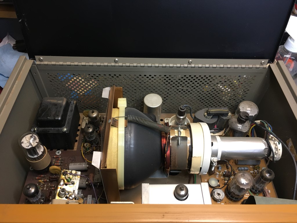

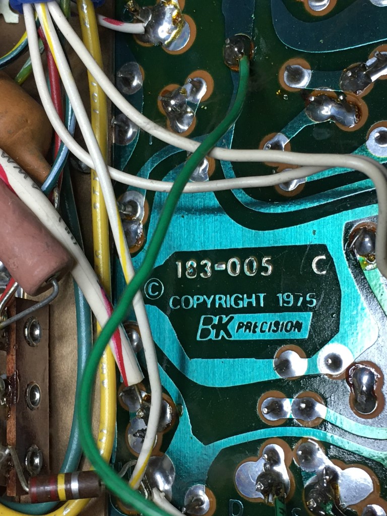

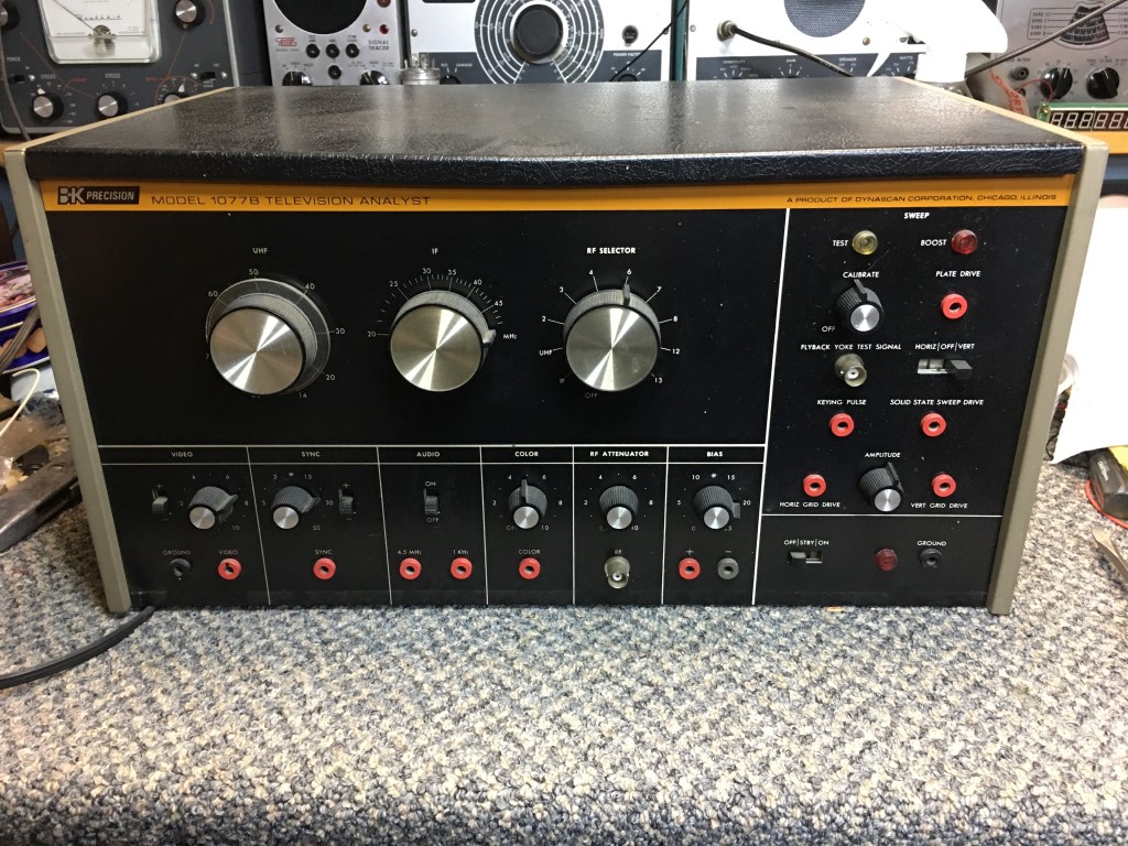

I've put this off for awhile, but I need to use this to find the problem on my Craftsmen. Need to track down a sync problem and hopefully this will allow me to do that. It's about like a tractor, when you need it, you got to work on it. Ok, I haven't powered it up but it looks original. I feel this will only (hopefully) need the e-caps replaced. It was built in '75 or '76, so it is one of the newest  versions. This will allow me to inject a signal into about any part of this TV I need to check.  Need to find some slides for it as it only has one with dots on it. A few pics below:

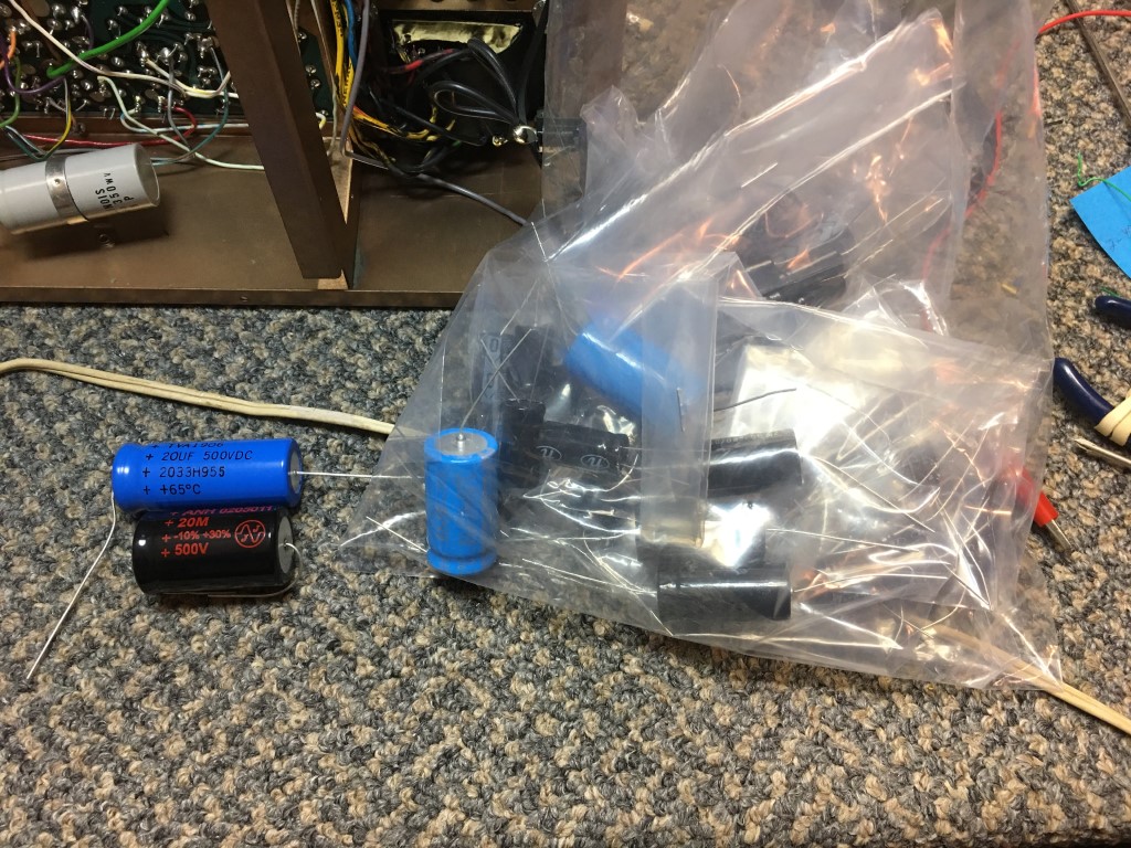

A bag of caps just showed up. Hopefully I can get some changed and power up. I found this at a "junk store" for almost nothing and it looked so nice! I have another one from my uncle, but it isn't as clean. It still smells like his cigars! Memories... I found a manual on eBay, which helps, so ... onward  Icon_biggrin
I can have 100's of capacitors on hand, yet still lack a certain voltage, size or quantity. Got these from AES, nice big caps.

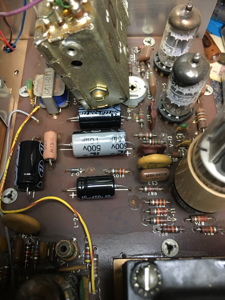

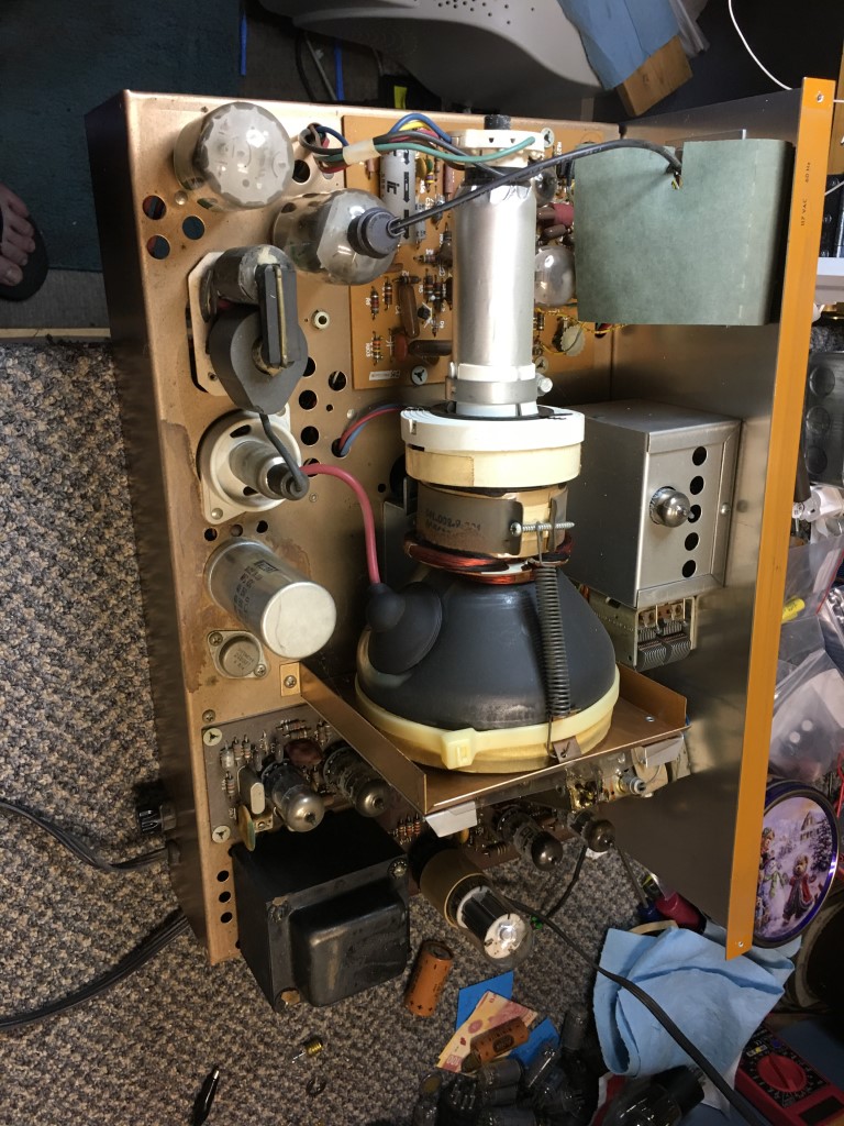

I got all the e caps replaced except the big can, thought I would power up slowly and see what I had.

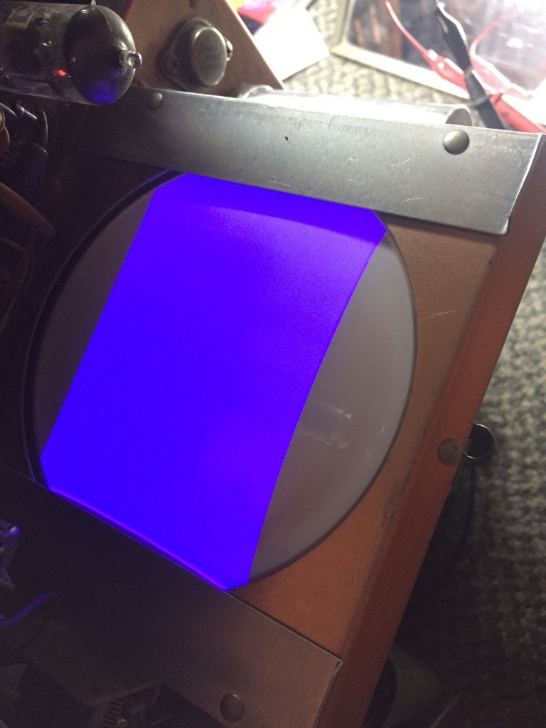

 The good: It came to life, tube lit up and had signal to TV tuner with color bars
The bad: smoke

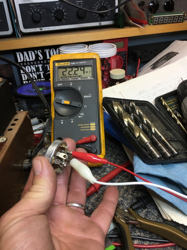

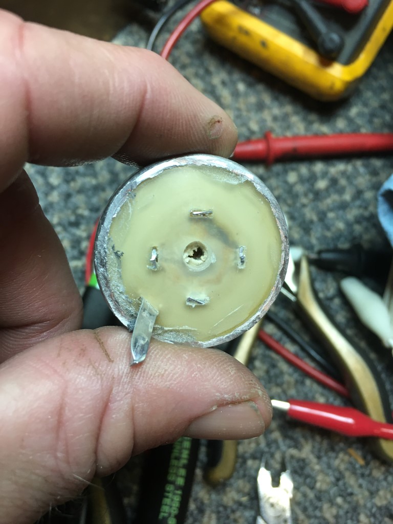

Yeah, its either the big can or one of the resistors underneath. I pulled the can with the intention to gut it and use the base for installing new caps on top, since it was a little crowded underneath. I chopped the top off the can and got ready to drill holes for the leads when I saw something that got my attention. Check this out:
Sure looks like a carbon/leakage path and may have been the source of my smoke. Gonna ditch this thing and put on a terminal strip to mount the new capacitators. Might want to check these bases before restuffing. Could be a source of "mystery problems". This was a Mallory can.
The completed pcb

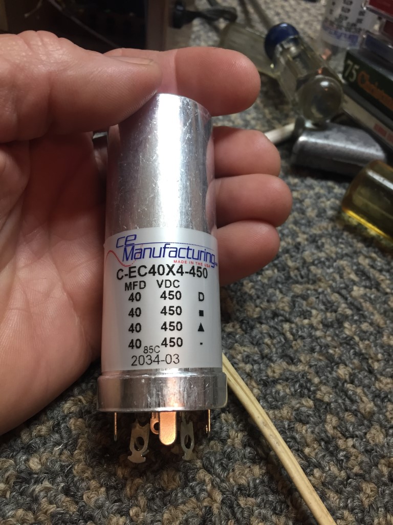

I gave up on the re-stuff of the big cap, so got a new can on order from AES.  A few bucks, but so much easier and will look right. Probably will be using this quite a bit over the years to come. Sure wish I had one of these 1077Bs in my TV servicing days back then.

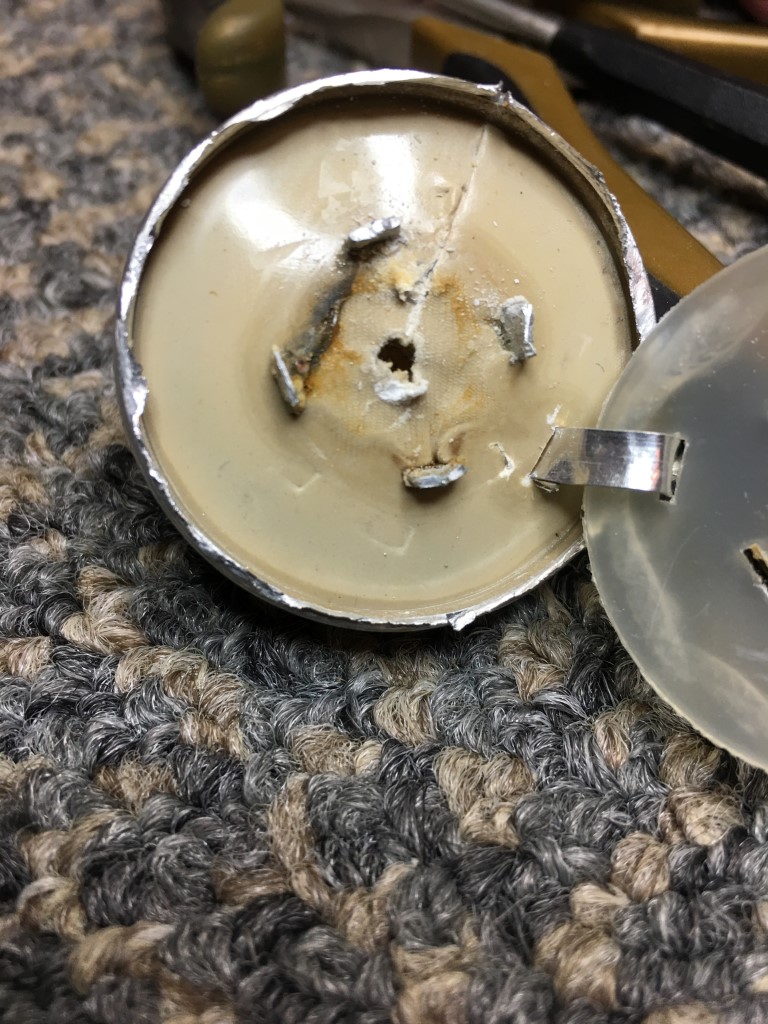

I dug out that plastic piece and found this:
Then I dug off the rubber piece and everything fell apart. To the trash can...

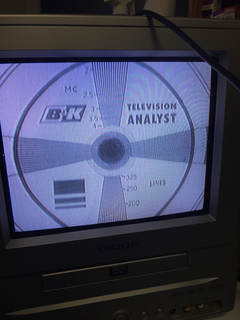

So I, I installed a 300 ohm resistor to drop the B+ a little and did my final "smoke test". After 45 minutes of running, nothing overheated. I could lay my hand on the PT without any violent withdrawl, screams or other form of sudden protest. I have checked functions and waveforms and seems everything is working as it should. Nice clean sweep waveforms, all channels clear, video and bias voltage. So, I buttoned it back up and is ready for my 1st test on the Craftsmen.
The below picture is on a small analog test TV I have. The slightly stretched vertical is in the set as Uncle Max's unit was identical.
