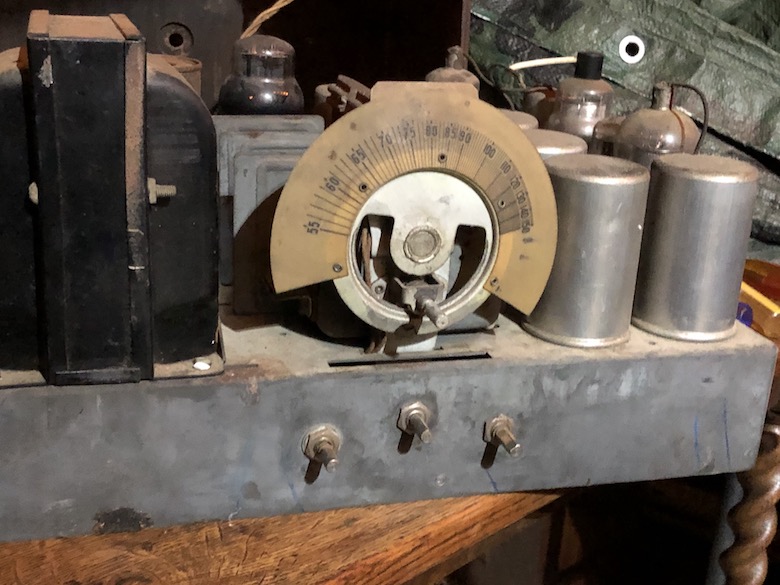

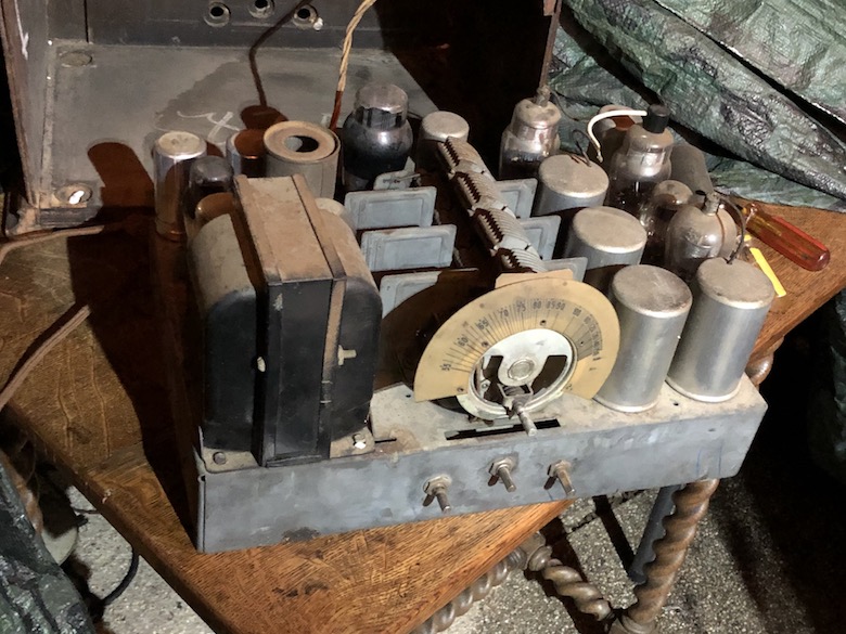

So I bought a Philco 90 off eBay for $95.00 and picked it up. I am now looking it over and I am lost. I think it is the early 90 with the dual 45's but the tubes in the sockets are all completely whacky...
There is a big 47, a few 27's, a few 24's, an 80 and one I cant read.
The chassis layout is the early one. The tubes in the sockets don't match the later 90 either..

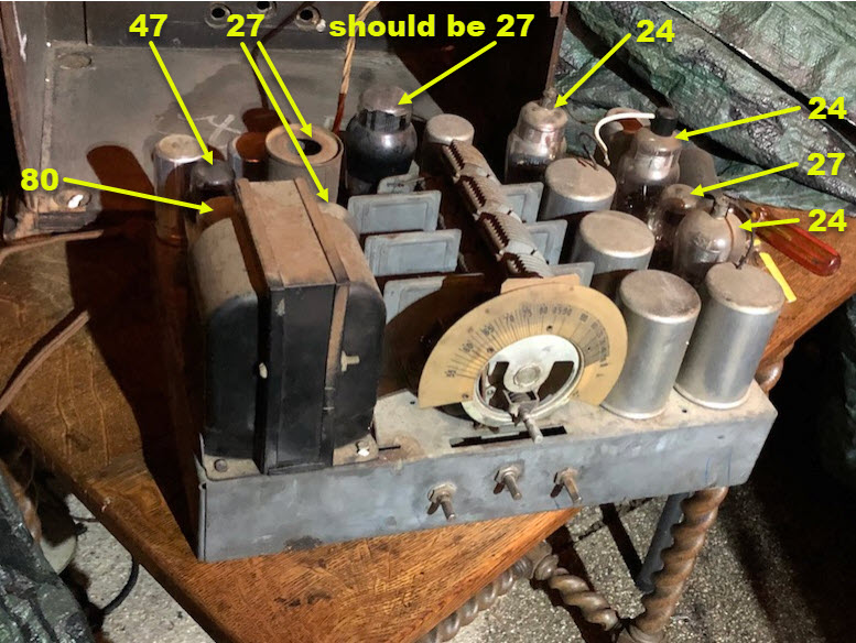

That is what is commonly known as the "mid" version 90 with single 47 output.
It looks like someone stuck a 47 (or a 46?) where a 27 should go.
Here is how the tubes should be placed in the sockets:

It will of course need the multi-section shield.
