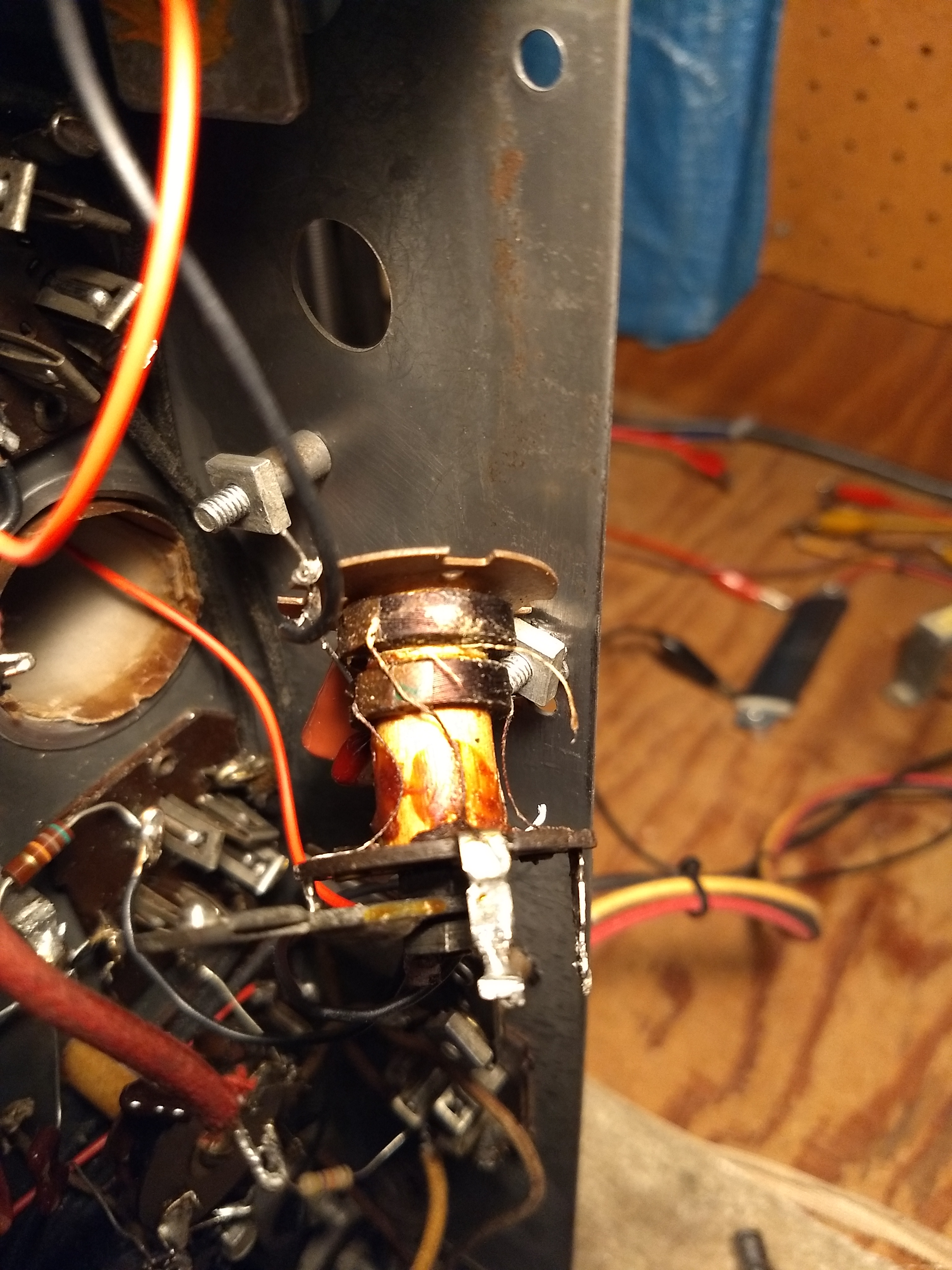

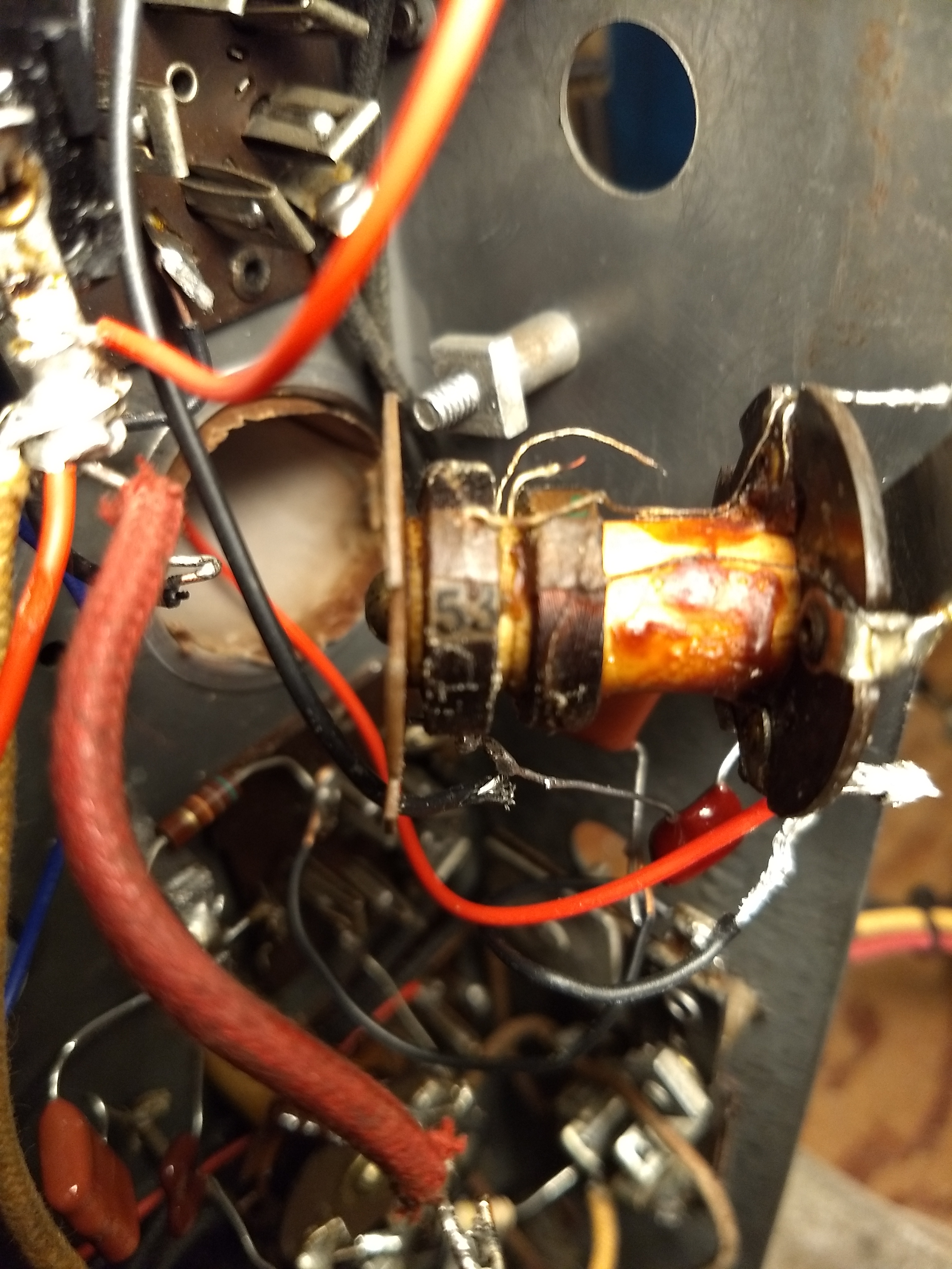

Found this in Model 70 last audio transformer.
The top coil had large glob of wax on one side of the top input coil and when I melted it off with dryer I found these two white extra wires coming out from the inner side of the top coil. The top coil's inner and outer go the terminals as I suspected, and the lower coil goes to one terminal and the the other to ground as it should.
Anyone have a clue? Should the be connected? They do not show on the schematic.
The ends of the these mystery wires seem to be stripped at the ends. Was this just a mishap on winding?

My bad, Its the coil before the second detector 24 (second IF transformer- part 03092). I have no clue yet, the white wires were under the glob of wax, and when I pulled them out that's what I see.  They are very, very fine cotton covered. I wonder if this the correct coil or not. The top coil measures 7.0 mh and the bottom measures 4.0 mh.
I think I was right, this is the audio detector (2nd detector) choke. It probably opened and was replaced by a coild taht was lying there nearby.

Good thread, thanks, my plate RF choke measures 10mh. The one in the pics that I am referring to is the second IF transformer that feeds the final audio detector. Still don't know what these are or why. Strange enough, found an eyebrow hair preserved in the wax.
