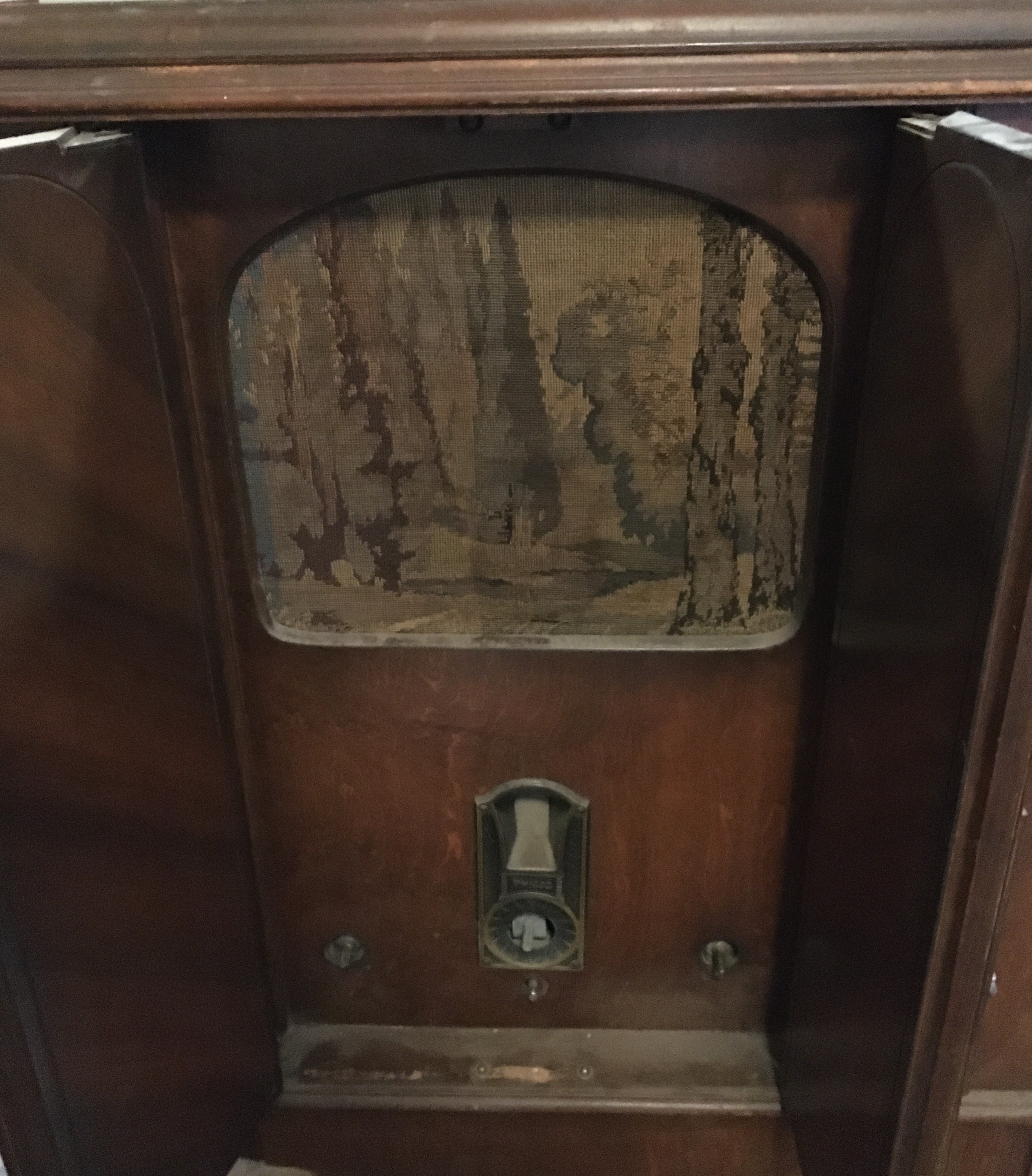

help id this philco
ok i have a philco 95 or so i believe it to be but if i am correct the 95 use two 45's this chassis has two 47's four 27's four 24's and one 80
help
Sounds like a model 112 serial #174001 and higher.
here are some pics i would agree but what about the 47s i found unless some put the wrong tubes in this that shows' 42s,44,and 37s

It looks like a late 20s highboy cabinet, like a model 95 would use, with a 1931-33 pan type chassis, either a 111 or 112.

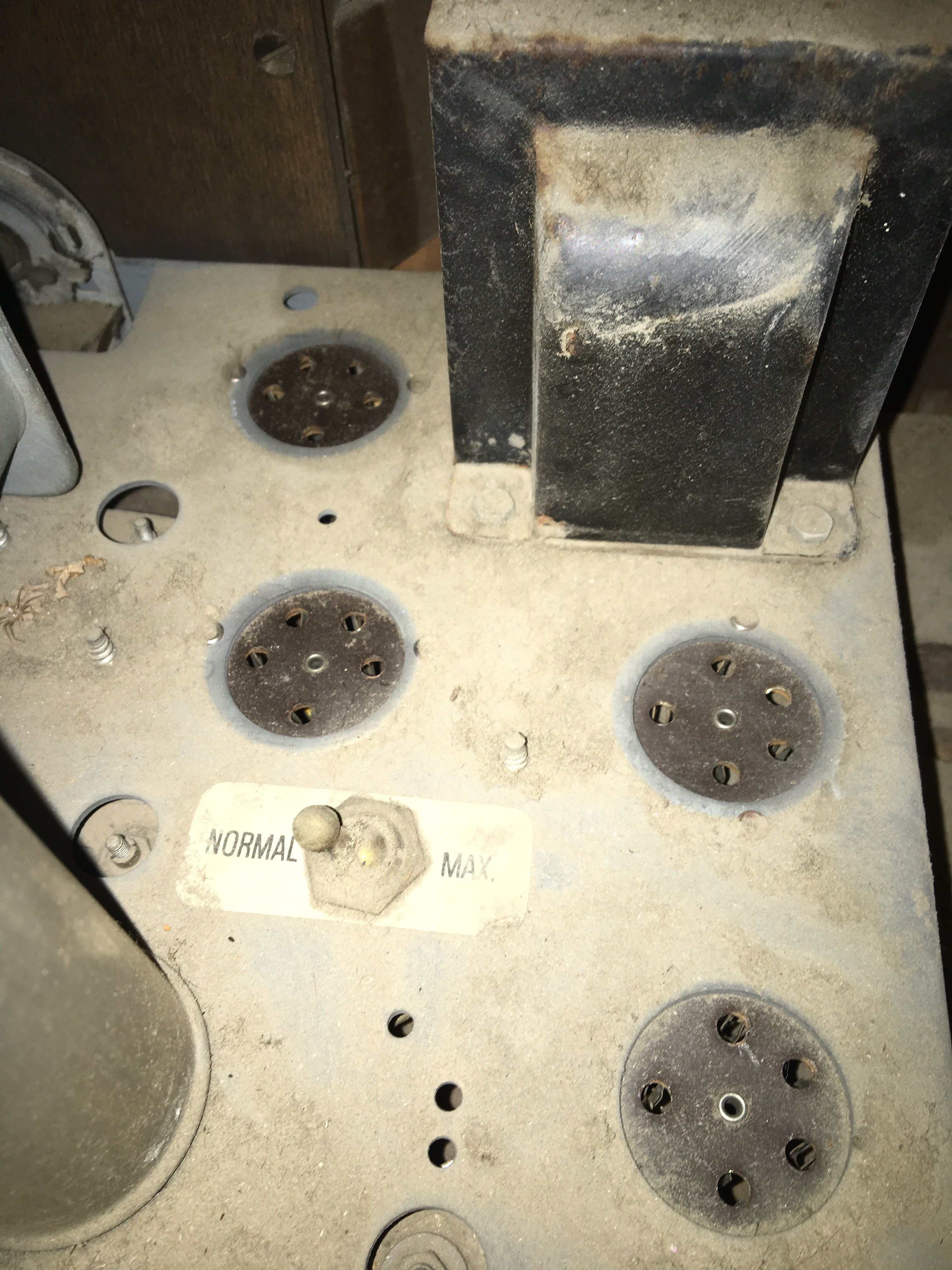

Terry is correct, as is Arran - it is a late version 112 chassis. Notice the NORMAL - MAX. toggle switch on top of the chassis; only 112 chassis have this. Plus the five pin output tube sockets indicating 47 output tubes. Someone put that chassis in a 1929 Philco highboy cabinet. The chassis are the same size and have the same control shaft spacing so the 112 fits that cabinet without modifications.

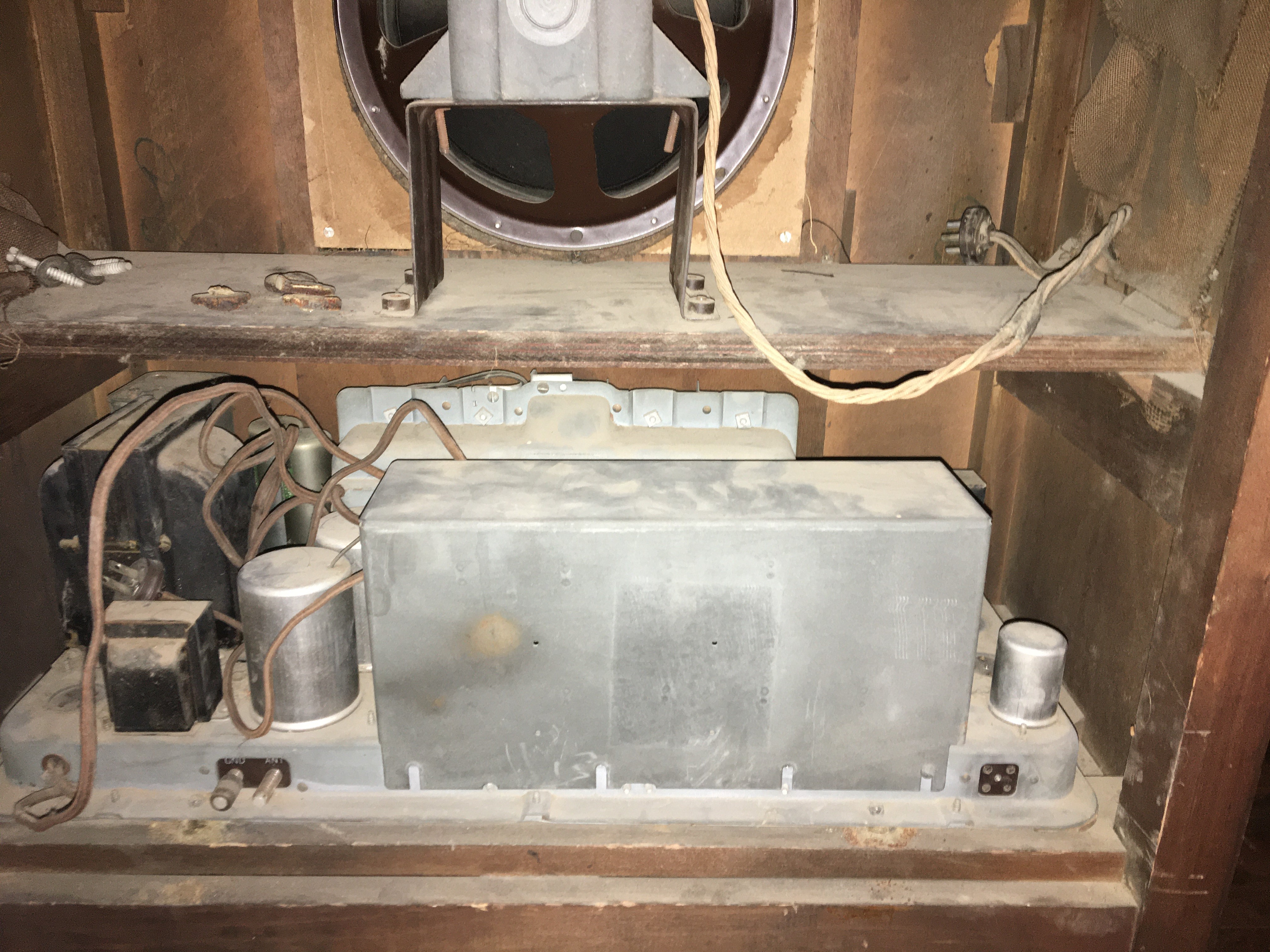

It looks like whoever made the change installed a matching speaker from a 112, adding the risers from the original speaker.
As much as it isn't the correct chassis for the cabinet, the 112 chassis is a "better" unit than the 87 (I believe) that should be in that cabinet, because it is a Superheterodyne design, with automatic volume control.
Unless you are an absolute purist, I'd restore the chassis and leave it in that cabinet. If you find the correct chassis later, it's easy to change. And it gives the poor chassis a warm home during this cold Covid winter.
