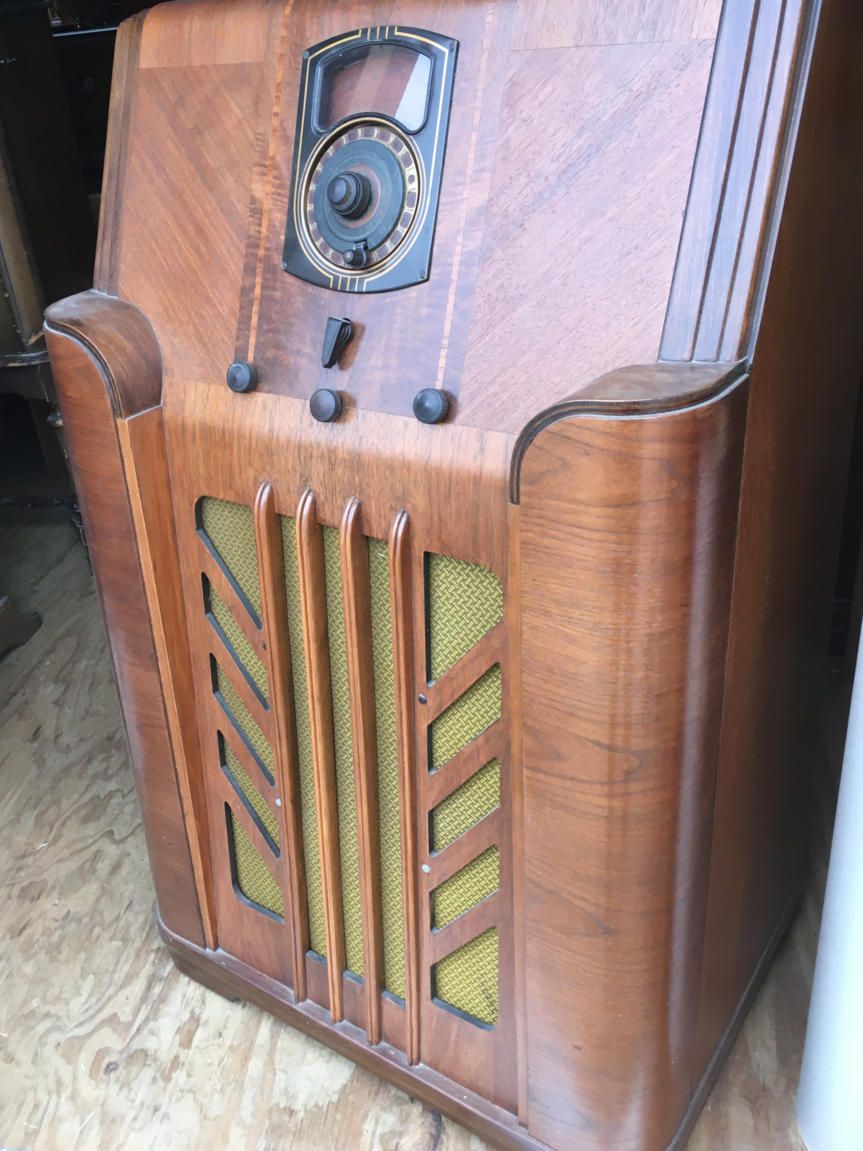

here is another one i need to id philco
i was told this is a philco 38-116 but it has a different cabinet than the one i have and can i get repo speaker cloth for this
benny

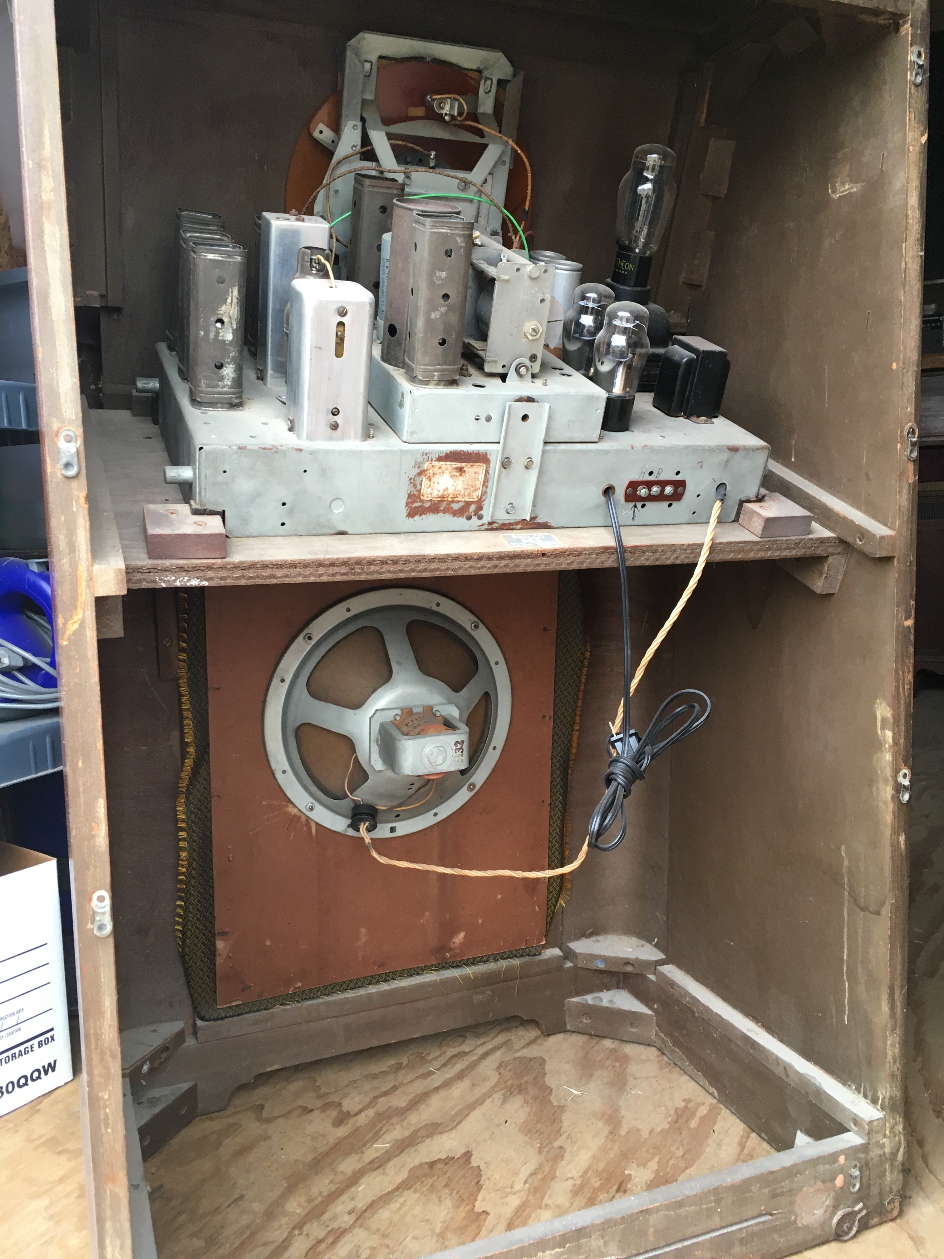

I can tell you one thing it isn't that's a 38-116 chassis or cabinet. Will shoot for 38-2.
I think Terry is right. I have one like it that i have not looked at in along time. My 38-116 is NOT like that!
Just take a look through the Philco Radio Gallery.
https://philcoradio.com/gallery2/1938a/#Model_38-2XX
Whoomp, there it is.
Yes but did it have the wide chevron grille cloth?
The 38-2 used the Philco "Ribbed" pattern originally, mounted vertically (up and down). Not the chevron cloth.
is anyone making repo speaker cloth
Radio Daze lists their GRC14 which is not exactly like the original, but is the best you can do now.
https://www.radiodaze.com/grille-cloth-14-item-grc14/
