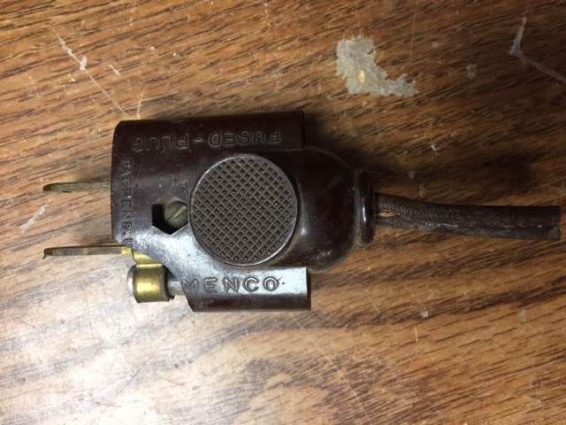

Both radios had a fused plug on the AC line. Was this a Philco supplied item?

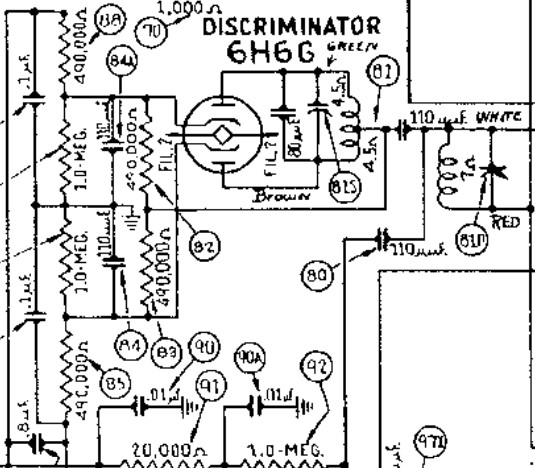

The Magnetic Tuning transformer #81 is a square can which has a different 81S tuning cap. Could this be used in the set I'm repairing if needed?

Attached is the schematic link from Riders which I am using, and a picture of the plug.

The ac plug w/dual fuses I doubt is original. I only place I've seen them is on Heathkit equipment. I would take a look in the Philco catalogs and see if they are listed.
From the number of 37/38-116s and 37/38-690s I have encountered in years past, I feel that the answer is - yes, they came with the fused plug from the factory.
New ones are being made, and you can find them at farm and home stores that sell electric fencing. The new ones are made in China (surprise, surprise) and have a "Dare" name on them instead of "El-Menco" but otherwise are identical to the originals.
Possibly, but study the Magnetic Tuning circuit of a 38-116 first to be sure they are the same.

Thanks for the info. I actually have a good Elmenco fused plug which I will put on the radio. It's not cracked and looks to be solid.
As for the Magnetic Tuning transformer, both sets are 37-116, just different vintages as you pointed out. I may look into the square transformer from the parts set. I'll open it up to check the parts values inside. If they are the same, I might try it. I suppose Philco made a change for a reason.

I found a supply of the Elmenco plugs and have been using them on quite a few radios. that way I don't put a fuse holder under the chassis. Both of my 37-116's had them and yes, Ron, the bottom board is not solid on my 116's.

I managed to repair the magnetic tuning today. I took apart the original can again to look at the coil. I had replaced the 110PF cap and the 490K resistors already and the primary was causing the required dip in audio. I tried replacing the 80PF mica that was in parallel with the secondary trimmer, thinking maybe it was bad. No dice. I could not get enough capacitance and the trimmer was down tight. I tried experimenting with extra fixed mica caps and still no change.
I decided to remove the transformer from the parts chassis. When I opened it to change the resistors, it was built completely different. The secondary had a big ole air variable cap and no fixed mica across it. The primary was identical to the old one. This transformer reminded me of the one in the 38-690.
After changing the resistors and installing it, the magnetic tuning worked perfectly! I had to tweak everything slightly, but that's it. Something must have been wrong with the coil in the old one. Philco must have had issues in the original design and went to this model. Hopefully this info will help someone working on one of these models.
