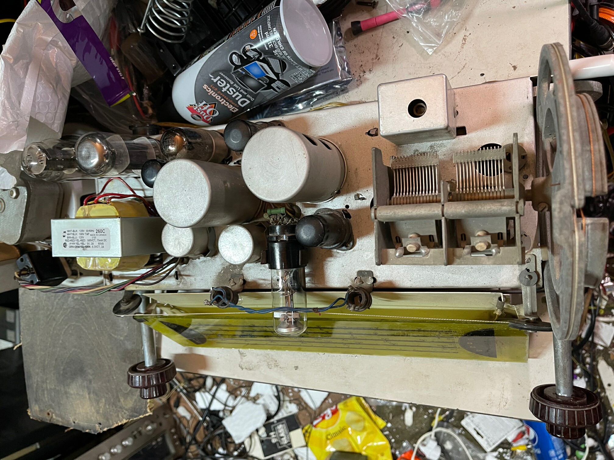

After obtaining a new power transformer for my Baltika, I find that it really likes the new transformer, it doesn't even get significantly warm to the touch.
The radio itself works pretty well now, except for one minor problem: The MW band does not work. The Local Oscillator is dead. If I insert a carrier of the proper frequency I can receive stations on it, but without that, nada.

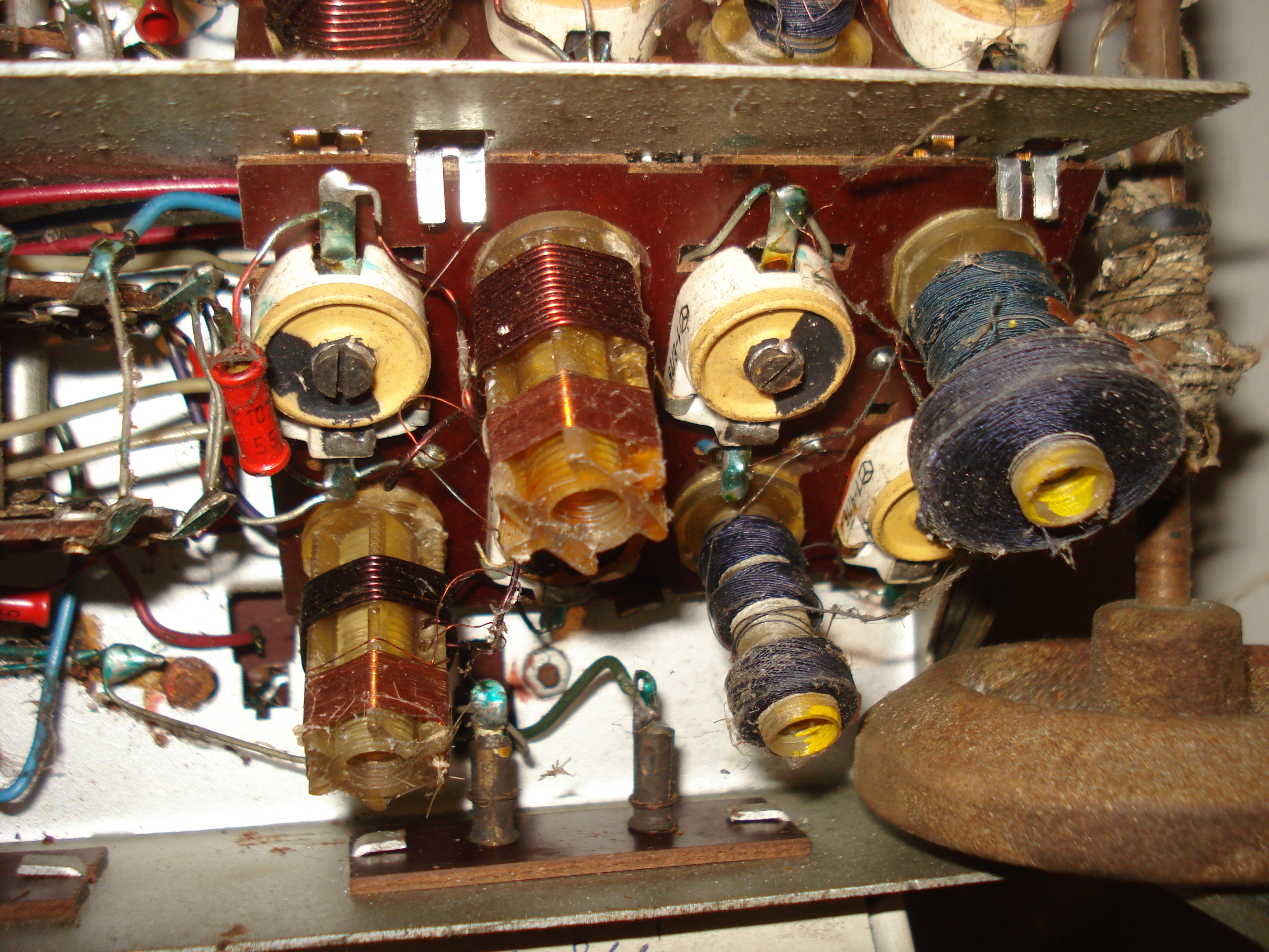

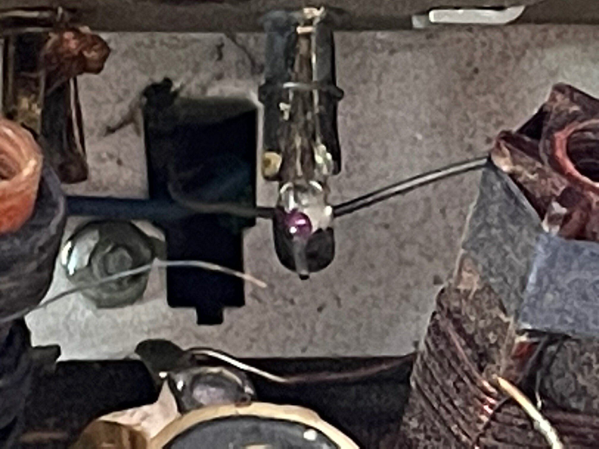

There is a coil on the bottom side of the chassis that looks as though to be for the MW band, and it has one wire that is broken off of somewhere. I cannot locate where this goes. I've tried touching it to various points close enough for it to reach, but still nothing.

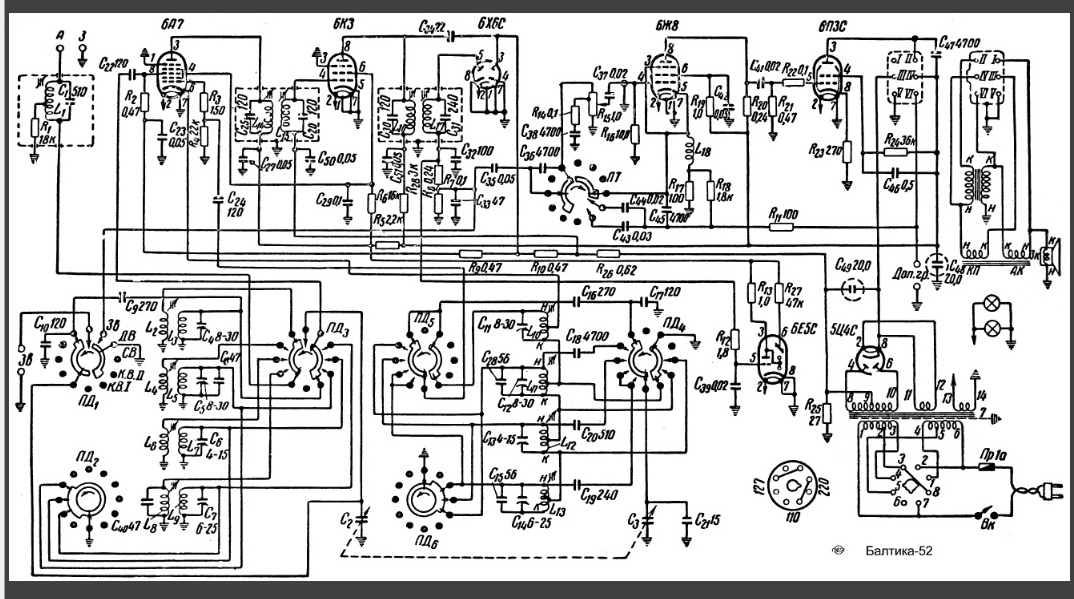

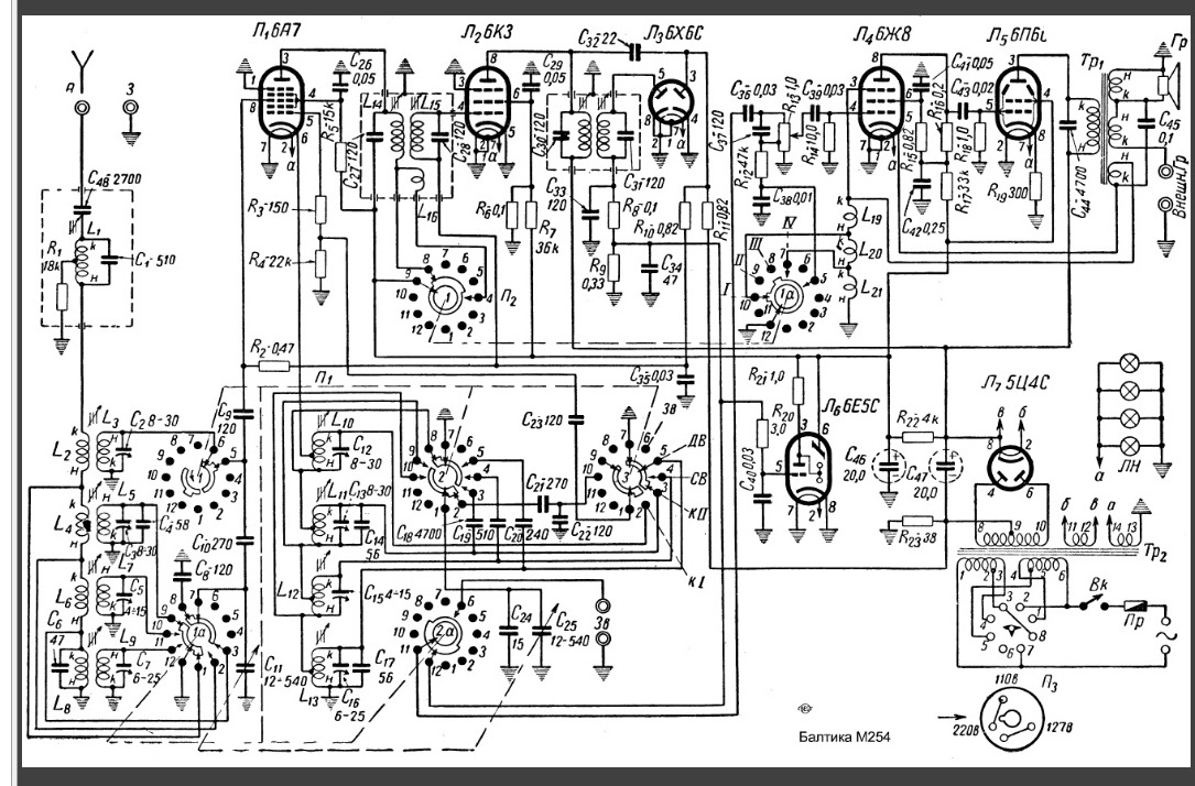

I have what seems to be the only schematic available for the set, downloaded from radiomuseum.org, but it's of little help, since it shows no pictorials of where parts are located.

Hello Brеndа. There are three main models - Baltic RZ-1, Baltic 52 and Baltic 54. I would like to clarify the model of your Baltic, because they differ significantly in scheme. Please let me know what model you have and I will send you a diagram and take a photo of the chassis.

OK . I am sending you all three Baltic models.
Baltic RZ-1 . 1950
Baltic 52. 1952
Baltic 54.
The main difference between the Baltic RZ-1 and the other two models is that it has only 6 radio tube.Models Baltika 52 and Baltika 54 have 7 radio tubes each
And the Baltika 54 differs from the other two by its permanent magnet speaker, instead of the combined magnetizing speaker as in the two earlier models. The most popular and popular was the Baltika 52, the Baltika RZ-1 is a rather rare model, and the Baltika 54 is very rare.

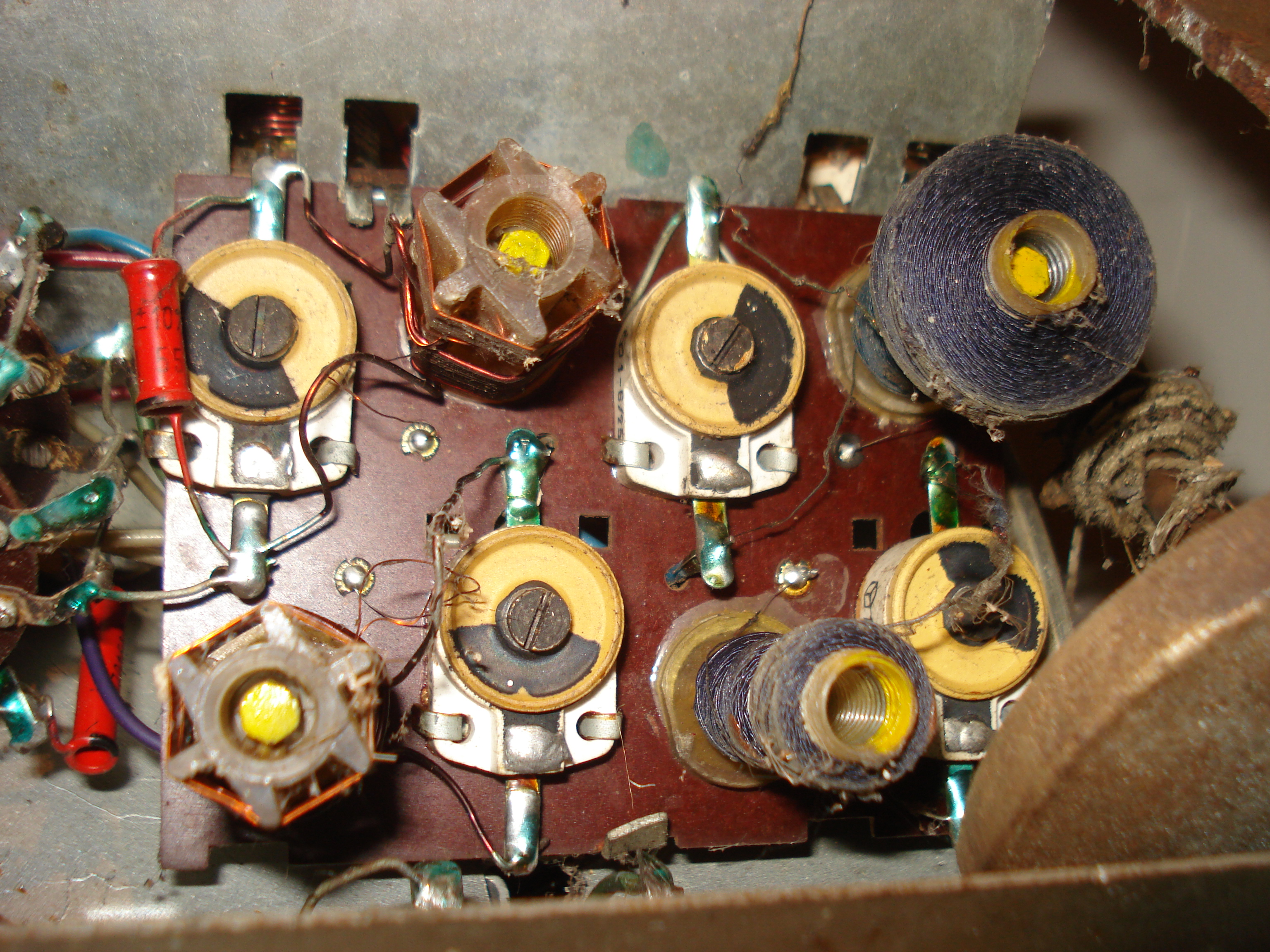

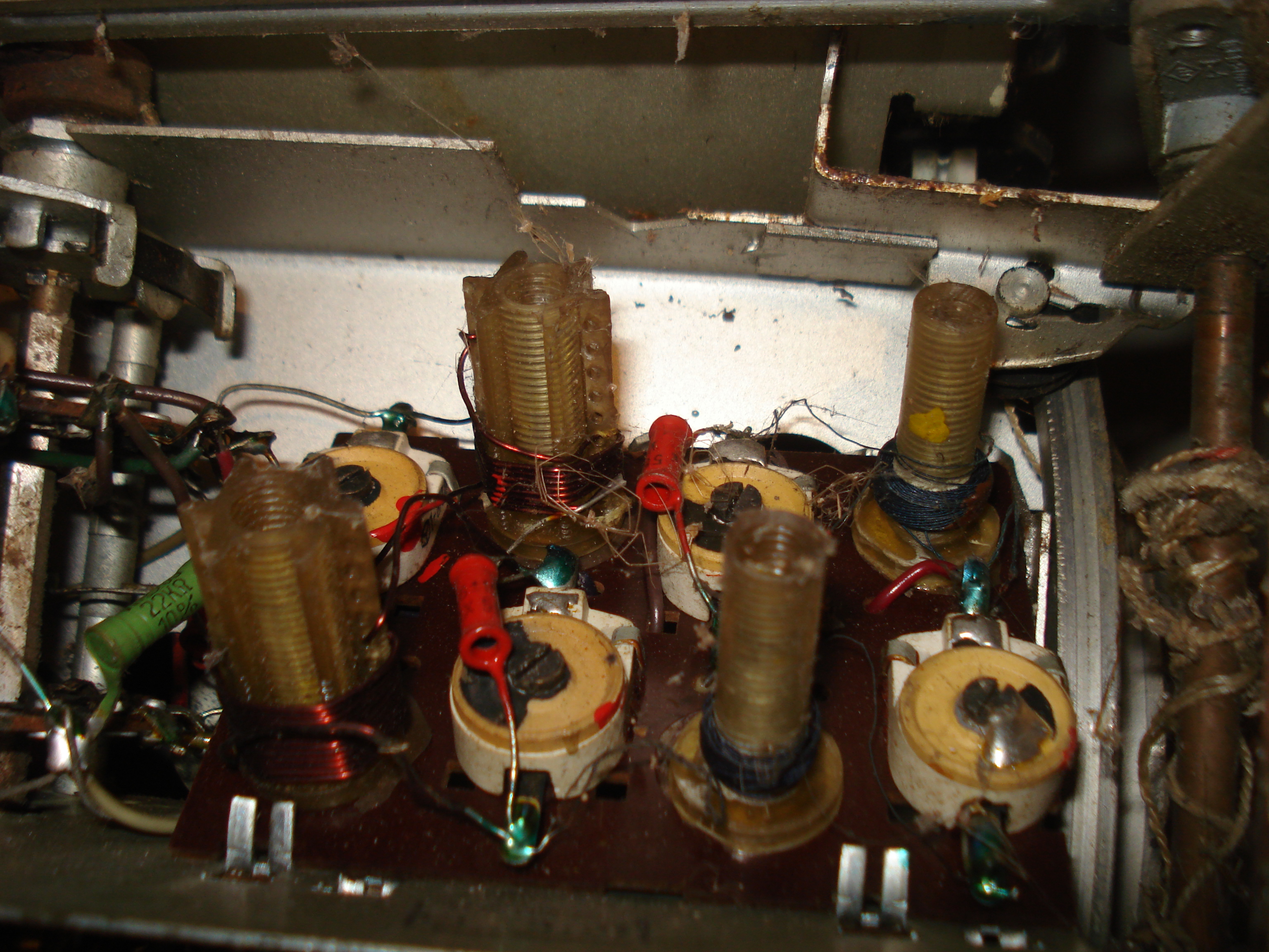

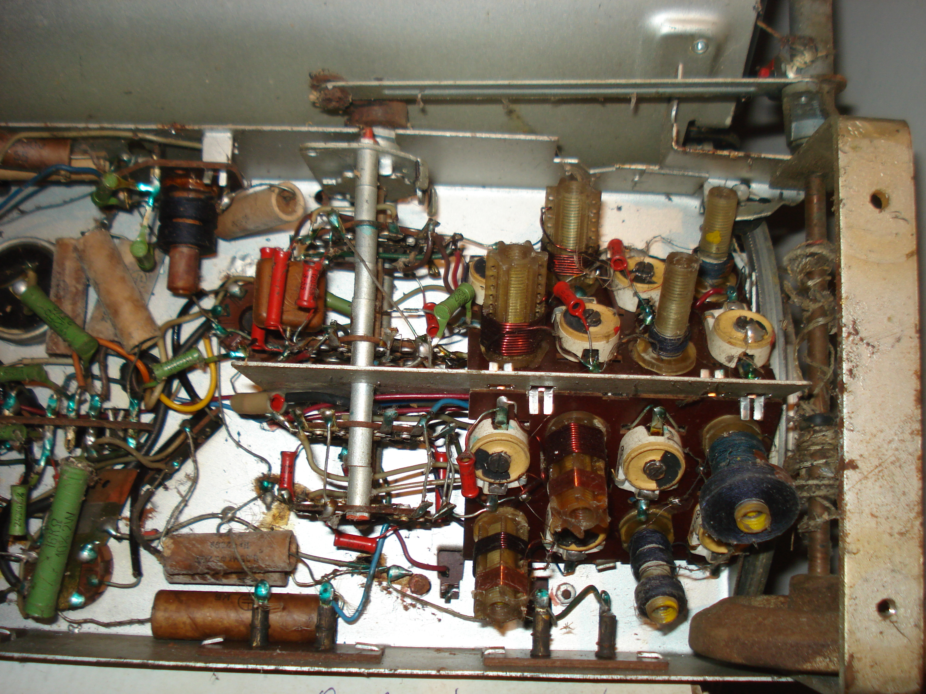

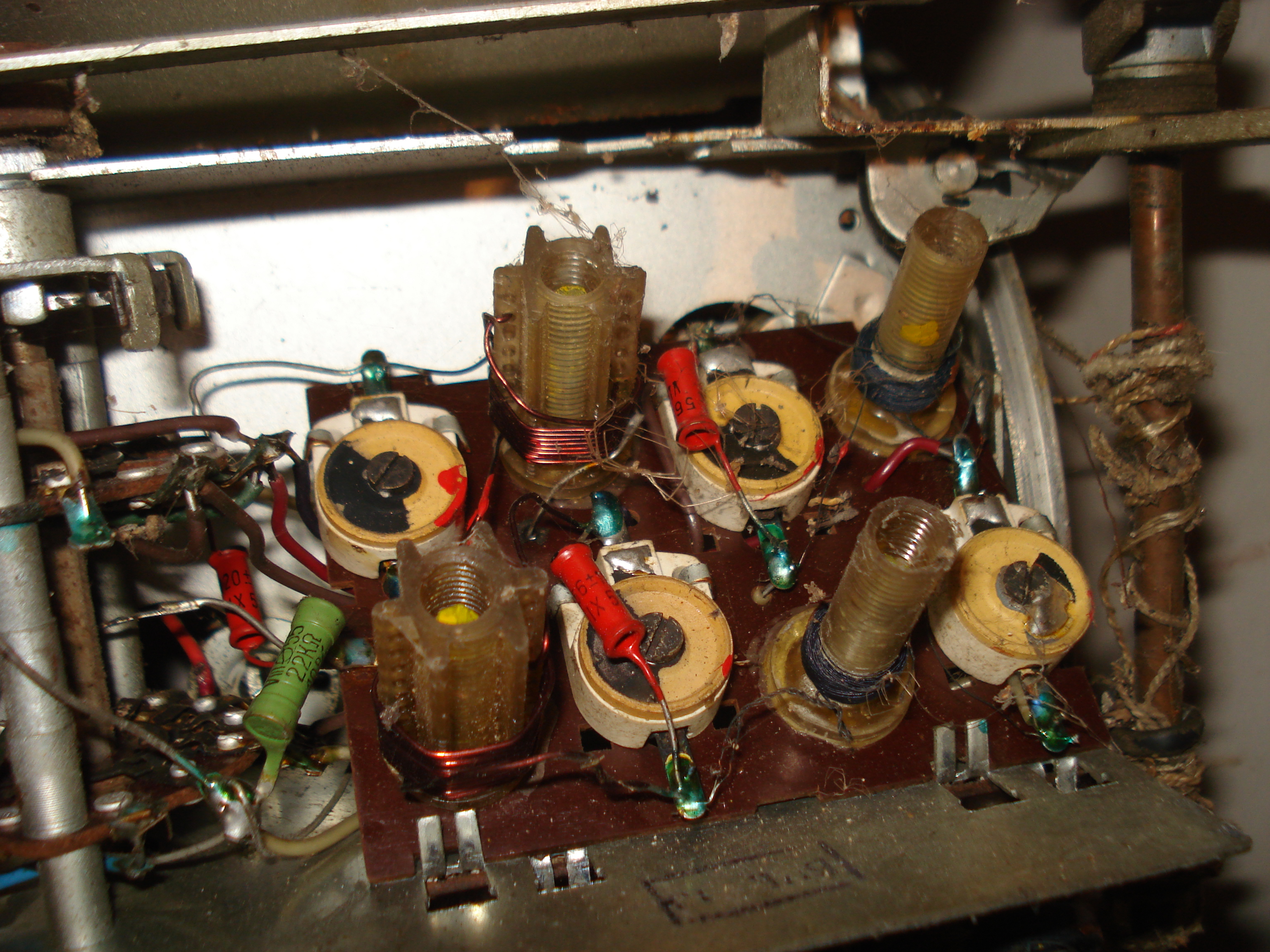

I think Brenda also asked about the pictures of where the coils are located. Do you have the assembly drawings?

The second photo is grainy, but if my perception is correct, it is a low-turn coil with fairly thick wire.
Worst case, would you think you are able to rewind that thing?

It looks like the coils in the schematic labeled L10 through L13 are the oscillator coils for the four bands. The band switches on either side select one of the coils to work with the tuning cap C3 to get the correct range of frequencies. Each of the four coils has a tap, so there are three wires coming from each. One end of each coil goes to the switch on the right through a capacitor. If you can identify which cap is associated with your problem coil then you can use that to identify the wiring for the coil. Hope this helps

Peter,
Thank you. These are helpful. I figured out where the broken wire went, and added a short extension to it so I could reconnect it.
However, that did not help, because as you pointed out, that coil bank is for the antenna input. My local oscillator is still dead for MW.
I note by visual inspection that the coil on the lower right of your last photo is the MW local oscillator coil. I checked the coil itself with a meter and it seems to have good continuity. Can you please point out the MW local oscillator section in the Baltika 52 schematic? I'm having problems tracing the schematic around the band switch, and it would help a lot. I'm so close to having this radio in good working order, I don't want to give up now.
