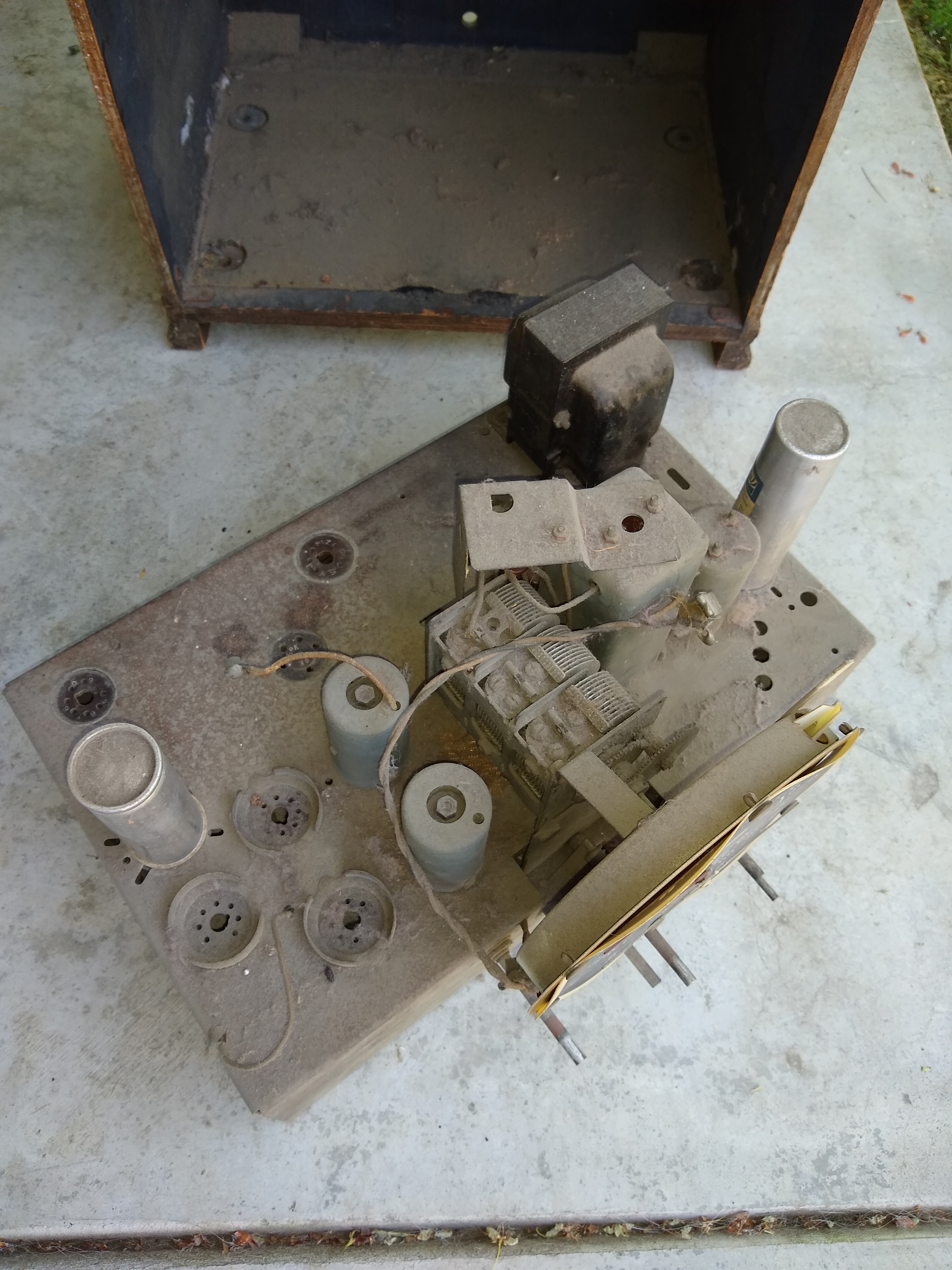

Here are a first few views, as found:
A little unpromising, as there is a speaker/transformer/field coil combinaiton to fiind. Otherwise, here is what I have found in the first assessment:
Power transformer seems intact, windings check out
There are a couple of extra holes in the back of the chassis - no clue what these were for (record player connection maybe, past tinkering)
Filter caps have been disconnected/bypassed at some time in the past, but the cans are still on the chassis

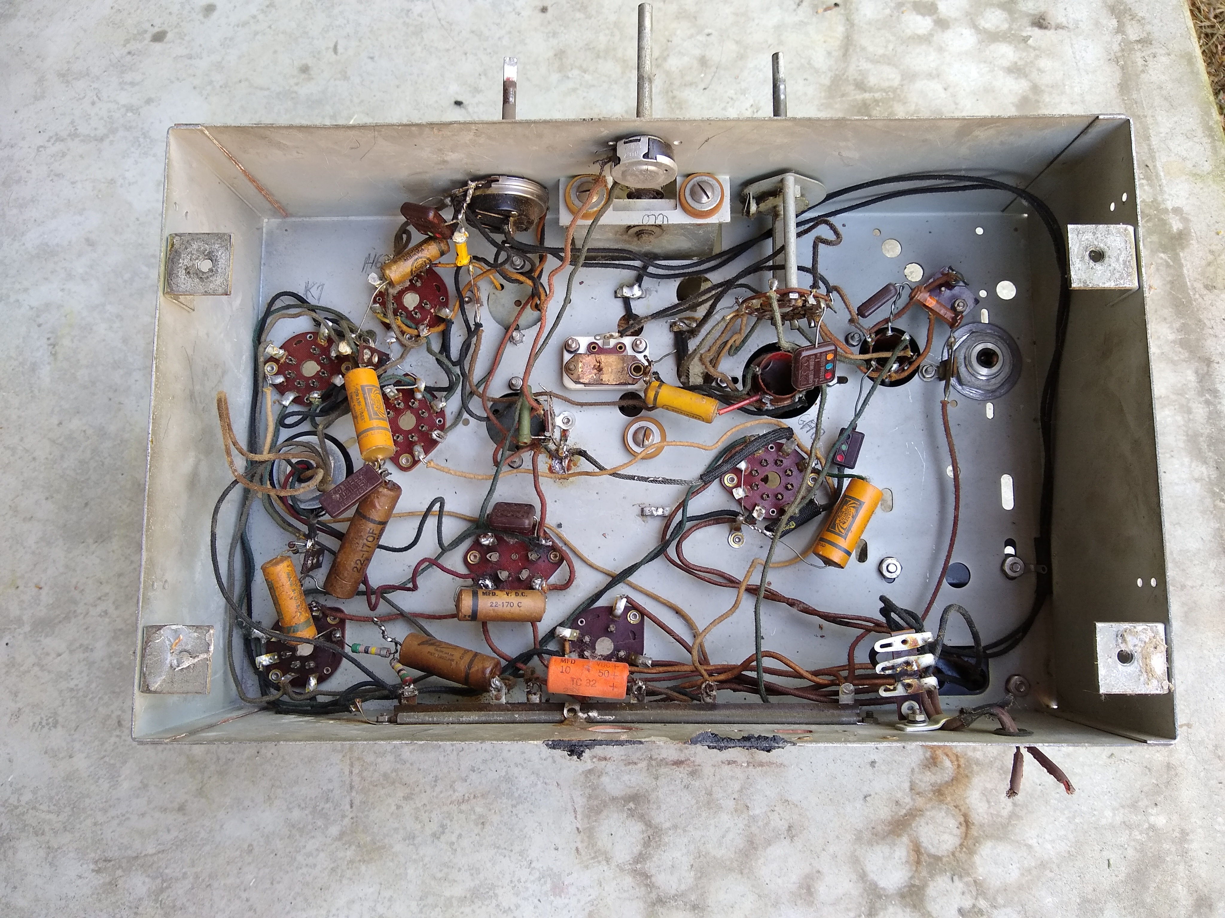

There are a few signs of past repairs/tinkering of marginal quality
The big "Candohm" or equivalent resistor along the rear of the chassis seems to have an open section.
The tuning drive belt is long gone, and a replacement would be needed.
After giving the chassis and cabinet a good cleaning to remove the antique dust and grime, the tuning mechanism received some attention. The dial was removed and and put aside for safety. Then I carefully dismantled the gear drive, cleaned and reassembled temporarily. It moves freely now.

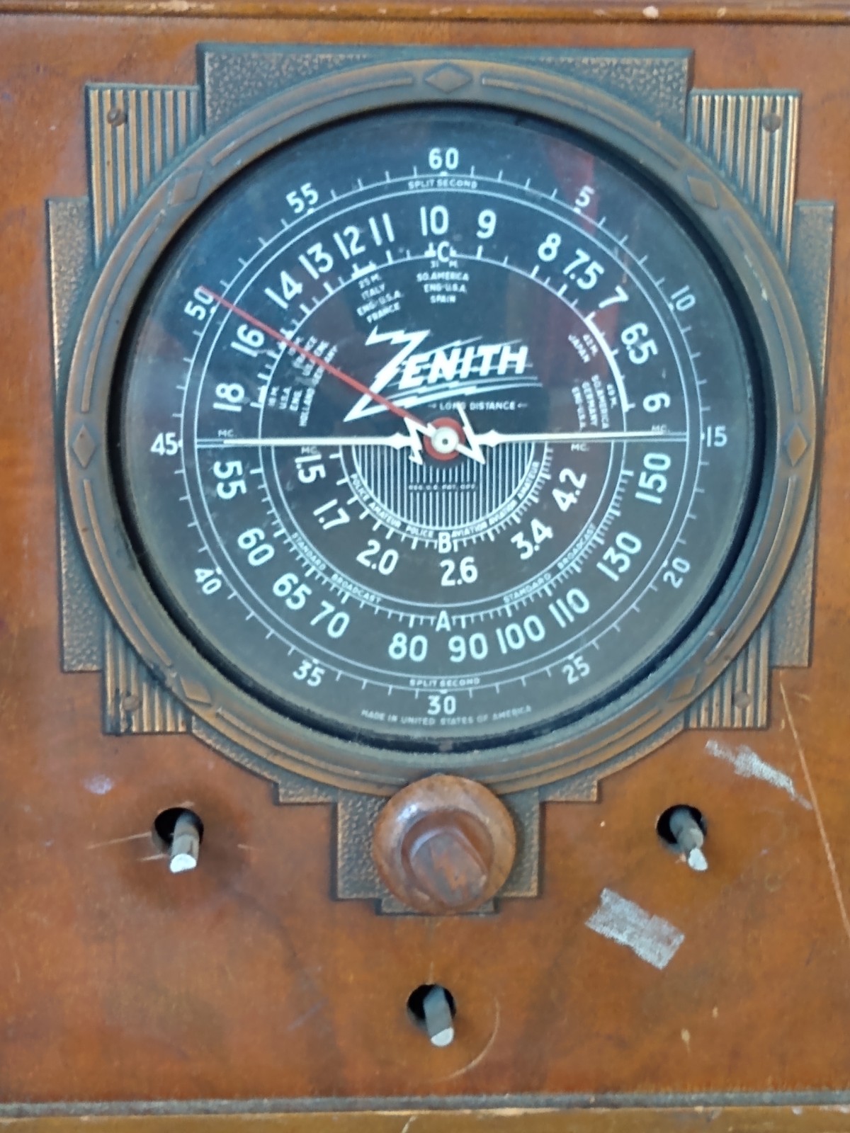

I am very tempted to give this one the full treatment - I have always liked the big Zenith dials.

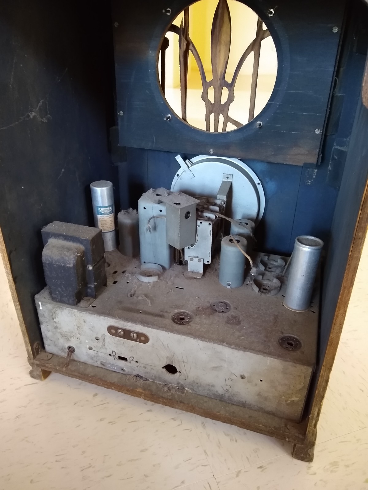

  I think you are correct about the extra holes, one looks like it my have been for an AC outlet, the elongated one, the round hole was obviously intended for a jack. I think that Brand Z liked to use rebadged Rola speakers, painted gold or copper, the bracket around the field coils look like a Rola. I can see why you picked it up, the cabinet actually does not look that bad, and the chassis isn't a rustbucket, even if the transformer was bad it would not have been a great loss as X mount replacements are easier to find.
From what I see on the back of this radio ;  the rectangular hole would have been for a slide switch
to go from radio to phono  hence the initials  'R' and  "p'.
     The round hole would have been for the RCA jack for the phono.
 I have seen this configuration on many radios, with the switch being in a rectangular hole.

Plus 1 at Arrans remark, chassis not rustbucket! Really just seems dusty.
I guess the slot could have been for a slide switch, though it looks like whomever made it either did not use the holes, or removed whatever they added some time ago. It's too bad that they defaced the rear apron by making a rectangular hole, round holes are easier to cover, but you could make use of the two smaller holes and attache a cover plate.
Thanks for the insight chaps. Very helpful.

  I'm sure that you have seen this guy before, he sells reproduction knobs that will match your set. https://www.ebay.com/usr/bigriverhardware I would love to know how he is making them as I have a few non brand Z sets that need some.
Hello Guys,
that is a nice score ED and my Zenith model 908 also uses a Z shaped pointer but mine is red and you are luck to have yours still .
I have had tough time finding one !
sincerely Rich
