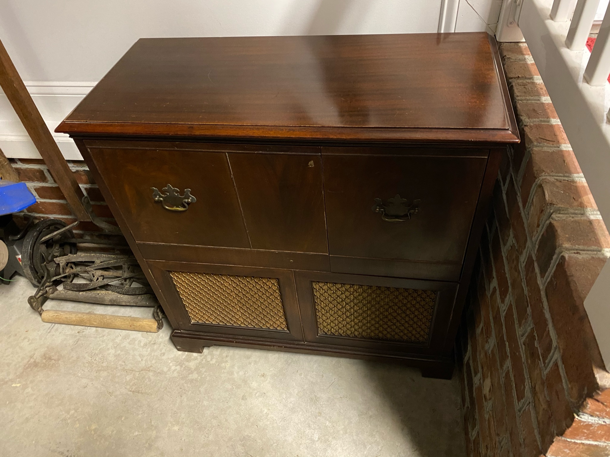

I bought this console at a flea market in March. It looked challenging to me in terms of electronics but the cabinet was in good shape and I got it for $ 50.

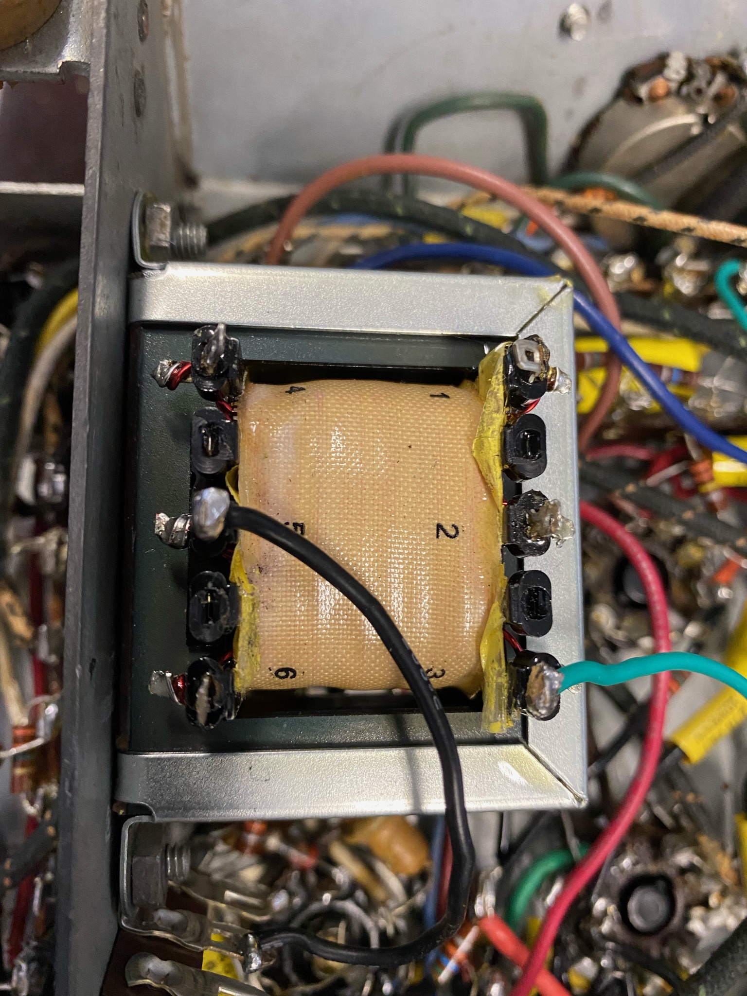

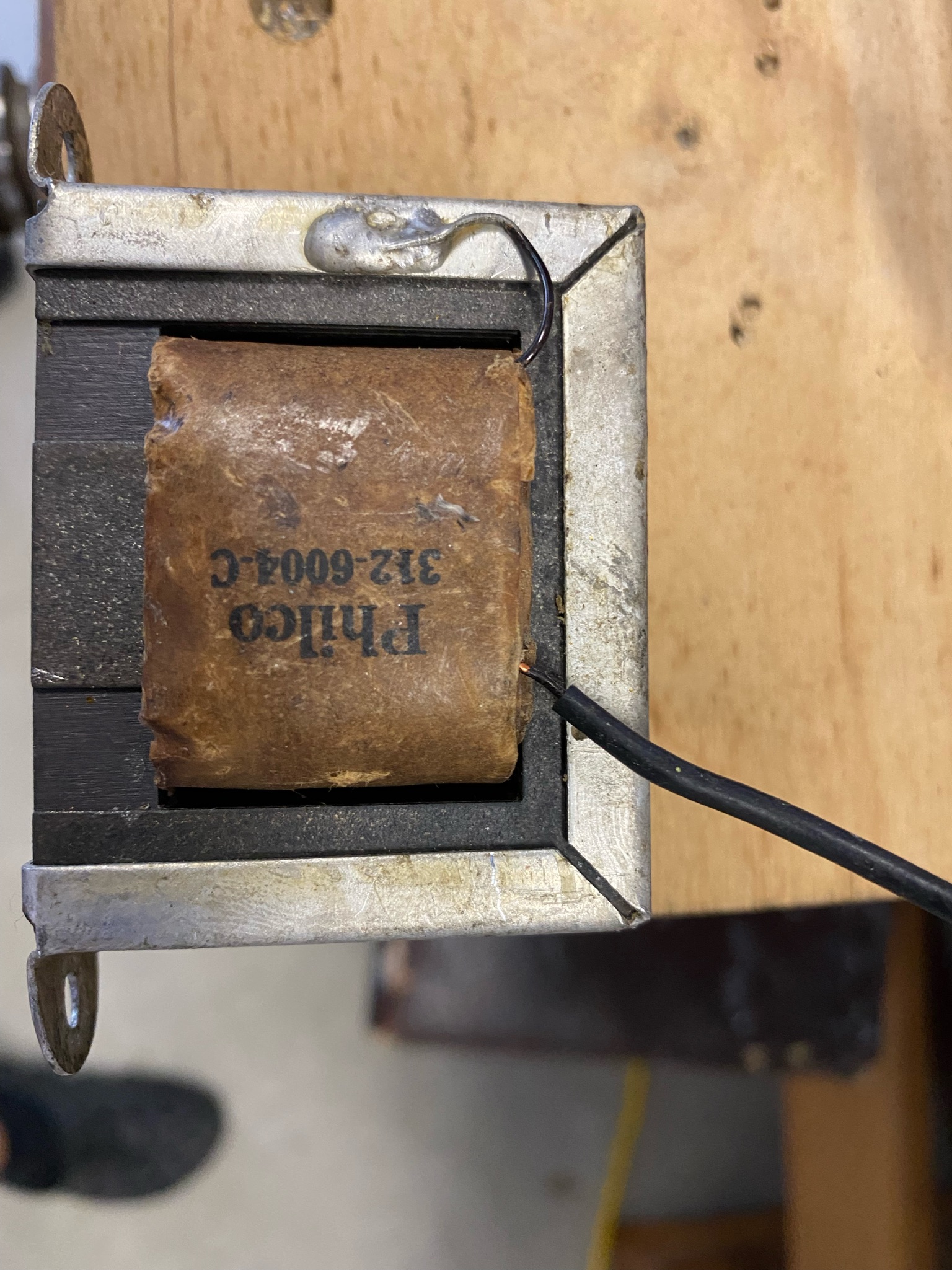

I spent a lot of time studying the Philco service manual and testing tubes, and transformers. All of the tubes except the 5U4 were good. The output transformer was bad and I replaced with a Hammond 125D. Speaker looked good and the field coil was good too. I treated it with Thompson’s water seal (spray can).

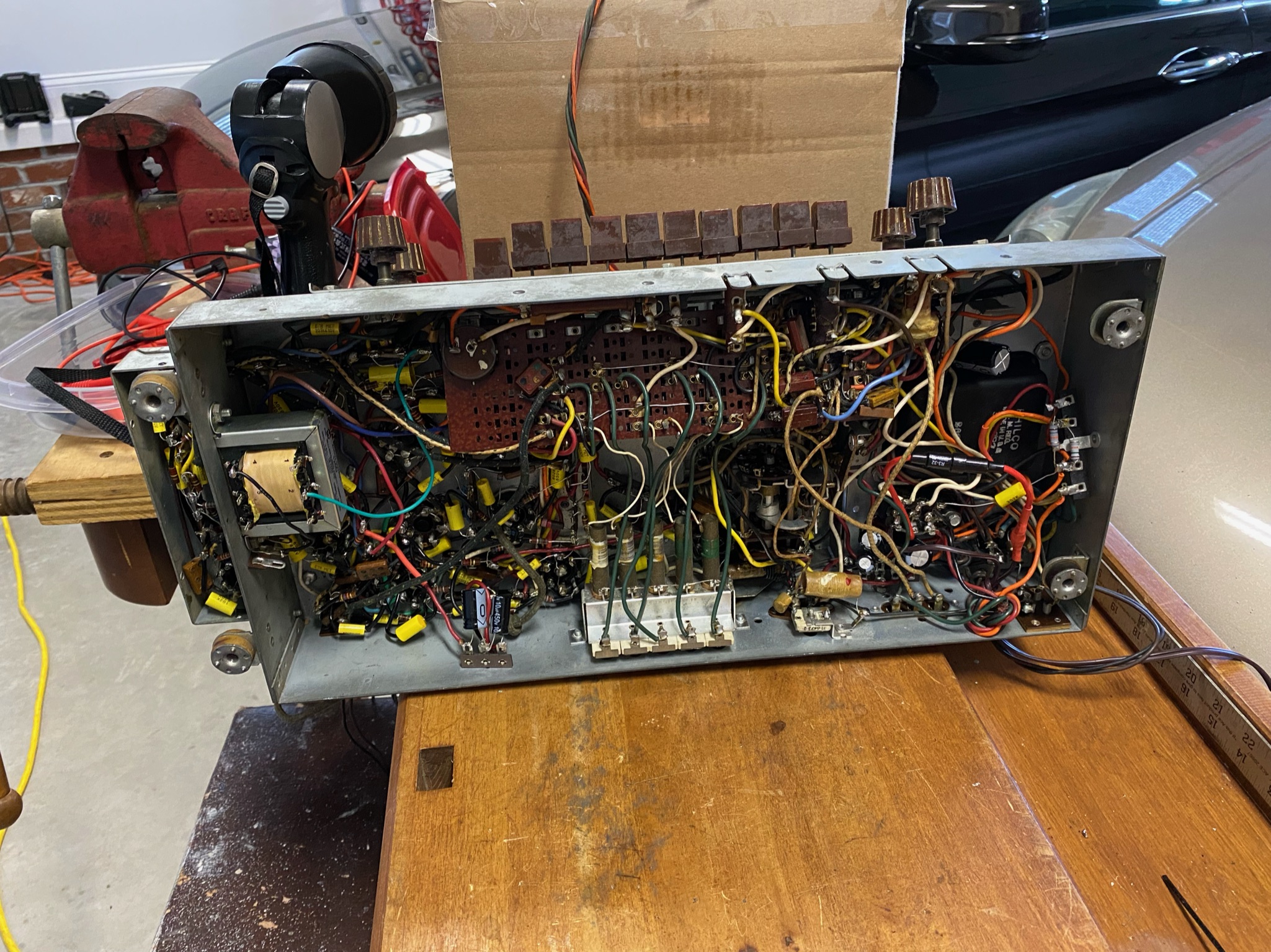

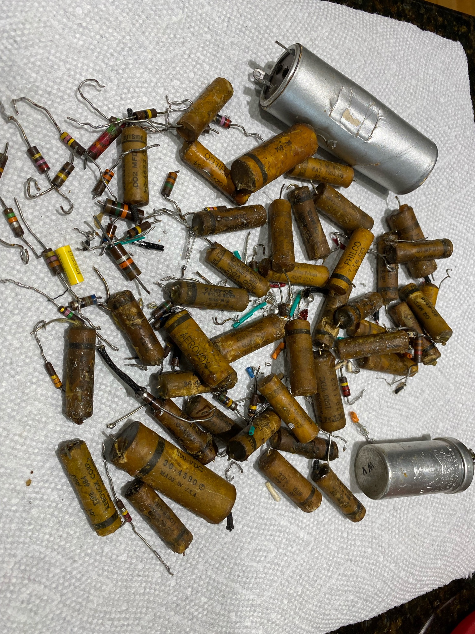

I started recap about end of May. I replaced the electrolytics, all the paper caps, and quite a few resistors. I was surprised at having to replace so many resistors but maybe my desoldering work put too much heat to them. Seems like caps were tied to lugs at lowest layer with resistors and wire leads on top - pretty tedious for a nearsighted old man. Maybe a desoldering station would be a good investment. I finished the recap along with a new line cord and fuse around End of June.

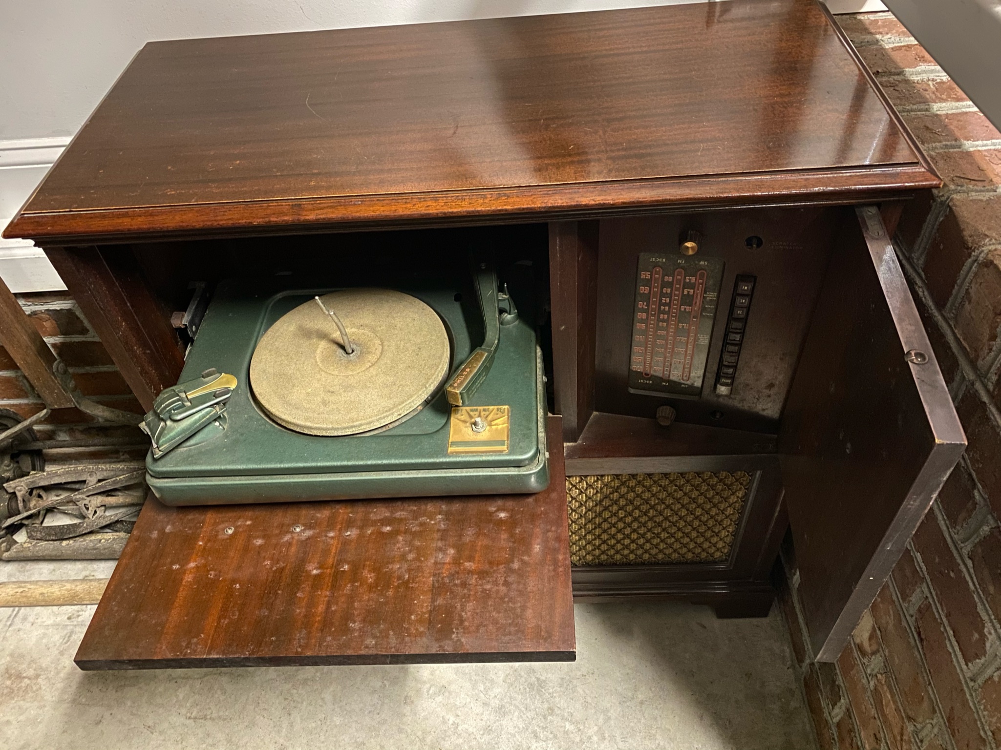

The record changer work was pretty much just cleaning, lubrication, and minor adjustments all per service manual. I am amazed at how good radio and record player sound. The scratch eliminator circuit actually works pretty well.
Cabinet work consisted of thorough cleaning, and sealing of all interior surfaces with shellac. I used Howard’s Restore-A-Finish and followed up with Howard’s Wax. I cleaned the door pulls with a vinegar/water solution (1:9). It’s not perfect but looks really good in my man cave.

For capacitors and resistors I sourced from JustRadios.com. I replaced paper capacitors with a mix of polypropylene and polyester film tubular axial capacitors. I used .5 watt carbon comp resistors except for a few cases where 1 watt were spec’d in the service manual. They can be identified by looking at part number ending in “4340.” There are a couple in the power supply section for voltage dropping and a couple of voltage dividers in the scratch eliminator circuit plus maybe a couple more here and there. I did not replace any mica caps.

I measured the dc resistance of the voice coil at 3.0 ohms. I used the rule of thumb to arrive at impedance of 3.75. I used the Hammond table for their 125D transformer: https://www.hammfg.com/electronics/trans...a-125e.pdf
I settled on lugs 3 and 5 for primary impedance between 7000 and 8800. Lugs 2 and 4 would yield 9000 to 11200. The 6V6 push-pull setup is good for maybe 10000 ohms. I also tried lugs 2 and 4 but really couldn’t tell any audible difference. Would be interested in comments on which way is better.

The M-4 record changer is in good shape. I cleaned, lubed,  and adjusted according to service manual. I had to get a needle for the magnetic cartridge. I found an Astatic N501-3s on eBay. It works fine. You might also find a viable replacement at thevoiceofmusic.com. They also will service idler wheels. I’ll probably have mine serviced before too long but it works pretty good even though the rubber looks a little dry.

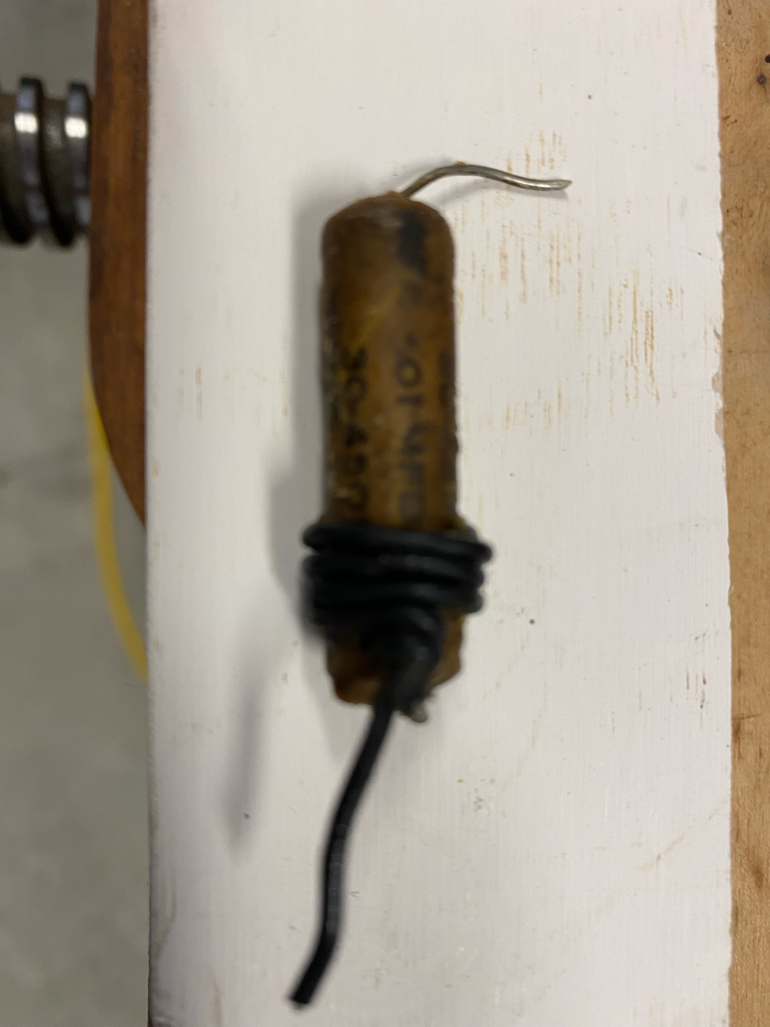

You will likely run into C306 condenser-choke assembly and may wonder what to do. It is a wave trap. There is an article about it here:https://www.philcorepairbench.com/i-f-wave-trap-and-special-capacitor/  I initially left it as is and radio performed fine. I replaced it with a new .01 mfd and noticed no difference. I believe simple replacement with a capacitor of similar value is the generally accepted practice. See photo attached.

I ran into the same question when restoring my 48-482; in that schematic the part is C404. I just stuffed a modern yellow .01MDF condenser inside the tube from the original condenser (one of the few times I have done this, I usually don't bother with trying to make everything look original, but in this case the diameter affects the inductance) and wrapped it five times with 24 gauge wire in series with one end of the condenser. It works fine, and provides the filtering intended by this part.
That’s a good idea mikethedruid! I still have that thing. I might do same. Did you test or notice any performance difference?
