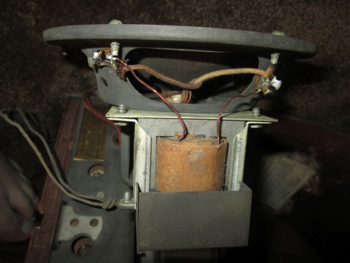

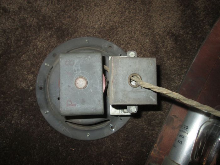

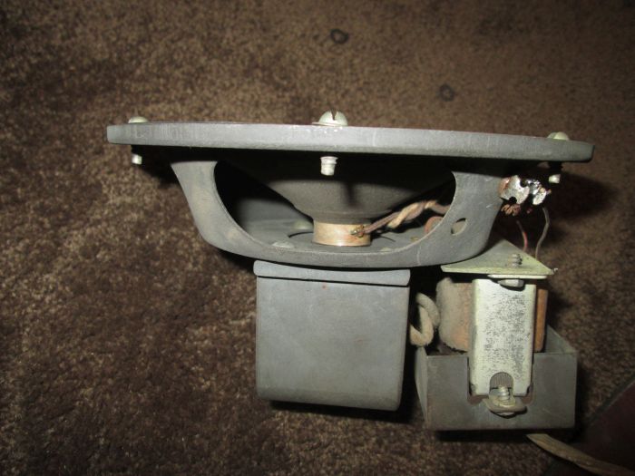

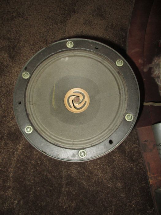

Anybody got a picture of an original speaker that went into a 1932 52b Philco Cathedral I assume it was a 5" Electrodynamic
Doubt whether I would get a working one to install
Hi Peter,
I don't have a 52b in my collection, but I believe that it uses the same style of speaker as the 80b.
Hi Peter and welcome
Here are some pic of the 6" speaker from a model 81. It's physical identical the one that was fitted to your set. You can go here: https://www.philcoradio.com/phorum/showt...hp?tid=215 Go to spkr zip and open the file. Within there is the specs most of the Philco speakers pre 1937 or so. What you looking for is a P2 speaker. It will tell you all about the speaker. It's also listed in the library but it's not as extensive.
