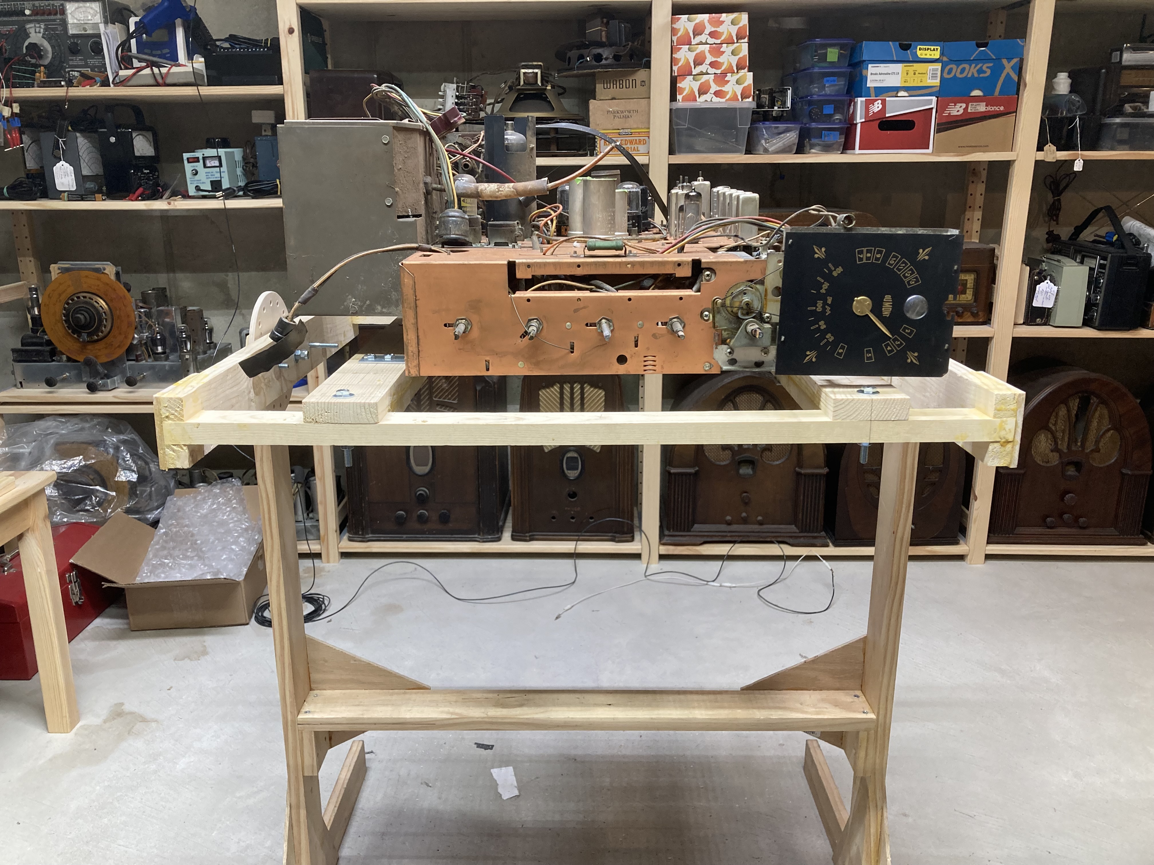

I've just finished my 37-116 (less grill cloth replacement) and am moving on to something a bit different, a DuMont RA-112 (first TV).
We had one when I was a little kid. It was in the basement and never worked. I think my mom gave it to the furnace repairman to get it out of the house, early 1960's.
I'd been looking for one for a while. Then this one literally came to me. A friend of a friend found it and the owner, who never got around to restoring it, offered to deliver it to me. It was nearly free... So now it's made it to the head of the queue, with lots to work on behind it.
The chassis' relatively huge, so I made a enlarged version of the stand I use for radios. It seems sturdy enough and gives me good access to the underside of the chassis. I have to check to see if the dial can wack the cross piece if I were to let it rotate it that far. That would be bad.
If anybody's had experience with one of these, is there anything special to "look out for"? The tuner is a bit "seized up" and looks mechanically complicated  . I figure this project will take a while  .

Very nice shop you have there- is that in your garage? Also can see you are a woodworker, shelves and the stand etc.

My shop is the corner of the basement under the family room. I have to confess, the shelves are from IKEA. But the chassis stand is my doing. I need a proper workbench. I currently use a 37 year old wooden table from when I first got out of school. It works.

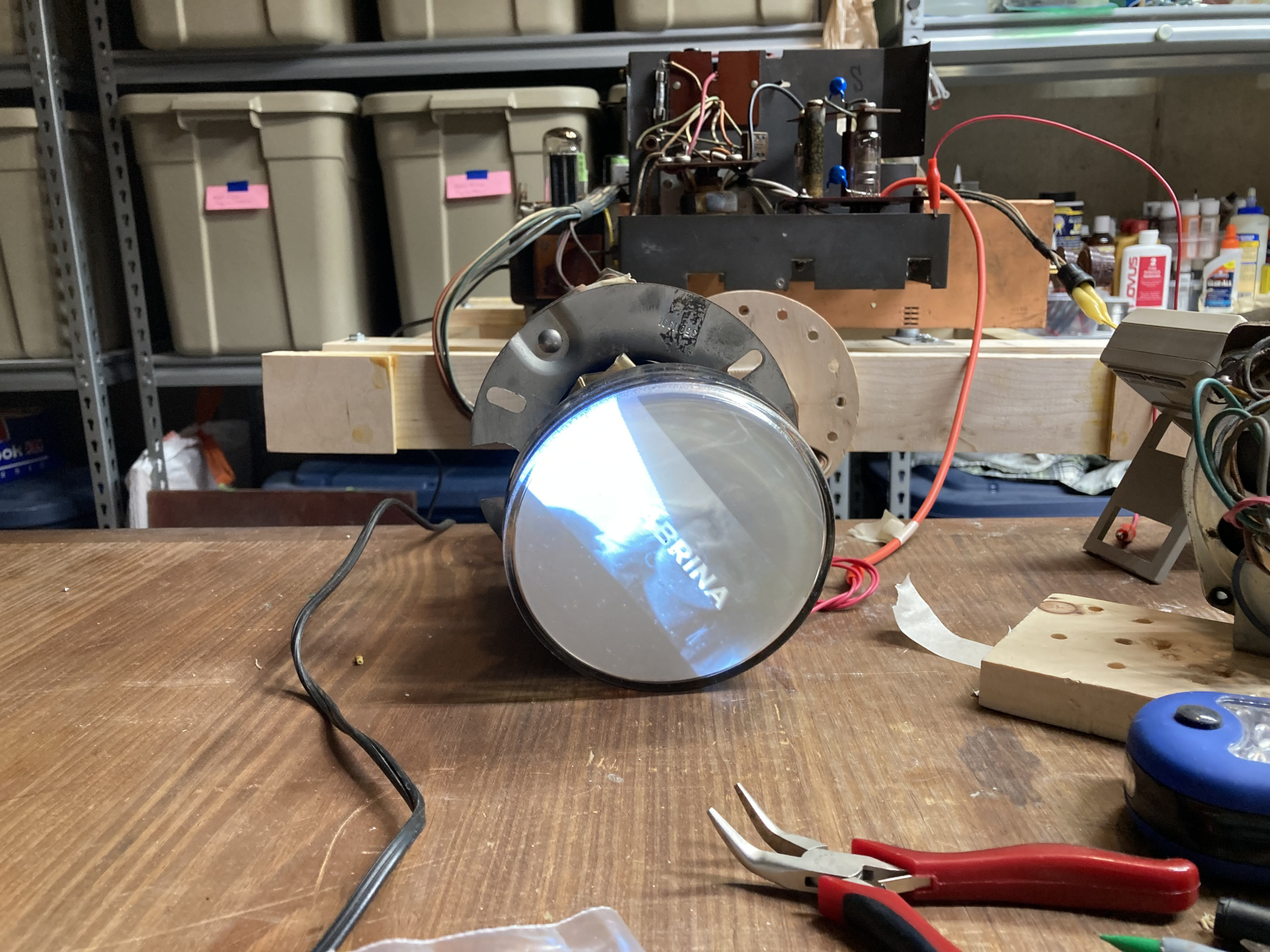

First power up as a TV (not just FM audio) and it works!
Tonight I powered it up with the HV enabled and with a test picture tube. After some tweaking there was a decent picture with not so decent sound. That needs looking into, even FM radio isn't great. But it was the first time I tested the whole thing. My TV knowledgeable friend was over for the spectacle for advice an moral. Fortunately nothing went terribly wrong. Failure is always an option, just not a good one.
It turns out the "snapping" was due to arcing when B+ was hit its peak on power up before dropping to its "normal" value. It went away after some lead dressing in the area. I still need to understand it a bit better and possibly place sleeving on some of the wires in the area.
I found the location of the arcing by turning off the lights and taking a video with my phone during powering up. It was pretty obvious without 300W of lighting beating down on it.
I still need a replacement speaker. I'll look for one at Kutztown in the morning...
It still needs some work, but it seems to be 90% there.
The biggest problem was finding a signal source. My VCR's were both messed up. I think they have belt problems. The DVD players don't have RF outputs. I ended up running a cable across the basement from our CTV splitter and using the one analog decoder box we have.
