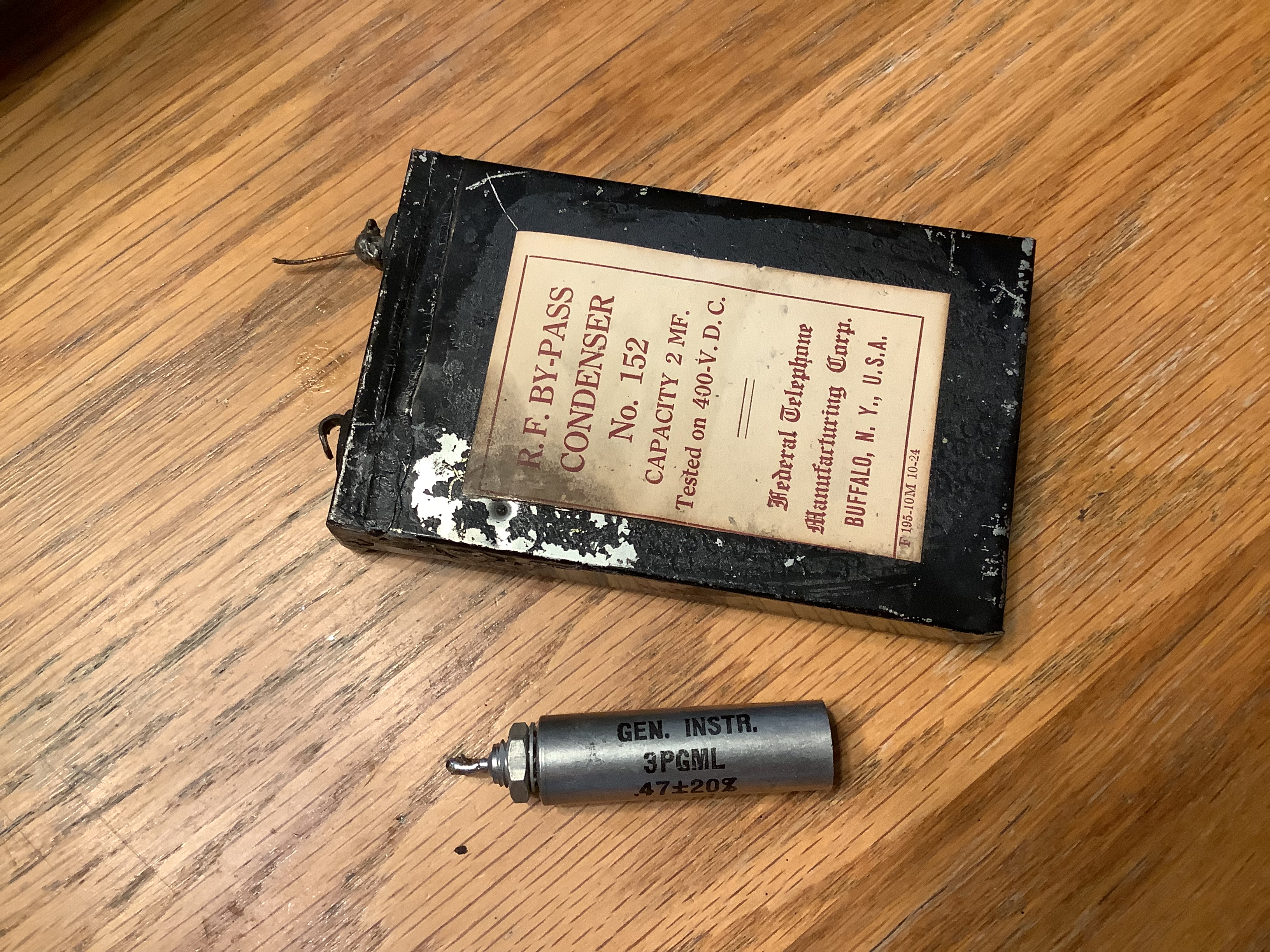

Hi Guys- I’d like to know something about these capacitors. Are either of them electrolytic? The older one has a 1924 date on the label. After replacing 4 of them in a kit built 1920s radio I’m getting reception but also a loud hum indicative of bad filter caps. Thoughts on either cap? Thanks. - Rob Q.
On the left seems to be electrolytic; on the right is probably a paper one.
Thanks. That’s what I was thinking. Another question for the Phorum is- “When did electrolytic caps come into general use?”.  ……….always one more question.
Electrolytic filter caps began appearing commercially in radios in the late 1920's. The first instance I am aware of was in a Crosley Bandbox from 1928. It had a large cylindrical cap labeled  "Mershon Condenser". It was a triple section liquid filled wet electrolytic.
Commonly, elecrolytics appeared more frequently in radios around 1931 or so, replacing the large paper filter cans.
I believe both of the caps in your photo are paper. The cylindrical one appears to be a hermetically sealed oil filled cap, given the capacitance is only .47 uF, and is a lot newer than the other.

Well, the radio hints that neither of them is electrolytic.
And yes, as Ron had noticed, 0.47uF is not a value for an electrolytic of this size anyway.

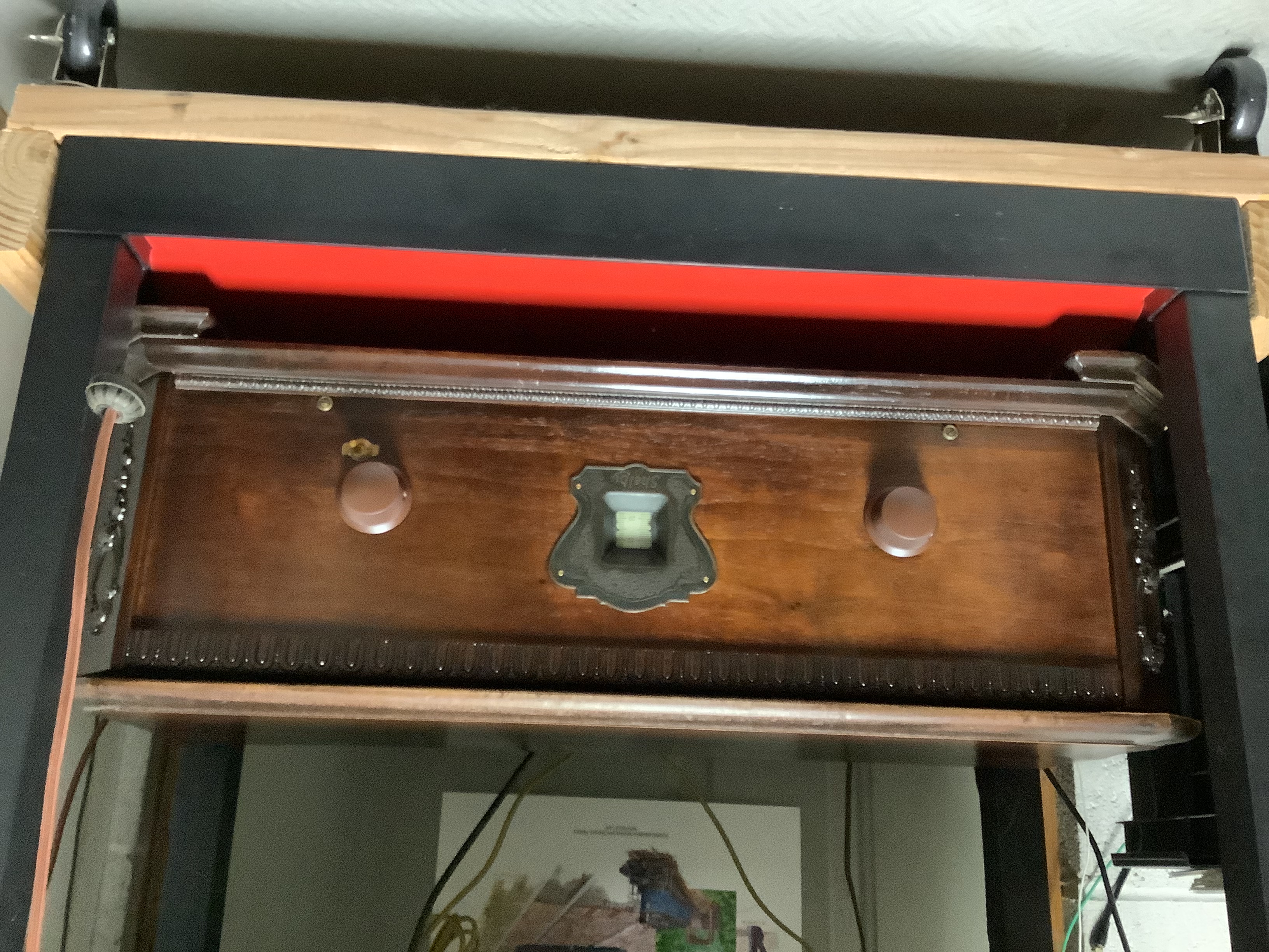

That is a nice looking radio. I wonder why anyone would want to throw it out? Icon_rolleyes Good save!
Ron
Perhaps Snoop Dogg or Ice T did not sound quite nice while listening to them on this radio......
Mike - Icon_lol Good point...
Hi Guys,
Thanks for the information. The radio was a mess when I got it. My wife did the cabinet restoration.
I’m assuming that the radio is a kit given the number of holes that were drilled and then redone. The escutcheon says Shelby but doesn’t match anything I’ve seen from them. There’s no other identification. The back of the cabinet had to be routed out before the rectifier tube would fit properly so I’m wondering if the radio was even finished. It’s quite heavy- about 50 lbs.

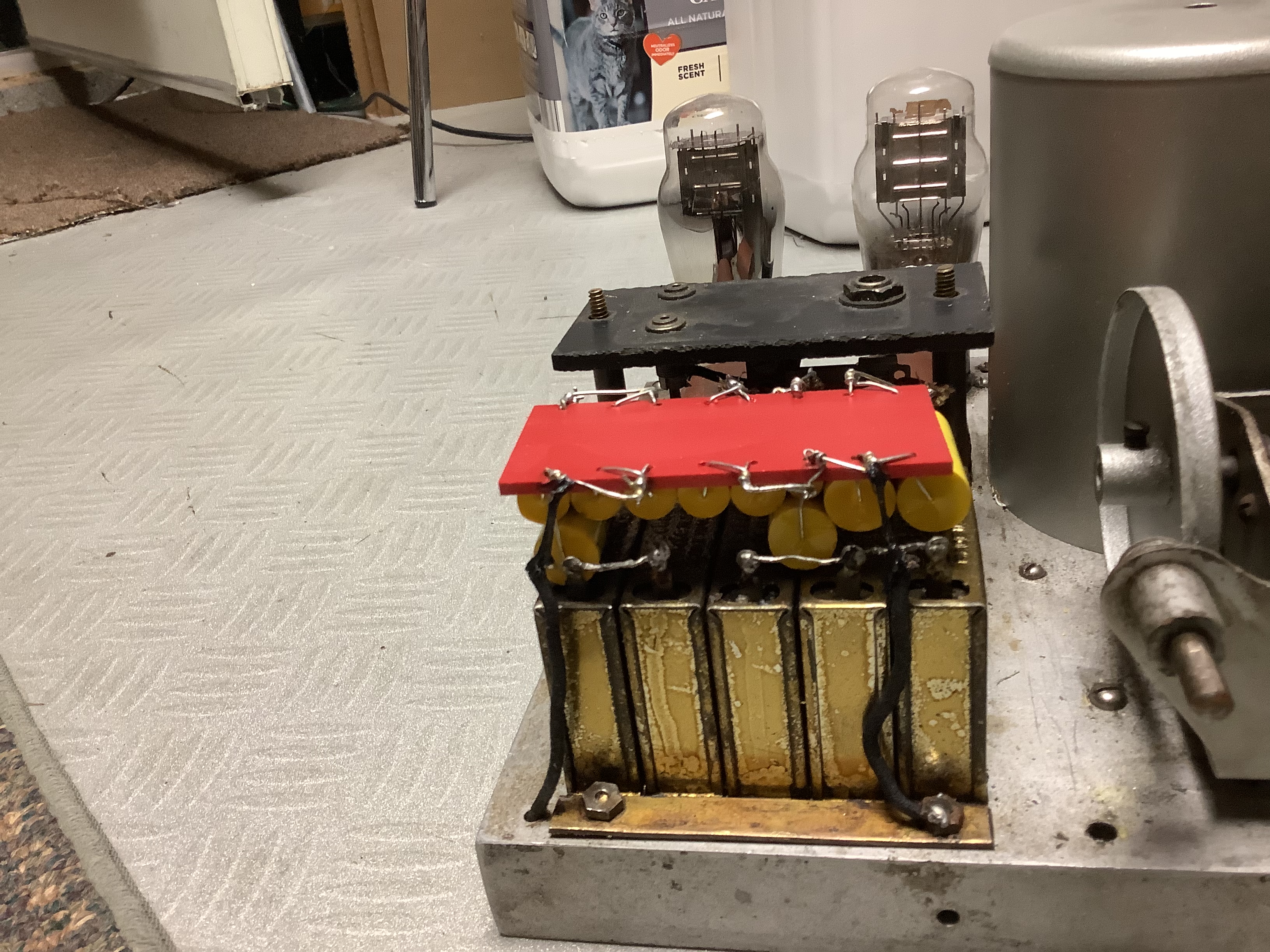

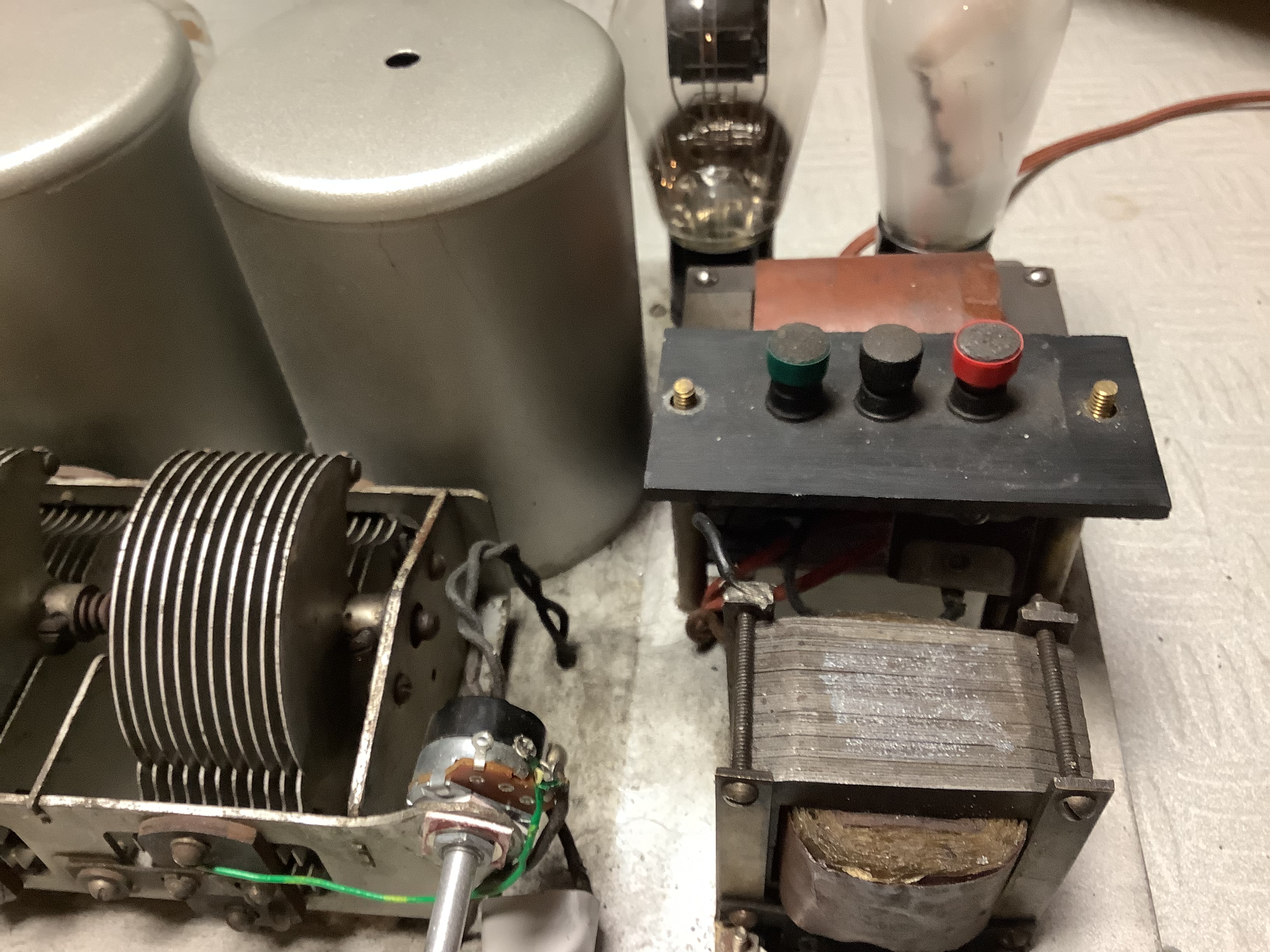

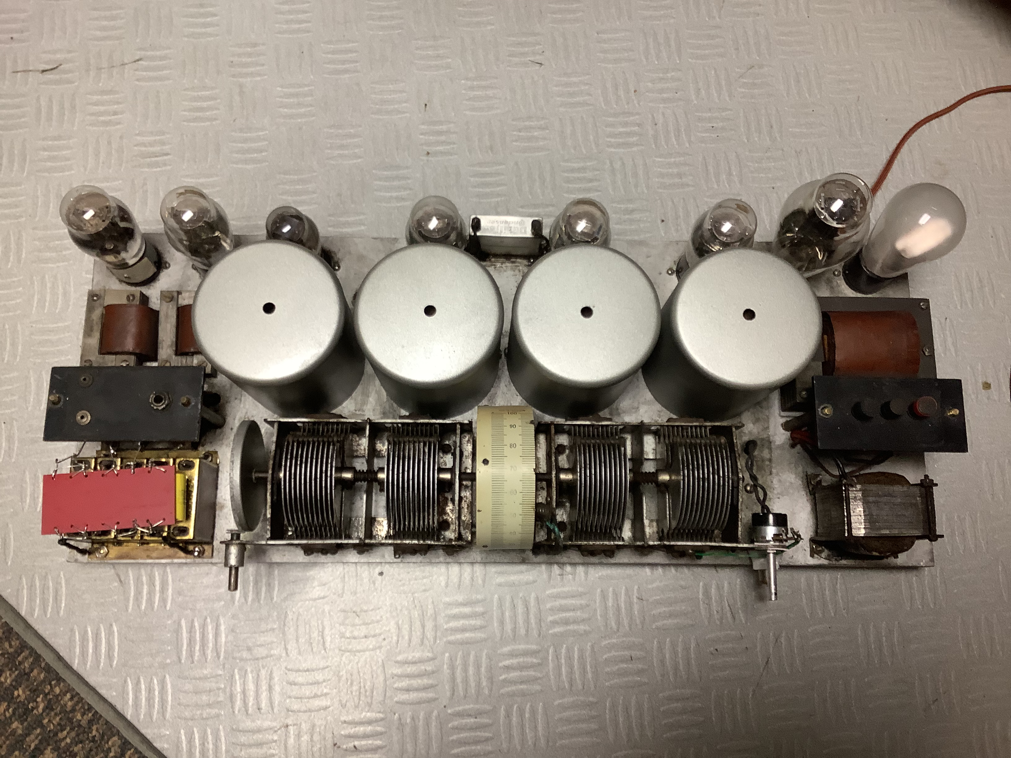

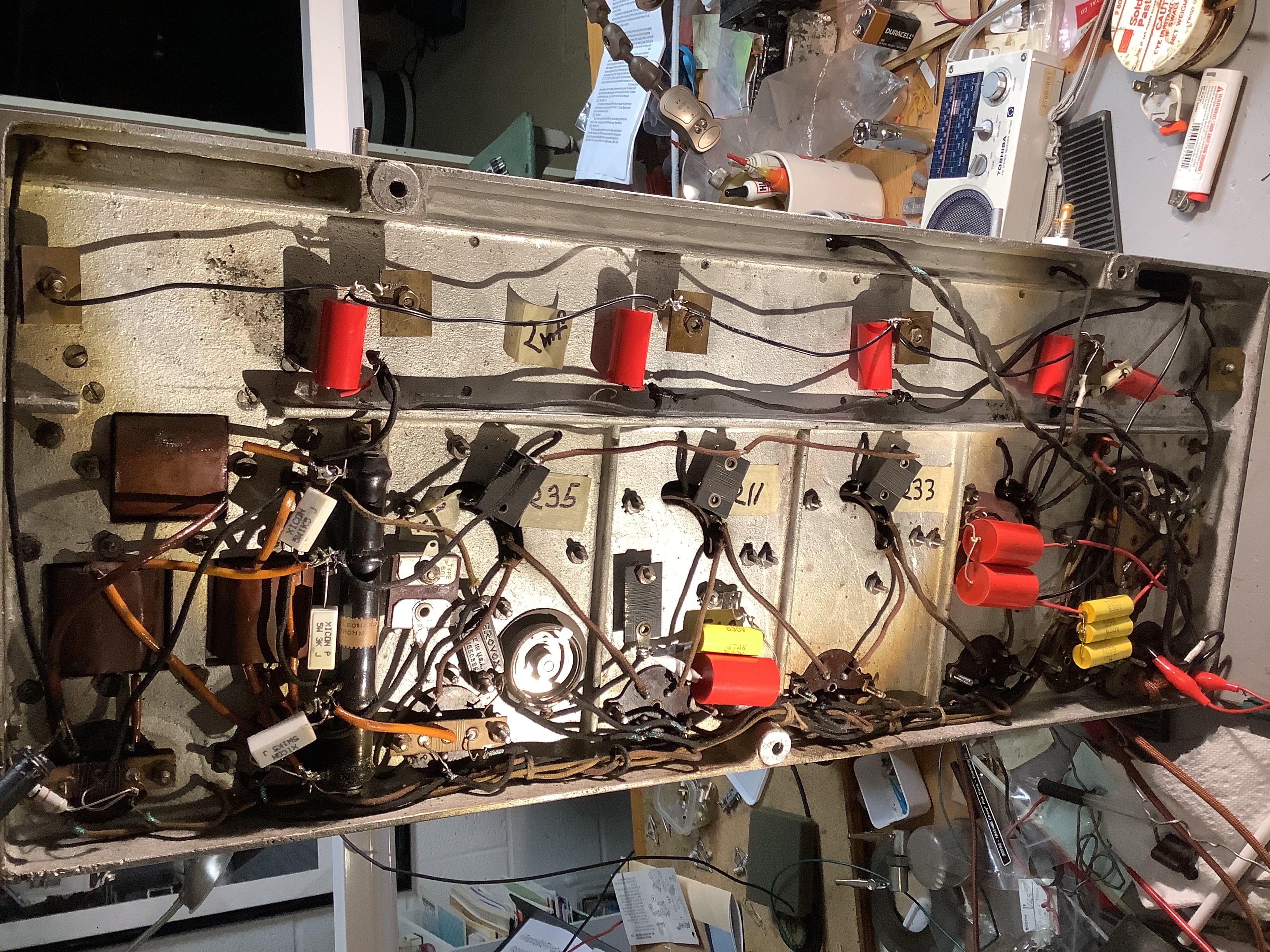

Rob, why don't you post some photos of the chassis and power supply. The set may have been built up from bits and pieces of different radios, some of which may be recognizable. 1920's radios are all pretty much alike in their basic circuitry.
Are you saying that the radio does not power up at all unless you connect an external ground? If so then something is definitely miswired in the AC line power supply wiring.
Here are the pictures. I kept the parts that were taken out so that the radio can be put back as found if desired.
Let's just say that I would not plug this radio in without thoroughly familiarizing myself with what it is and whether the repairs are valid.
Also if it is a transformer radio, it would bother me if it only worked with the plug one way.
The most benign guess is, they are using a "Line" as an antenna, same way they do in 86 Philco. Then plugging it in reverse connects the Antenna to the "Neutral" which is a GND.
But still, should be looked at.
