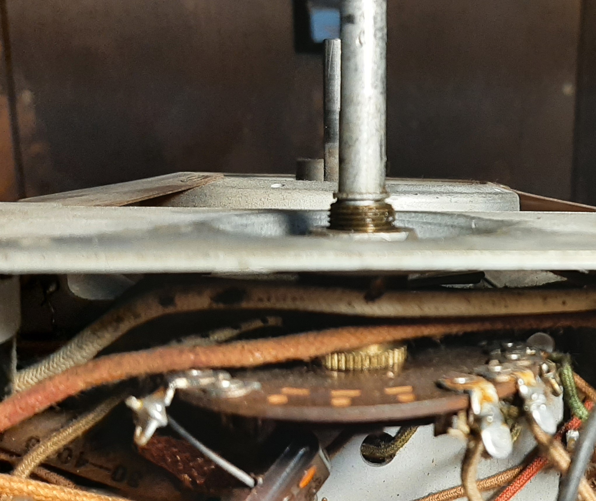

OK I've read a couple posts of what to do but no luck so far. Have tried PB Blaster, heat , and force with no luck. I just added some WD-40. A side problem is the when I put a wrench to the shaft the whole thing turns.   So I guess I will let it sit a little while longer and if the rust buster doesn't help the next step is to remove it.

 Does anyone have any recommendations? Bandswitch # 42-1046.

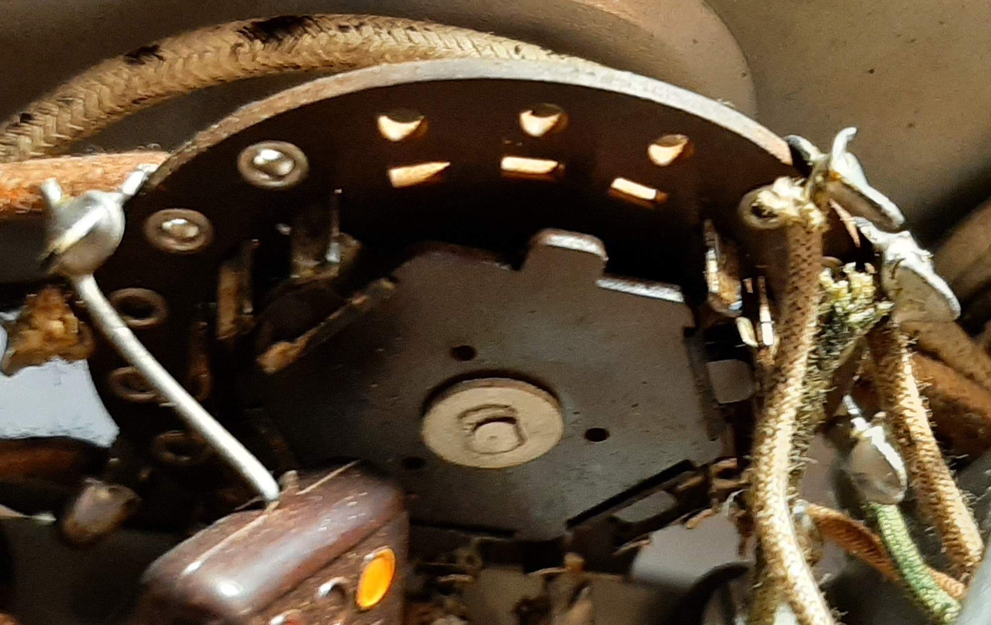

Mike,
Here are a couple pix of the bandswitch. I still have not broken it free and think I may have to try taking it apart , something I didn't want to do.
Mike,
Henry
Take your time apply a little WD-40 everyday for a week before trying to make it move. May take a week or three!.
