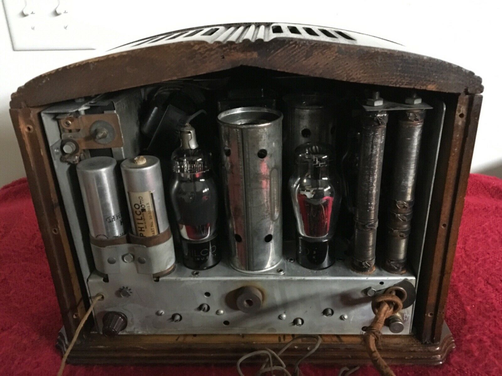

Thanks a lot for the advice RodB.  Yes, it does have a paper sleeve between the can and clamp (see attached pic). I’m going to re-stuff the can, so that raises another question. Since it is B - do I wire the negative (-) of the electrolytic to the can and the positive (+) to the terminal just like you would normally? I was planning on drilling a hole and attaching the negative side of the capacitor to the can with a screw and nut.
Thanks Mike. That looks really nice. I’ll try stuffing the original cans first. If that doesn’t work out, I’ll have a plan B now thanks to you.
You can wire the negatives to the can as long as you remount the can with a nonconductive sleeve where the old one was.
Thanks Rod. Appreciate the help.
