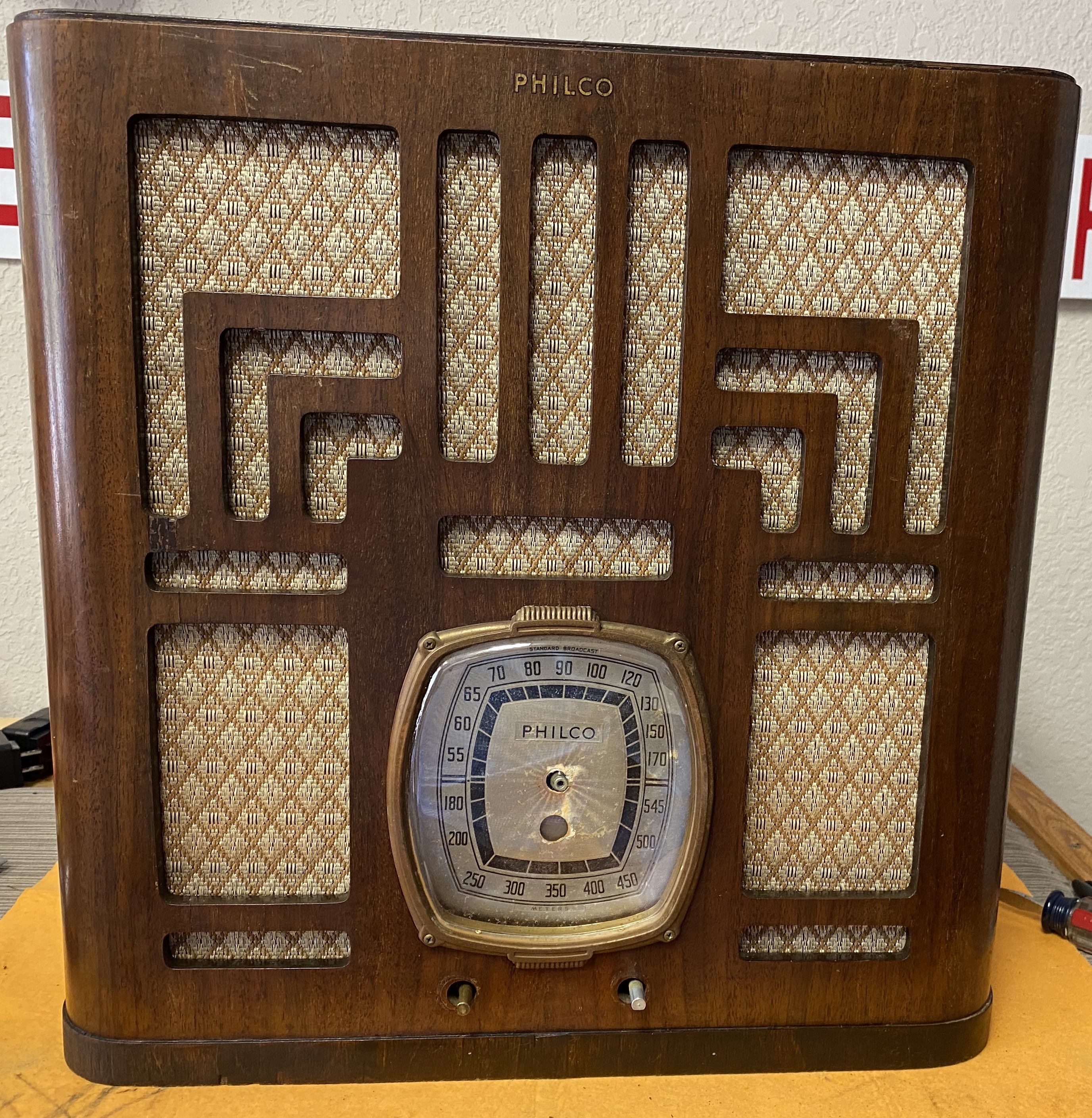

Ready to install new Grill Cloth, looking for suggestions on how to proceed and type of glue best to use.

Hi,
3M Super 77 Adhesive is what most of us use. You spray it on the backing board - never on the cloth itself - and wait a few minutes (the can will tell you how long) before sticking the cloth to the backing board.
You will have to work fast and very carefully, because if you do not place the cloth just right on the board, it will never look right.
If you have never used Super 77, you might practice with some pieces of old cloth and wood or fiber board first until you get a good "feel" for the proper technique.
And as Ron says, NEVER onto the cloth...ask me how I know. Lol!  Icon_redface

New Grill Cloth installed from Michael Katz.
Cabinet veneer re-glued where needed.
New dial bezel cover from Mark Palmquist.
Waiting on replacement dial from RadioDaze.
Waiting on parts for Battery Eliminator parts.
Missing one knob, any suggestions ?

New knobs as suggested from Gobs of Knobs.
Scratch built Battery eliminator power supply completed and tested today.
Waiting on new Dial Face from RadioDaze should be soon now.
Speaker needs some attention, but think it can be patched up OK.
Would not have attempted to bring this radio back to playing status, if not for the encouragement of this group.
Will soon see if it all works.

Today the old Philco 39-80 is once again working fairly well.
Battery Eliminator Power Supply working as hoped.
Rebuilding the chassis overlooked soldering the speaker output lead and one resistor missing, a bit of troubleshooting and the receiver came to life.
Next is to touch up the alignment and get everything back in the cabinet.
Radio will be placed on display in our small local museum.
