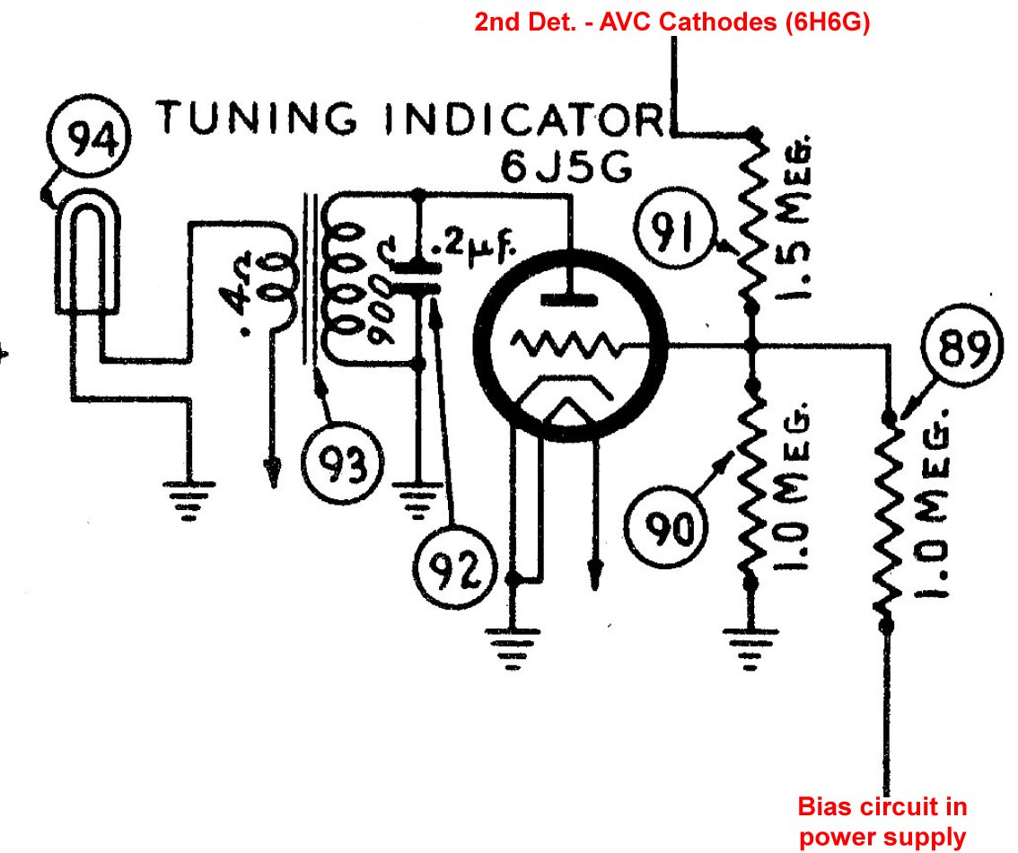

This radio has what Philco called a "Fotometer Visual Tuning Indicator." Here is a description of how it is supposed to work, from a 1939 Philco booklet which includes listings of their Philco-Tropic models:
Quote:Fotometer Tuning Indicator - Improved visual tuning. The brilliance of the light decreases as you more accurately tune your station. Effective, simple, quick. No looking for an indistinct line (Models 750 and 770).
Only, in my set, the brilliance of the light increases as a station is tuned in, rather than decreases
Is this a problem, or a mistake made by Philco in their description?
Have a look at the partial schematic below. You can get more detail by looking at the full schematic (link above), but this should also be helpful.
Ron
For the trimmer cap, mica Dk (or Er), the dielectric constant, is twice the one of plexiglas. Which might affect the resulting capacitance range. Also I am not sure, but many plastics are somewhat hygroscopic and in absorbing water they change their Er and so the capacitance could drift. Also it can exhibit temperature drift.
As for the fotometr, I think it should go darker as the radio tunes in, as it is much easier to tell the darkest from less dark, then the brightest from less bright, as at some point the eye will get saturated and will not discern the changes of brightness well.
As for the principle, I am not sure, but could it employ saturation of the transformer or is it a saturable reactor? When the AVC signal goes down, it lessens the current via the 6J5G tube, which de-saturate the core, increases the inductance and dims the lightbulb which it is in series with.
If the AVC level goes up, it increases the tube curremty, saturate the reactor and so lessens the inductance and the bulb gets brighter.

As for question #2, I guess I really should measure voltages at the 6H6G 2nd det-AVC tube cathodes, and at the "B-C" voltage divider where the circuit is also connected, find out what is going on, and report back later.

Hi Ron, since I don’t profess to be an engineer, I will give my theory as to how your tuning indicator works so here goes. Since the plate circuit of the 6J5 tuning indicator tube goes to ground through the secondary of transformer #93 instead of back to some B+ supply, that puts the tube in parallel with the secondary. As the station gets stronger when tuning, the grid goes more positive or less negative from the cathode of the 6H6 AVC tube, thus making the tube more of a load across the secondary. This will reflect back to the primary as a lower impedance in series with the indicator bulb #94. This in turn would allow more current through the bulb giving a brighter response to an increasing signal strength, exactly what you are experiencing. Others may disagree with my theory.

i see on the schematic that the plate of the one 6J5G tube for the indicator light is grounded thru a transformer. could that be right? the plates of the other 6J5G tubes are at 50-60V DC.
