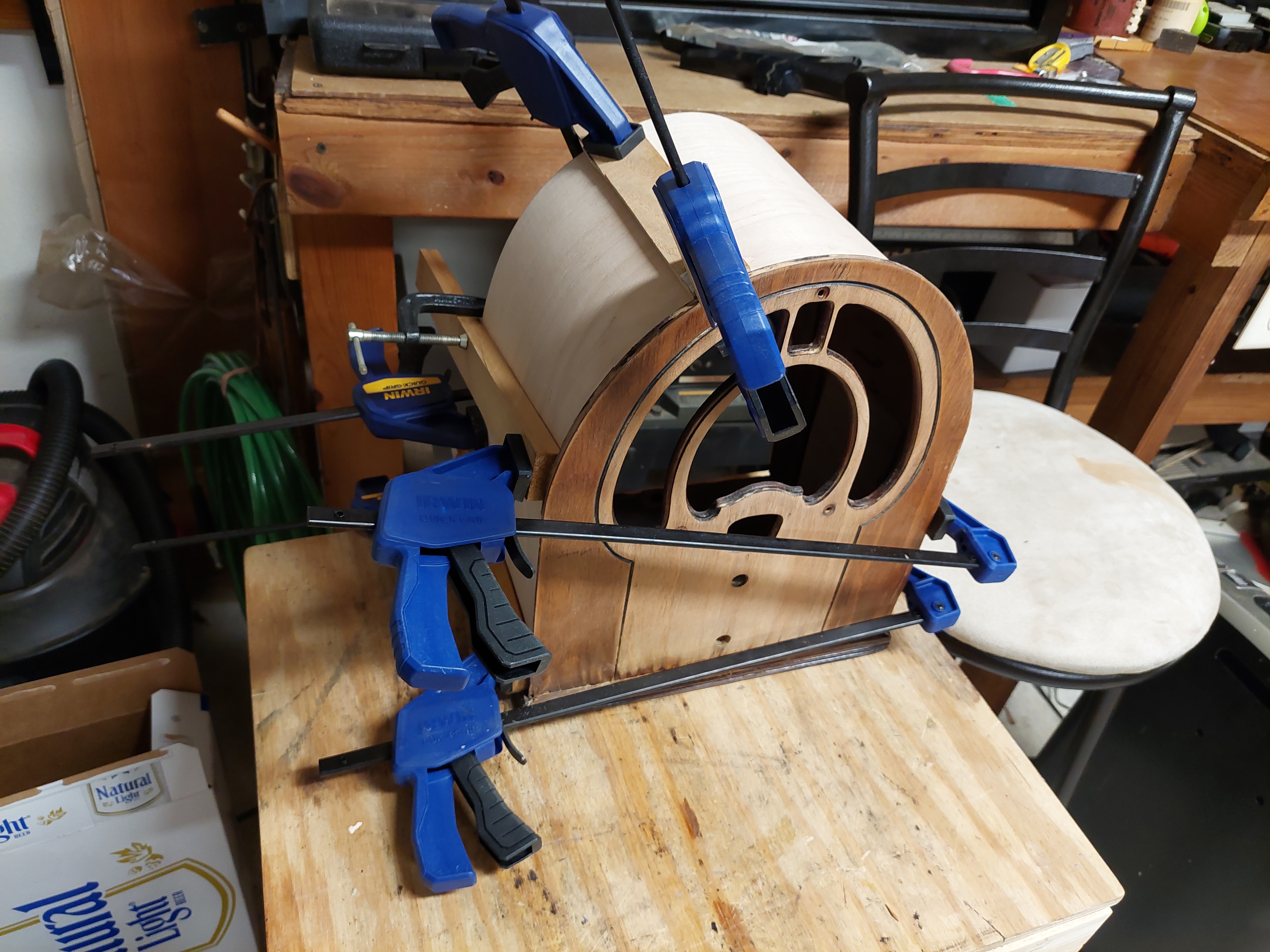

I am trying to restore this model 80 and have removed the veneer on the dome part due to many broken and missing sections.
Now the question I have what is the best way to get the bend in the veneer to glue it to the basic structure. I was thinking of soaking it in water then clamping it until it dries.
I would appreciate some advice on this.

I must have different veneer than Steve, who is the Master of all Masters. When I try to bend the veneer, it wants to crack that's why I thought of getting it wet. Also if I use Maple instead of Walnut veneer would it change the color of the medium brown walnut classic toner on the final coat?

Nobody would fault you for buying a "backed" veneer (easiest and cheapest is paperbacked). It's way easier to install, doesn't suffer the same resistance to bending or tendency to crack that raw veneer does and over the arch nobody will ever know what you used.

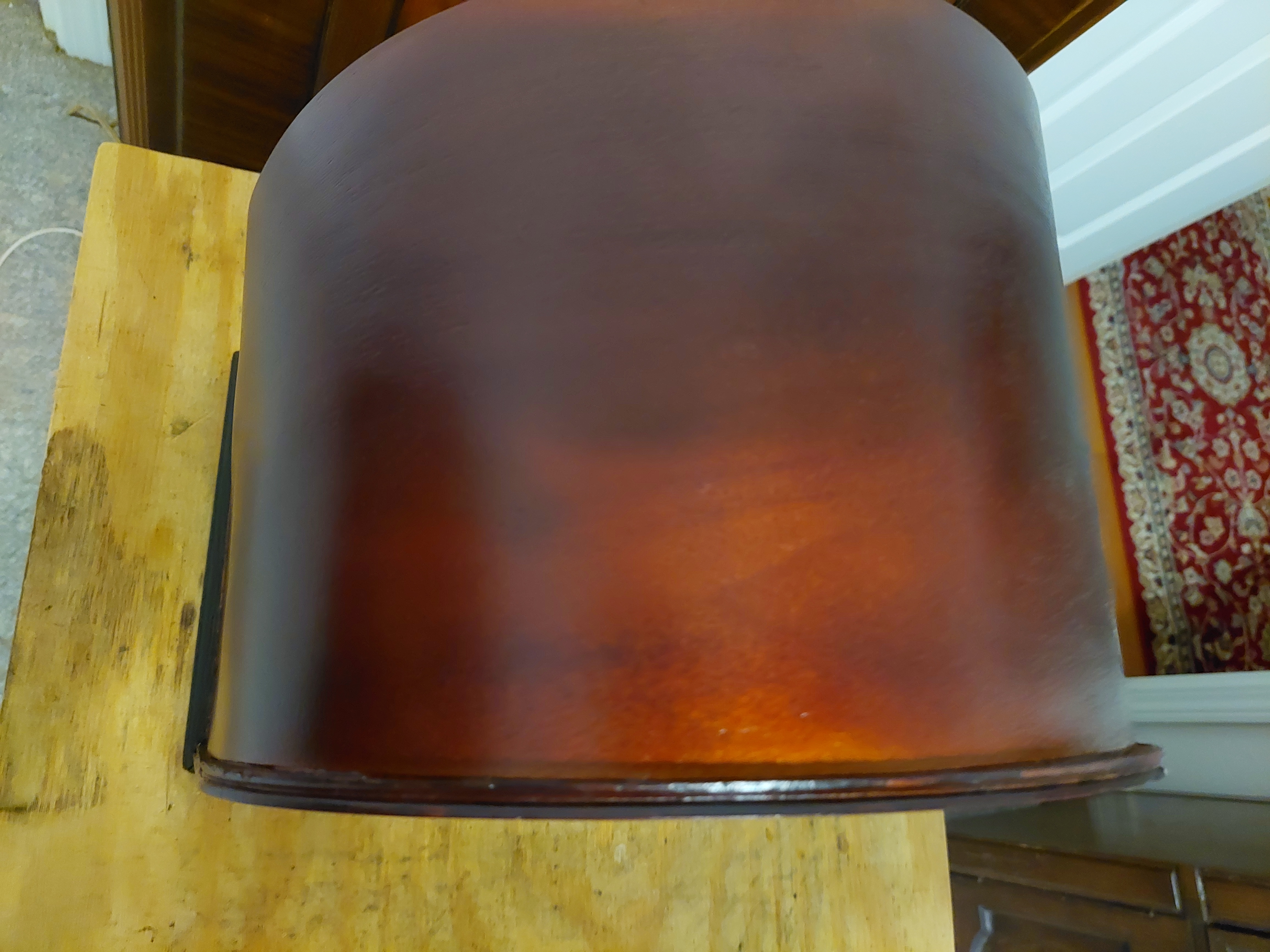

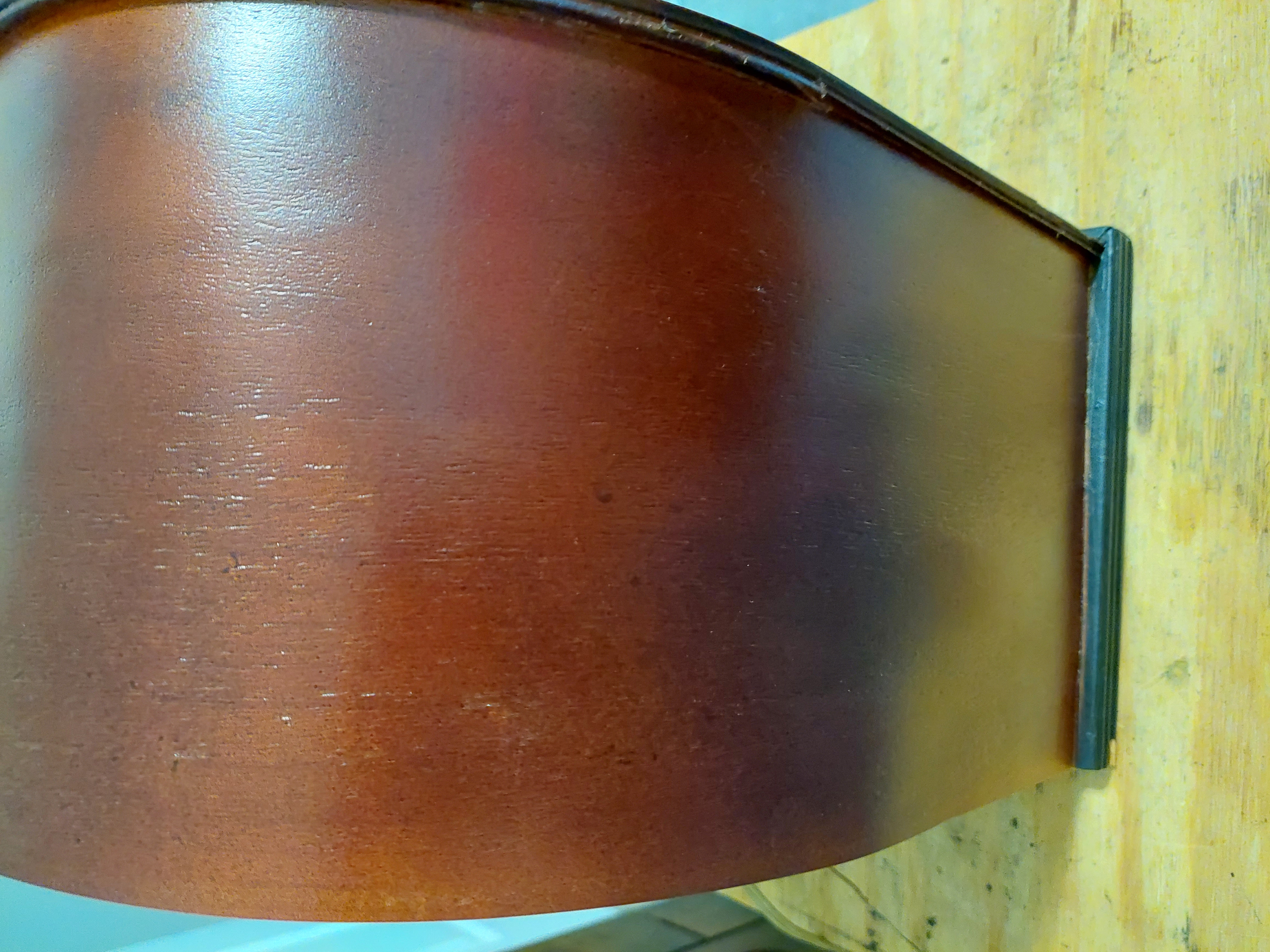

Considering what the "before" must have looked like, this is turning out nice!!

Thanks for the comment Mr Fixr55,
Should have taken some before pics, it was pretty bad. Still would like to learn how to replace front with new veneer and do the cut outs for the speaker and controls.
Thats the way it is for now.

that turned out really nice !

Nice job on the arch veneer - well done!
