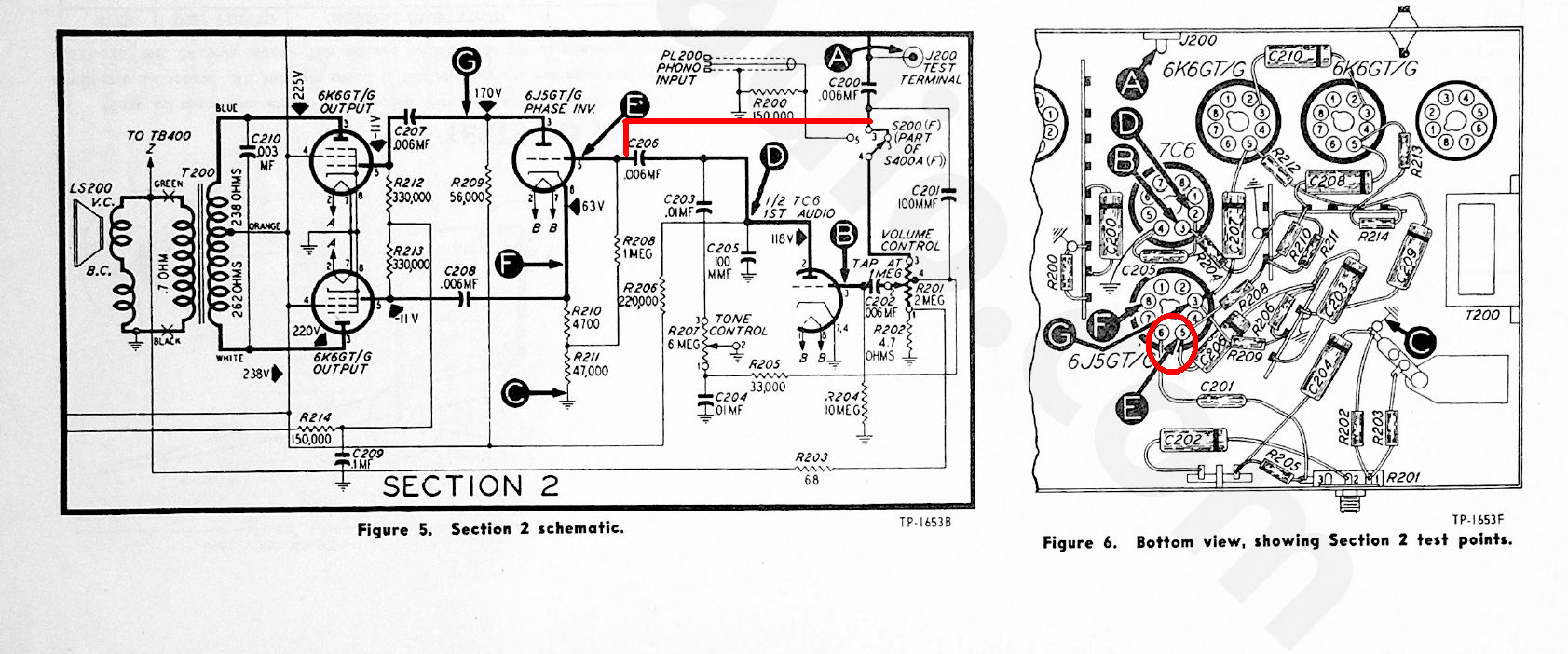

New member here. I'm in the process of restoring a Philco 46-1226, code 125. Unfortunately, the condition it came to me in prevented me from testing it prior to the work I did. I say that because I don't know if the issue I'm dealing with was preexisting or the result of something I did during my work. The issue? When listening to AM, increasing the volume (turning the knob clockwise) causes the output from the speaker to decrease. This doesn't happen when I inject a sine wave into the phono input, i.e. the volume works as you'd expect.
I've replaced all of the electrolytic and paper caps throughout the unit and also swapped out any grossly out-of-spec resistors. I tested all of the tubes with my B&K 550 and replaced any that tested weak. If anyone has any ideas or has encountered this oddity before, please weigh in.

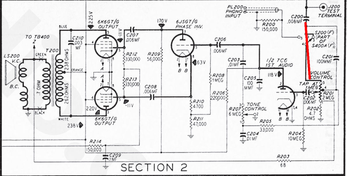

Check the Phono/AM switch. It is possible it does not make a good connection when in "Radio" position, and the signal goes through C26, in which case the volume pot would increase volume whgen going CCW.

Not much should come through C26 as it is 100 pF (0.00001 uF), unless it is shorted. Also, look at the tone control. Some weirdness could happen if the wiper no longer connects to the resistance track.
BTW, with the Push Pull 6K6s (Successor to the 41), Cathodyne Phase invertor and the negative feedback, this should be no slouch of a receiver.

I measured the resistance between the point after C200 (which is new) to the volume pot, and it was around .03 ohms. So I think that rules out the switch.
Somehow Rider's sch has different ref. designators on parts, but that's OK.
How about the volume pot, does it show correct end-to-end resistance and the wiper action? (I am driving at the top pot lug being disconnected due to a crack in the top pafrt of the rheostat).

Check the volume and tone control wiring and parts carefully. an open or wrong 4.7 ohm resistor between the pot and chassis ground may wreak havoc, as that is the injection point for negative (?) feedback.

It is a neg. feedback.
Inversion of the output winding or the plate wires of the primary of the output xfmr would also create an interesting behaviour.

The volume pot measures close to the spec'd 2 meg and tracks fine when rotating it while watching the needle of my Simpson 270. The 4.7 ohm and 68 ohm resistors connected to the one leg of the pot are ok.
The tone pot actually measures high compared to what it should be: 10 meg vs 6 meg. Granted, this is in circuit. The 33k resistor coming off of one leg is ok.

What would happen if: (top/right is used as from the sch point of view, not physical locations)
1. Fully disconnect C200 top pin from J200 test terminal (fully disconnect, the pin should be unsoldered).
2. Fully disconnect C202 right pin from the volume pot's wiper terminal.
3. Connect that C202 pin to the J200 Test terminal.
Does the volume become loud, as if at maximum volume? (be careful with local stations).

Figured it out. Turns out that when I replaced C206 I connected it to the lug for pin 6 of the 6J5GT, rather than pin 5. Lug 6 is unused for the tube, but acts as a tie point for where the radio signal goes to the bandswitch and C201 (part of the negative feedback?). I moved the C206 to pin 5 and correct volume operation was restored, and it was significantly louder than it had been before, which is no wonder.
