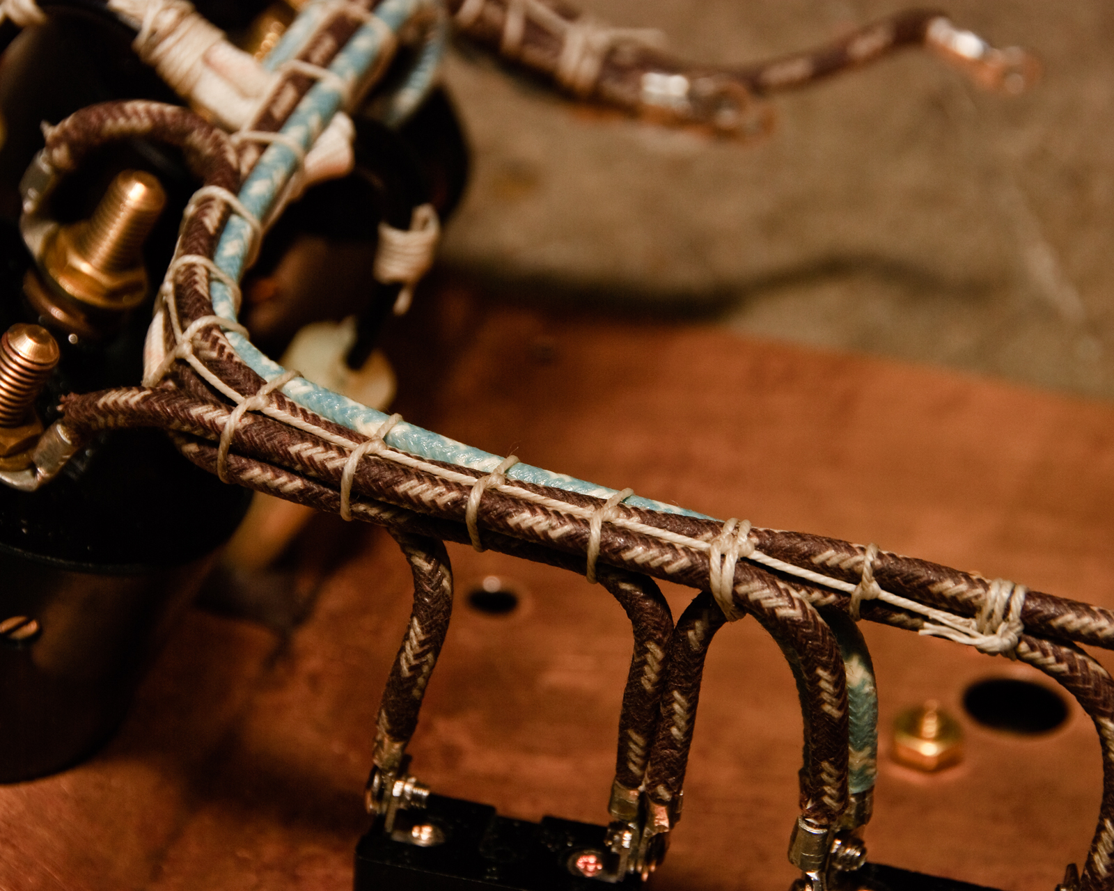

Ah, cable lacing:

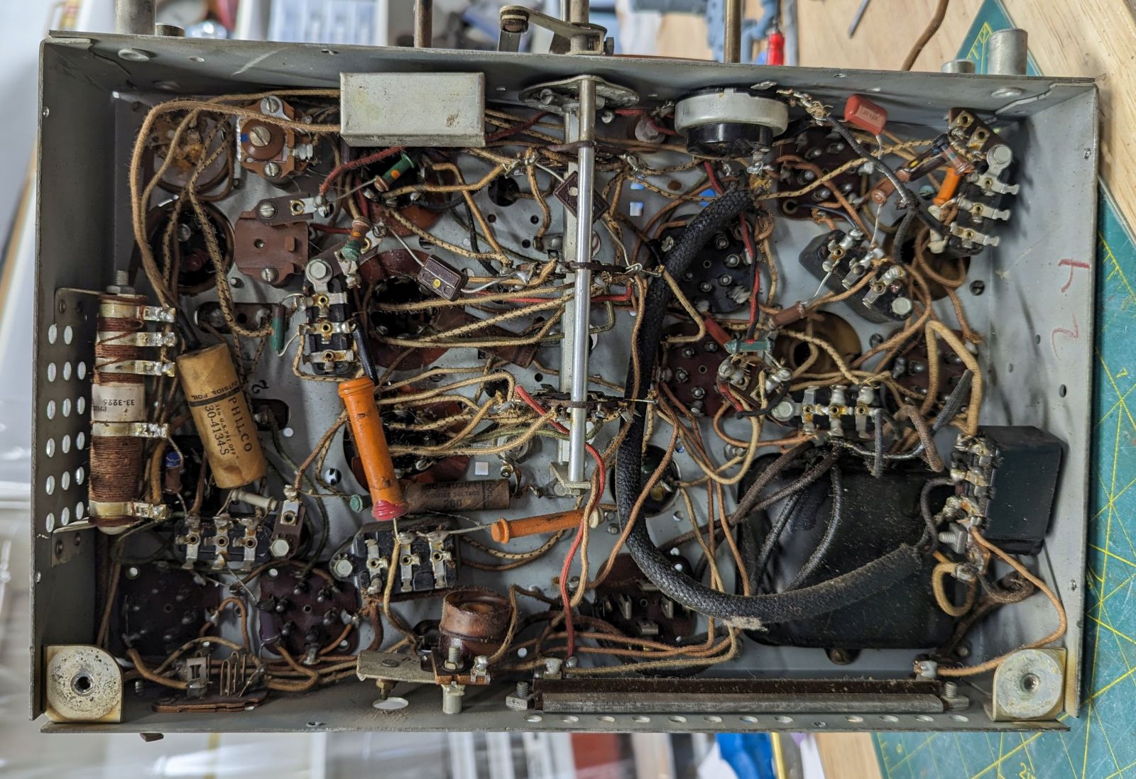

A rat's nest:
Simple answer ... if it ain't broke don't fix it, and don't re-route it from its' original placement. Address any frayed or rodent-chewed wiring only. Rerouting to a more 'pleasing' look can sometimes introduce signals that were originally routed to shield against. Cloth wire holds up well for its' years in most cases. Take care and BE HEALTHY! Gary

+1 what Gary said.
The shielded cable was put there in an effort to reduce the possibility of AC hum being introduced into the radio (chiefly, the audio) circuitry. And it was grounded only on one end because that was all that was needed - if it is grounded on one end, it is grounded through its entire length.
As to cloth covered wire with different color tracers (or, in your words, "ticked") - the answer is no, not in the size typically used in vintage radios (20 gauge).
Be careful trying to improve wiring! Look at a hallifcrafters S38A-S38E and see how they got the BFO.   https://philcoradio.com/phorum/showthrea...6#pid91506
At best you will not have problems.
Wires, especially carrying AC signals (most do) do not like long parallel runs. Point to point routing provides for shortest runs and in most cases criss-crossing ones, which is good for fighting off interference.
So....it's your radio, but the best you can possibloy do is to stick to the original, in every aspect possible.
