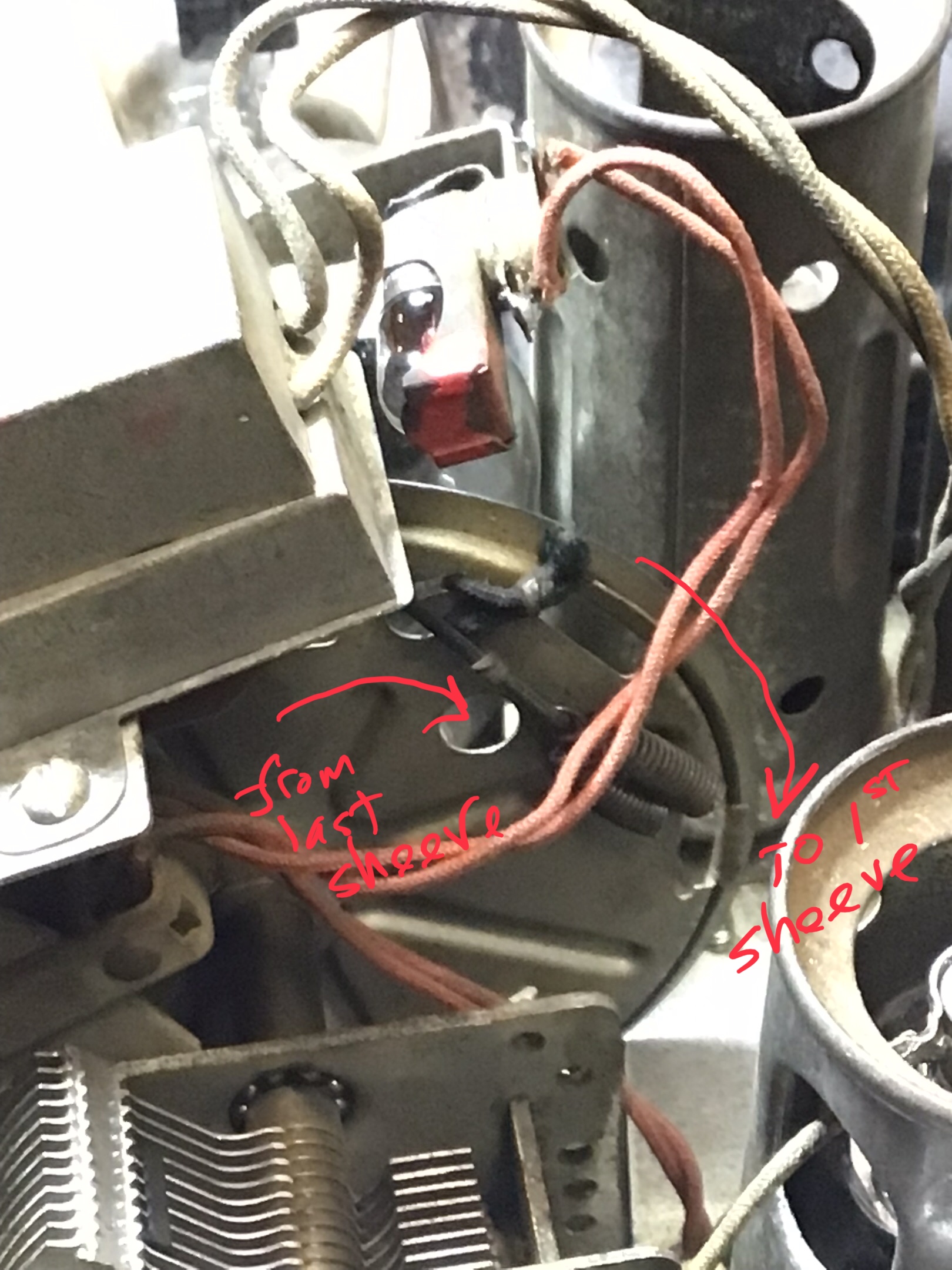

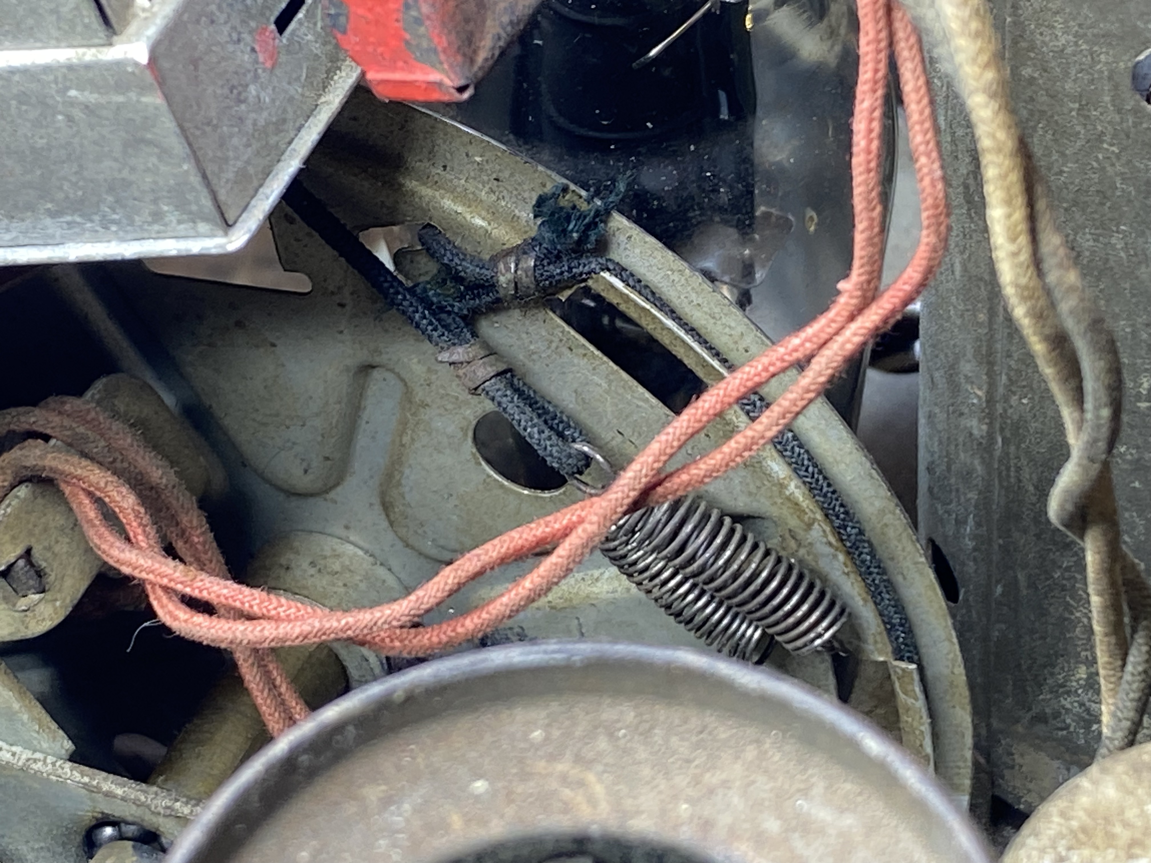

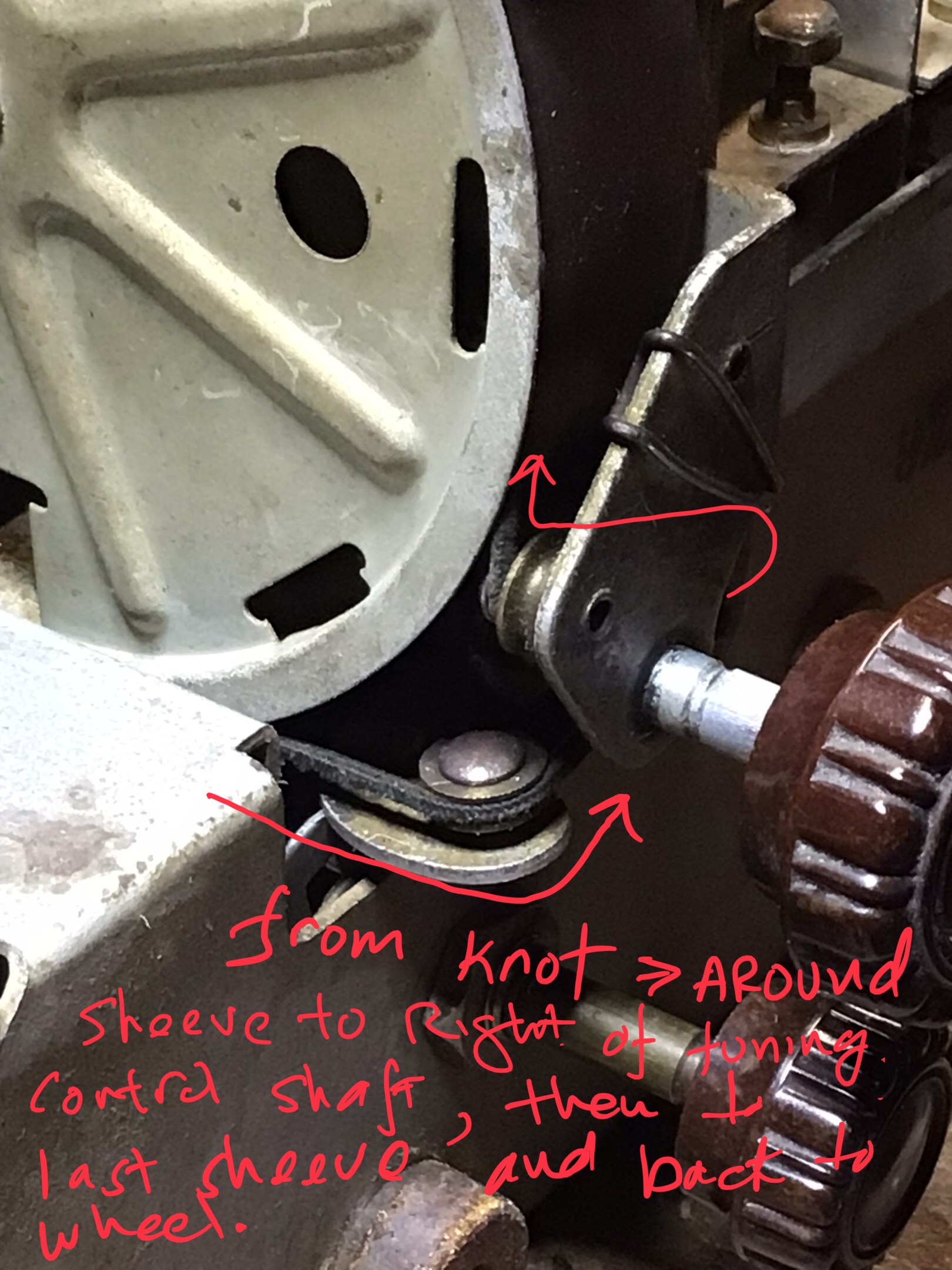

I don’t have a string diagram but recently finished work on a 29x, so might be able to help. If you look at the pics I’ve attached, you’ll see that the string starts with a knot tied onto a little tab on the tuning wheel, wraps around the wheel once then runs through a series of sheeves (pullies). There are a couple of them that I couldn’t get a shot of, but you should be able to see that the string heads back to the two springs attached to the wheel. It’s actually fairly intuitive if you study it a bit. It was easier for me as I had removed the entire tuning assembly for cleaning and took note of how the string ran (it was intact before I started). I had to hold the assembly in one hand as I strung the string through the sheeves. Don’t know if that makes things clearer or not. If you’re still confused, I can try to partially dismantle it and draw something that might make more sense.
Thank you so much for this!!!! I am going to study it and then I may have a couple of more questions if you don't mind. Does the dial string loop around the tuning dial shaft pully, does't seem to be enough tension to turn the dial when I turn the knob, but could be the way I strung it. I'll keep trying.

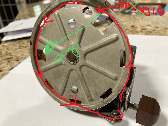

    I am attaching a picture of how I think the dial string goes based on your pics. Let me know if this looks right or not. Does it make any loops on any of the pulleys/sheeves? Did you have to adjust the spring tension on the tuning knob to prevent slippage?? Doesn't appear that there will be enough tension on the control knob to turn the dial wheel, but I will give it a try. Looks like there are two springs instead of one, where exactly are they attaching?
Thanks
        To get enough tension, the springs need to be stretched further. I’ve shown where the springs need to be on the pic you uploaded. Maybe this pic will help.
Actually as I look at this again, I think the springs need to go here…
