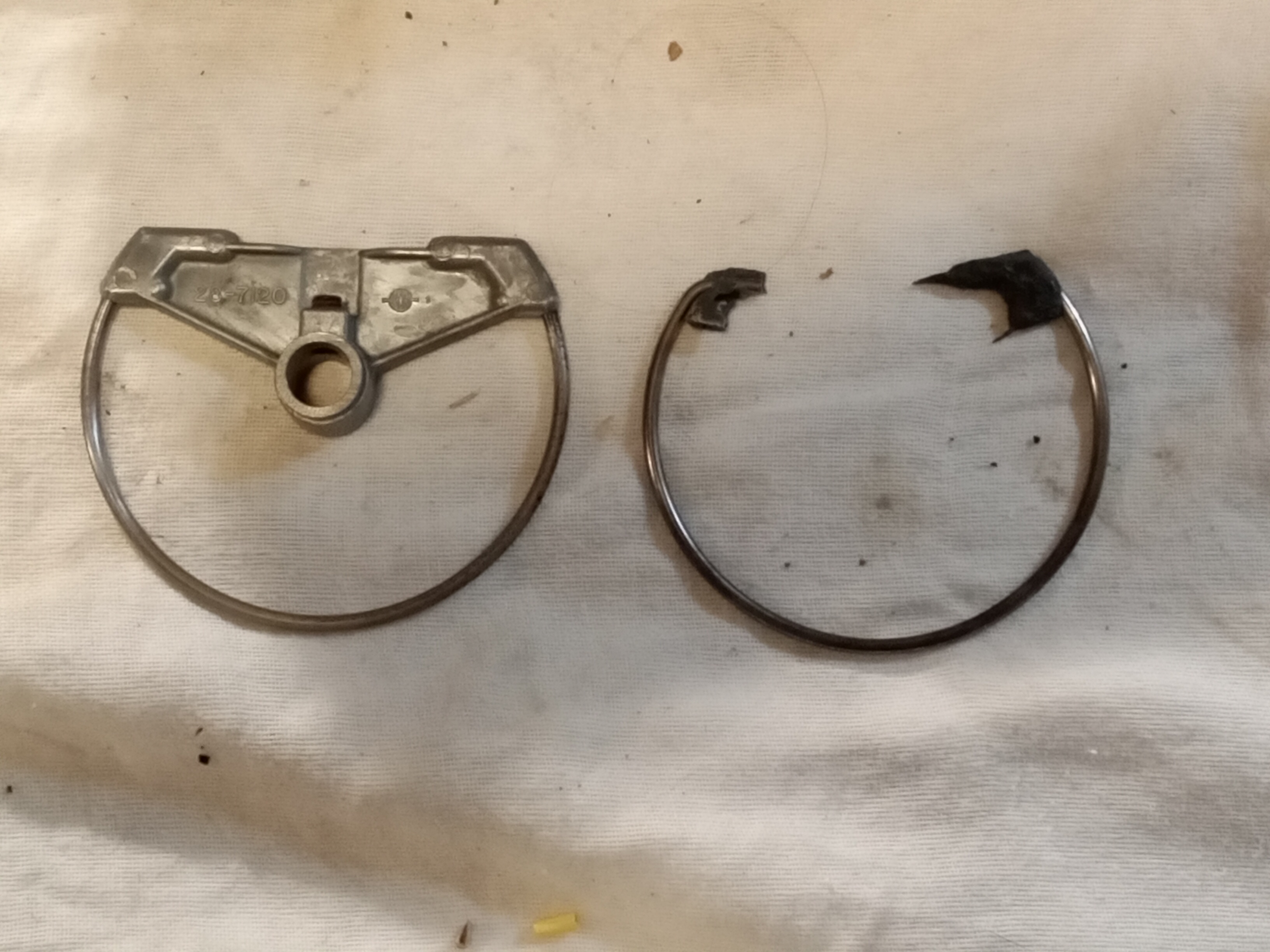

I'm in the process of cleaning a vernier dial assembly on my Philco 650 and decided to clean the brackets and metal dial hoop in the vinegar bath I was using to de-rust some metal pieces. The dial pieces were really gunked up. I was busy with company yesterday so I didn't get to looking at it till today. The vinegar had turned black. When I fished the parts out of the vinegar I discovered that the cross brace of the heavy wire hoop was gone. All that was left was the end pieces and part of the center hub. The remains were chalky and crumbling.
The one on the left is my spare, the right is the victim. There must have been a chemical reaction the vinegar had with the pot metal brace/hub that dissolved most of it. Just amazing. The hoop is nice and clean!

Much of the base metal in "pot" metal is zinc, oops.

Years ago was cleaning a fount from a very old Coleman lantern made of brass. The fount turned a nice copper color as the vinegar stripped the zinc out of the brass. Sprayed the lantern with clear coat looks nice, now a shelf Queen. Placed a note inside the burner cage saying danger do not light!

Well vinegar is an acid, so anything soaking it it should be monitored, pot metal (probably Zamak metal) has zinc, and aluminum in it so both can corrode. Brass is usually all right with vinegar, even if it ends up coppery I've found that it's often just on the surface and will polish off. The point being if you are not sure what vinegar, or any other acid will do to a part, don't drop the part in a bucket of it and leave it for days unless it's a lump of heavy cast iron.
