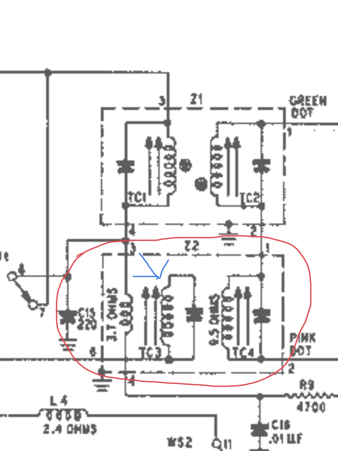

Hi all, nearly a year ago I was restoring this am/fm table top Philco radio given to me by a friend. Had it all done except I needed a speaker which I could never find. The real problem is it has SMD so with that I put it aside until now. I was able to find another exact model radio. I decided to restore this one too. It also has SMD so now I have a question. First of all, I know there is a difference between the 1st IF transformer and the 2nd, impedance wise. Input and out put transformers if you will. However, I have 2 no name AA5 radios for parts and both of them have the same part #s in their cans leading me to believe both transformers are identical, primaries and secondaries both ohm out the same between them. I hate to look for another Philco set of xformers as I feel they are prone to SMD. I would transplant the xformers from the parts sets to the Philco but for one caveat. The first AM IF transformer has 3 separate coils, a primary, secondary and some third coil not totally connected electrically, a design I’ve never seen before. Part # 32-4516A!
Just wondering if a regular 455kc input transformer would still work and what exactly does that middle coil do?

That tertiary winding is used to inductively couple the 455kc signal to the two slug tuned coils. This adds a bit of selectivity to the circuit. Can you use a transformer w/o it?? Sure. Just wire it like all the other IF transformers. Top of the pri to the plate of the mixer, bottom of the pri B+, top of sec control grid of 1st IF amp, bottom to avc line.

Thanks Terry, I figured it was some sort of tertiary thing going on especially since only one end is connected to anything. It just baffled me as to why make it that complicated when every other AM radio I’ve seen only has a primary and secondary! My only question now is why do the parts sets I have, different brands, have the same part # on input and output IFs. I would think they should be different!
