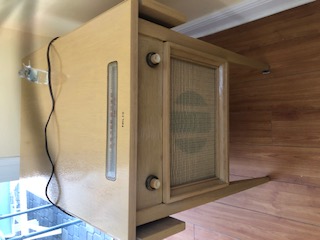

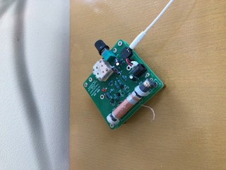

I have restored 2 of these (53-1750) Philco's. One of them recently stopped picking up AM radio stations - just a lot of buzzing throughout the tuning dial. I have a small AM transmitter (purchased on ebay) which I can plug into the headphone jack in my computer (or any audio source) and when placing the transmitter on the Philco, the Philco receives and plays the signal just fine at any frequency I choose.
I checked the continuity of the Philco antenna - seems good and even hooked up an auxillary AM antenna, still no stations. I've tested all the tubes, they're all good AND even swapped the tubes from the other Philco and still no stations, only buzzing. I've have not tried re-aligning it but why would the alignment have gone bad when it was fine?
I've checked all the connections in the radio, nothing loose, all caps are only a couple of years old, but maybe recap it again?? Not sure where to start looking for the issue in this thing. It does work with the AM transmitter (see photo) that should be giving me some clue as to the problem, but not sure what. Any ideas? Thnx,

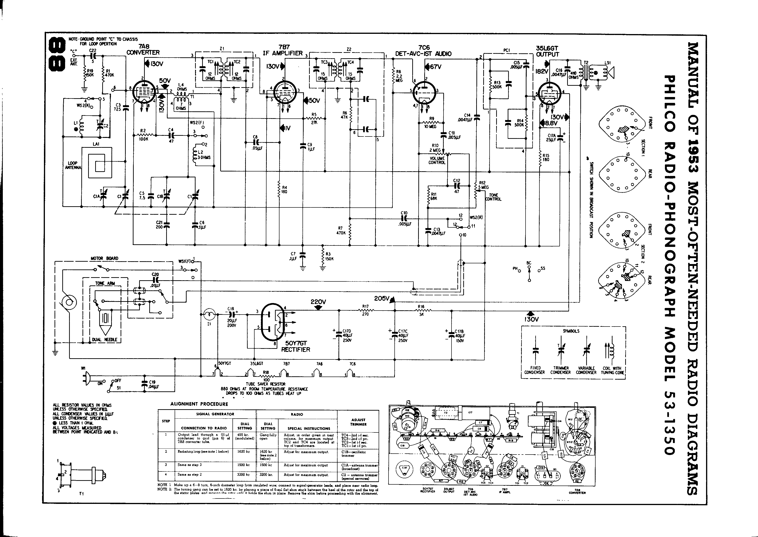

The schematic shows a cap, C19, 0.047 uF across the power line to filter power line noise. check / change this cap with a safety type.
The schematic shows a tunable LC network and switch (S2) in the input of the converter, ganged to another coil in the oscillator which serves as a wave trap (?). Try to set switch so that this network is out of the circuit.
Check / change C3, the 725pF cap that connects the loop antenna to the converter input. It is likely mica. They usually do not fail, but very occasionally, they do.

The original Philco service information for this model is available on this site in the Philco Library. Use the Philco Service Index to find it.

MrFixr55 - yes, other am radios are able to pickup the stations no problem. When tuned to the AM transmitter, there is no background noise and when I turn off the AM transmitter, yes there is buzzing. The caps you mention are only a couple of years old and I had already replaced the original mica cap but I'll replace the caps you mentioned anyway, we'll see what happens. The AM transmitter can be set to any AM frequency and the Philco is able to pickup up any frequency I set it to. The tune dial on the Philco seems to be accurate with the frequency being transmitted.
DaleHCook - I do have the schematic for it - thanks.
David - The Philco was set to radio not phono. The AM transmitter, as you can see in the photo, sits on top of the Philco - just inches from the antenna underneath. It's a very weak AM transmitter but the radio seems to pick it up just fine.
