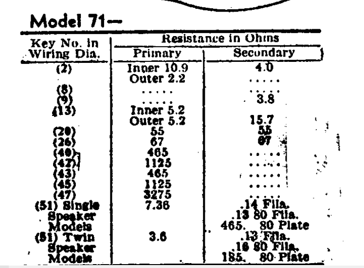

The chart for the reference ohms resistances list the following:
Primary (inner) : 5.2 ohms
Primary (outer) : 5.2 ohms
Secondary (outer) : 15.7 ohms

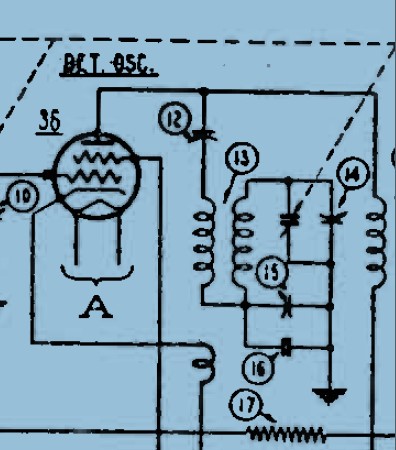

I'm thinking the open circuit is the secondary if I'm reading the schematic correctly.
Question: Which coil should I attempt to rewind and can someone tell me how to find the beginning and the end connections of such coil ?

Screenshot of Philco 71 Oscillator Coil (P/N 13) from Rider's

Philco Model 71 Transformer/Coil Resistance Ohms Data

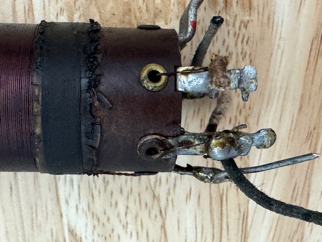

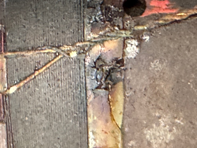

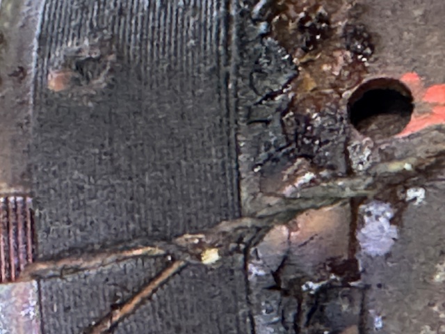

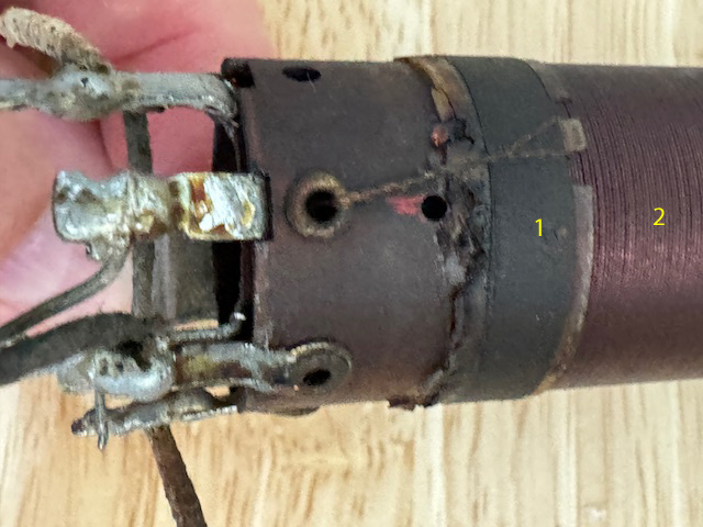

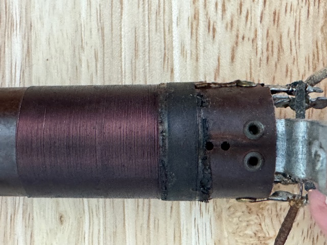

Here are some more close-ups of the Lug 5 vicinity. Appears to be a burnt out spot on the lower winding. Also, you can see it appears to have three strands of magnet wire descending to the lug. Is the lower band considered the "tickler" and the windings directly beneath that the secondary winding ? I have not been able to find a diagram to differentiate primary vs secondary, tickler, etc. , inner vs outer core.

That is the “burnt” look is the Celluloid decomposing.
Once the coil/form are cleaned with solvent the condition of the coil can be examined any tiny green spots are nitric acid corrosion. The coil will have to be rewound.
Mineral spirits or alcohol.
Chas
Pliny the younger

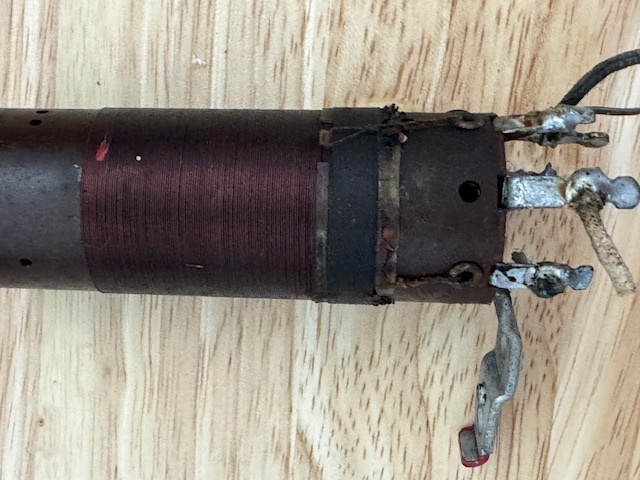

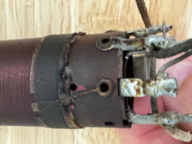

May I ask if anyone can identify the components numbered 1 and 2 in the photo. I'm trying to determine the order of removal and replacement of the coil windings.
Thank you
Why remove the 2?

My guess is that the 3 to 5 is the secondary and it is open according to my readings but I do not actually know which of these is the secondary winding. Haven't been able to see any diagrams as to which is which. Is the small band (#1) the secondary winding ?
In RF interrstage transformers the small one is typically the plate load, that is the primary.
