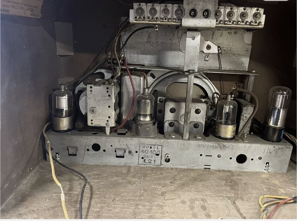

I picked this up today. A 1940 battery operated farm radio. Aside from the schematic I haven’t been able to find very much about it.  It was only $20 or so plus shipping.
Do you have the three pages with 40-100 service information from the Philco 1940 RMS Year Book)?
I only have page 43 with the schematic and parts list which I found in the library here.
You should also have p. 9 (instructions for setting push buttons) and p. 40 (alignment).

Unless attacked by mice or other vermin, and unless wired with rubber insulated wire, these sets are rather easy to fix, as almost no heat was generated in these sets. All tubes are easily available on eBuy. The non-electrolytic caps and resistors are likely good, but caps should be replaced anyway. It seems strange that electrolytic filter caps exist in sets that are battery powered, but replace them. The radio is unstable without them.
Unfortunately, the schematic does not identify what color power leads go to what. However, as the schematic shows:
A- goes directly to chassis ground.
B- goes to the junction between R17 and R18
B+ goes through the switch to the junction of C22, the output transformer (20) and B+ distribution.
A+ goes through the switch to the filaments of the 4 tubes.
The only downside of these sets other than the need to power them, is the fact that the output power is about 10-20% of the output power of the common AA5 set and fidelity suffers. However, sensitivity is similar to AC-DC AA5 sets.
Thanks. This is all really helpful. It’s only the 2nd farm radio I’ve found - I think the other is some 1930s Firestone Air Chief or western auto model. I’ll have to dig it out of storage - I worked on it for a while but I had an issue finding a tube.
Have had a few and serviced a few this is what I've found. Battery cable and ant/gnd wire the rubber will be flaking off badly. There's a small value e cap across the 90 line. It's there to keep the b+ clean. I've found some that are open. Best off to replace as if it's leaky it will drain your b batteries.
Set is silent. Chances are the opt pri is open. This is problematic as Philco decided to use an output tube that has a pretty high plate load resistance 25K I think. At 20 or 25K they are difficult to find a small affordable matching transformer. There are other tubes w/the same pin out and a lower load and will make more audio. At 10K or lower you have a lot more choices. I think the 1A5 makes abt 100mw at 25K and the 1C5 makes 260mw at 8k.
If the volume control is noisy try to save it the best you can. They are expensive to replace because of the dual switch on the back.
Even though the output power seems rather punny with 1A5 and a quiet room it's not bad. With 1C5 twice as good but it does run the batteries down a little quicker.
