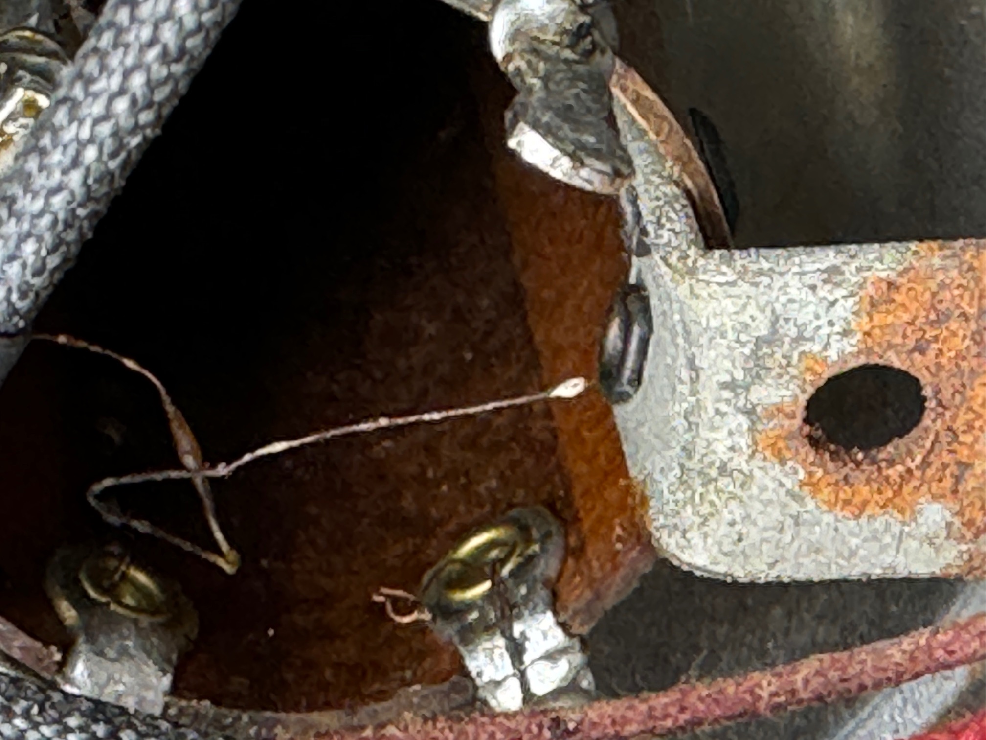

If stations only come in while touching the grid cap of the RF tube, that is a pretty sure sign the antenna transformer has an open winding. On to the filament voltages. Be sure to use the AC scale on your meter, read from filament pin to filament pin. not filament to chassis ground. Last, the plate voltage of the 1st audio is probably OK. The plate is supplied through a couple of high value resistors, your modern meter does not load the circuit as much as the meters used back in the day, giving a higher reading.

Steve, I have included a photo of the antenna coil, and I believe you are correct about an open winding. It looks as though a wire has broken loose. It also looks like a bit of solder on the end of one wire. Maybe this was an attempt to repair it earlier.
