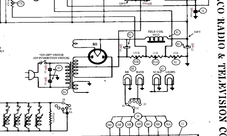

Restoring a 41-295.  Every schematic I've seen has an 80 rectifier tube and the electrolytics in the pi filter are 18uF and 25uF.  However, the specimen I have has a 5Z3 rectifier tube and the filter electrolytics are 30uF and 12uF, which appear to be the original caps.  Is this a legitimate variation, or should I go back to the 80 tube to help preserve the transformer?  And any recommendations on which set of electrolytic filter caps to use?
If the 5Z3 and filters look original, I'd say stay with those components and values.The discrepancy may be the result of a production line change. The other possibility is difference between console and table versions of the chassis.
I would the 80 less strain on power transformer
The 80 and 5Z3 are both full-wave rectifiers, and interchangable. The difference is the current draw and output. The 5Z3 is the 80 on steroids, but at a price. The 80 draws 2.0 amps to the heater, and the 5Z3 draws 3.0 amps. Considering that the transformer is already dealing with the higher line voltages today from when built do you really want to push the issue by using a 5Z3? If the schematics say 80, I, like Vinser above, would use the 80. Take care and BE HEALTHY! Gary
Don't tell anybody the filament on the 5Z3 (like the 5U4) is 3a not 5a. But you can get 250ma of dc current output vs 125ma of the 80 (5Y3). I would go w/the 80 tube also.
My bad, Terry. Meant to type 3a ... fat finger and foggy mind typed 5a! (since corrected) Take care and BE HEALTHY! Gary
My $0.02 worth:
+1 on what others said.  I do worry about the extra 3A oops, 1A (Thx Gary SP) filament current on the 5Z3.  5Z3 is the 4 pin version of a 5U4.
Go back to the 80 and limit the input filter cap to 20uF.  This set does have some power, having the Push Pull 42s (They do have drivers after the cathodyne phase inverter).  The Philco manual for this set describes the Audio section as a "degenerative Push-Pull Output stave with drivers.  Rated power is 5 Watts.  Tis should be within the capabilities of the Type 80 Rectifier.
This set merges old and newer style tubes (Loctals are newer than the octals that are not in this radio).  Maybe someone mad the changes to the power supply to give the radio more 'punch'?
If you go with the 80, try to find the newer style that looks like a 4 pin 5Y3.  That is the latest version.  Seems to me that the last 80s that RCA sold looked like 5Y3s only having the 4D base.  Specs for the 80 and 5Y3 are the same but the newer versions are more rugged.

Thank you everybody. Living in constant fear of power transformers heating up and short-circuiting, I went with an 80 and the radio is back to life after decades. Using a bucking transformer setup I power all my vintage tube radios at 109VAC, also to save heat in the transformer. As a third measure, I always replace incandescent bulbs with LEDs, in this case of the bayonet bulb variety, from Pinball Life.
Thanks again. A friend's family heirloom and he will be very happy.
