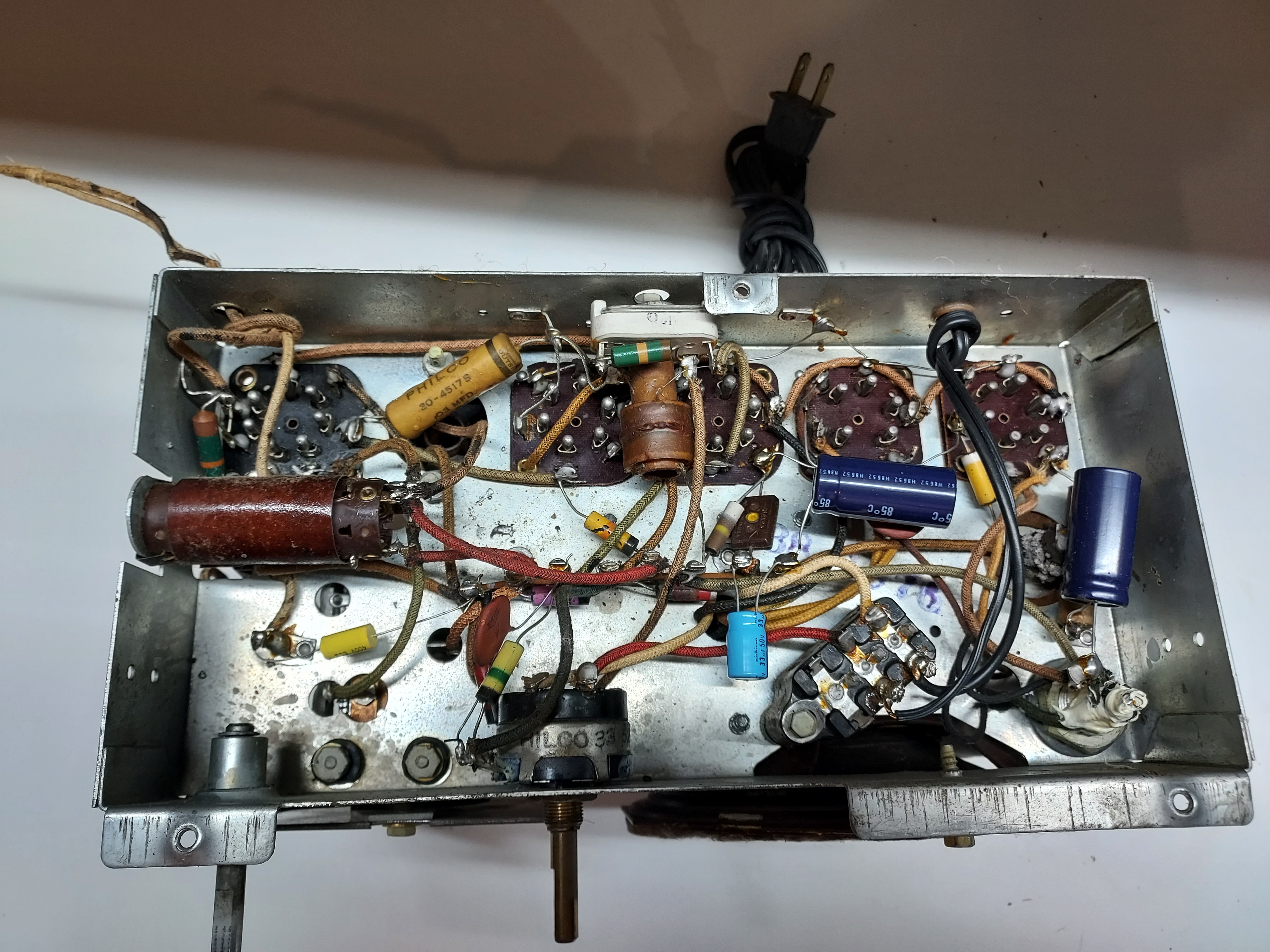

The chassis is very clean, and, though I do not like it, it was restored at some point. Not to my standards, but it is, all in all, a good restoration. It's just I am not a fan of hanging caps and electrolytics over the existing old parts. Even if it is properly done (they are).

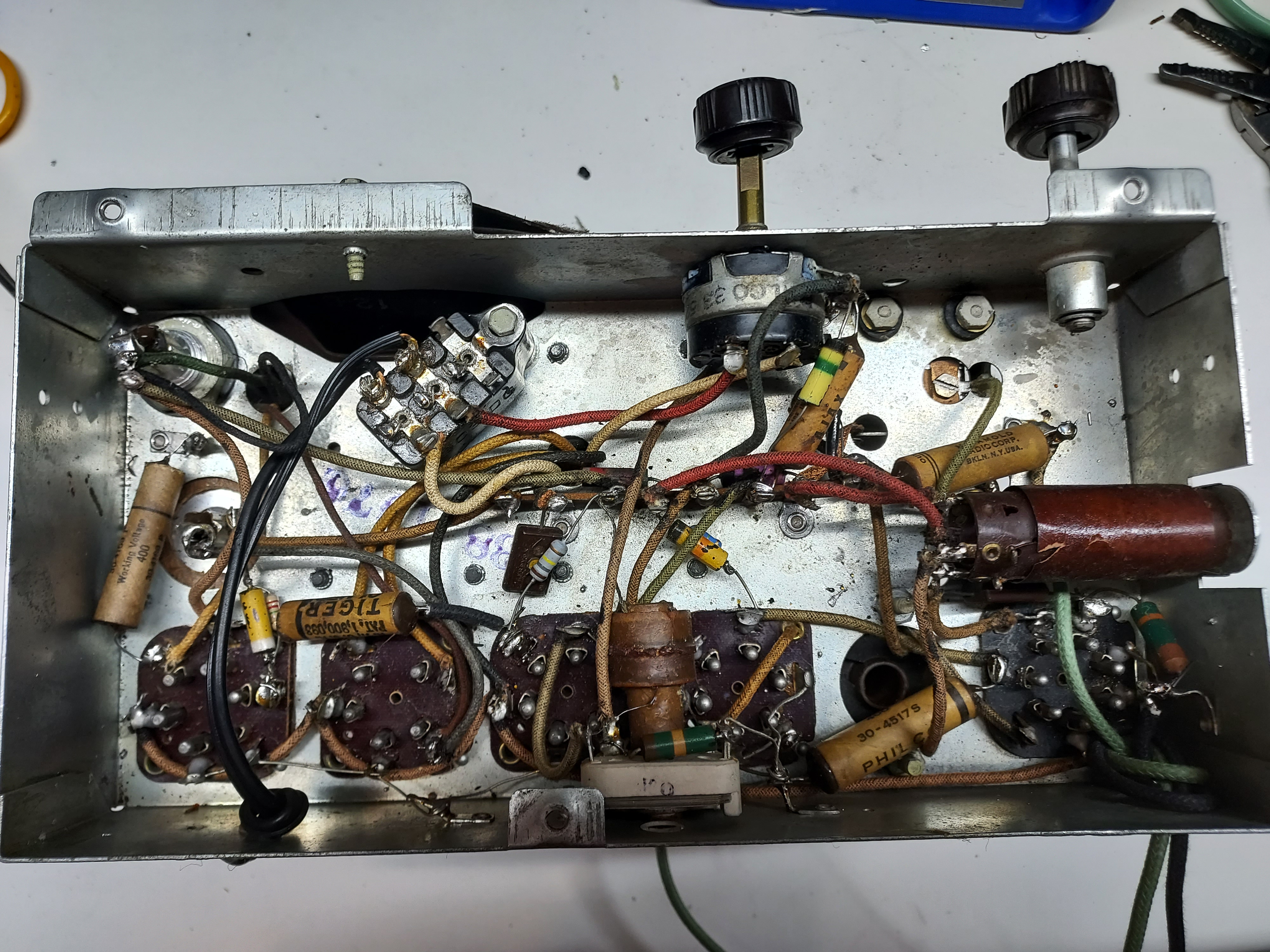

As seen from the photos, not all caps have been replaced. I intend first to replace all of the original caps, then tackle the electrolytics and those that are outside of the backelite etc.
This is the first photos, the case and the chassis.

- stuffed the old tubular caps
- stuffed the backelite block (two Y-caps), and
- replaced the disk ceramic caps and the sole axial film one with the old caps' shells with axial caps inside.
- Plus Iremoved the 30uF 50V cap that was there between the GND and the Negative. It is not in the schematic, so even if it is good, I do not want it. Plus it seems it did not affect anything in a negative way.

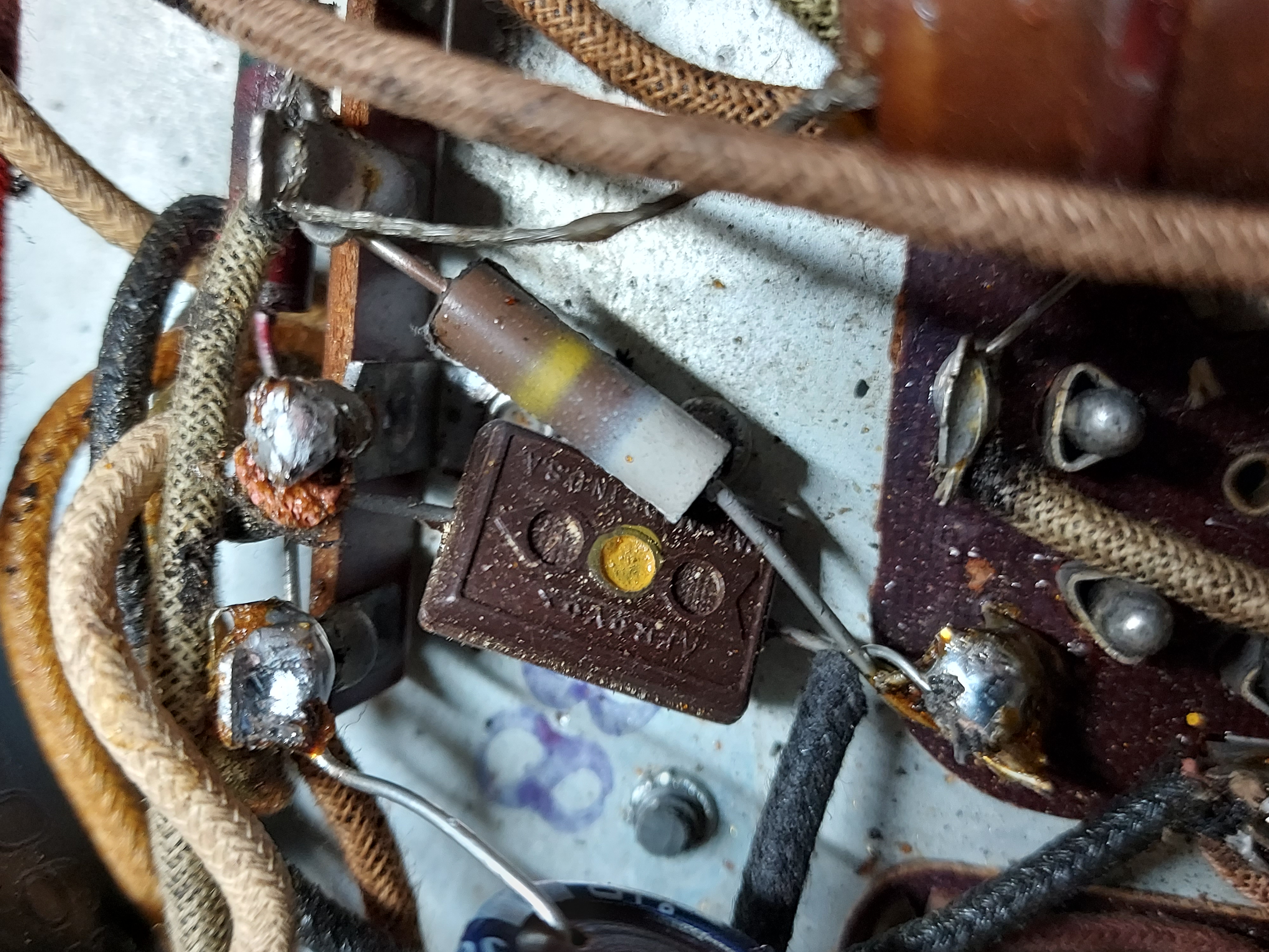

One particular resistor puzzled me for a while.

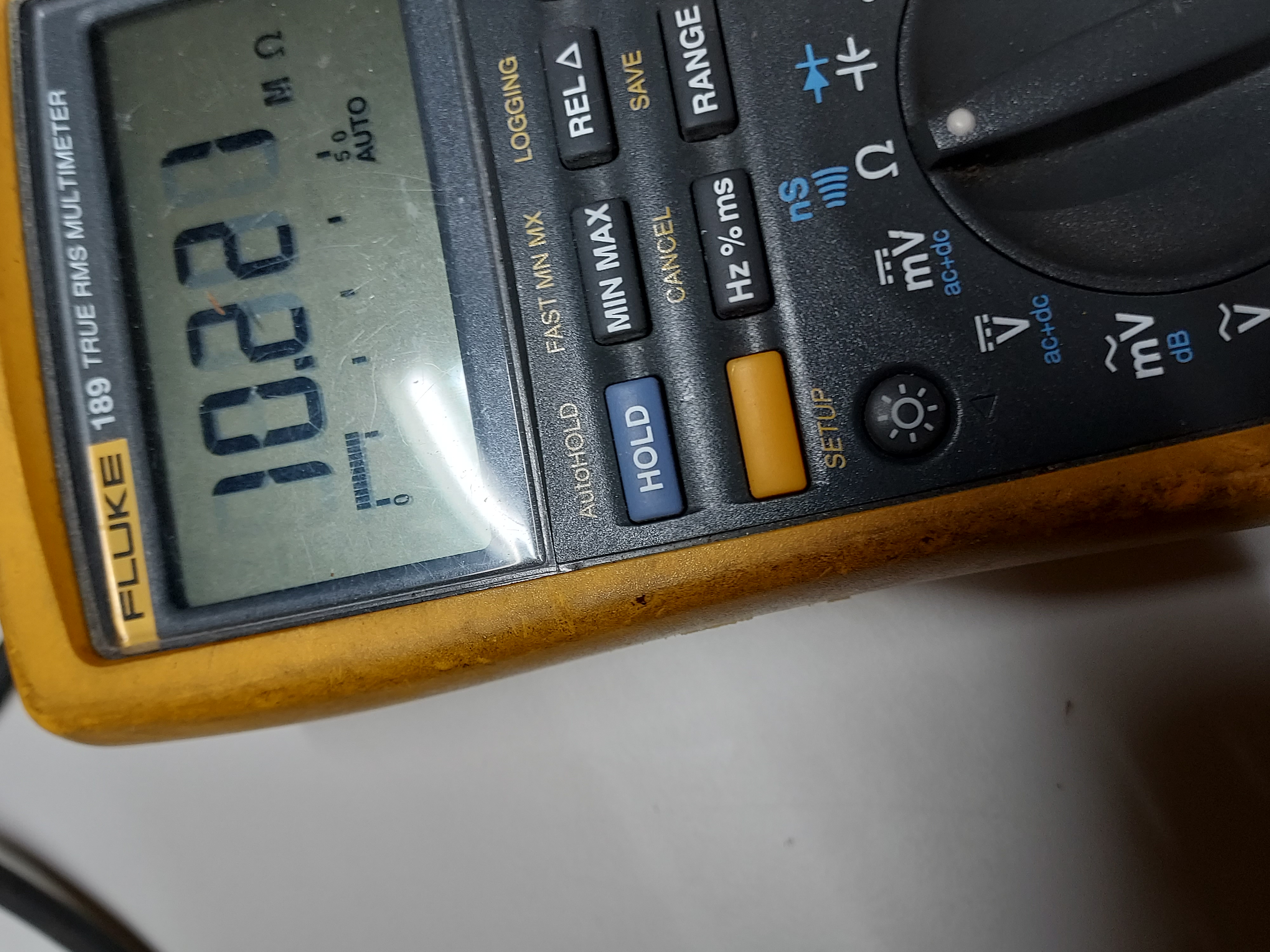

It showed 7.3M and it should've been 190K. I 've seen my share of open resistors...but the radio worked fine.
I have another chassis I keep on the bench for reference; it was acquired independently about 2 years ago for $5. In good shape.
So, I looked at the same resistor there, and it showed....10M. I started doubting myself. I even thought it was some variation. I tried to look for 190K resistor but to no avail. Then I measured the voltage on the plate of the IF, where that resistor was the load, and saw 20V instead of 90V.
So I replaced it, and the voltage came back normal. The radio worked the same way as before.
I never saw two resistors in two chassis failed the same way. Bad batch?

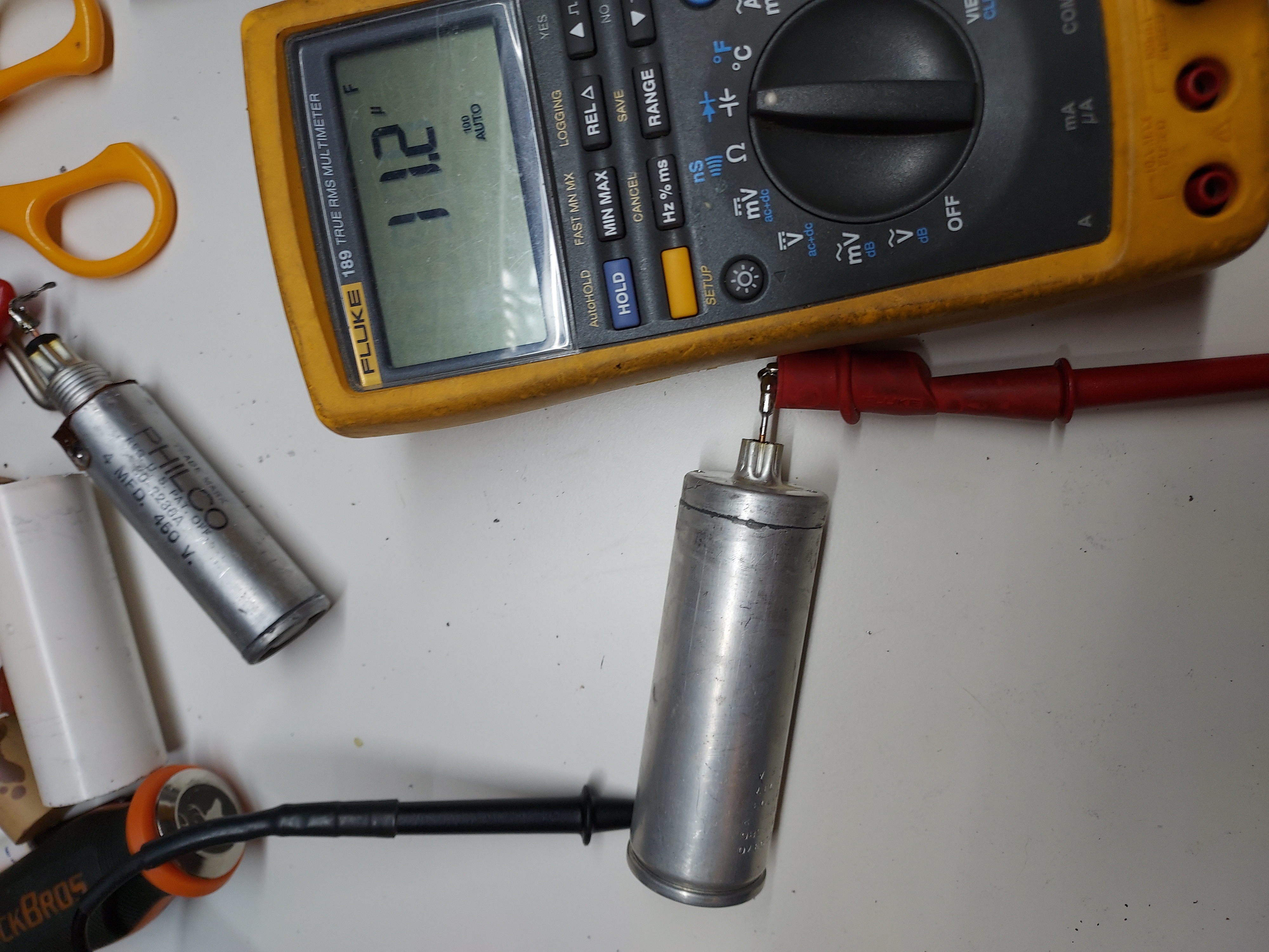

Both caps exhibit 70% rise in value, and when shaken, a liquid splashing is heard inside. I take it, they are beyond the repair (reforming) and tonight both will be drained and opened in order to be re-stuffed.

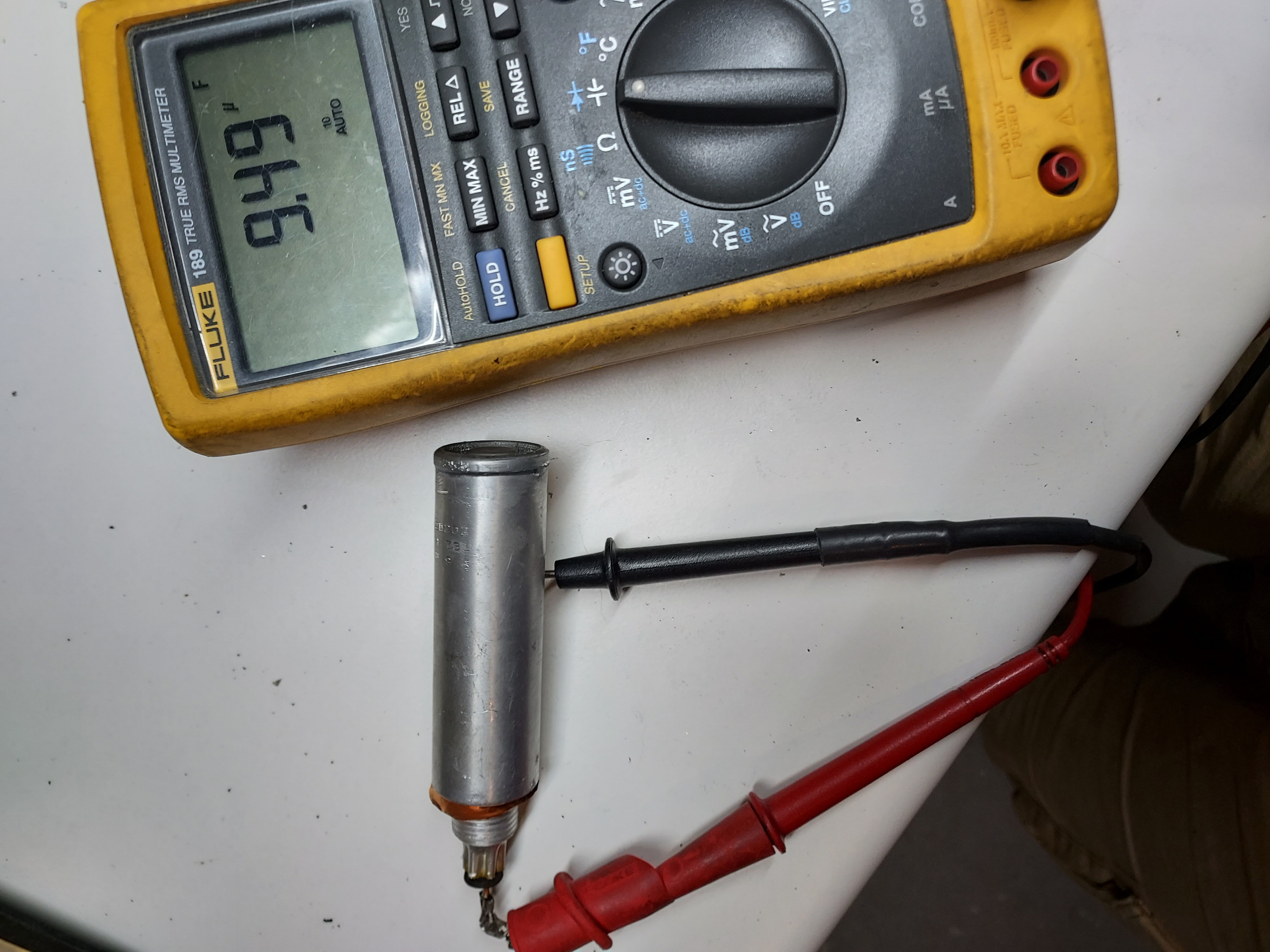

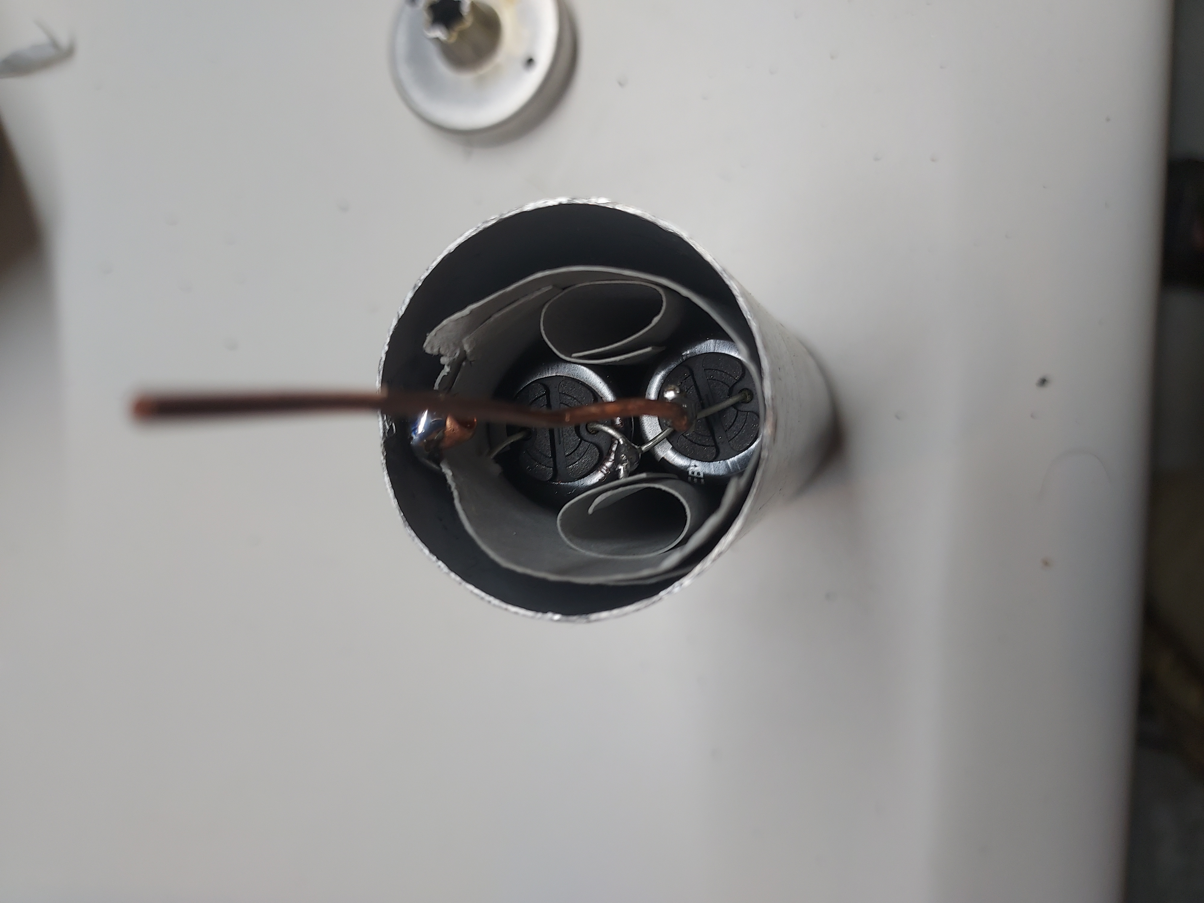

First prep the 12uF cap: serialized two 22uF high-ripple Panasonic capacitors (22uF 450V, 560mA ripple at 120Hz).The resulting capacitance is 11uF, close enough.

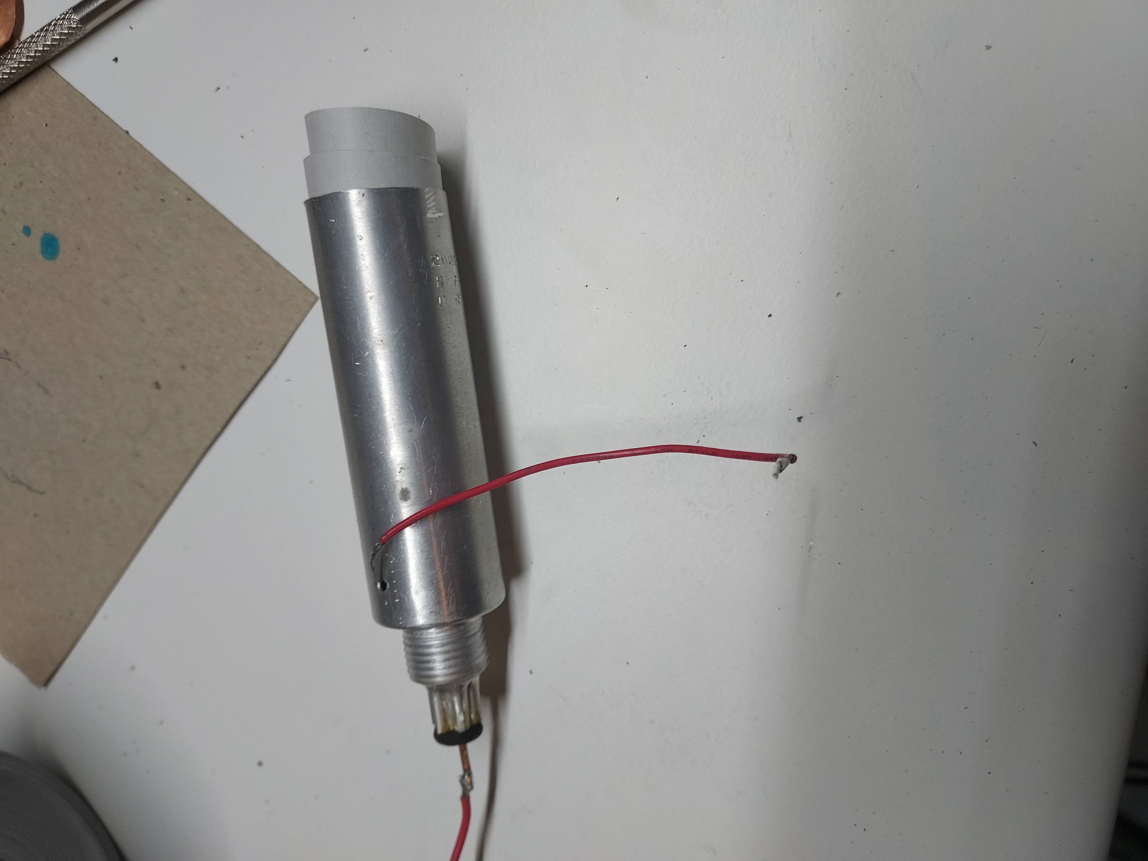

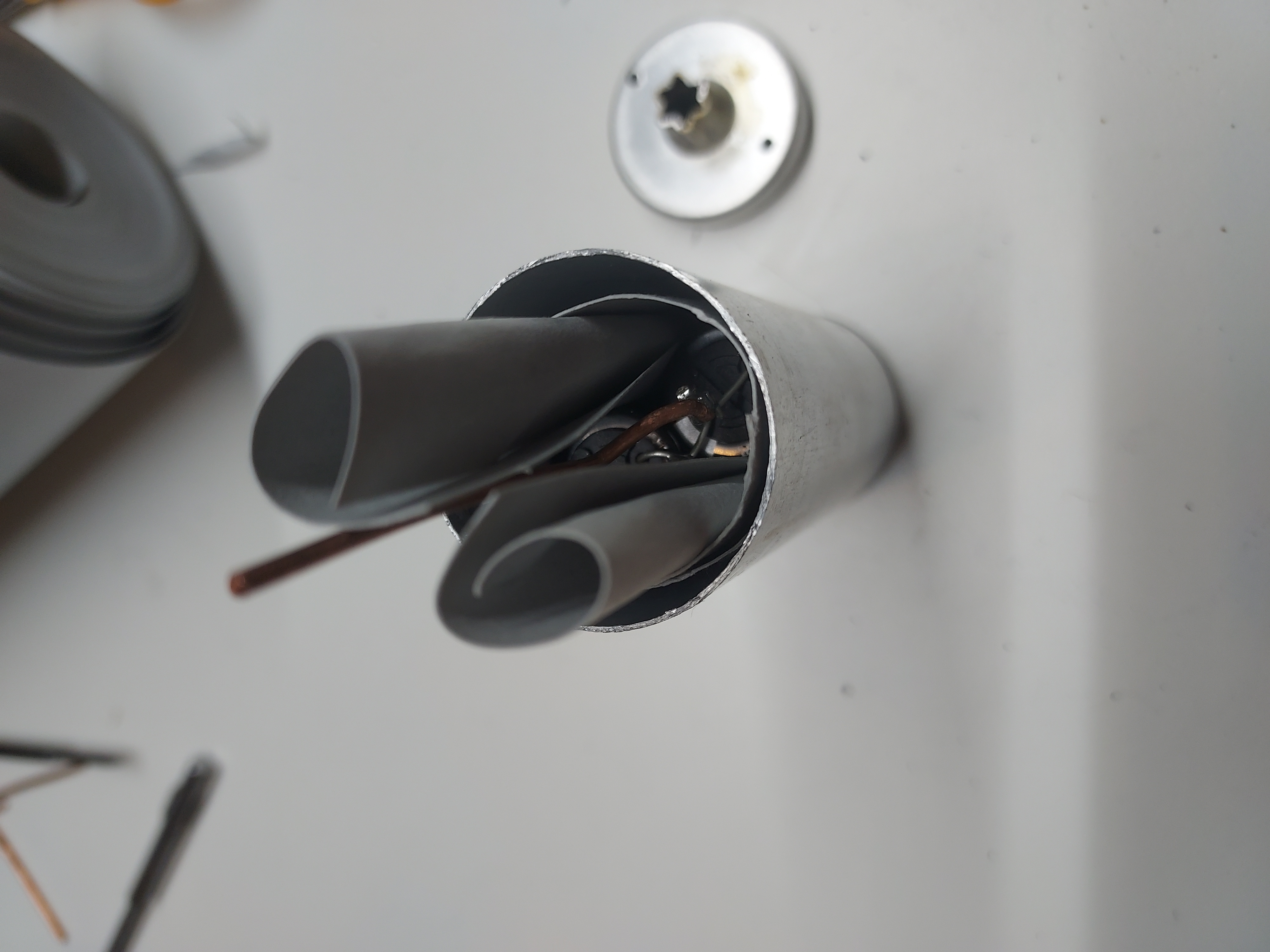

Then wrap it in fish paper (to keep the cases from the shell), push into the shell, and insert two spacers to stabilize it inside the shell (also made from fish paper, a simple roll).
Then I put a copper rivet at the side of the shell, and soldered the negative lead to it.
This cap is now ready for epoxying the bottom back to it.

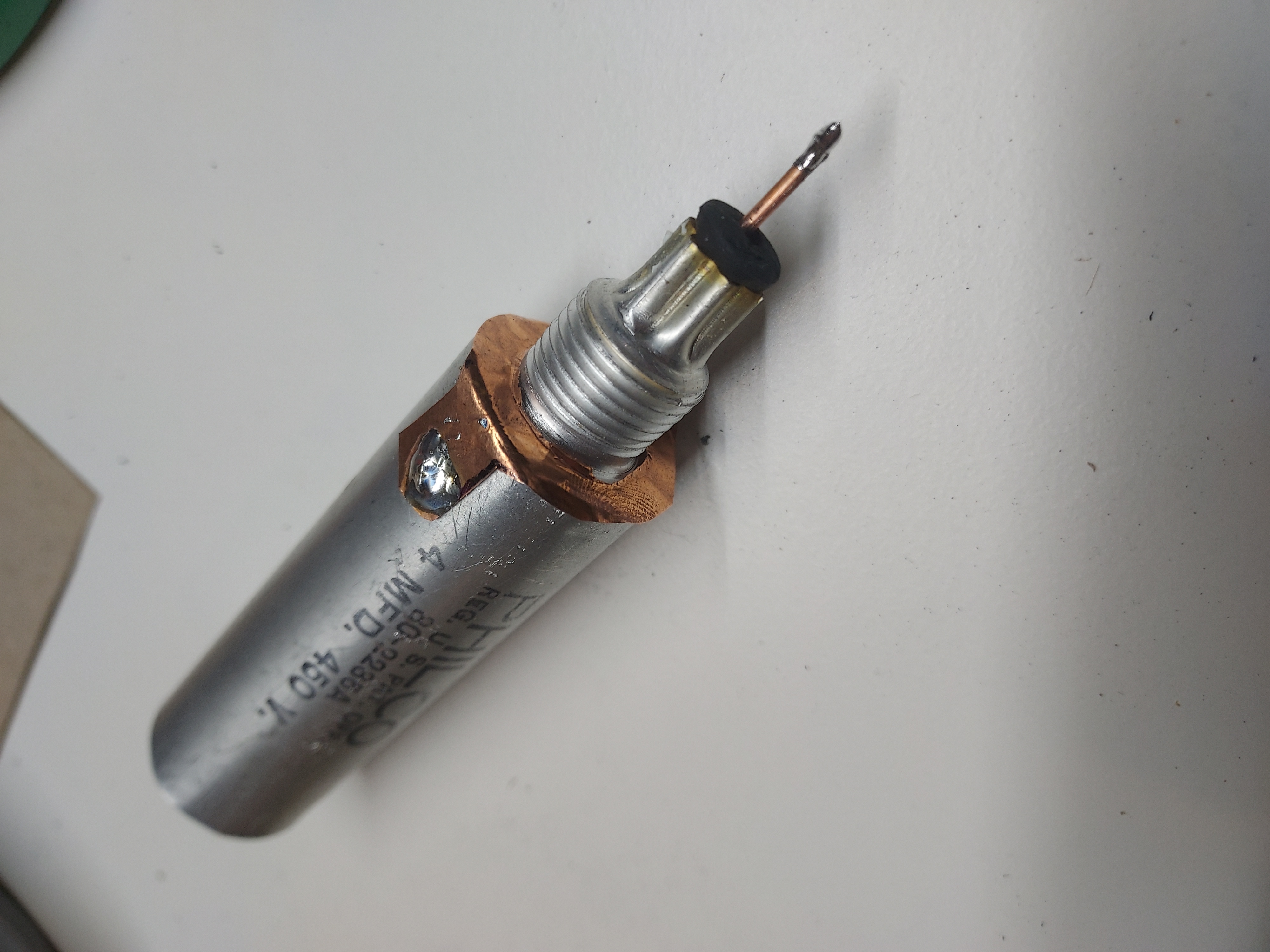

Unlike the first cap, which is insulated from the chassis, this one uses the shell as the GND, and so the bottom of the shell could benefit from being solid, so the most natural place to cut is the cap's groove at the top.

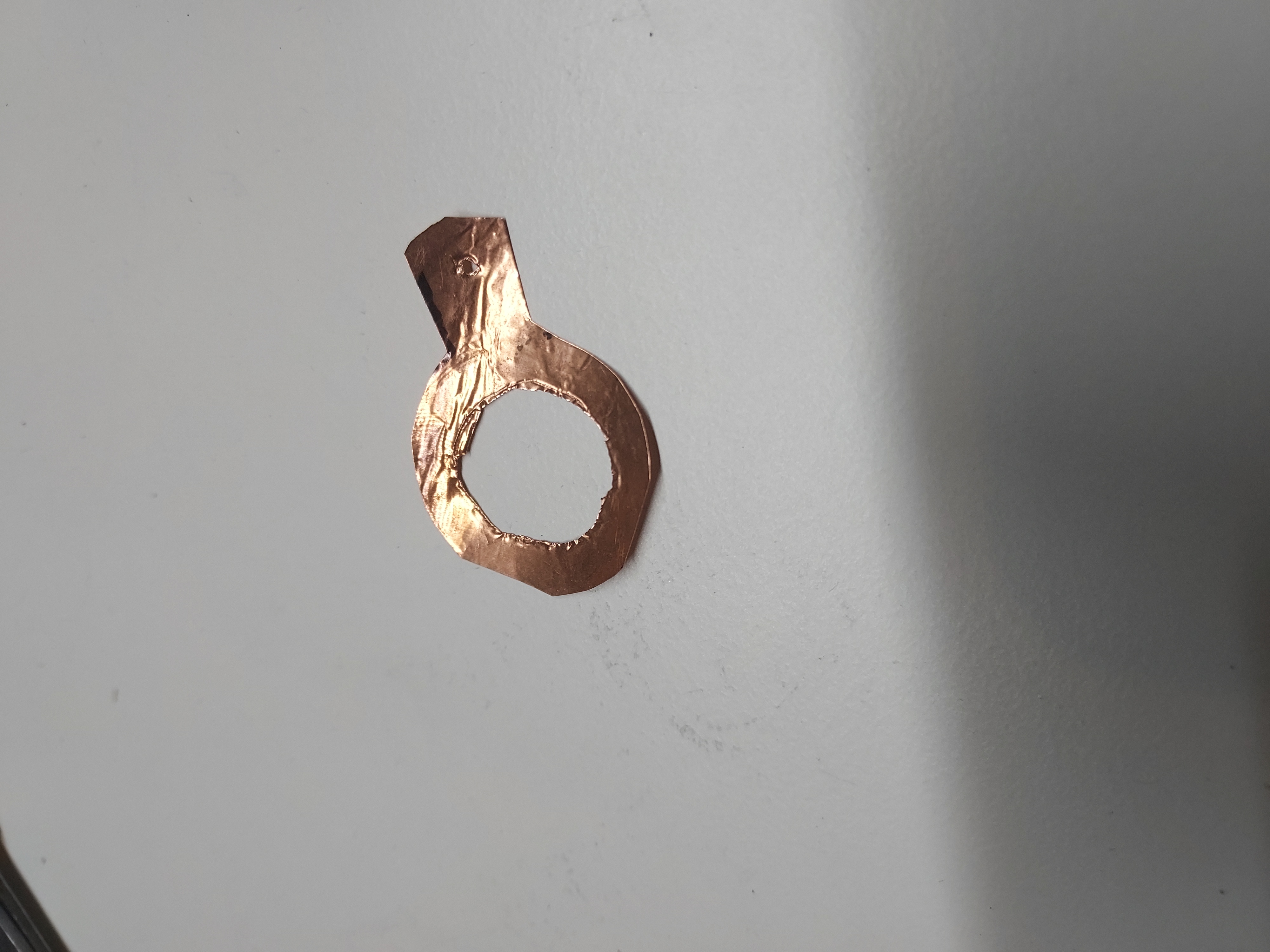

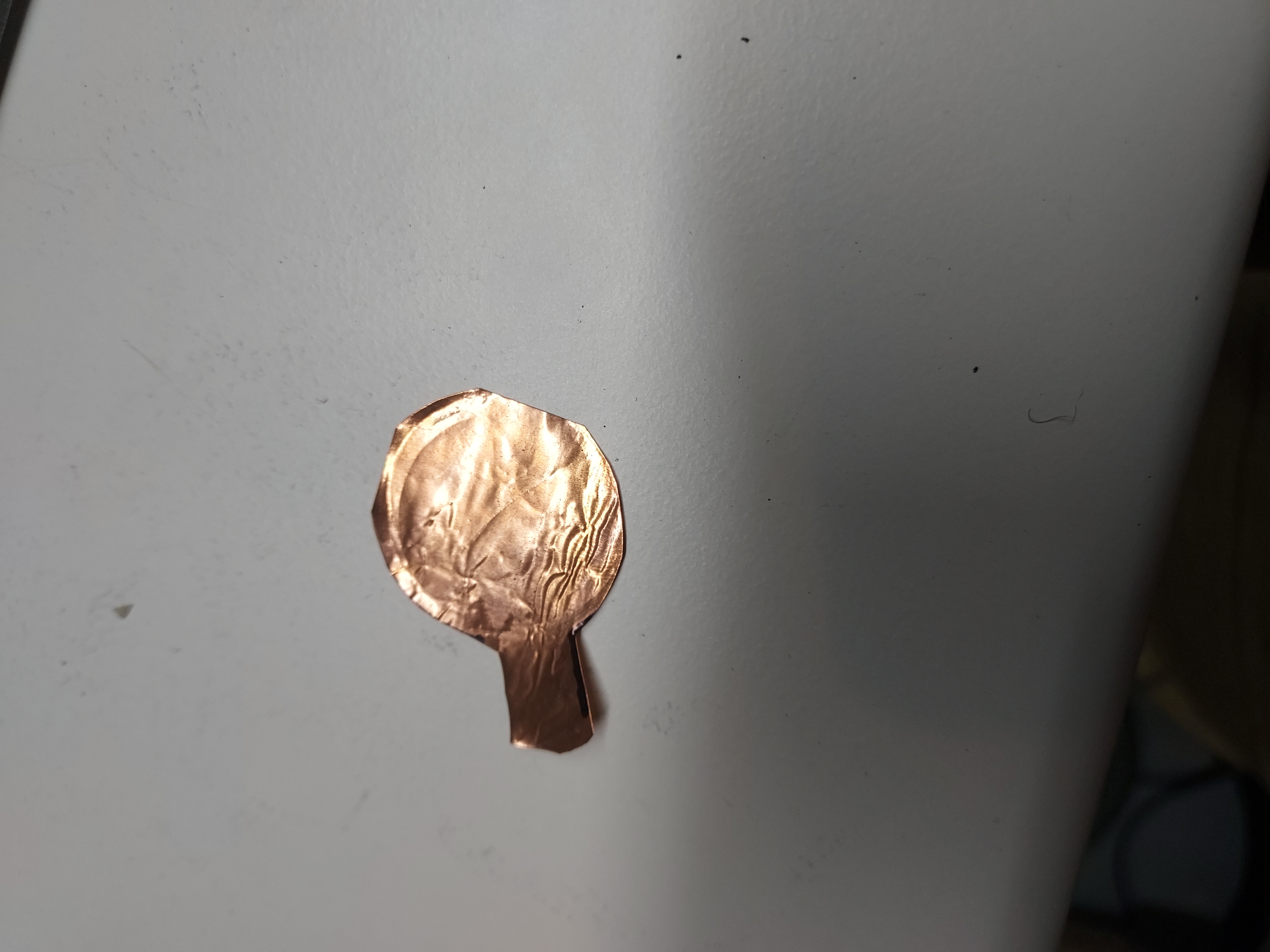

Now I had to think of how to best connect the minus of the cap to the shell, so what I did was manufacturing a copper foil ring with a solder terminal, which would receive the inner cap's negative through a hole in the shell, while itself being between the shell's bottom and the chassis.
I soldered tug wires to the cap, to pull the leads through.
Then I trimmed and soldered the side lead.
Then I measured the capacitance.
This is how the caps look in citu, and the whole chassis after I also changed some broken antenna/GND wires.
After this I pretty much just plugged it in 120V outlet and heard it receive. The voltages are very close to those shown at the chart, the rectified one is a bit higher (10V or so), because, well, it is today's Mains voltage, which is higher than 110V.

Nice job Mike. "And nobody will be the wiser." (Stan Laurel) Would there be any issue with the dissimilar metal problem between the copper and aluminum?

Another method I thing may work to ground an electrolytic can would be to solder a lead to a large star or locking washer under the can, some makes used to do this from the factory, some will just pinch a wire underneath the can itself, and hope for the best. I had not thought of using a copper rivet through the can though, that was a good idea, if you can find the correct flux you can solder to aluminum, but how long it will last is a guess.

Indeed, copper and aluminum do form a galvanic couple, whicb some consider the worst.
However that requires some moisture, and in well-controlled climate this should not be much of a problem.
Yes, and I did that once before, forgot in which radio from those I restored. That was early on. I just wanted to keep wires from sticking out from the can.
Another way would be using two wires out of the cap, as in some Philcos. I probably could've gone for that too.
The small cap was somewhat inconvenient. If you cut close to the base, you can't tork it when handling, plus it will be obvious; if high, it looks nicer (if really diligent, it could look very nice), but the aspect ratio interferes with handling the cap inside easily.
