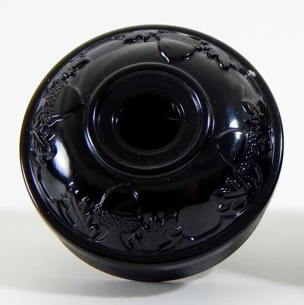

I mostly use brown far as my cloth powercords go !
Here is the plug that I have used bakelite Acorn style

Plugs for the power cord were hard rubber either assembled onto the cord or molded onto its cord. I do not believe that the screw-on replacement type plug illustrated by RadioRich was original equipment but is a most appropriate replacement. These may have been used on earlier radios, but I have 2 non-Philco radios, a 1933 Zenith 705 and a 1934 RCA R-17, both with plugs factory assembled onto the cords (soldered pins, metal case swaged on or hard rubber with pins press fit), but not molded to the cable. In fact, the RCA R-17 has the original "Curtain Burner" Cordohm power cord.

From what I read Philco went to using brown rubber power cords in 1936, so cloth was used in the 1935 and earlier models. So a cloth cord, a brown one, would have been correct for the 1934 edition of a model 84, as for the plug I don't know, my model 60L from 1933 had a plug much like the one Rich posted, a cap style, I can't remember what my model 3118 had. In terms of vintage style plugs I like the style that is shaped like a lamp shade as it has a shank you can pull on, but there was a style made by the Viceroy Rubber Company that I also like, but most of those have chips out of the rubber by now.

I remember a bakelite "lampshade" (a fancy lampshade) style plug being available in the hardware store when I was a kid. I remember several rubber style replacement plugs also. I did use the plug that rich posted, along with cloth covered cord on Radiola 60 and I will eventually do the same on my Model 20 when I get around to finishing the cabinet.
