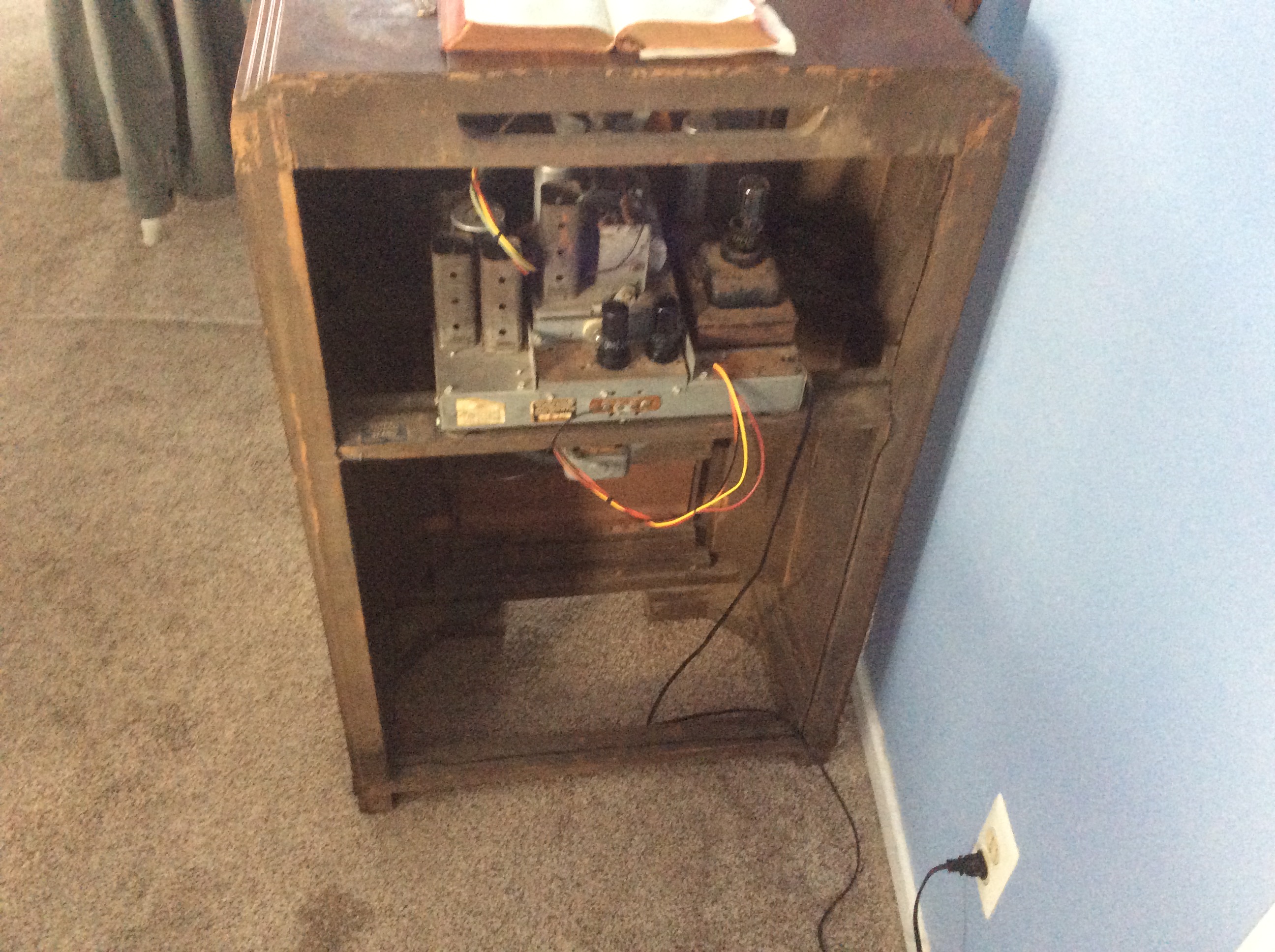

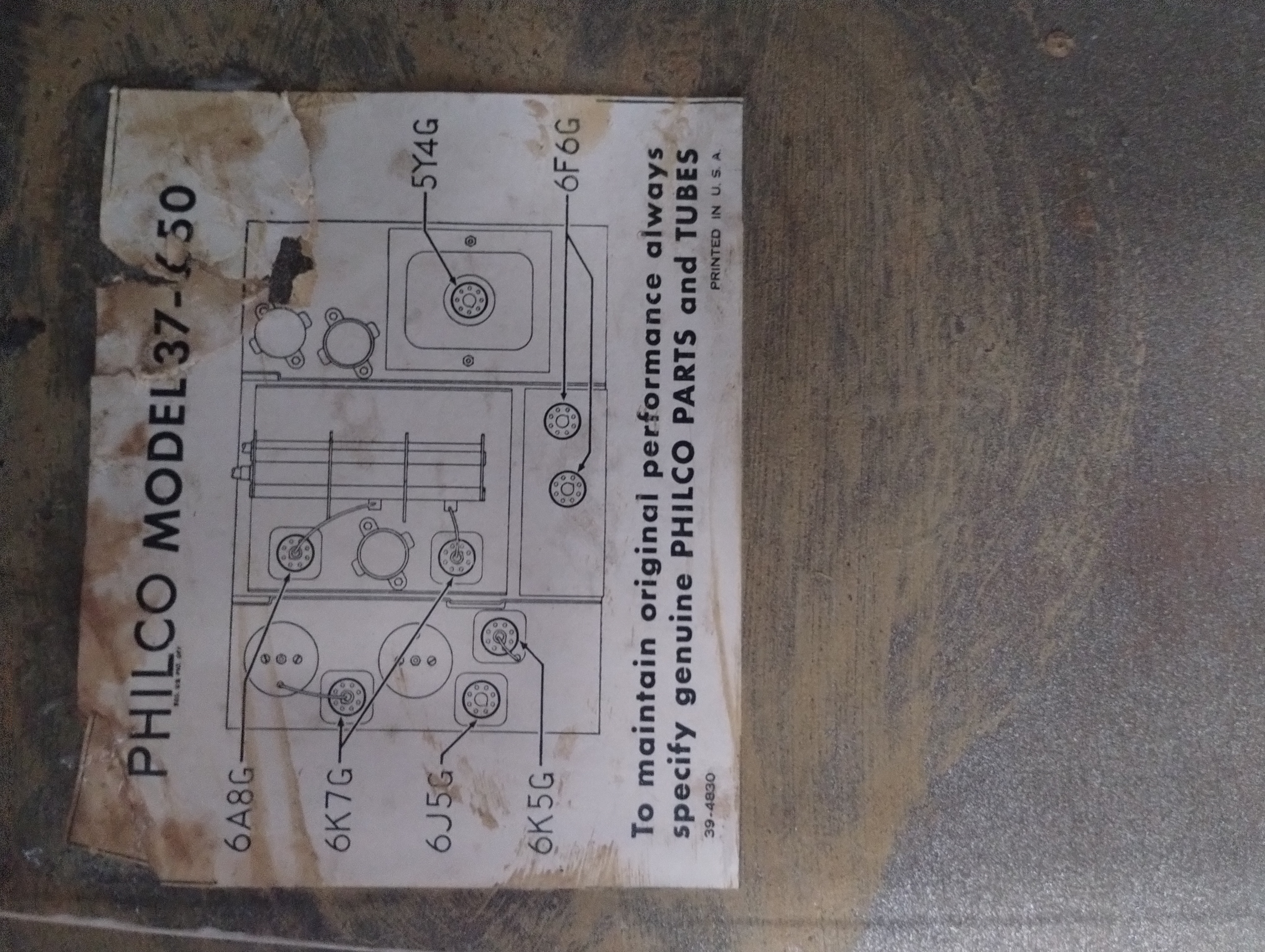

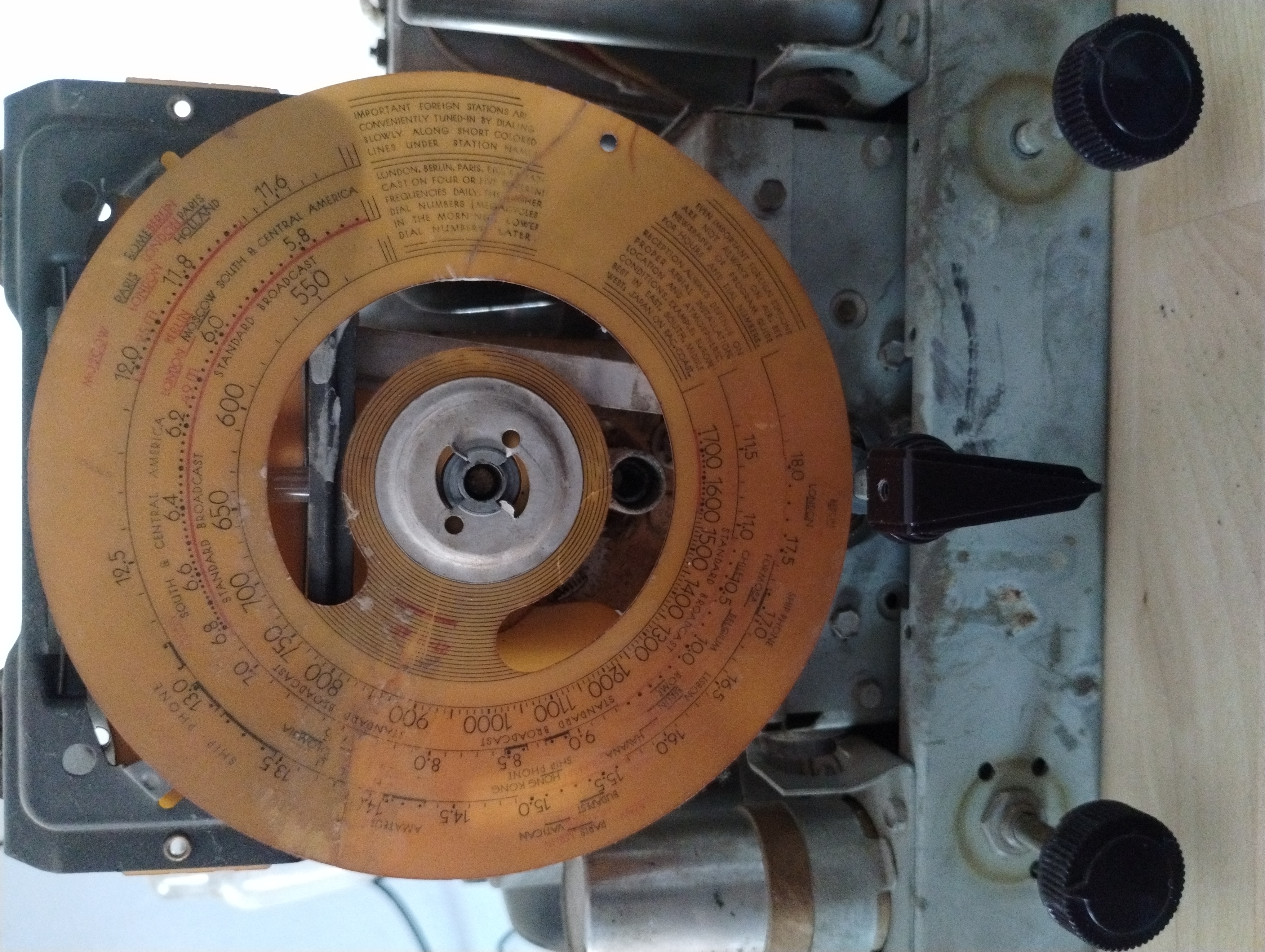

After I got it home, I found a tag inside the cabinet stating it was a 37-650.  I found Service Bulletin 254.  I pulled the speaker and chassis out in preparation of refinishing the cabinet. 3 band dial, AM, and 2 shortwave with shadow meter.

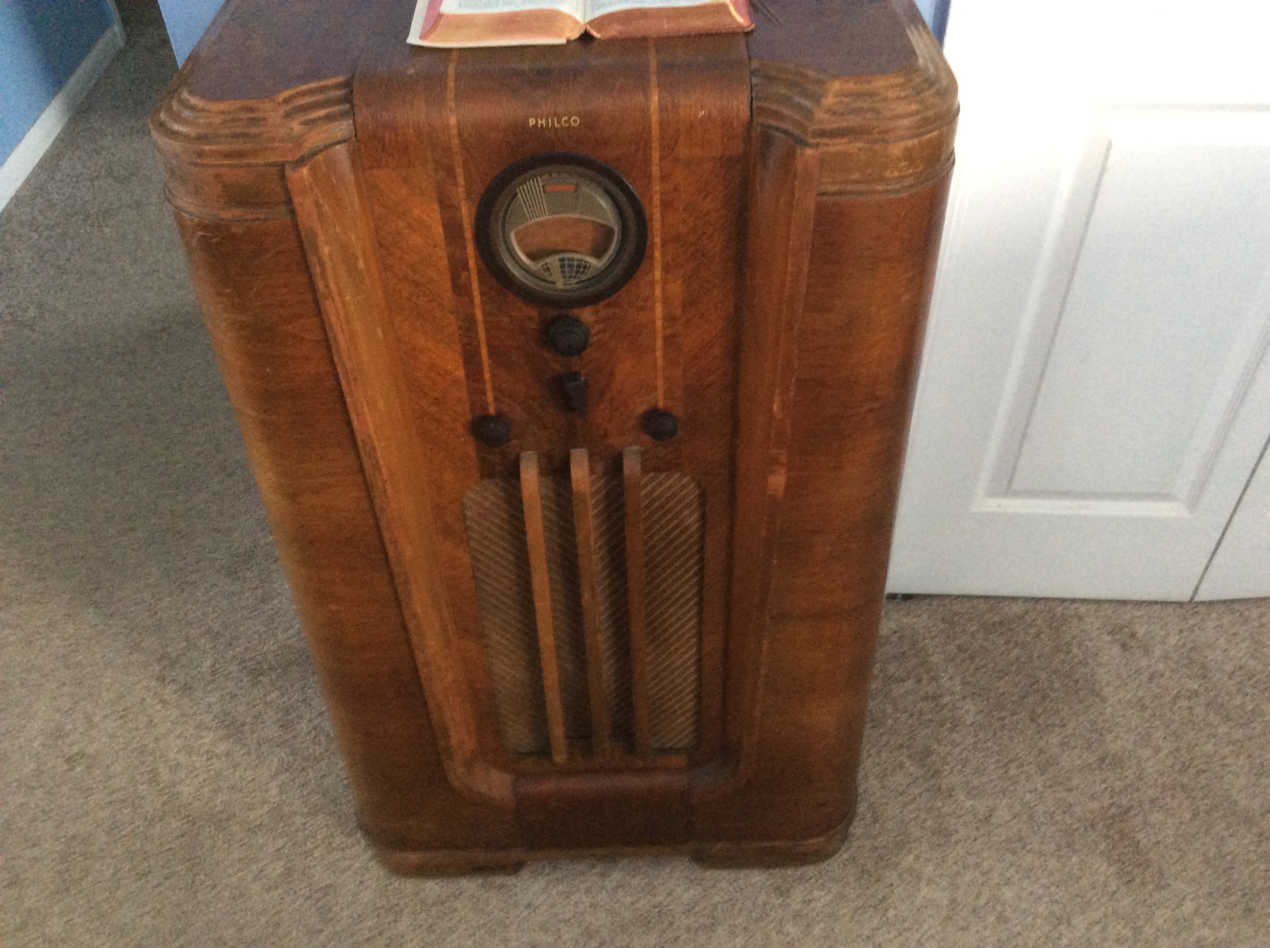

Then I found this forum and library, etc., and found that the 37-650 picture did not match my cabinet.  My cabinet matches the 37-665X.
Further investigation shows the 37-650 is an 8 tube chassis.  The 37-665 is a 9 tube chassis.

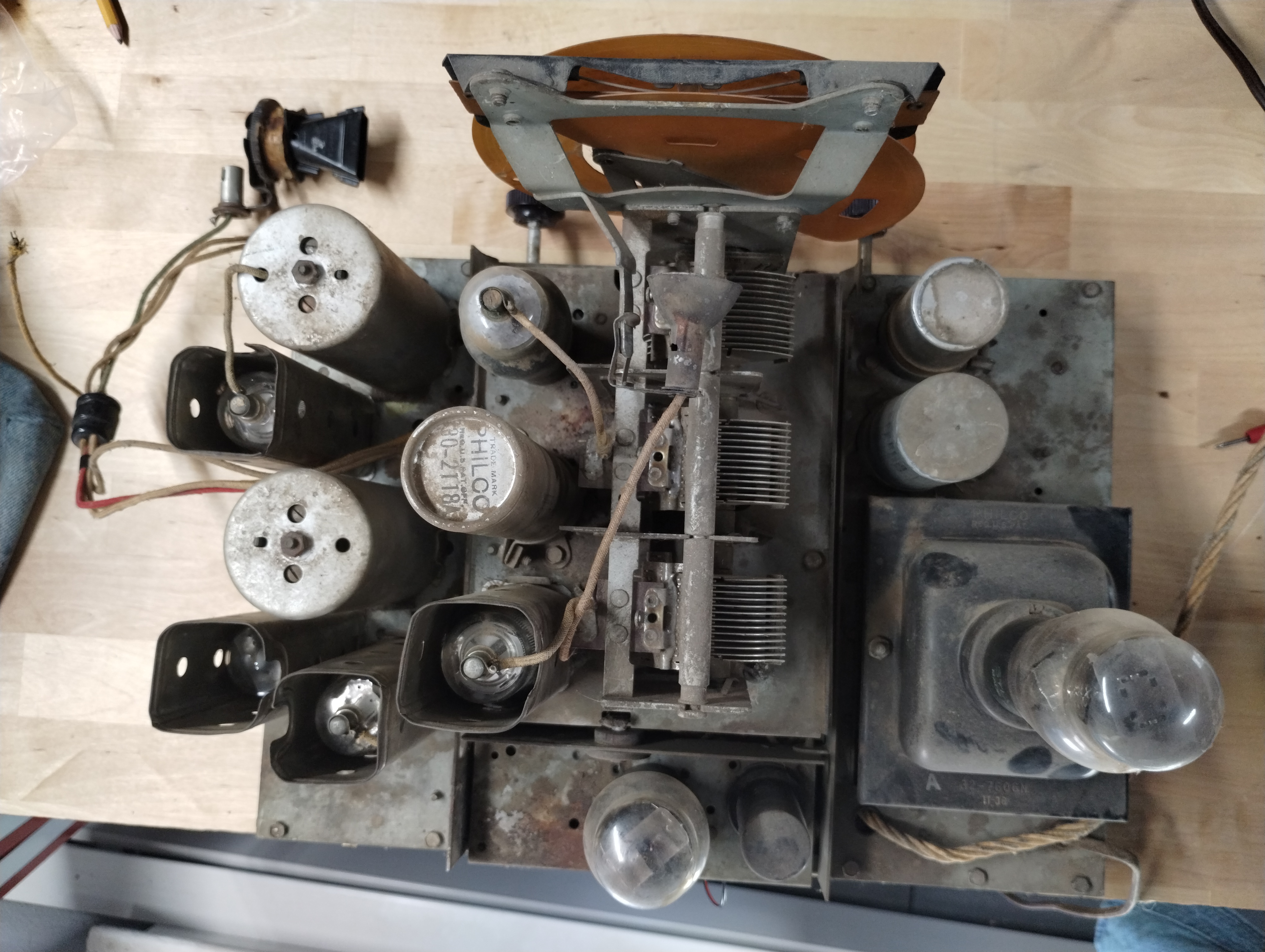

Look at my pics, and I have a 7 tube chassis!
So, I think I have a 37-665X cabinet with some other chassis...or an optional chassis?
Maybe it is a Phrankenstein Philco?
Hello You have the correct 8-lamp chassis. Perhaps you did not pay attention to one more lamp - 6F6 in a metal case. Of course, both 6F6 should be made of glass. And preferably from Philco. Icon_biggrin

Ah, now why would I count a metal part as a tube when I am counting glass tubes? Icon_smile
Yes, if I do a full restore I should probably put in the correct part!
So a 37-650 chassis in a 37-655X Cabinet?
I think that you have a 37-650 chassis in a 37-2655X cabinet, in the version for export Icon_think

Interesting. I looked in the gallery again and the 37-665x changed cabinet type between June 36 (1937 model) and the January 37 pictures. Radiosvit, your observation of the 37-2650 makes more sense.

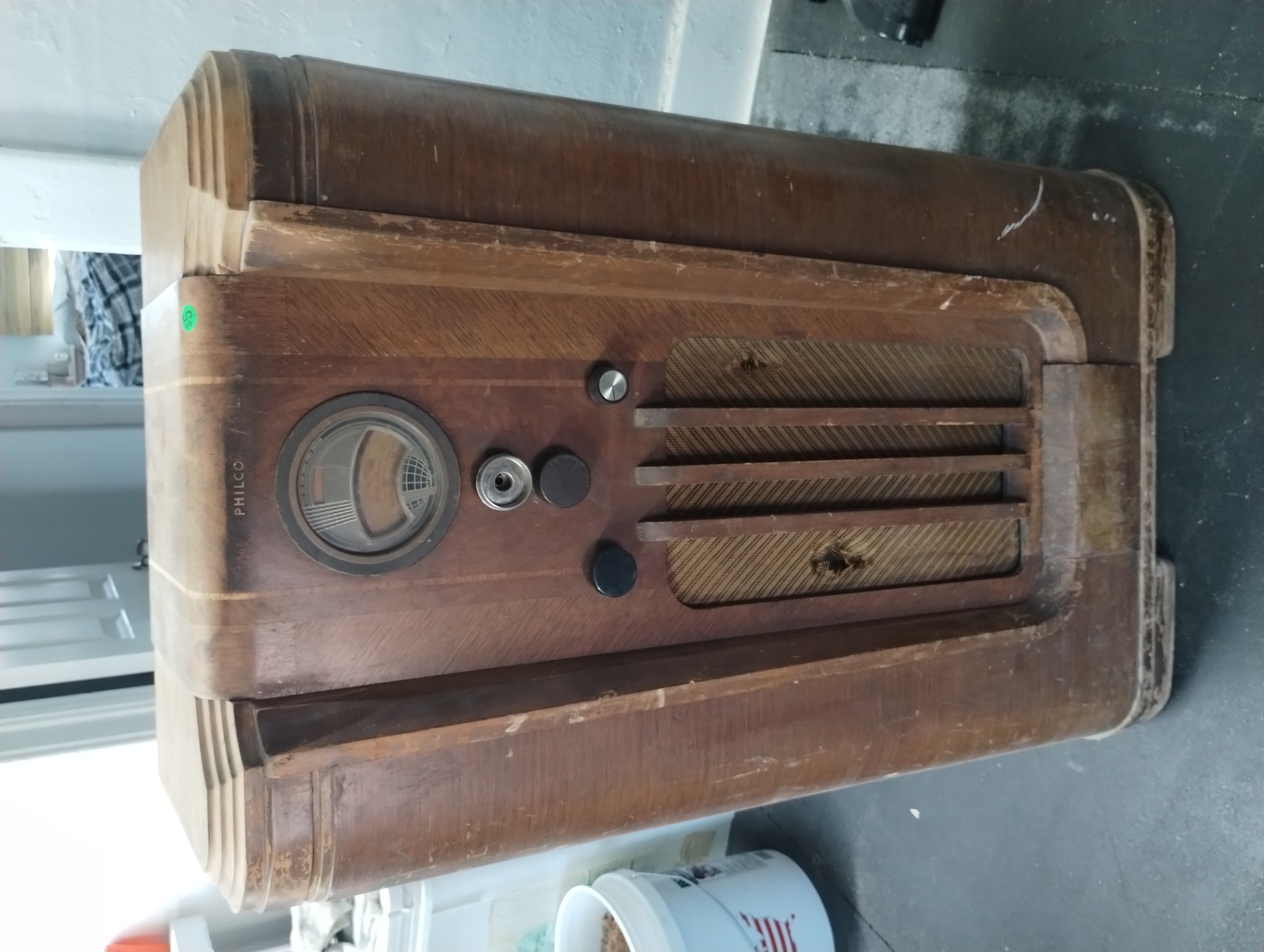

Sorry, I’m late to this post.  That is a 37-650.  Attached is a pic of mine.  Joe
Joe
It's an 8 tuber. One tube is metal.
