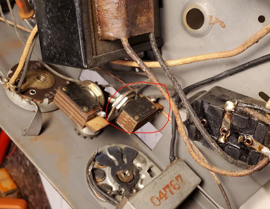

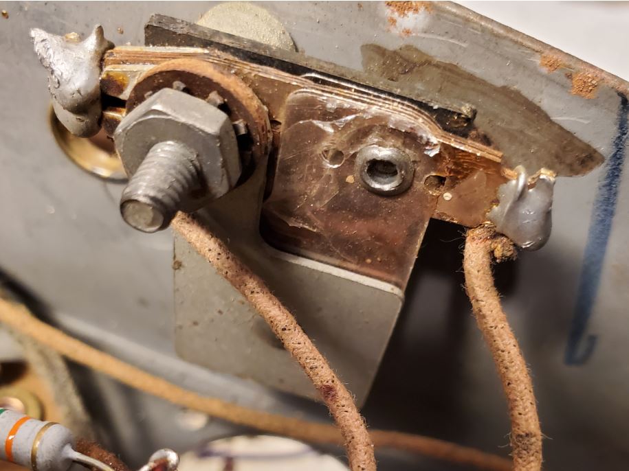

I have gone through most of the cap replacements. I am working on the replacement of the E caps and wiring of the output stage. There is a capacitor (#47) in the plate circuit of the output tubes. Schematic says it is a .001. What I think is the cap is a part mounted to the back of the chassis. It looks like compensating capacitor but without the adjustment screw. Is there some reason why it is not just a plain paper cap or one in a bakelite block?

No, that cannot be the 47.
The 47 is a regular backelite block cap. Look at the chassis picture, it is shown there. Right under the tone control.
I have two schematics for this radio one shows the 47 block (126-226) and the other (121-221) does not. My radio does not have the 47 block. The compensating cap I show is between the two 42 tube plates. I'm sure that is #47. Neither chassis layouts show the compensating cap. It is mounted on the back of the chassis between the E caps.
Anyway what is the purpose of that cap? I believe my cap is open. My M-Tester says unknown or damaged part.
Well, this cap you showed cannot possibly, due to the way it is constructed, be 1000pF (0.001).
It can be in tens of pF.
Now the purpose of it really depends.
One schematic shows it in series with the resistor. That could be a snubber, that protects the primary from high frequency transients with the capacitor allowing them to go to the resistor and be dissipated as heat. This stabilizes the stage and reduces voltage spikes.
Another schematic, also in our library, will show just the capacitor. I think it also acts as a High frequency filter and stabilizes the output, preventing some unwanted oscillations, or spikes; the parasitic of the transformer may act instead of that resistor.
It also depends on the frequency range, as the equivalent circuit of the audiotransformer is very frequency-dependent.
Thanks Mike. I at least know why it is there if I don't fully understand it. I see where you talk about a cap and resistor in series. That shows as 47 and 47a in the NA schematic (code 126-226). Parts list says the cap is .006. Anyway I think that part is sorted out.

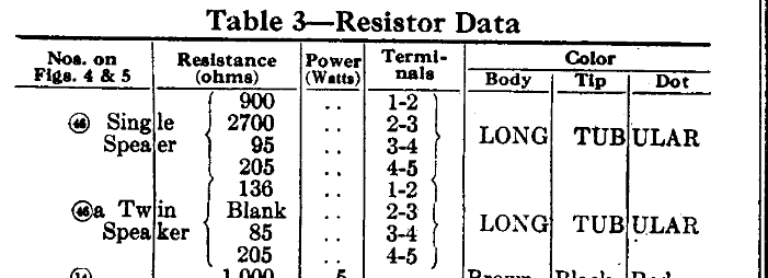

I remember somewhere reading that the cannedohm 900 ohm (pins 1 & 2) section may be wrong and should be 9K. The person did some tinkering and settled on 5K. I remember the person said the screen grid voltage was way too high on the 44 tubes and the 2700 ohm section was running way to hot. The change bought the temp way down and bought screen grids down to reasonable level. What is your thought on that?
I still need to get my output transformer and speaker wired in and a resistor wired in to replace the field coil. What wattage would I need for the coil resistor?
If you know the fc resistance you can use 120 ma nominal current through the resistor to get the voltage drop then calculate the wattage. Probably 10 watts or more.
Or you could just square the current Icon_lol
As for the values, they are dependent on the 1 or 2-speaker system.

I did the math to calculate the wattage of the resistor and found to be 47.16 watts using 3275 as fc resistance and your 120ma value. Something must be wrong here? According to Philco speaker list the resistance for the fc is 3275 ohms. My speaker is K-6. Only one speaker in the radio.
Dan, have you traced where those wires on that part pictured go to?
Mike, do you think that #47 pictured could be a trimmer for alignment purposes? Some of those old Philcos had trimmers you access through a hole on the back of the chassis, just wondering!
