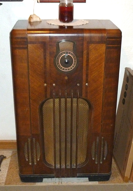

Howdy everyone - pictured is my 37-116 I am starting a resto on. Chassis is at a friend's place being overhauled. The cabinet is my problem.
I love the color of it as-is (original finish) but over the years it has been dowsed in alot of clear lacquer. On a closer look, the corners look like they are cracking but it is the multiple layers of clear that is cracking. I'd like to gently sand it off / strip it and freshen up the cabinet's color. There is a small gash on the side as well that needs repaired.
Is there any full on step by step tutorial as to whats safe to sand or strip it? I've been told by some not to use anything new (like poly) as they think it would damage the old veneer (mine is perfect - another reason I'm afraid of messing with it). I have a spray gun and compressor to clear it when its restored.
Also - how do the front vertical ribs come off? Are they screwed from the back or glued?
Thanks for any help.

Hi, to remove those vertical ribs you need to remove the big speaker first. Be careful in doing so as there is a wooden cone in front of the speaker that will rip your speaker cone if allowed to come in contact. On my set, I removed the 2 nut and bolts while keeping the speaker pulled back from the front and slowly lifting and tilting the speaker until it came out. Then you need to remove several wood screws all around the perimeter of the speaker board. That board along with the 3 acoustic resonators and grille cloth will come out then you will see the screws that hold those ribs and remove them!

Thanks Ron! I was hoping it was something other than glue
(Fortunately) my speakers were all missing when I got this radio (found it next to a curb for trash pickup in 1986), so nothing in the way.
I read your resto threads - looks awesome. Did you clear it after stain?
Any idea what 'color' the dial bezel is?
Thanks again.

I used Mohawk semi-gloss clear lacquer and rubbed out with mineral oil and rottenstone. This was my first attempt at refinishing a large console cabinet. If I had it to do over, I would have sprayed a few more coats of lacquer on it. I still could do that but I would need to wash the cabinet down with OMS mineral spirits to remove the wax I applied after finishing. Plus it would require me taking the chassis and speaker board out again  It was a learning experience. It took most of last summer to spray the lacquer dealing with getting days with no wind and the proper humidity and temperature and a wife who is tolerant of my hobby but absolutely won’t put up with lacquer fumes in the house, thus the need to drag it out on the deck anytime I was spraying anything! As for the dial bezel, I sprayed multiple coats of Extra Dark Walnut on it.

So what is wrong with the original finish on this cabinet, to me it looks like a fairly acceptable original finish for an 88-89 year old piece of furniture ? I would give it a cleaning with some automotive hand cleaner, the cream kind with no pumice, and some paper towels or clean rags, just so you can get an idea of the actual condition. Quite often a finish will look bad just because of the grease, wax, and dirt building up on it over the years. If it really has been over coated with something I would try a rag with some alcohol on it, often people would paint over the lacquer with shellac, but they usually do so very crudely, but try this after the hand cleaner.

Up close the corners are cracking (clear coat )- and there is a slight gash on one side, otherwise, its in great shape.

Yes, I would try what Arran said first and if anything you can remove the clear top finish and you can deal with th minor damage and then clear coat again.

+1 on what Arran suggested. In my case, my cabinet had the usual scratches and nicks, except the top had water damage probably from keeping a plant on it, no gouges. So I started by using CitriStrip on it. That mostly stripped all the old lacquer off and in the process, that removed all nicks and scratches and evened out the finish. Most of the original toner color was still in the wood. When I wipped it down next with lacquer thinner, the original color really popped. So much so that I was seriously considering just applying clear lacquer over it, it looked that good. I had done that previously on a table top radio and it looked great. I have no spray equipment and dreaded using rattle cans on such a big cabinet. Tempted as I was, Ron Ramirez and others convinced me to use a toner on it first before the clear. It is a lot of extra steps to get the finish even.

We just had the discussion on the GoJo.
It is no longer sold, but Goop is, and those two are very close.
I use Goop and it does excellent job on cleaning.
Yes, no pumise/orange stuff, just regular white cream. It lifts dirt like nobody'e business.
