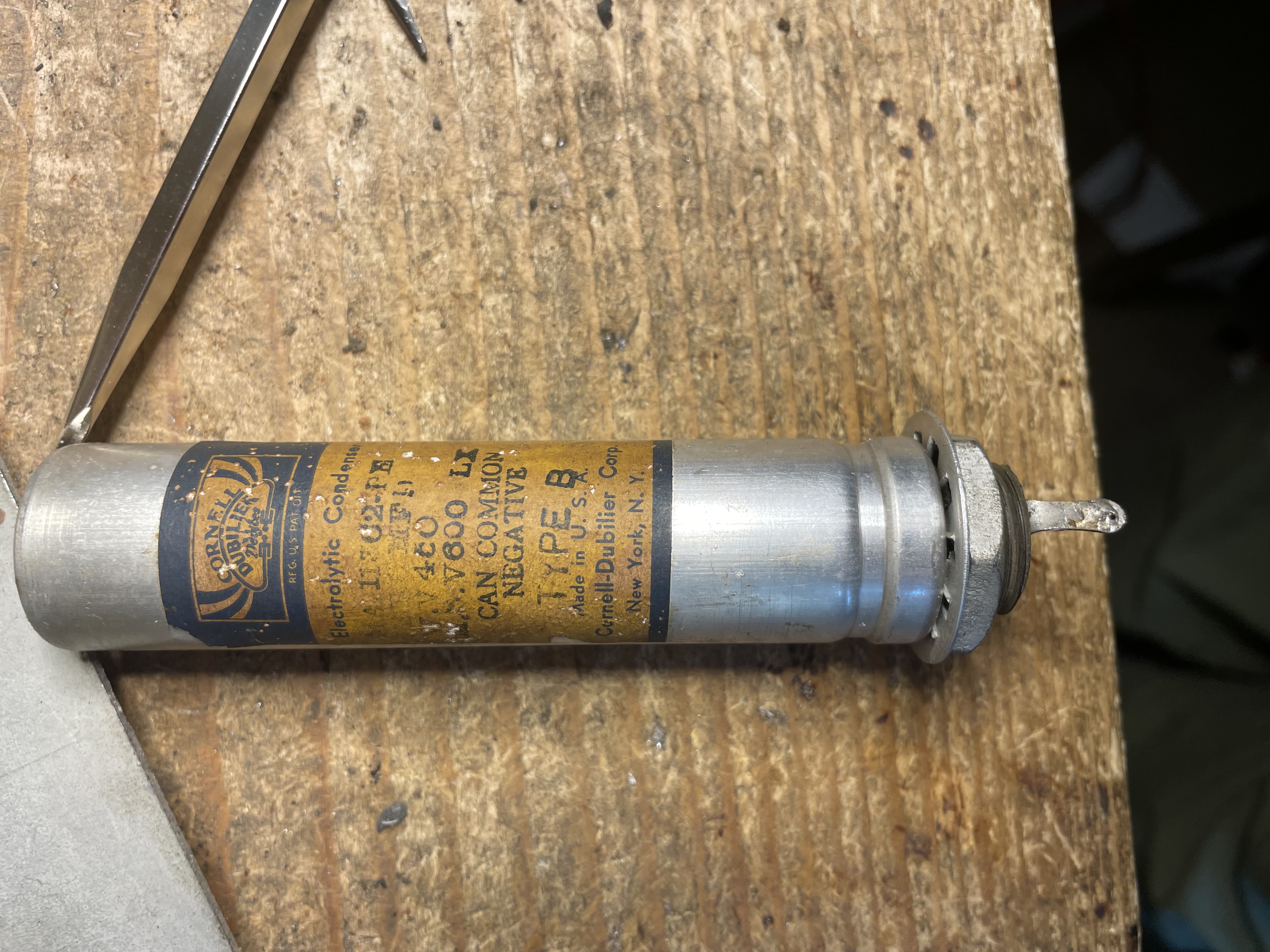

I have an 8mf screw mounted steel can filter capacitor. Putting new caps underneath is an issue because of space.
What I’ve seen is someone cutting the cap with a tube cutter, restuffing the cap, and closing off the cap top with a panel plug. You end up with a shorter but functional cap that fits per original installation.
Can anyone describe what I’ll find inside the cap? Is it reasonable to think I could be able to do this or is there some issue with these caps that would be a problem? I figure I’ll ask before I take the trouble to cut this apart.

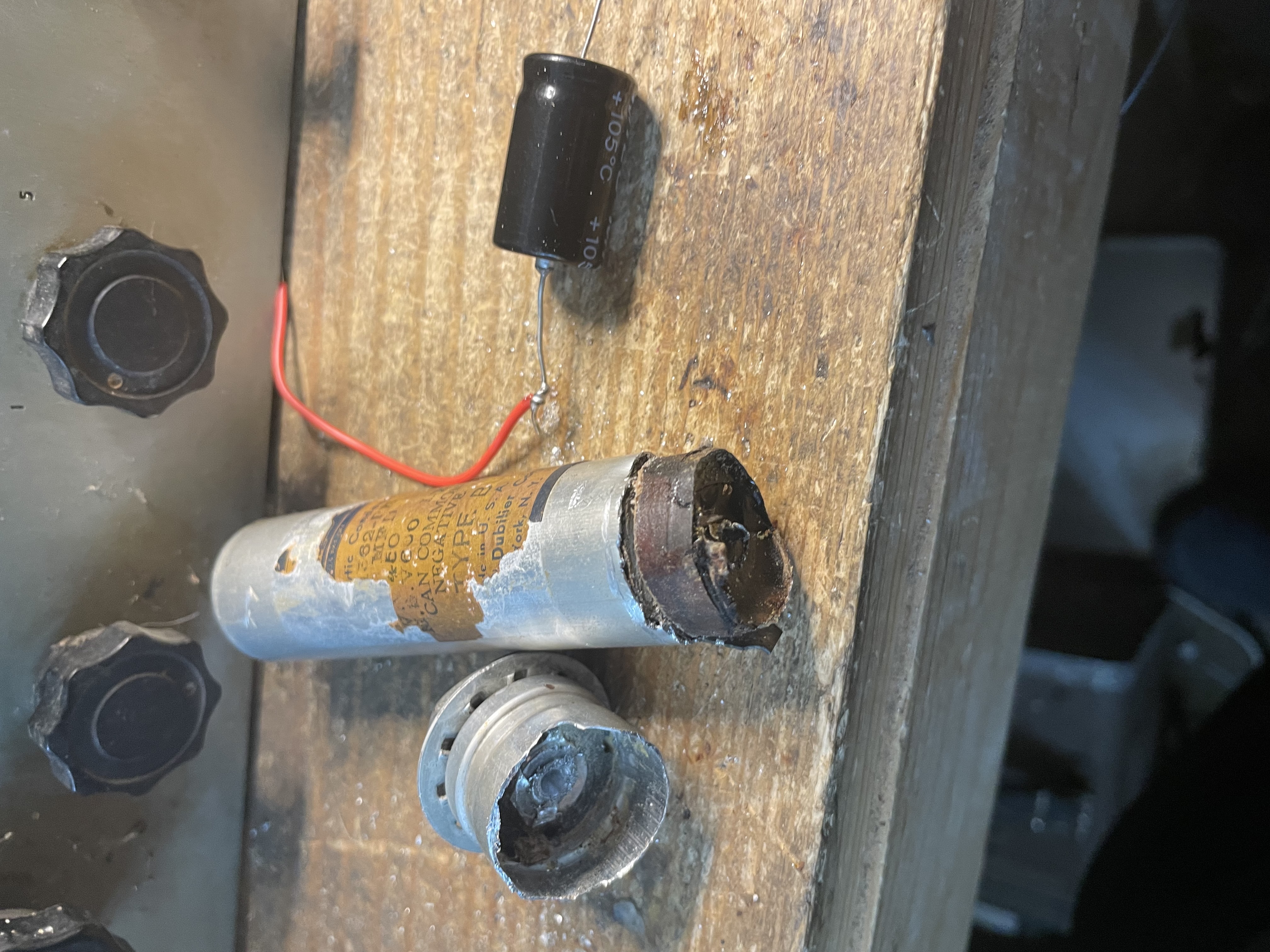

Did as suggested. Cut can with hacksaw, removed internals, attached new 8mf cap - with ample use of cardboard and electrical tape for insulation.
I did have to drill about 1/2 inch for positive lead into stud from inside because solder just refused to stick despite best efforts. I also drilled a small hole for the negative lead in the can to assure good mechanical connection. Put can back together with hvac tape. Since this is an aluminum can soldering won’t work but hopefully the strong mechanical connection is enoughtl
It tested at 8mf and infinite resistance between can and positive lead so it appears to have worked.

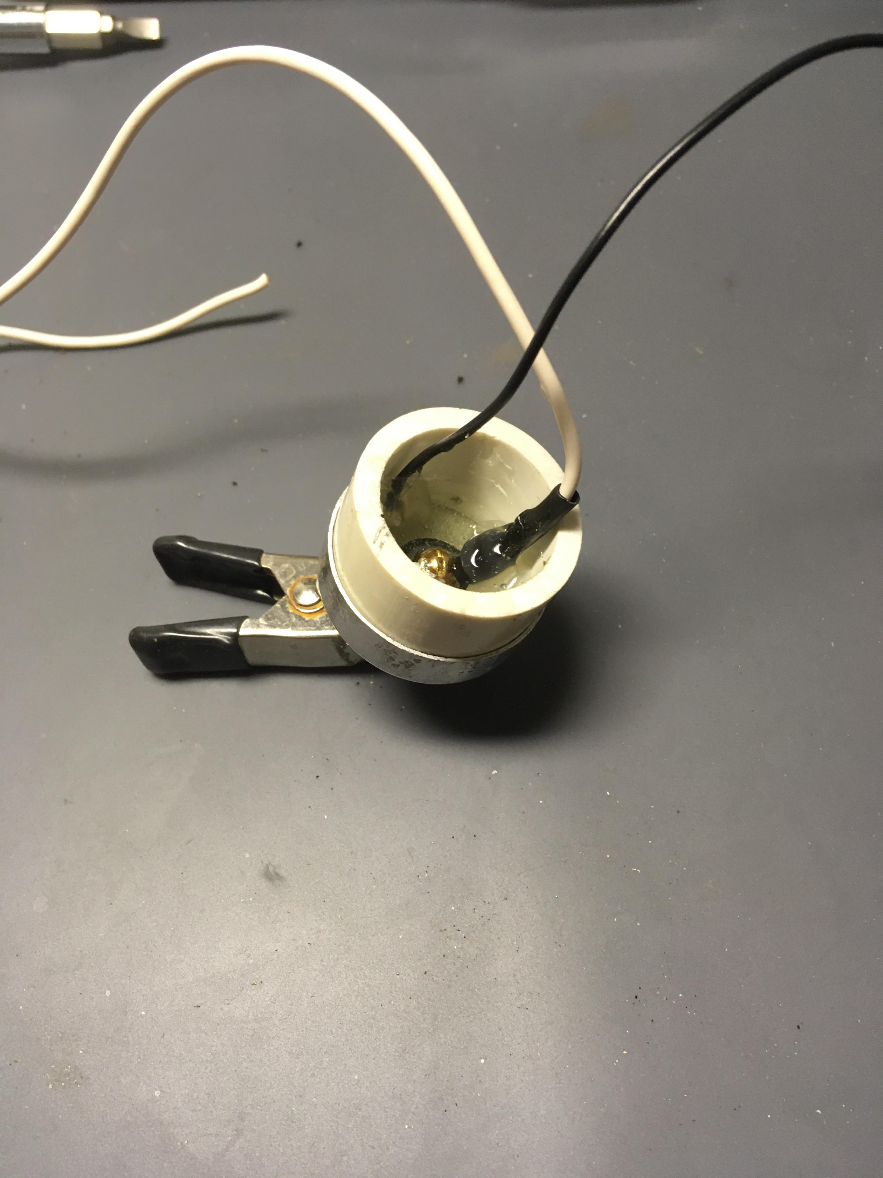

Here is a Photo of the base of Philco capacitor that I cut open you can see how I glued the PVC pipe into the base .
