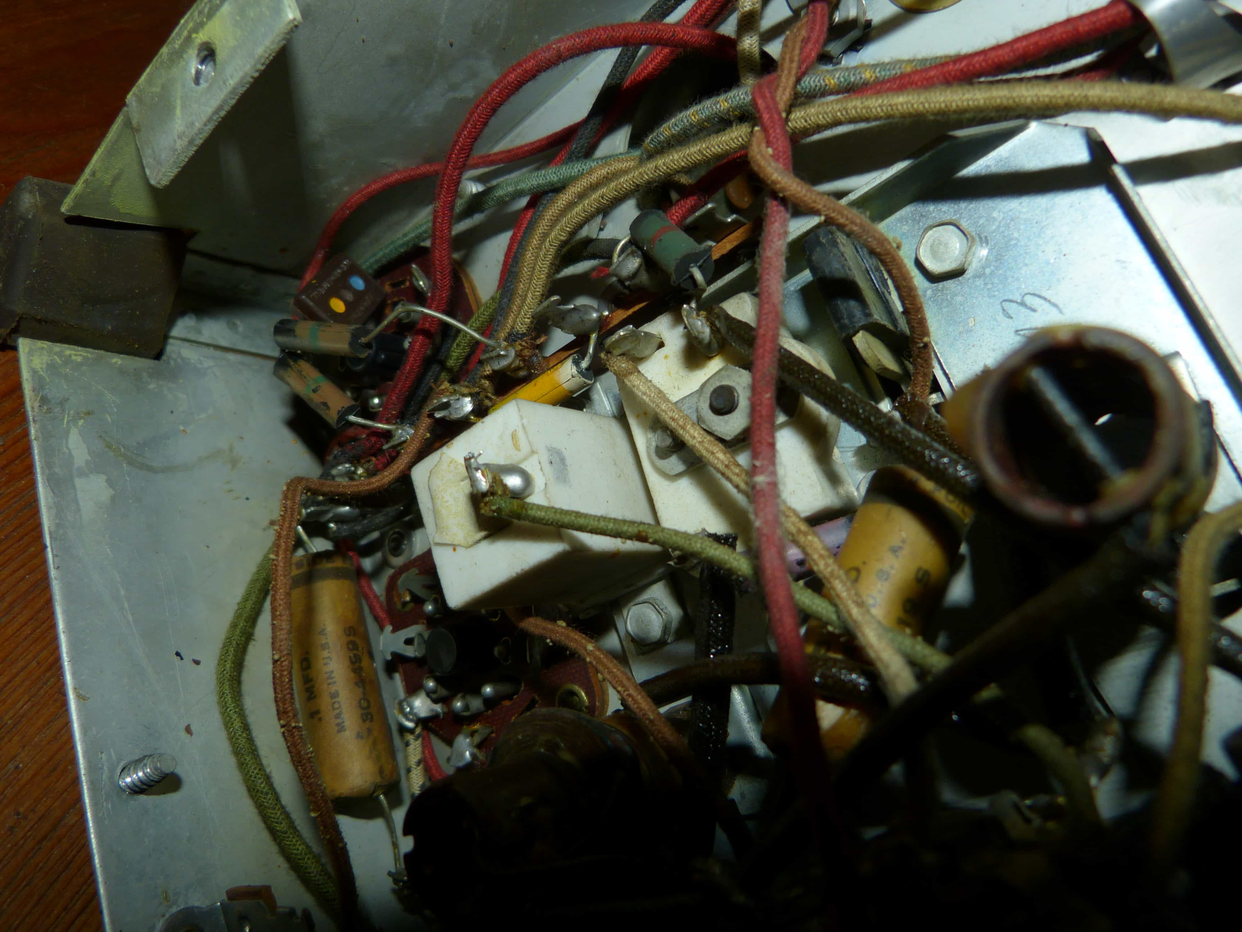

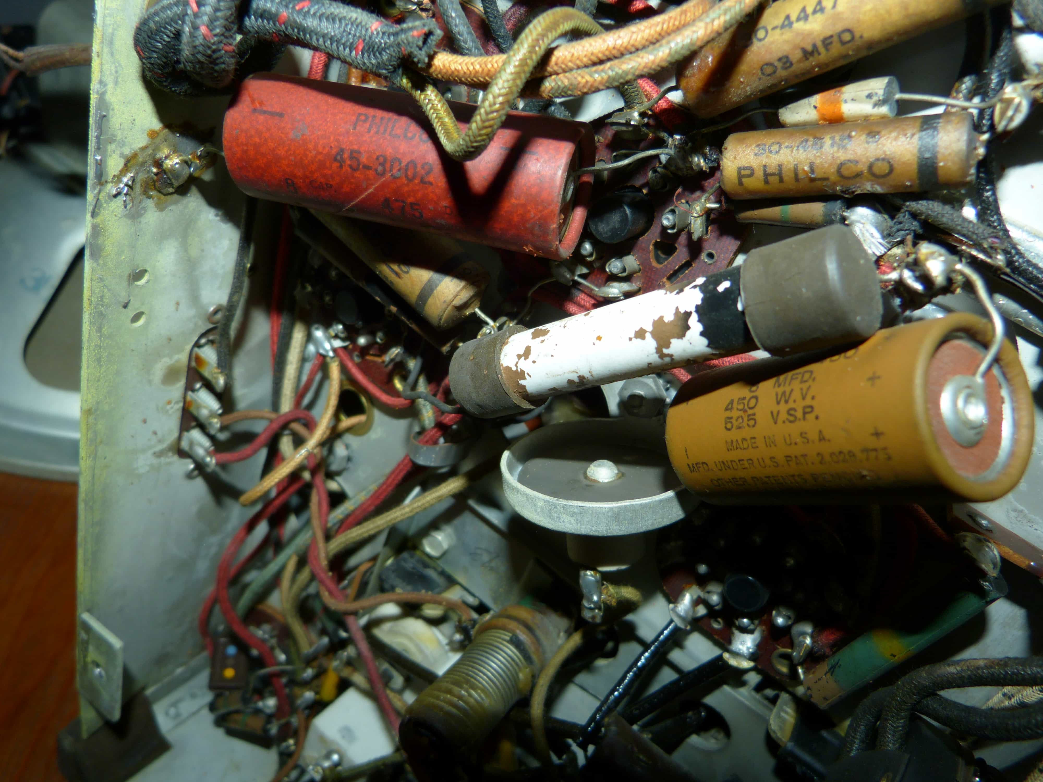

On those two parts you pointed out earlier, I can't tell what they are. Perhaps you can tell us where the wires on them are connected in the circuitry.
