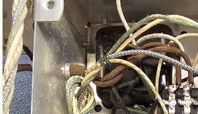

41-250 original plug/cord

I believe by 1941 Philco didn’t use cloth covered line cord anymore. I have a 41-250 that had the original cord and it was just rubber no cloth! BTW, it is a good performing set, enjoy!

I have to suspect that rubber line cords became popular by 1938 - 1940, as they were likely much cheaper to make than cloth covered cord.  Plugs were also rubber, either molded onto the cable (usually post-war) or an add-on, similar to the plugs used on the previous cloth covered wire.  Forzby T just posted a find of a 40-150 radio (with a really nice clean chassis).. The cord was rubber with a molded-in  strain relief.  Pic below:
