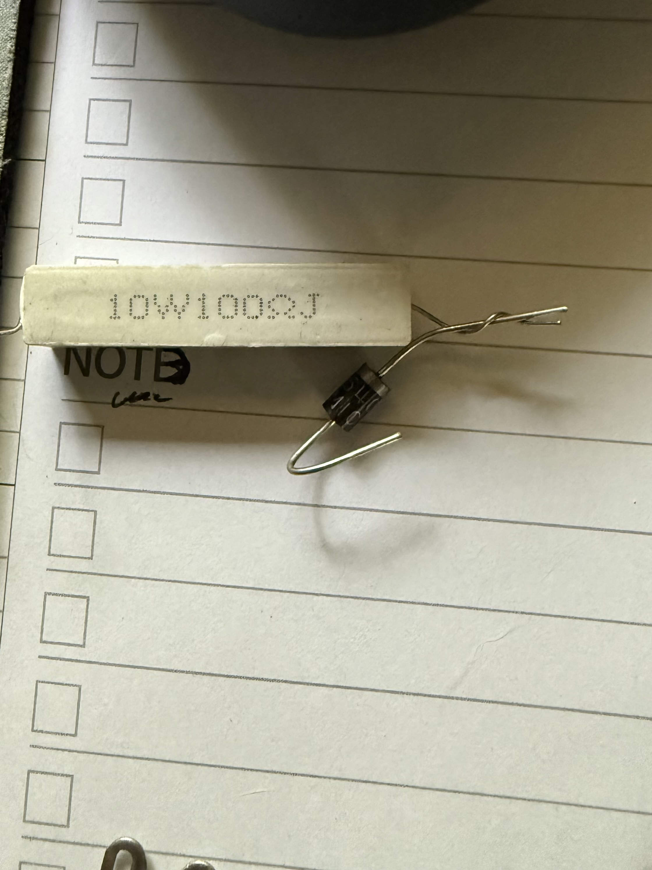

Here is what I  will be using and thank you fr the replies
Yep.
And, looking at the sch, the banded end goes to the right, and the black end to the left.
As for the resistor, see what it drops. The wattage should be sufficient.
