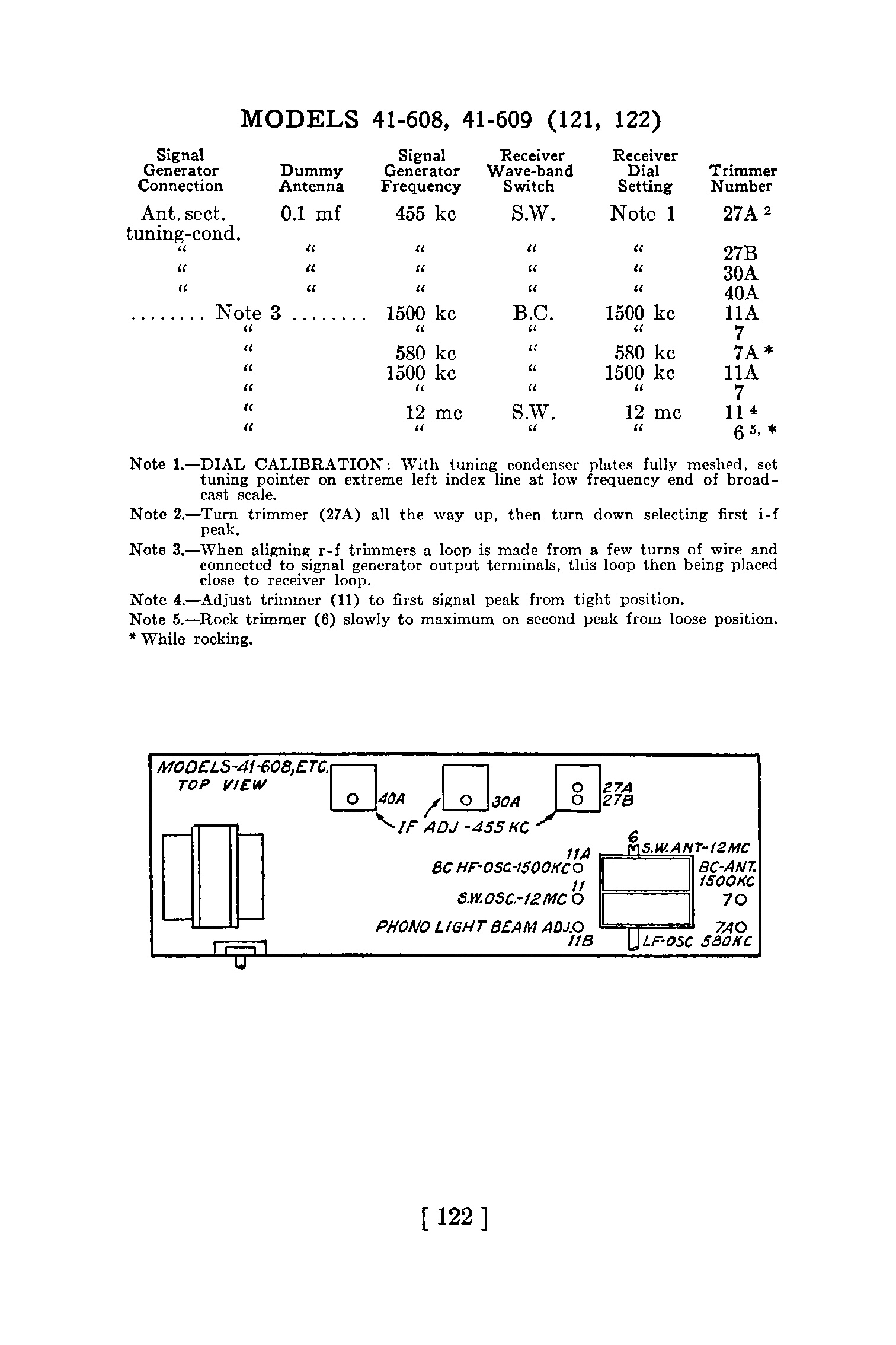

Answered my own question.  Hopefully this helps someone else out.  There is an adjustment for the BOL at 11B on the chassis.
