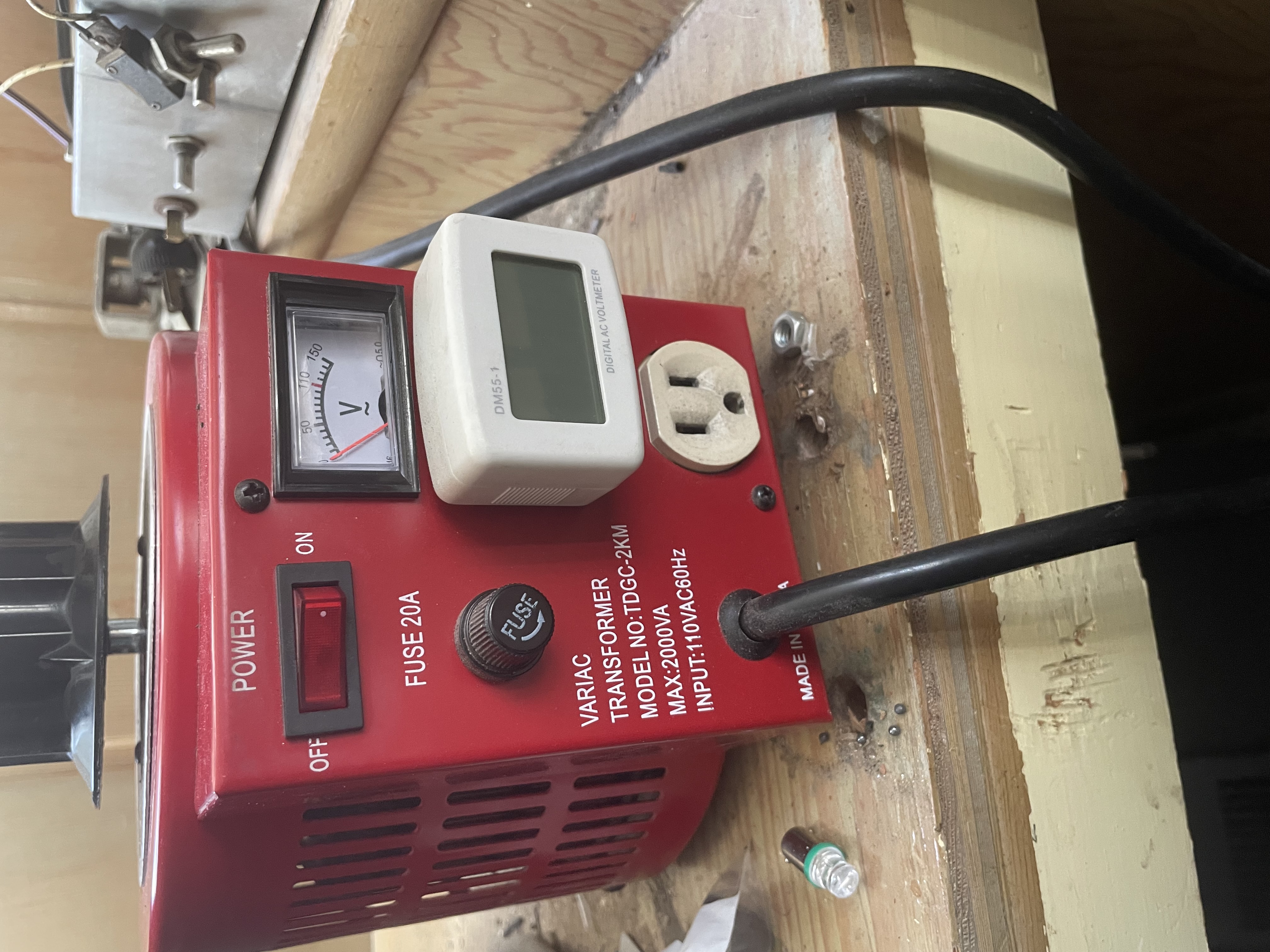

I’ve been using this cheap non-isolated variac feeding into a fused isolation transformer.
Not had any issues, - I’m sort of obessive about one hand in my pocket don’t touch anythinh but I’d like to upgrade to a nicer setup.

This is what I have. The Variac is plugged into it.
If you buy an isolated variac, it will likely have an undersized isolation transformer inside, so your power output will be limited. While enough for some radios, it might not be for the large ones.
Sounds like I have it set up properly then as I have it. I have the variac plugged into the gcfi fused line than plugged into the iso transformer which is also fused.

I have my isolation trans before my variac. Oh, and if you saw my variac, you probably wouldn't approach my bench at all! Icon_lol

If it works great - nicer than my current jury rigged variac/ammeter/voltmeter. Just using one of those cheap $109 chinese variacs off ebay and a home made iso transformer with a plug in voltmeter.

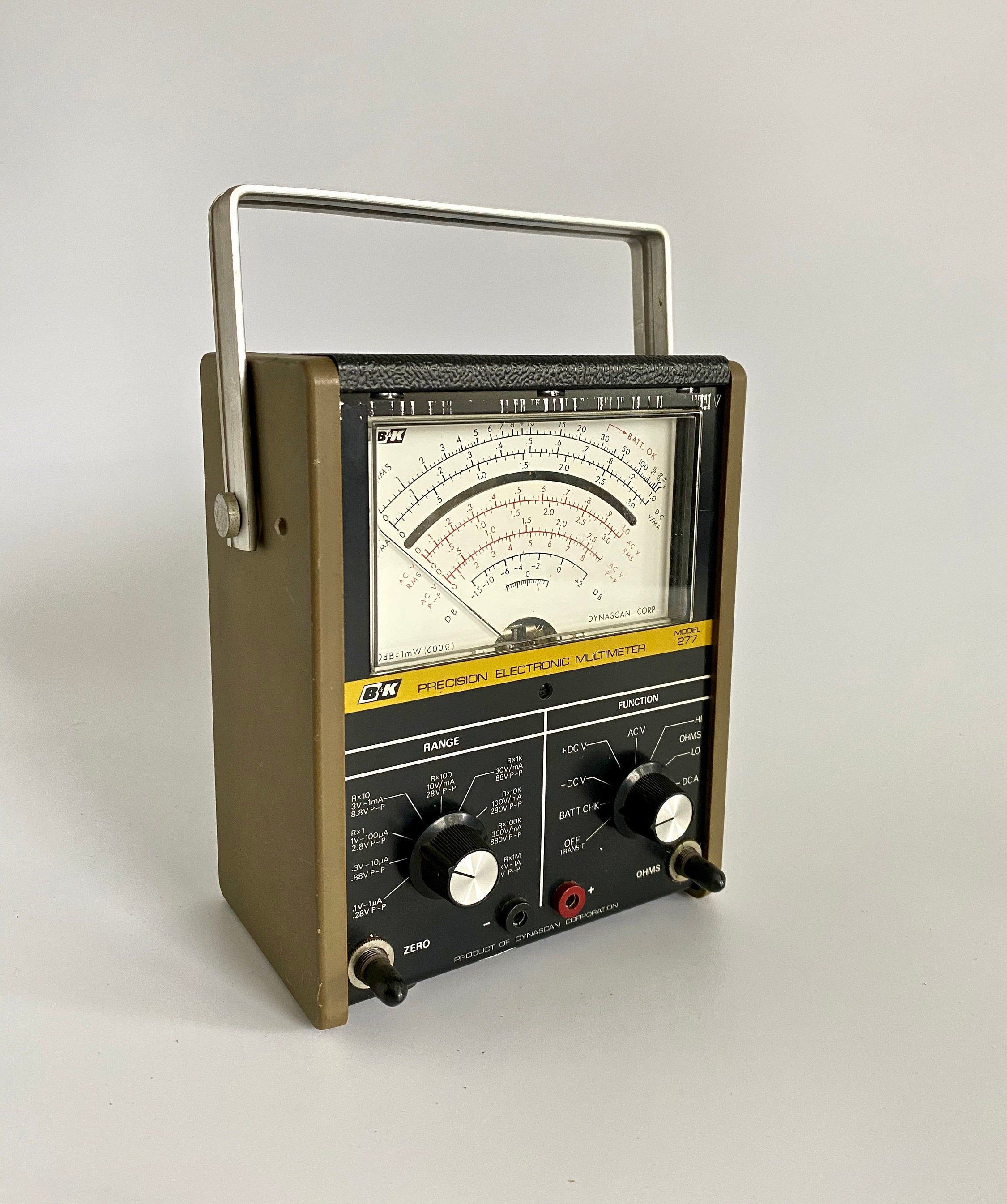

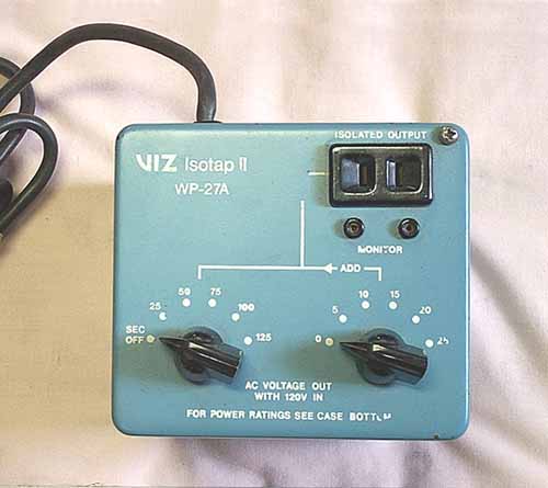

Bridkarl it sounds like you’re getting your shop setup in fine order. I am NOT digital savvy in anyway, old school here, and while there are some good features on these scopes I fear it would overload my old brain and make it difficult to to use. I do have a more modern, if you can consider 70s era modern  Icon_lolno solid state oscope dual trace 15 MHZ that works for me so far. As for a meter, I have a B&K 277 FET-VOM, a solid state version of a VTVM, it is super sensitive with a 15 Meg input resistance. As for an isolation transformer and variac, what I’ve been using for years is an RCA Isotap II that can be found sometime on eBay. It’s one unit that is an isolation transformer that the output can be varied in 5V steps from 25V to 150V all in one and I believe it’s good for 400 Watts.
