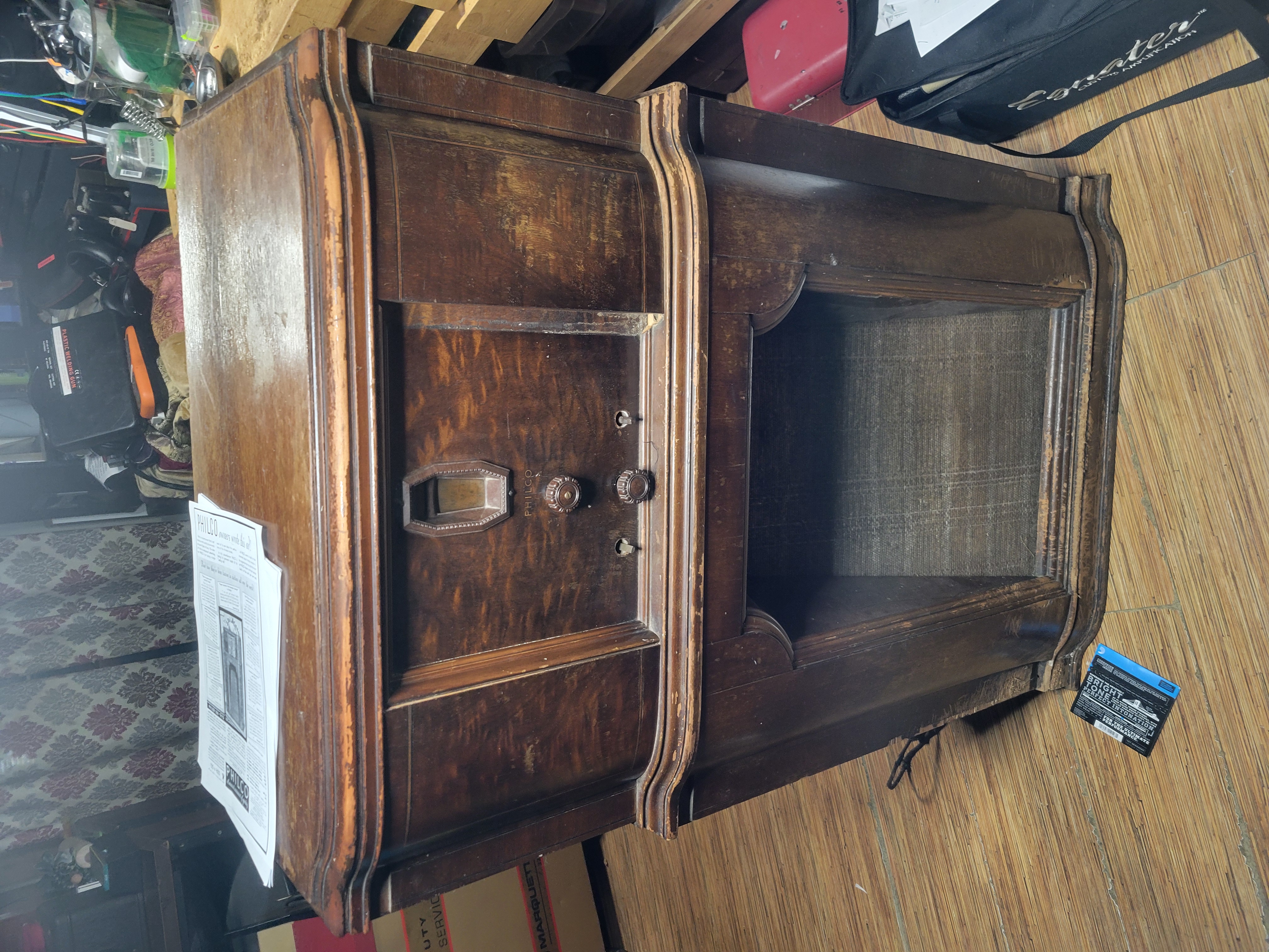

Flea Market 16x early find.
Hi everyone. I think this may or may not be my first post here. All the guys at ARF say you guys are great. I'm a bit of a radio novice but I've done about 20 including one model 89 so not a complete idiot, I'm an incomplete one (-:

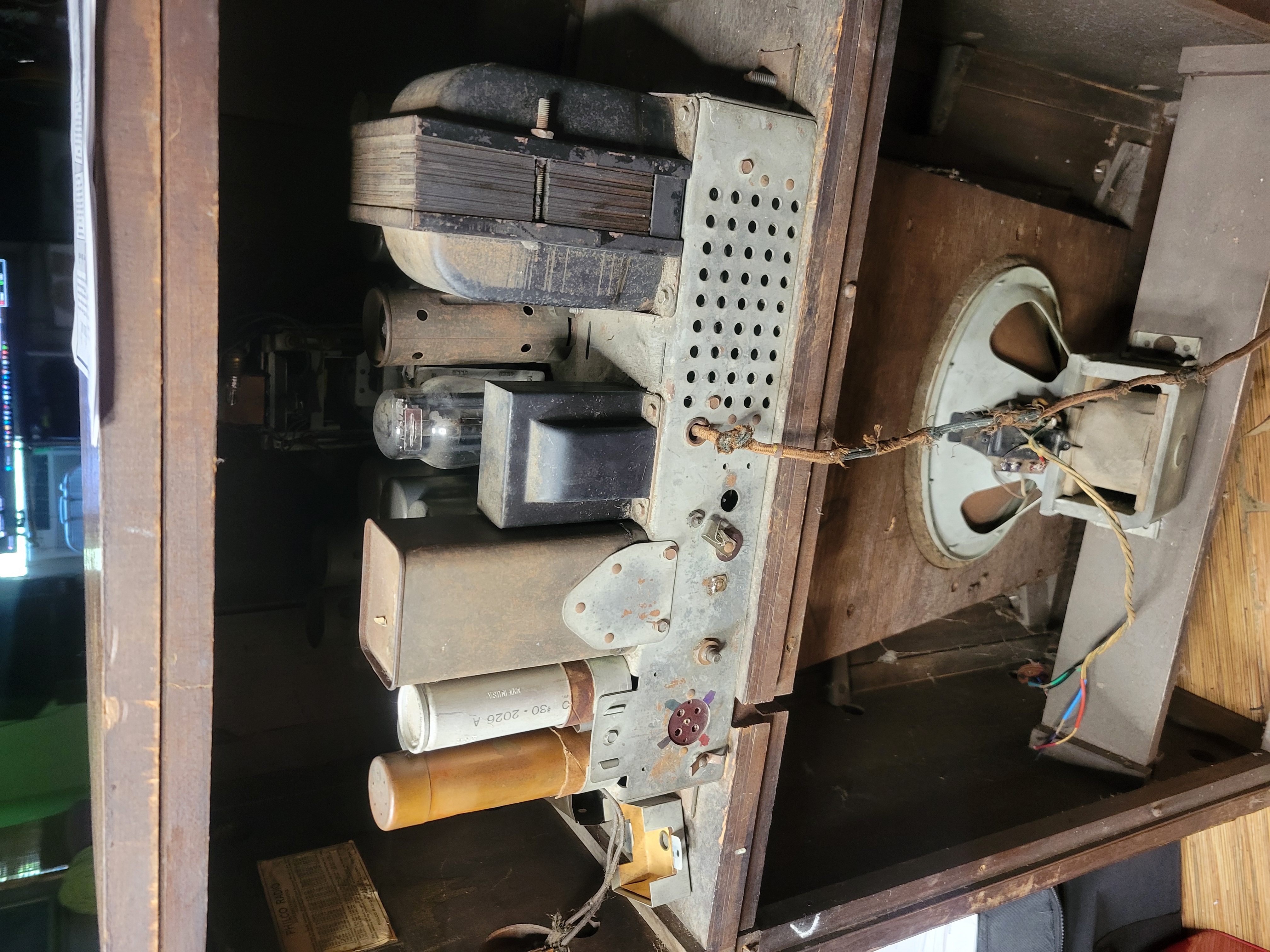

So far on this one I have found an open speaker transformer and that sort of brought my usual "starting from audio and working my way back method to a halt. If anyone know if I could get away with a temporary sub from another radio please let me know. What I planned if I cant do that is pulling the pair of 42 tubes out and working from there.
Please give me any tips or gotchas I should know about. I'm sure there are gonna be a lot more stuff. This old radio seems incredibly made. Practically have a guitar level power amp. (-: I'll post pics soon. Thanks yall.

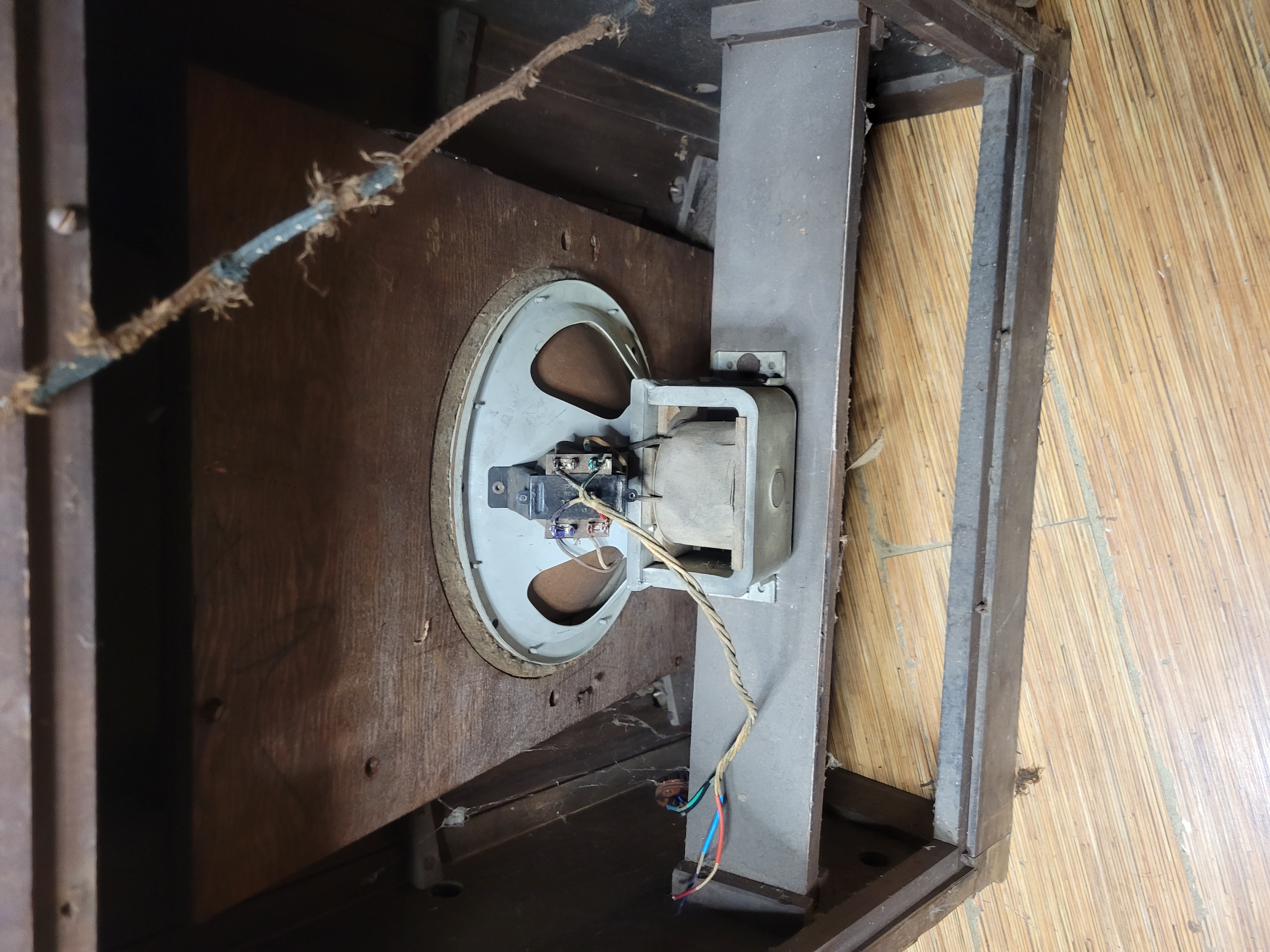

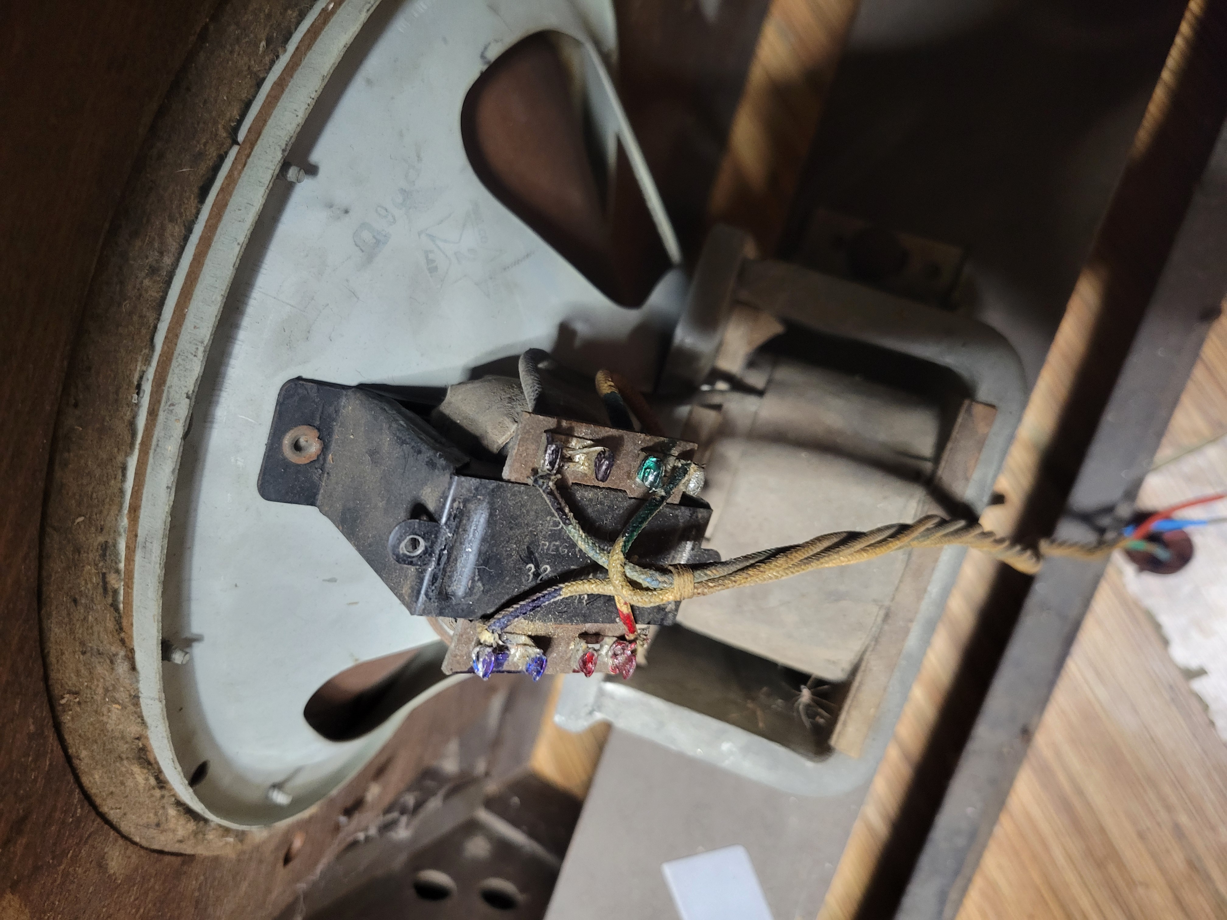

Could someone explain to me how the output transformer is wired? I have an open primary and I have aquired a possible replacement which has a 3 wire center tapped primary. Oddy I see only a 2 wire primary on the original and  only a 4 wire cable from radio  to field coil / output transformer-speaker.
Hey Pete,
The two end leads of the primary winding goes to the pin 2 of the two 42 tubes (plate pin). The common color code for these wires are brown and blue, red is the center tap which is connected the field coil. Philco has their code for wiring. The secondary are two stiff wires protruding from the lower side of the opt as I remember it. Here's something you'll probably need: https://philcoradio.com/library/index.ph...34-44-144/ As for a better diagram I don't know what you've seen but this one is pretty good: https://philcoradio.com/library/download...%20165.pdf  There's not a lot of choices as they all come from the same source.
Hi PeteLeoni,
Per the Philco service documents, the green and white wires are the 2 legs of the transformer primary.  These go to the plates of the 42s.  The green/white wire is common to the output transformer center tap and the field coil.  This wire connects to the junction of filter choke #85 and 8.0uF cap #88, the output of the rectifier and filter.  The final wire, blue, is the output of the field coil and connects to the junction of 2.0uF cap #62B and 7.750 Ohm resistor #77.  This is the B+ supply to the rest of the radio.
Ignore the color dots for now; they were not placed there by Philco, and may not accurately represent the modern color coding that Rod describes.  Since the colors of the wiring are quite faded, you can do the following:
  • Ohm between the 2 wires on the right side of your speaker.  The reading should be about 1400 Ohm.  If so, this is the field coil and the darker wire is the "Blue - White" wire described in the schematic.  The other lighter color wire is common to the center tap of the transformer and the field coil.
  • Ohm between that "common" wire and each of the other 2 wires.  You should get readings that are approximately equal (there can be a 50 - 100 ohm difference.  These are the "legs" of the output transformer that connect to the plates of the 42s.  BTW, I don't think that the resistance value for the output transformer primary stated in the schematic (5300 Ohms) is accurate.  That may be the impedance but it is not the resistance.
