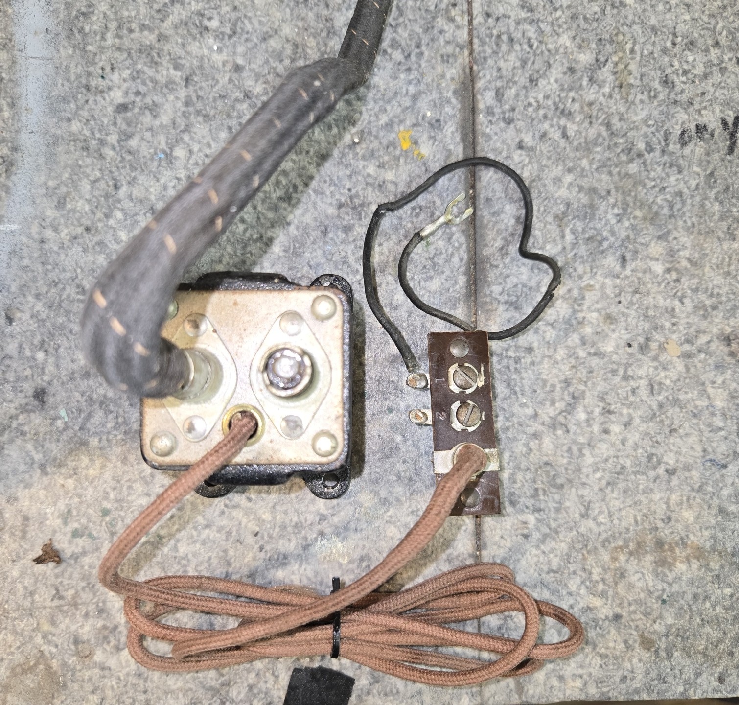

Hello, I am restoring a Philco Beam-of-Light phonograph with an HR-1 record cutter/recorder. It's the Model 41-608 radio/phono. Everything seems to be powering on, but I am not getting any sound from the speaker when playing a record. I suspect that maybe the transformer that connects to the BOL arm my not be functioning properly. Questions:
1. Is there a replacement for the Philco d 32-8148m transformer on the market?
2. If worse case scenario, can I replace the pickup arm with a traditional needle arm?
Thank you for any help in advance.

The source lamp is working and the mirror is attached. The light beam is hitting the sensor. Thanks

You can check the transformer by ohming between ground and the transformer side of cap #51 on the schematic. (Per the schematic, this is an "autotransformer", where the primary and secondary are actually the same winding.) You should get a reading. Then read between the 2 photocell terminals. You should get a lower reading. However, I don't know what those readings should be. I think that part of the reason for this transformer is impedance matching, and the other reason for the transformer is to filter out the high frequency AC driving the source.
Also verify that the needle does move and that somehow the needle / mirror mechanism has not frozen solid. However, I think that it is suspended in rubber so there should be some compliance.
One other thing. The phono preamp is used solely for the BOL pickup. It is not used by any other part of the radio. So it could be that the BOL is good but the preamp is bad. Try touching the same junction between the autotransformer and Cap#51 with a screwdriver while touching the shaft. This should inject a hum into the amp. If you do not hear a hum, try the other side of the cap. If no hum on either side, troubleshoot the preamp. If you hear a hum on only on the tube side of Cap 51, the transformer may be shorted. The preamp tube and the detector / 1st AF amp are both type 7C6 so you can swap them. In addition, Loctal sockets and tube pins are notorious for getting dirty and intermittent (I don't know why 7 and 9 pin miniature tubes don't have the same issue).
