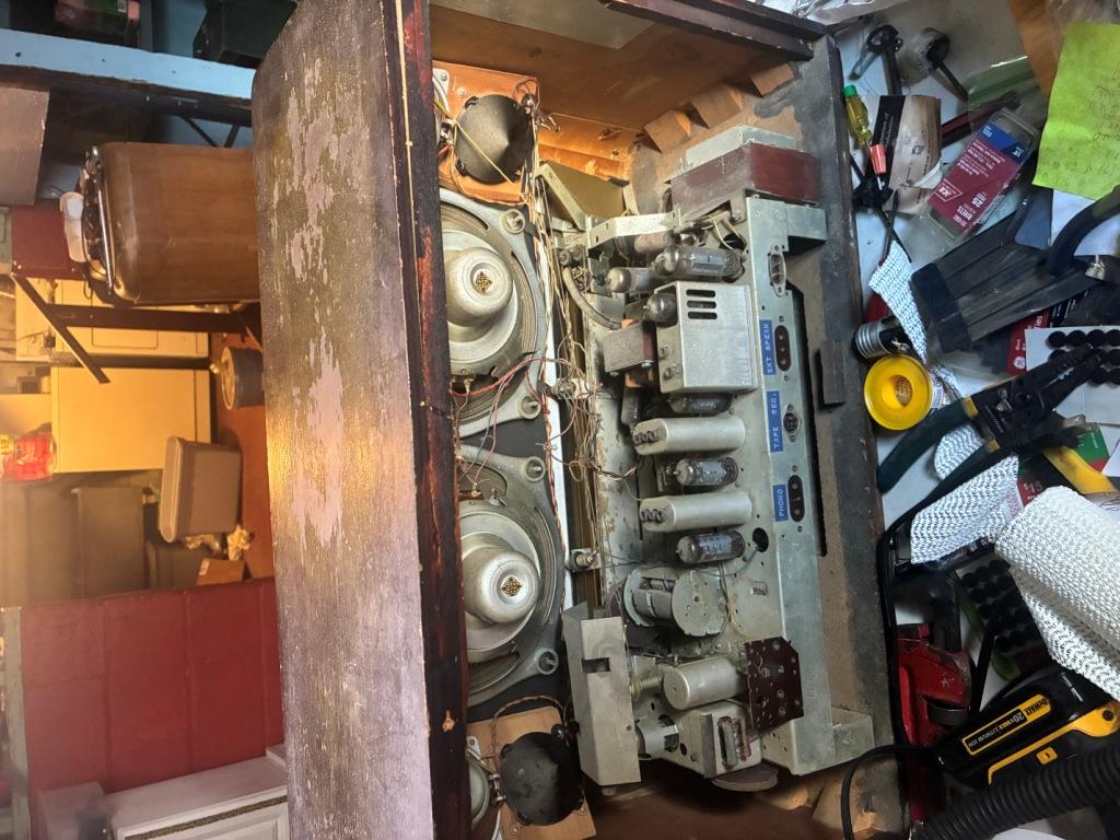

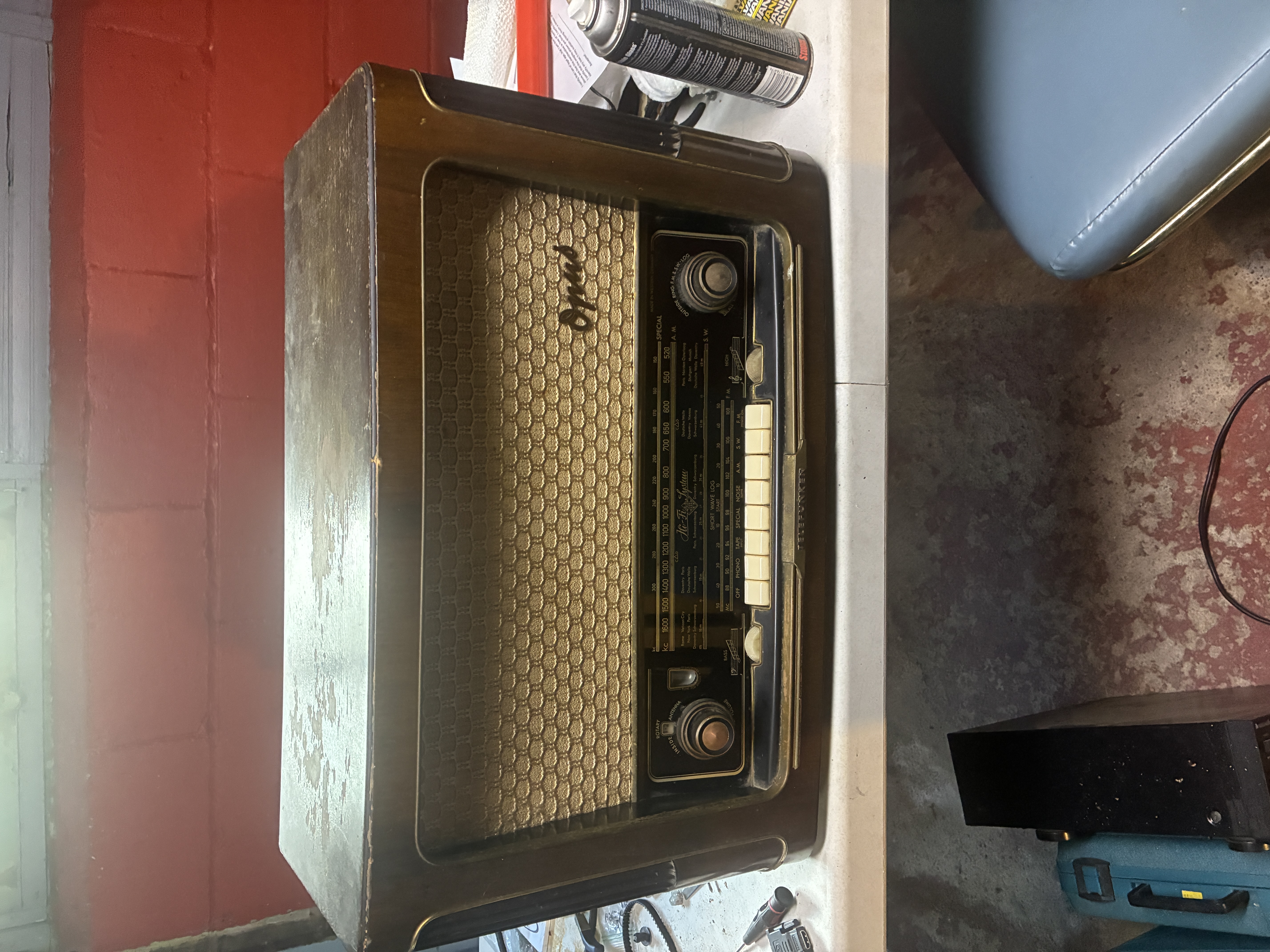

Hello everyone, today I bought a 1955 Telefunken Opus 6 from Facebook Marketplace for $60 and I am in need of some parts for it, specifically the back cover with the interlock cord assembly attached, and possibly a replacement case, as the case on mine is damaged on the back where the cover is supposed to go, and the cabinet on the top is in bad shape as it had suffered from water damage from what I assume to be an old flower pot sitting up there.
Also, where does this model sit in the Telefunken Model Line up and how does it compare to the other German radio companies and their models?
See Pictures below.

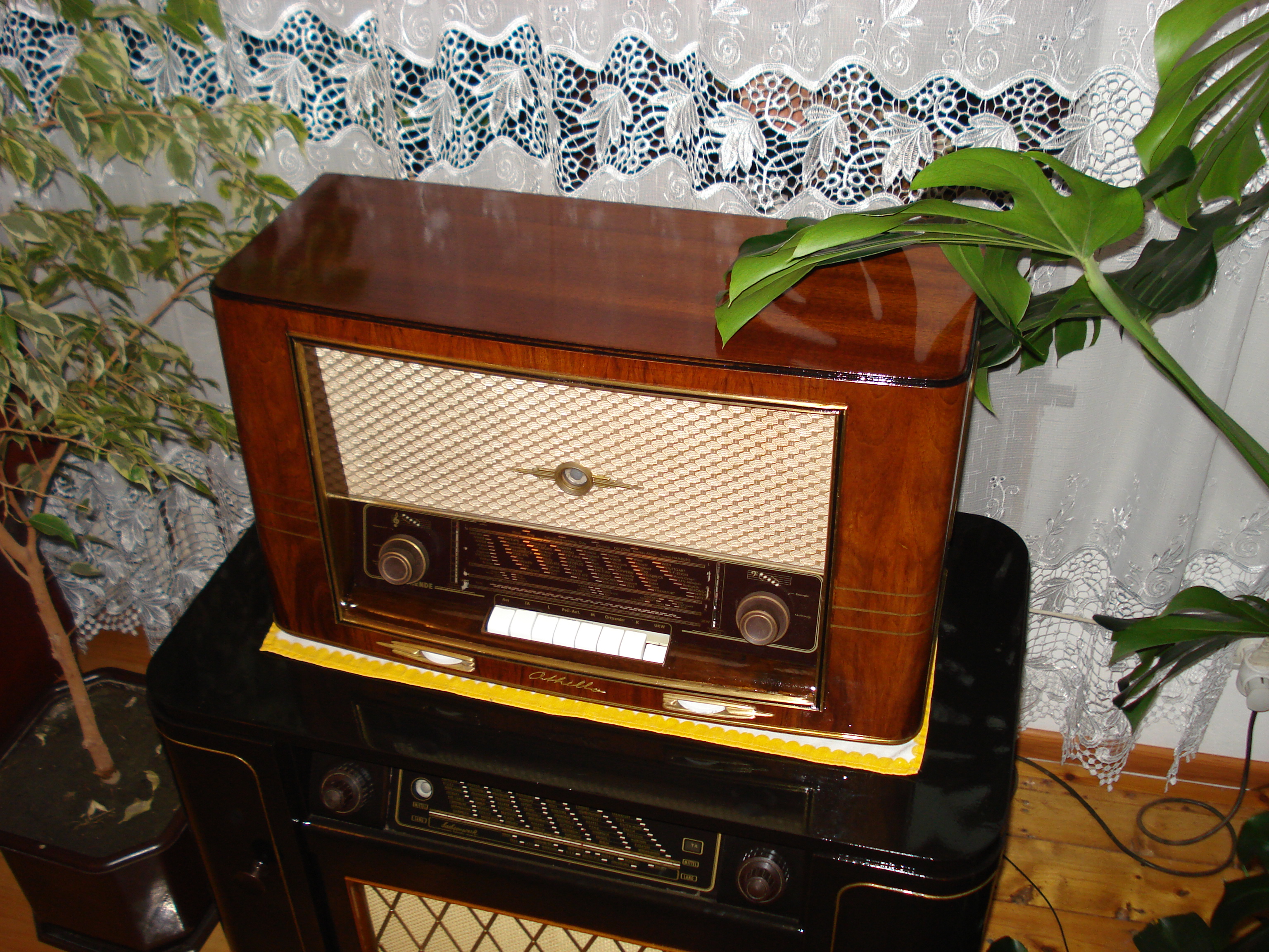

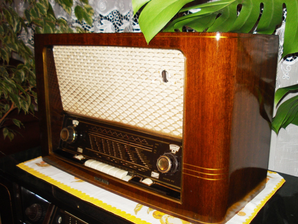

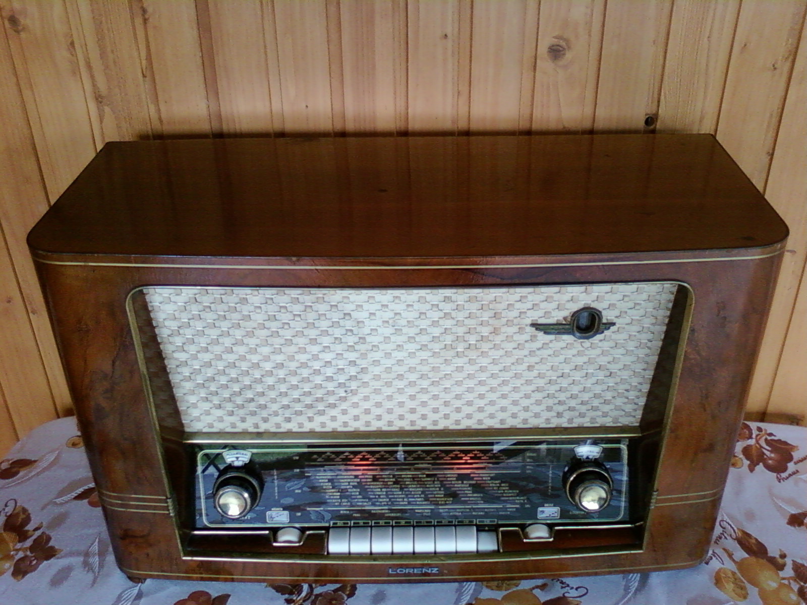

Hello. Your Telefunken is in perfect condition for a German top radio from the 50s, bought for $60. There are no such low prices for premium Telefunken even in Europe. Judging by your photos, the repair of the body of this radio will take a maximum of a week and in Ukraine the cost of materials for restoration would be limited to another $20...$30. Plus the cost of your work. I think this is a find. Yes, you will have to work hard with your own hands, but if you try hard, you will get a diamond for the price of a cheap plastic decoration. The main thing is not to rush and very carefully remove the remains of the old varnish and carefully sand the old veneer so as not to remove too much. But if you do not have experience working with wood, it is better to trust a specialist so as not to spoil this receiver. Here are links to three German radios that were in a similarly deplorable state and that I restored about 10 years ago.
[Video: https://www.youtube.com/watch?v=PPsovgo_...1&index=96]
Sincerely Peter
З повагою Петро
Thank You Sir, I appreciate your advice, I do have some experience with woodworking, and refinishing cabinets, but the part I was concerned about the most was the back cover and trying to find a replacement, so I don't have to worry about dust getting inside the cabinet, and the pieces of wood that were broken off the back of the cabinet that were from mounting the back cover onto.
The electronics part I don't think should be too hard to do, as the previous owner said that the unit was functional about 6 or 7 years ago but when he tried it a few days ago it had a loud hum, which I am assuming is the filter caps failing.

I think that for $60.00, you have made a lot of collectors of German radios quite jealous. I only have one, A Telefunken Allegro "Stereo". Actually, it is only Stereo for external inputs like Phono or Tape and the amps are not equal.
This seems to me to be a "High End" model. Yours seems to have very nice "bilaterally symmetrical" speakers. Are those "electrostatic" tweeters? It also looks like you have Push-Pull EL84s (6BQ5s) with hefty power and output transformers. I would not be surprised if this radio has between 5 and 10 watts output. It should "rock"!

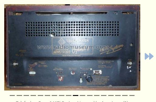

There are You Tube videos about this set.  It is listed also on Radiomuseum.  A picture of the back panel is listed here:

Schematic on last page. Symbology in German schematics (or Europe in general) is different than American but not too hard to figure out. Single line such as "|" or "_" indicate ground or chassis common. Resistors are rectangular boxes. Caps and diodes are as we expect. Tubes are somewhat similar. Do replace the electrolytics and all other caps, especially coupling and bypass caps. Consider replacing the rectifier bridge, as it may be selenium and likely prone to failure (at least American ones were).
According to Radiomuseum, this set puts out a whopping 15 Watts!  And that is likely an honest value, judging on the size of the power and output transformers, not like the party speakers that advertise a maximum peak power of 1000 watts (possibly into a dead short for 1 microsecond before the output transistors vaporize).

I'm hoping I can find a back cover for this radio to complete the radio, so that the radio will sound halfway decent, or else get some 1/8" plywood that I could paint to look similar to the original back (and have someone paint the lettering onto the back of the cover for me, so that it looks like the original back.)
Hello, I have one of these that I restored a few years ago, I still have it not for sale. I wish I knew where to get a back for you. You could make on but not the same.

You should be able to find a 4' x 4 ', or even a 2' x 4', piece of 1/8 inch hardboard (AKA Masonite) at a home supply store like Home Depot. Usually one side is finished smooth. Don't button up the back too tight, you'll want the heat to escape. I did a restoration of a Grundig that had been in a garage for 30 years several years ago and it came out gorgeous. I didn't use any toner, just sealer and clear lacquer.

I think if I were to use a piece of masonite board for making a new back, I would try to drill holes in it following the same or a similar pattern to the original back.

BTW, I don't think that not having a back would affect the sound much. It's not like this was a tuned port or acoustic suspension speaker system; it was much like the American sets of the time. Nonetheless, with 15 watts, 2 woofers, 2 midrange and 2 tweeters, this thing would out-rock any American table radio of the time.
