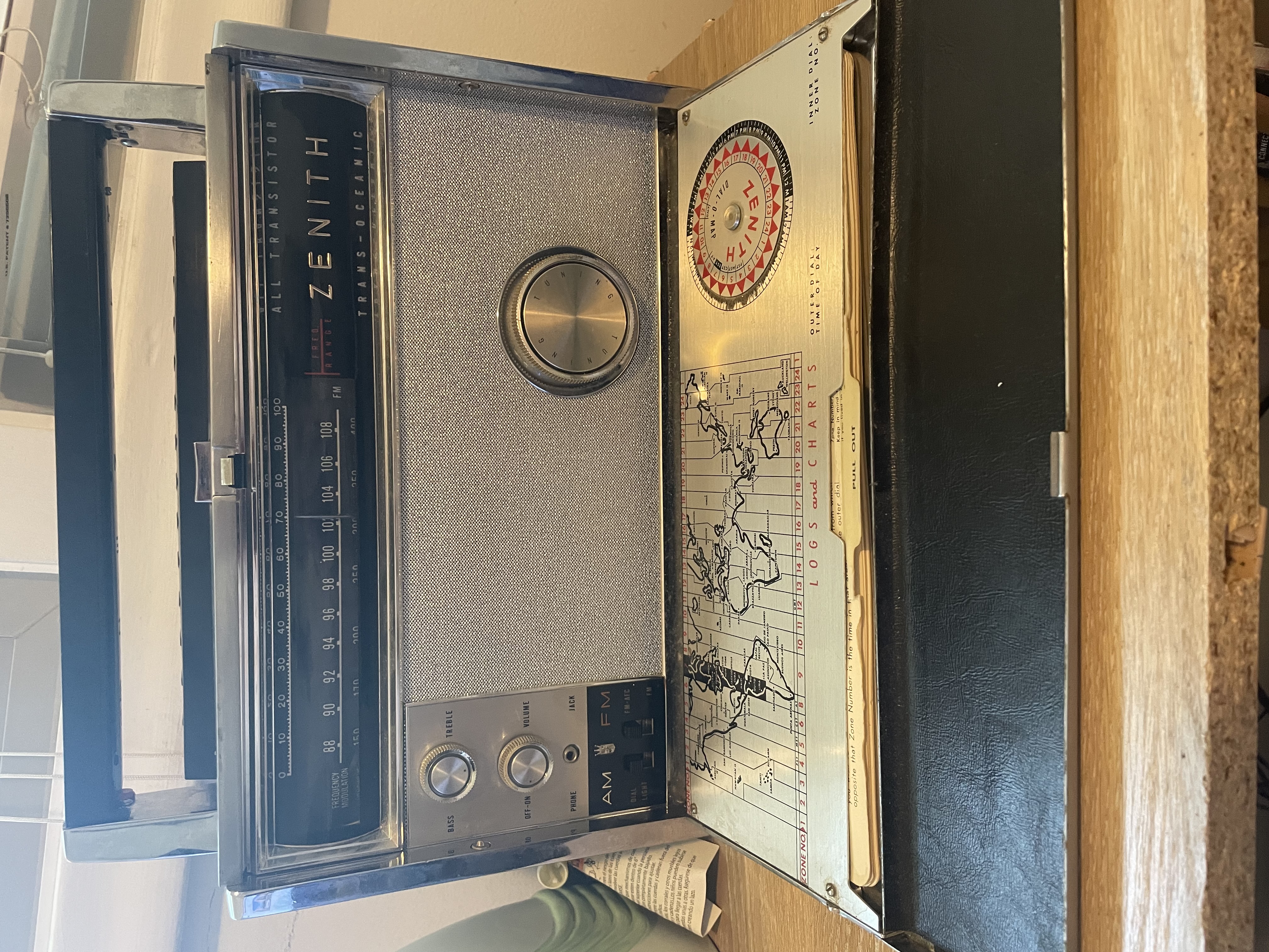

Picked this up today. Works ok on FM and SW.
Broadcast AM seemed dead but exercising the bandswitch and it works now.  Otherwise complete with antenna and interior book and a working dial light.
I’ll have to read up on this model to see what needs doing.

$60.00 is not a bad price, especially for a partially working one. Chrome looks pretty good too, MUCH better than mine. These are rather collectible. I hear that the 1000s and 3000s are desirable but the 7000, the last of these are a little bit of a doggie and are not US built, so seems to me that you scored!
Considering that the set is 60 years old, consider changing all of the electrolytics. If using in a car with an adaptor, remember that this is a Positive Ground set. All the transistors are PNP germanium.

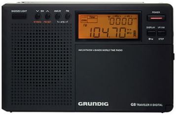

Pic of the Grundig G8

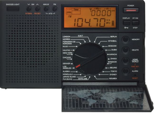

The Eton branded replacement:
This is a rather nice radio.  With earphones, FM is in stereo. Nice world clock function, and of course, no World Band radio would be complete without a map of the world.
