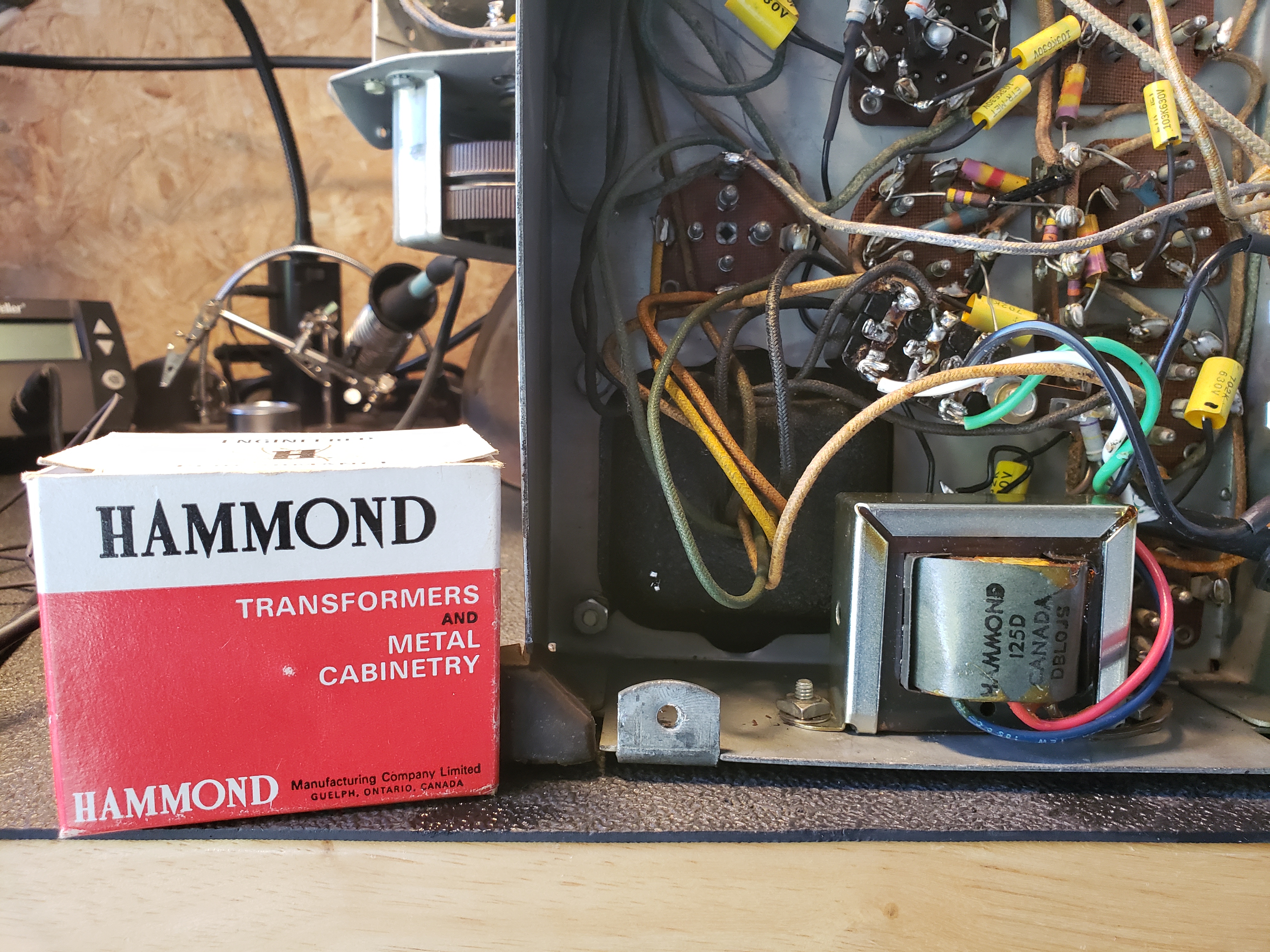

I was able to get a Canadian made NOS Hammond 125D new in box for $25 CDN!

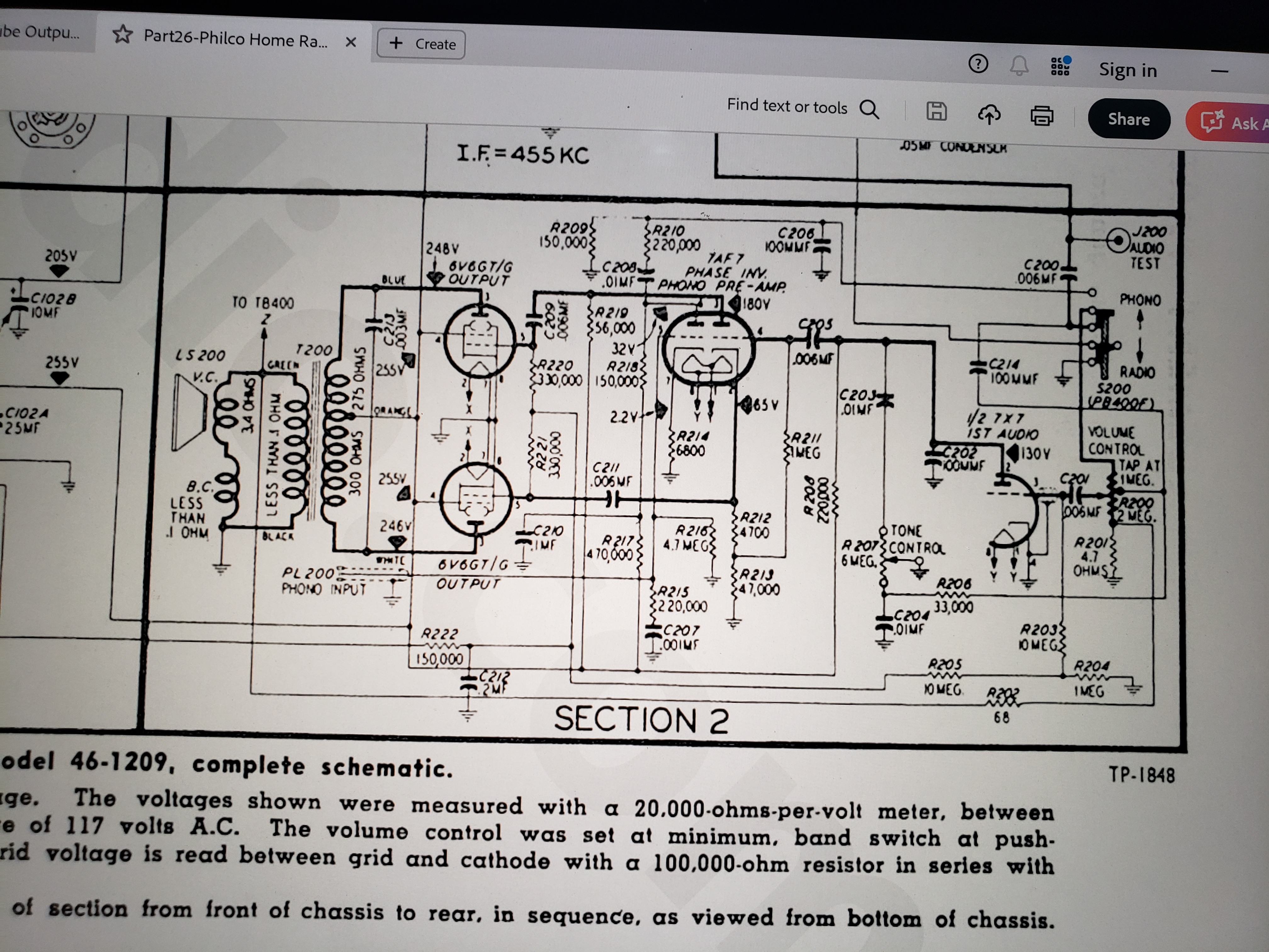

Per Ron's comments in forum post  https://philcoradio.com/phorum/showthrea...edback+tap I used the attached schematic for the 46-1209 feedback replacement.  I started by using a 4.7 ohm (R201) and 68 ohm (R202) as per the 46-1209 schematic and found a sharp squeal at low volume.  Then I used an 82 ohm for the R202 and it worked great.  For fun I moved the R202 up to 100 ohms but the sqeal came back.  Returned to the 82 ohm and I am quite happy.

The interesting thing is that this does not appear to be negative feedback, it appears to be positive feedback. I may be wrong counting stages and figuring whether the feedback is negative or positive. I am used to seeing feedback being put into the cathode of a first audio stage. I will have to dig up some old Heathkit HiFi schematics. It is not common to find feedback circuits in "popularly priced" radios, but people were also not used to finding technology like the "Beam of Light" phono pickup that Philco used in the early 1940s or the GE RPX magnetic cartridge that came later which was the basis for modern magnetic pickups. These distort much less than crystal or ceramic pickups.
