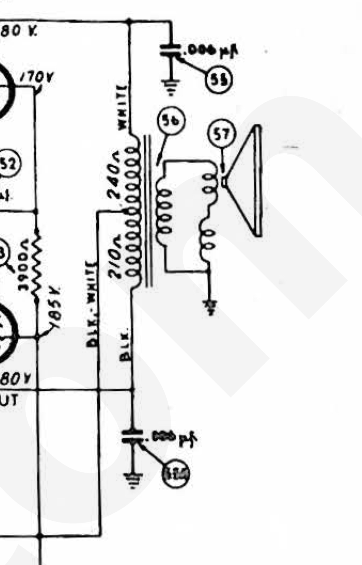

40-155 transformer output

Replaced the tubes. Powers up with about 40 watts usage. Zero audio. Going to start working backwards from the speaker. I’m starting with the assumption the audio transformer has an issue so I’ll use my ohmmeter and check the windings.

replacing bad rubber wiring. The wiring on the speaker was bad so replaced that. Also the audio transformer showed short so replaced that. General check of work to date, reflowing soldering, checking wires in right places.
