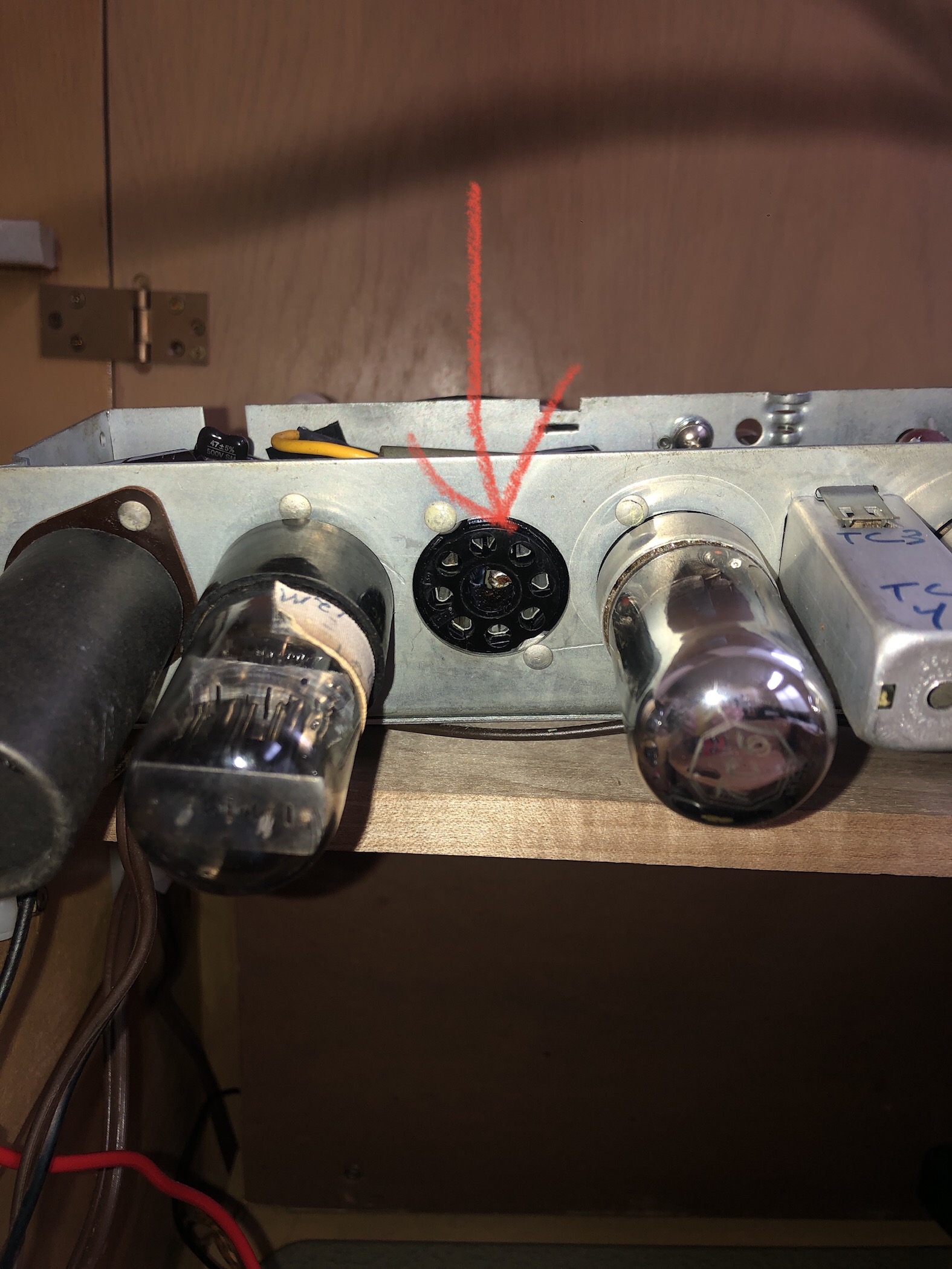

For my Philco 53-1750,  the 8 pin socket for the  35L6GT tube just won't hold the pins tight and causes intermittent poor connection and therefore, crackling and/or squealing.  If I hold the tube in there tight, the radio & phono work just fine.
Not sure where to find a new replacement socket for this old tube type.  Besides just replacing the socket (which looks like it might be real pain in the #$#%#% -  are there any other tricks for tightening up the socket receptacles or making the tube fit tighter?  Thanks.

You can try to tighten the pins of the existing socket by wedging a jeweler's screwdriver, pick or other small tool between the contact and the cavity that it resides in.  Then use Caig DeOxIt D5 contact cleaner on the socket.  Be sure to thoroughly dry the socket before reapplying power.

For those who may run into a similar socket issue - I solved the problem without replacing the socket.  I simply took an Optical screwdriver (small,  flat blade) and was able to bend the metal tabs inward so that the open end of the receptacles in the socket are closed or at least closer to each other - thereby tightening them up.  Now, the tube fits in there nice and snug with perfect contact of the tube pins and the radio now is perfect.

I likely would have done the same as you did, but if let's say that didn't work you can actually remove, and replace the terminals on many of those molded sockets by unsoldering the terminal from the bottom, and pushing it through the top, reversing the procedure with replacement. If it would have been a wafer socket it's easier to push the contacts closed, but those tend to flex, and bend, I really do not like them much. If the contacts were pushed out and loose that's often a mark of a high hour set where there were lots of tube changes, but I wouldn't have thought that on a radio-phono combo unit.
Replacing a socket outright is a pain, you need not only a socket that will fit in the large hole correctly, you also need the right spacing between the rivet holes.
