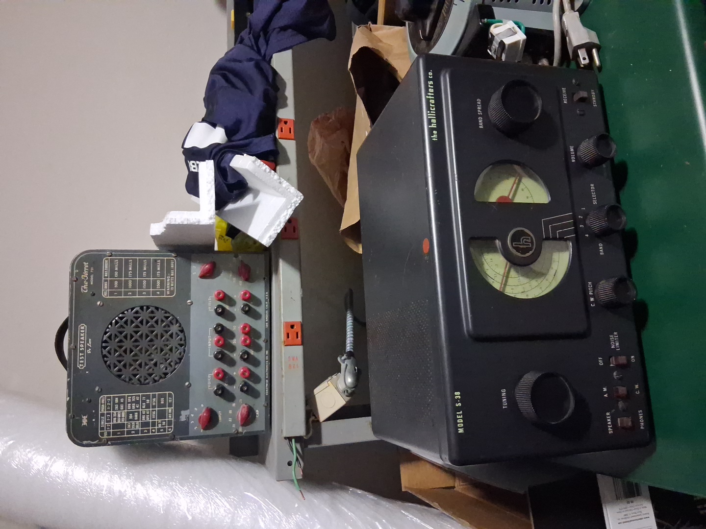

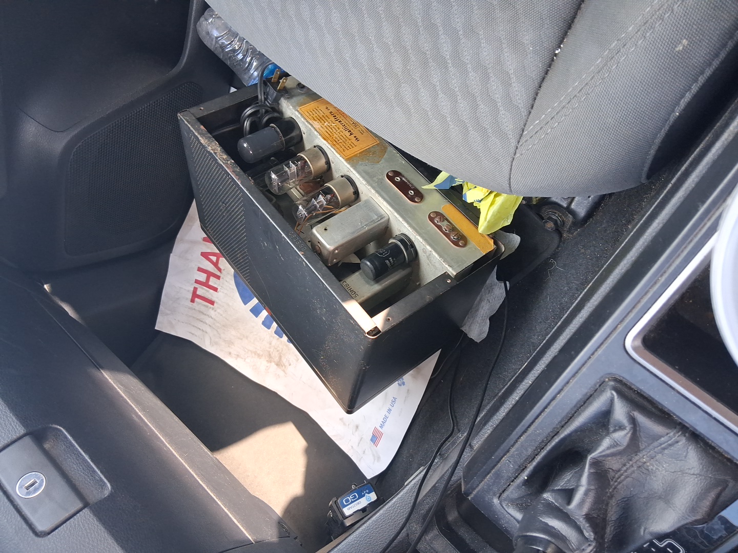

Hailcrafter s-38

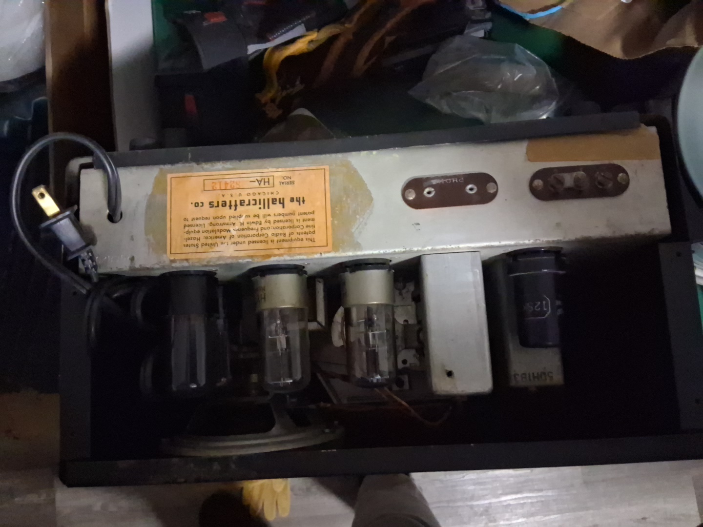

Bought from a citizen
Yup S-38 alright. It's missing it's back cover which may be kinda important. The chassis and cabinet are insulated from each other because the chassis poses a shock hazard. When servicing it do use an isolation transformer between it and the wall socket. I've worked on a few of them and their old siblings the Echophone EC-1 and the Hailcrafters S-41.

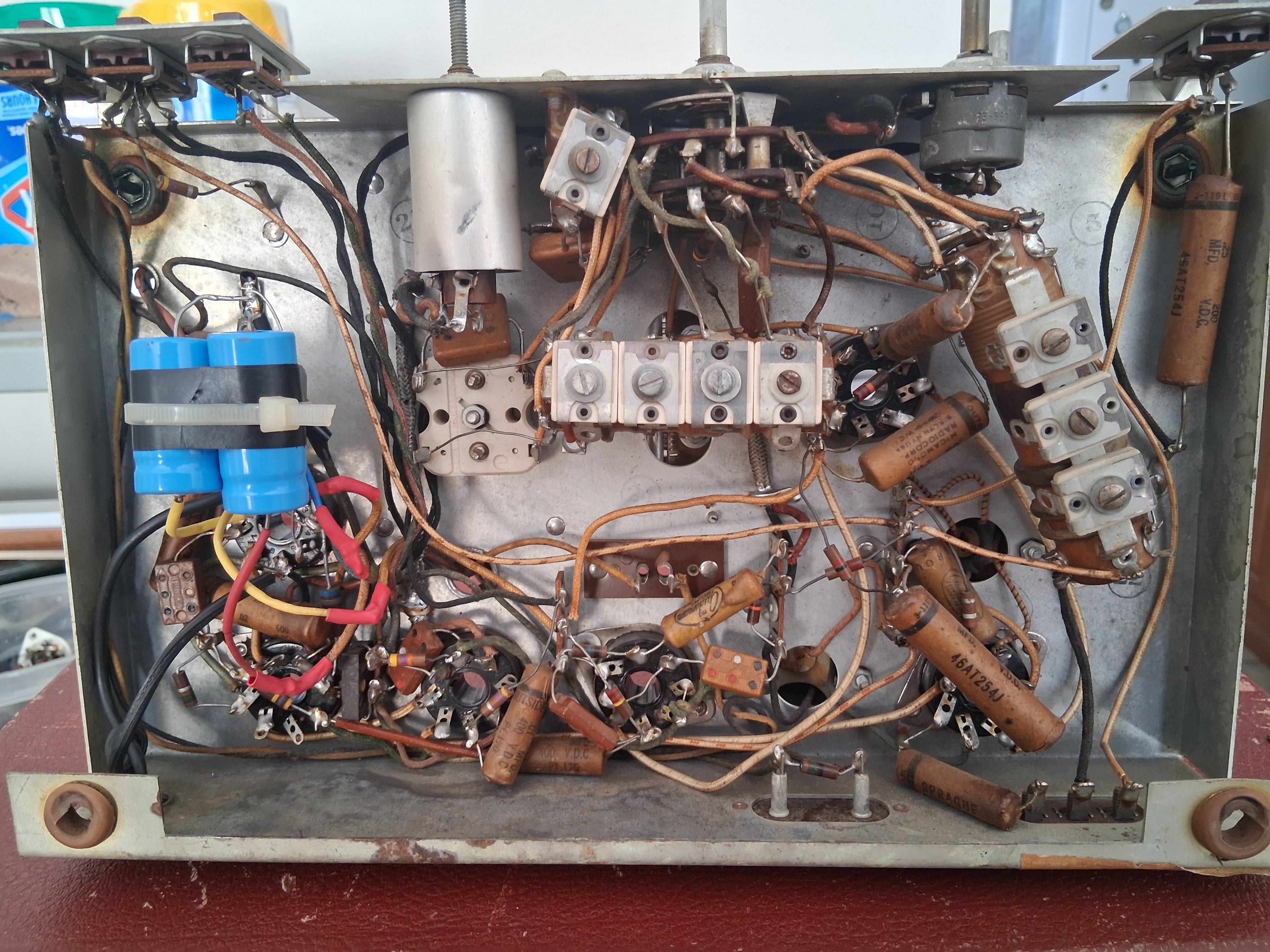

I like the S-38 series the E has 7 pin miniature  tubes the others no. The first model in the series did not have the gimmick wire.  Hailcrafters resistors and caps do not age well. Please let us know which one in the series. David

Here's a better pic
A link for info. David     https://www.nostalgiaair.org/models/Hall...c-S-38.htm
Looks to be in clean shape. Great catch!
Great info at this site. David    http://www.stanwatkins.com/hals38.htm

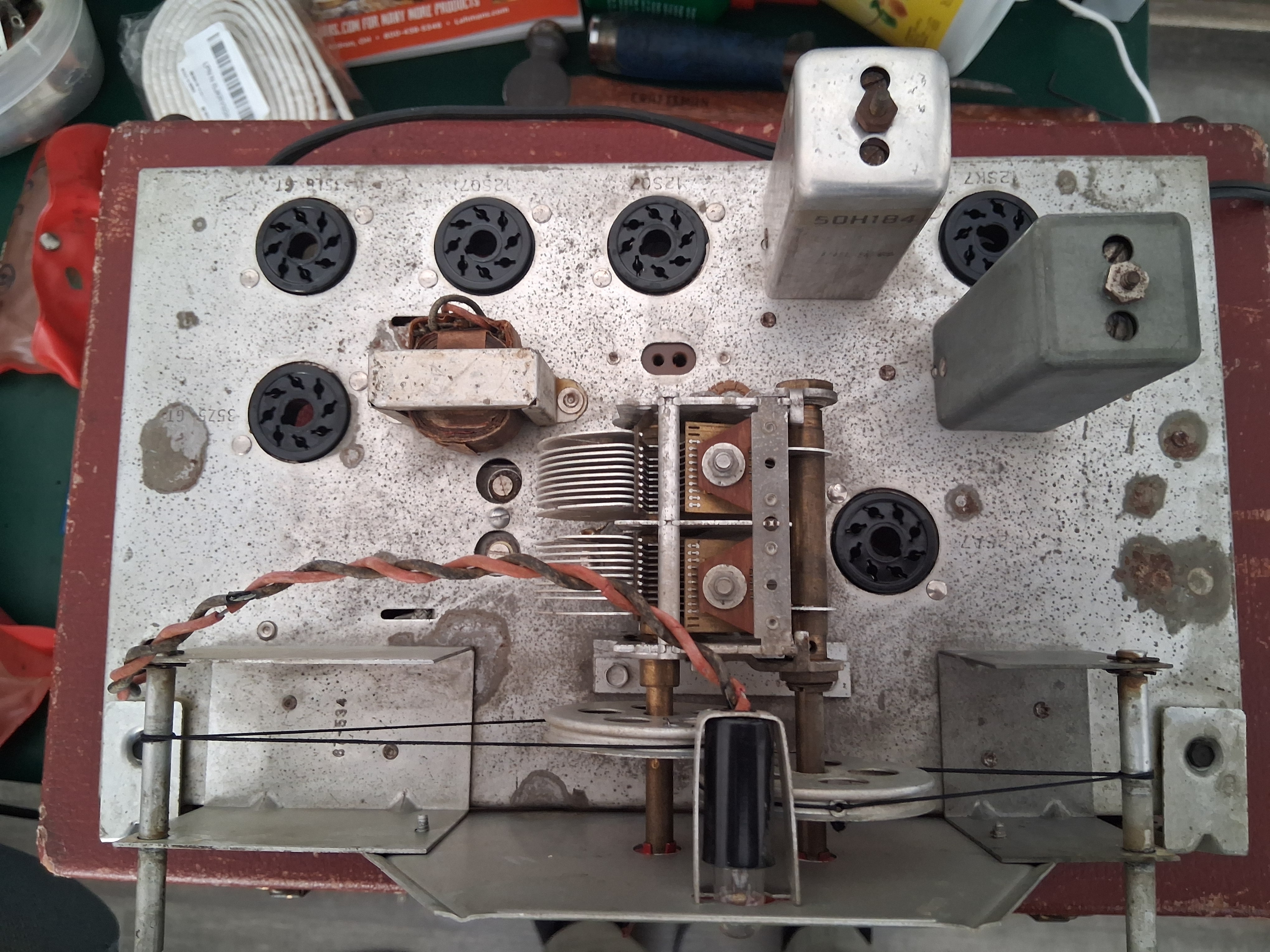

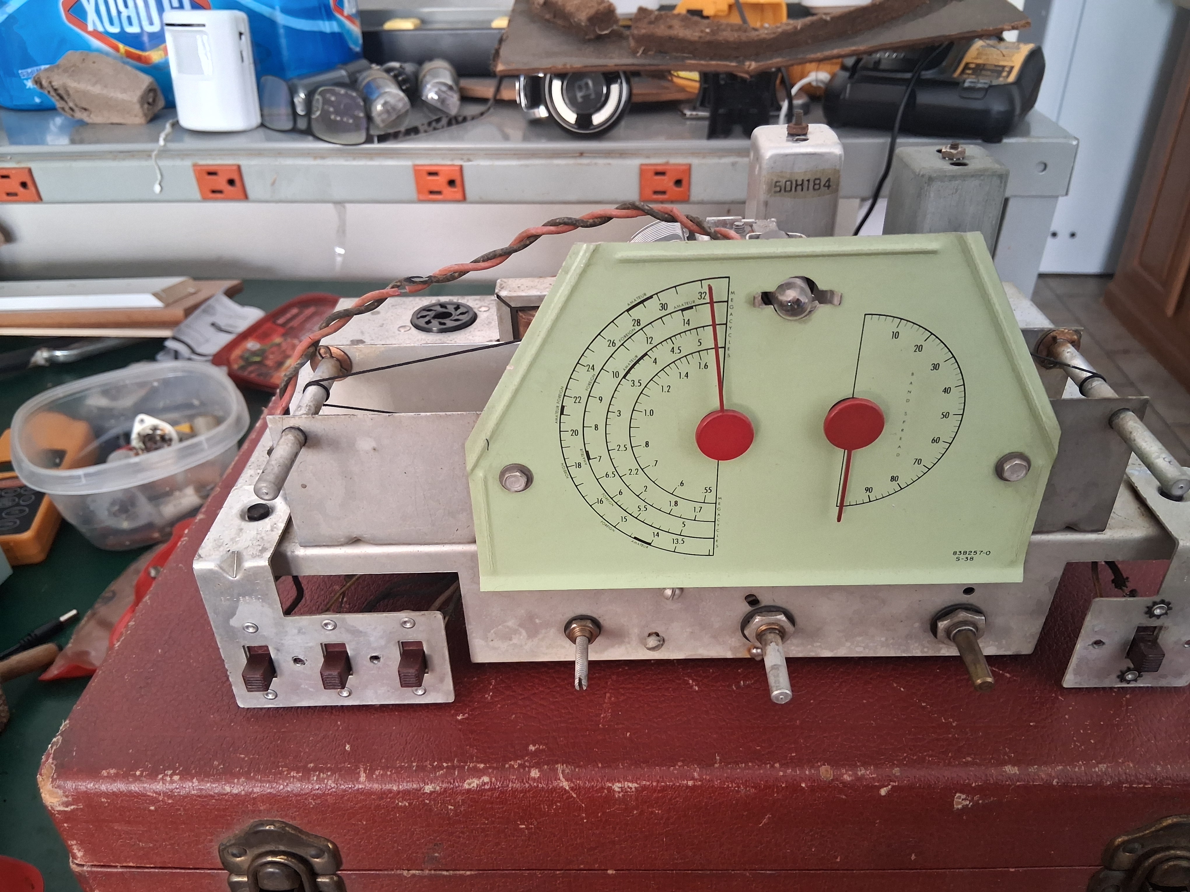

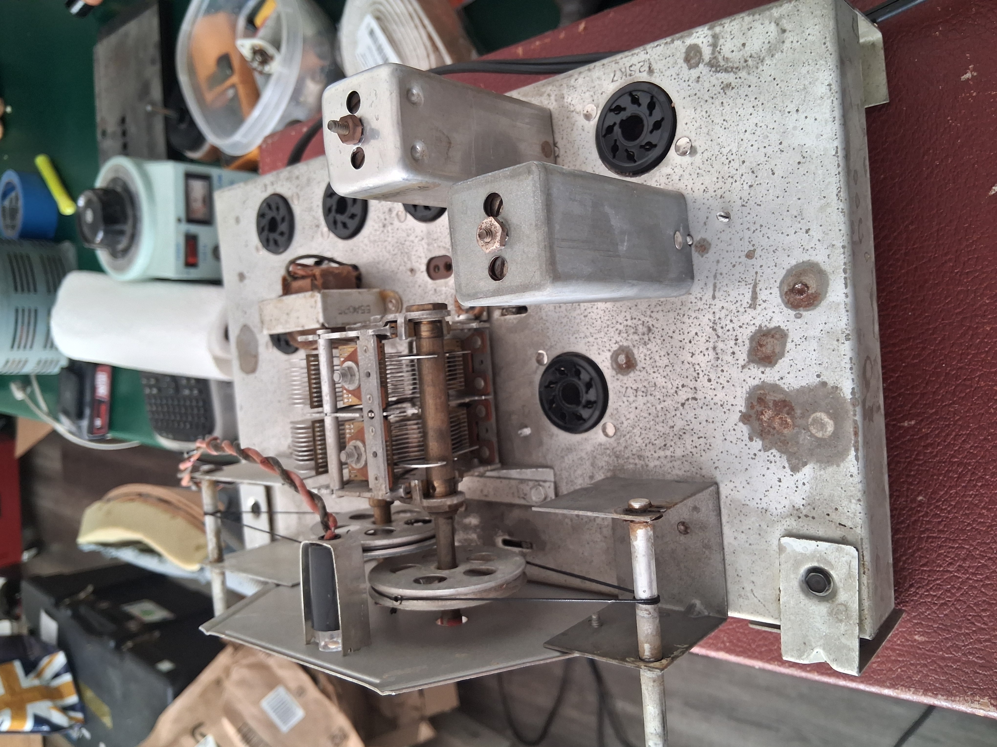

Chassis pics
