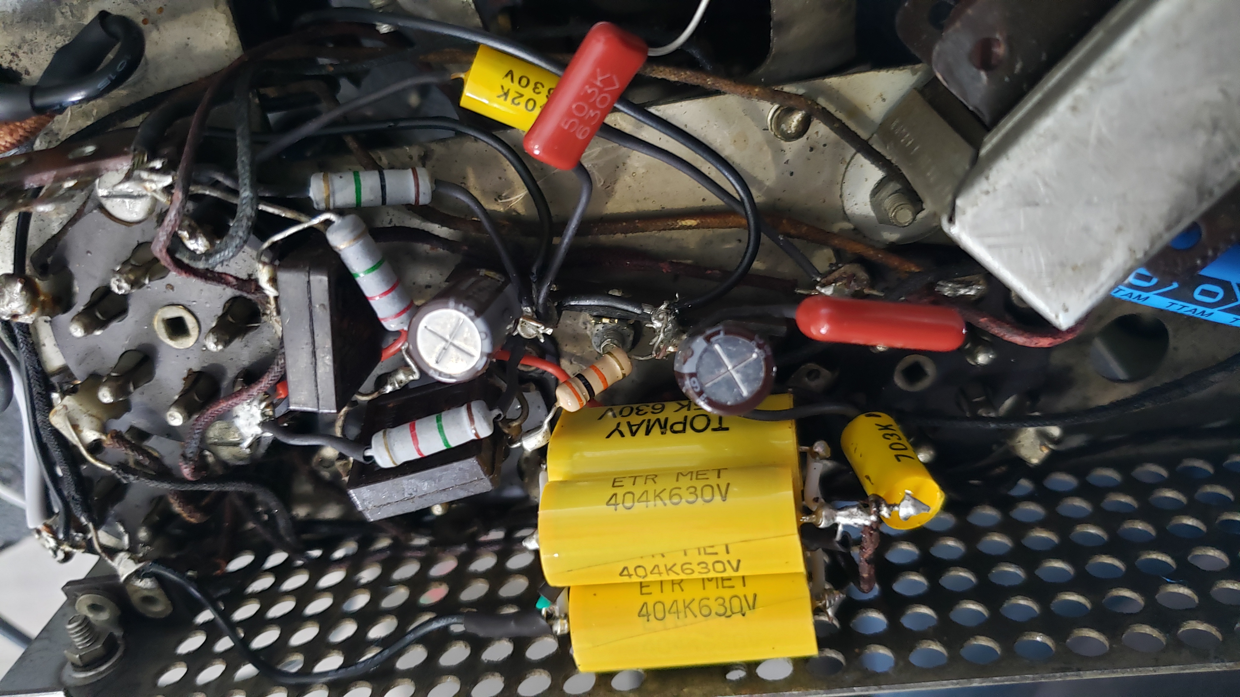

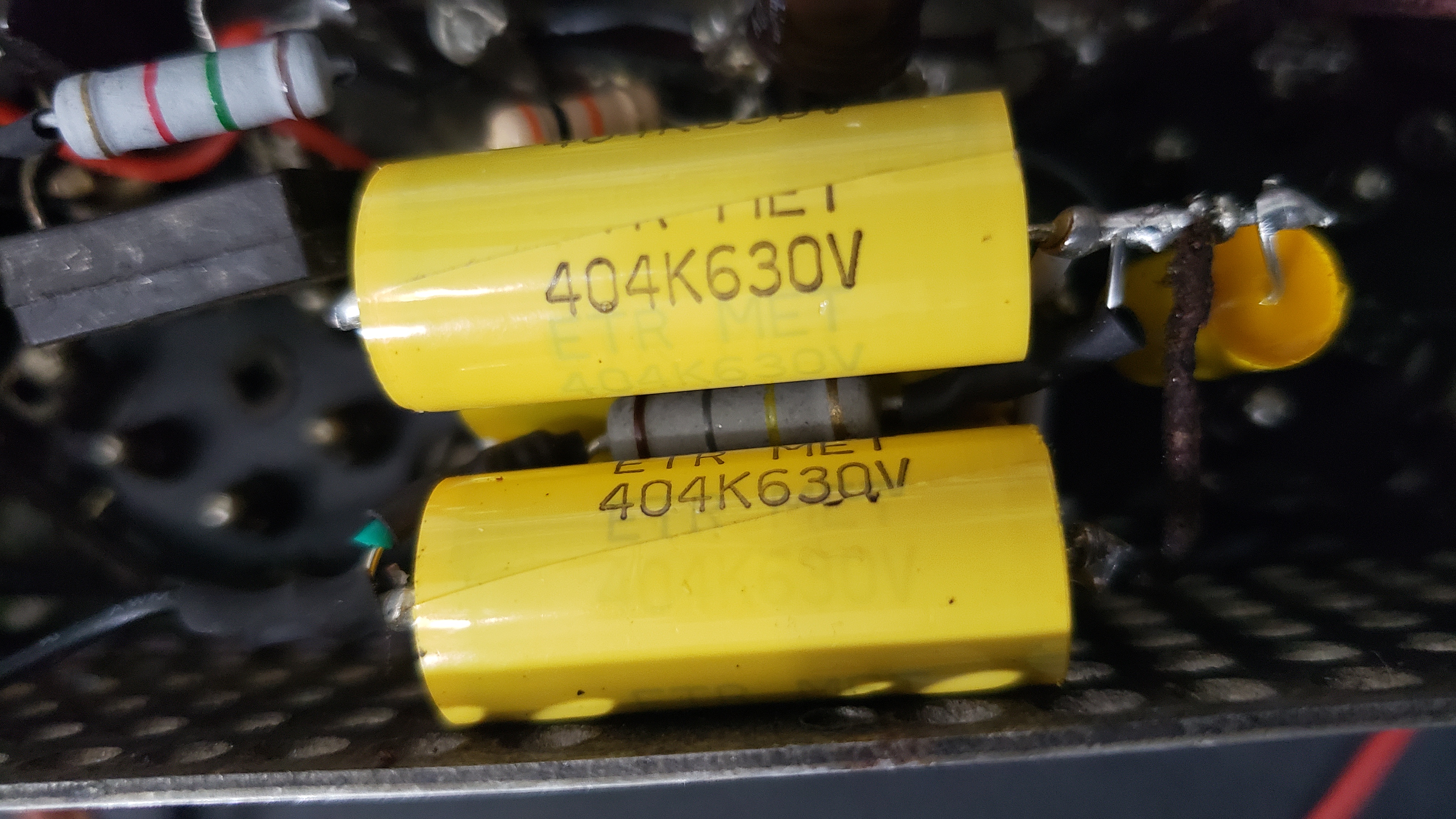

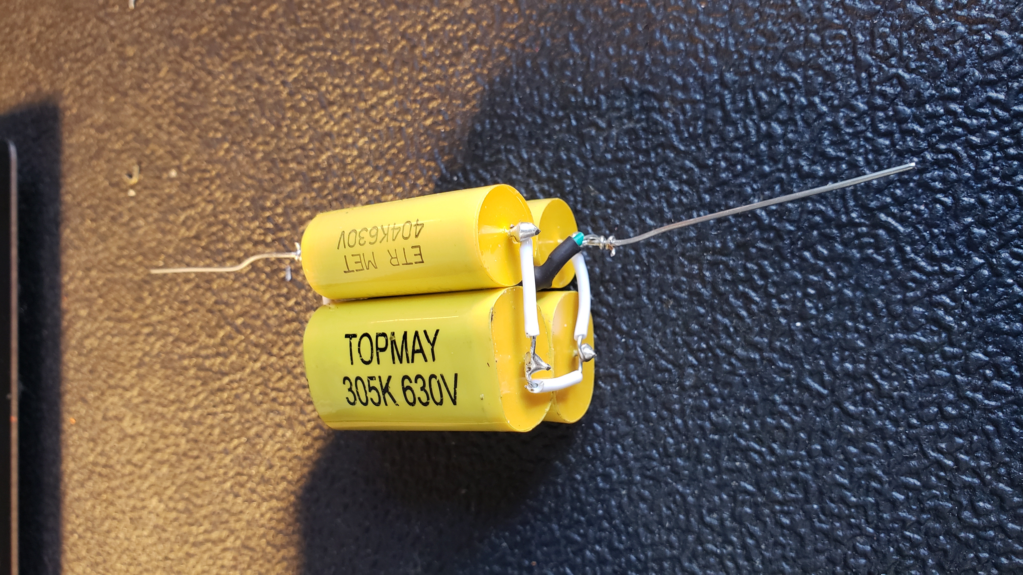

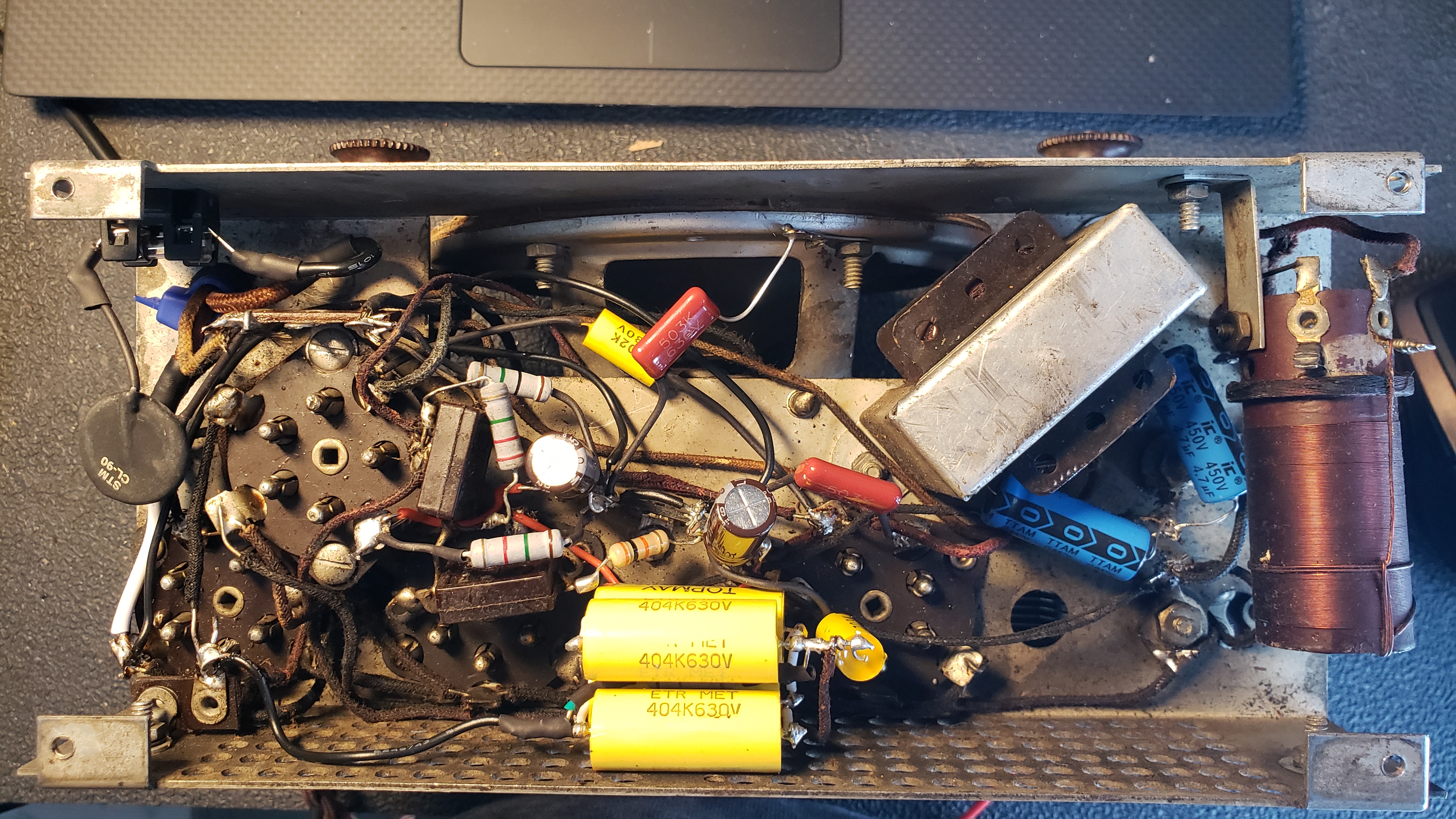

Installed the capacitor voltage dropper with caps on hand (made a capacitor bank with 2 x 3 uF and 2 x .4 uF). Also added a 100k discharge resistor.  The radio is working well and cool as a cucumber.
Thanks again gentlemen.
