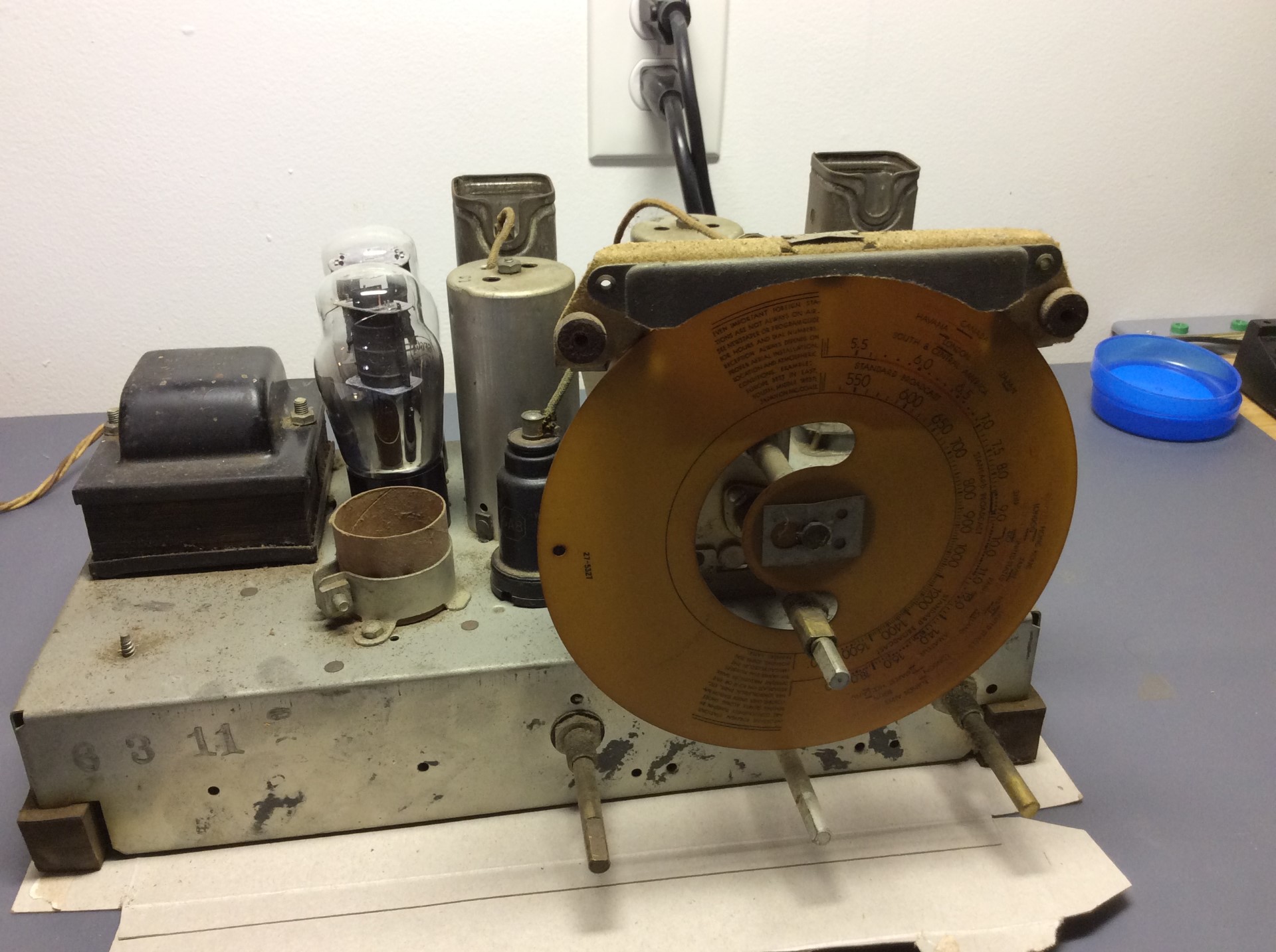

Here is Photo of my Philco 38-10t before I started restoring it and you can see the two tube shields .
