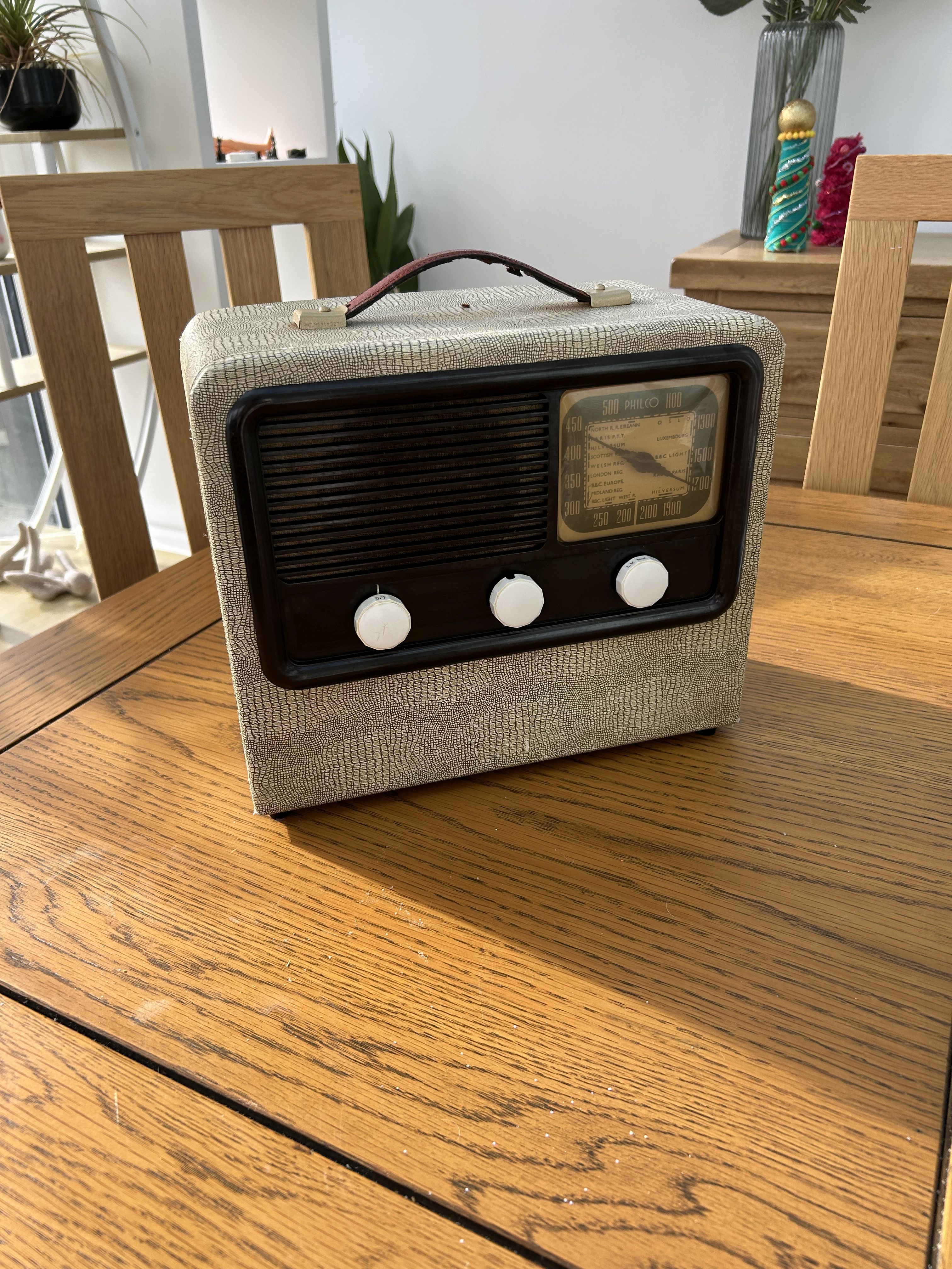

Dear All,
I thought there might be some interest in this UK made BP426 portable from the Perivale factory in about 1946 / 47
It originally used a 2 V accumulator for the filament voltage,  which I replaced  with a 2V lead acid battery, as used with remote controlled cars and such.
Restoration was straightforward with very good shop info. being available.
Condition is more or less 'as found' after a clean-up.
Best Regards to all, after a long absence !
Chris
It's a cutie. And is in very good shape.
Smart looking set, Chris. Must be stuffed in there. Maybe you should recap it. That would test your patience.
Rod
Judging by Zenith 5G500 (should be similar inside), not too bad. A little crowded, but, with the sole exception of removing that omnipresent twistlock, it is not your 38-690 RF chassis recap. Icon_lol
Thanks for the replies - I did end up replacing all the capacitors - there are not so many and it was actually easier than some, like the Zenith portables. It uses full sized Octal tubes with painted-on shielding. Which is interesting if you consider that in the US Philco were making farm radios like the 46-132 at the same time that had the much more compact Loctals.

Were those Mazda brand tubes/valves with the spray shield coating or Cossor? I don't think that Mullard (Phillips) made battery tube like that with octal bases, they did make some AC tubes that way as some Pye models used them. I have yet to acquire a British Philco, but have been studying what I could of them online, the closest I came was a People's Set (I think) about 20 years ago. I have noticed that they, much like Canadian Philcos, used a mix of imported U.S, and domestic made parts, and materials.
That's a nice one! Thanks for posting it.
Hi - in answer to Arran's question, the valves / tubes are all branded Mazda. Other components also seem to have been sourced locally - e.g. UK made Hunts and Plessey Capacitors.
