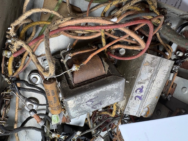

I have hit a HARD stop on my rebuild.  The audio transformer (Philco part # 7233) is dead.
It may have been replaced by a Hammond transformer at one point.
Other than the hammond logo there is not id.
Does anyone have a Hammond number for this unit?
Thank you,

The transformer is likely a Hammond 125h. See the following link:
https://www.hammfg.com/electronics/trans...audio/125h. Plate to plate impedance for a Type 19 in push-pull is 10KOhms. You can likely scavenge an output transformer from the many Philcos that used a pair of type 41, 6K6s or 7B5s in push pull. Plate to plate impedances for all of these tubes is 12KOhms. The mismatch is not critical.
If it's the audio output transformer that should be very simple, if it's the audio interstage transformer it's not as straight forward as the push-pull outputs in most 1930s battery sets were class B, and actually require a step down transformer rather then a step up style like most AC sets would use.
